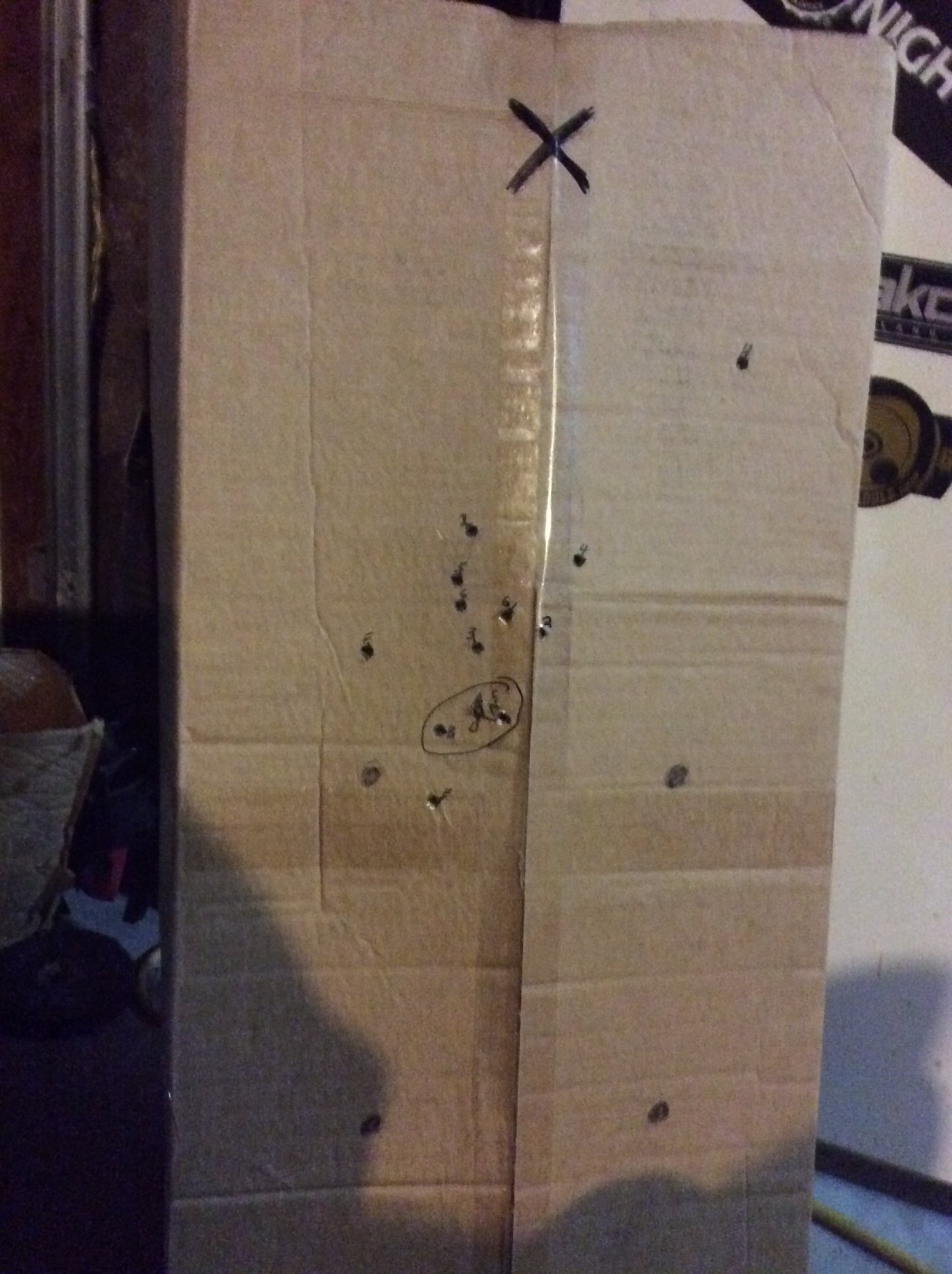

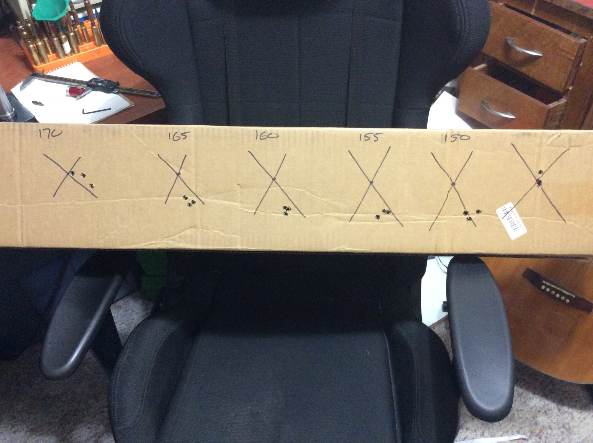

    A very small sample of five rounds through the corner graph I had an es of 12 and an SD of 4 and the other five was 19 an SD of 6 just trying to get a feel for the powder but so far liking what I see and it matched my Hodgins 1000 velocity with easy bolt lift Lift no ejector marks 80 + degree weather the Hodgins 1000 would open up very hard with strong ejector marks and ruin my brass

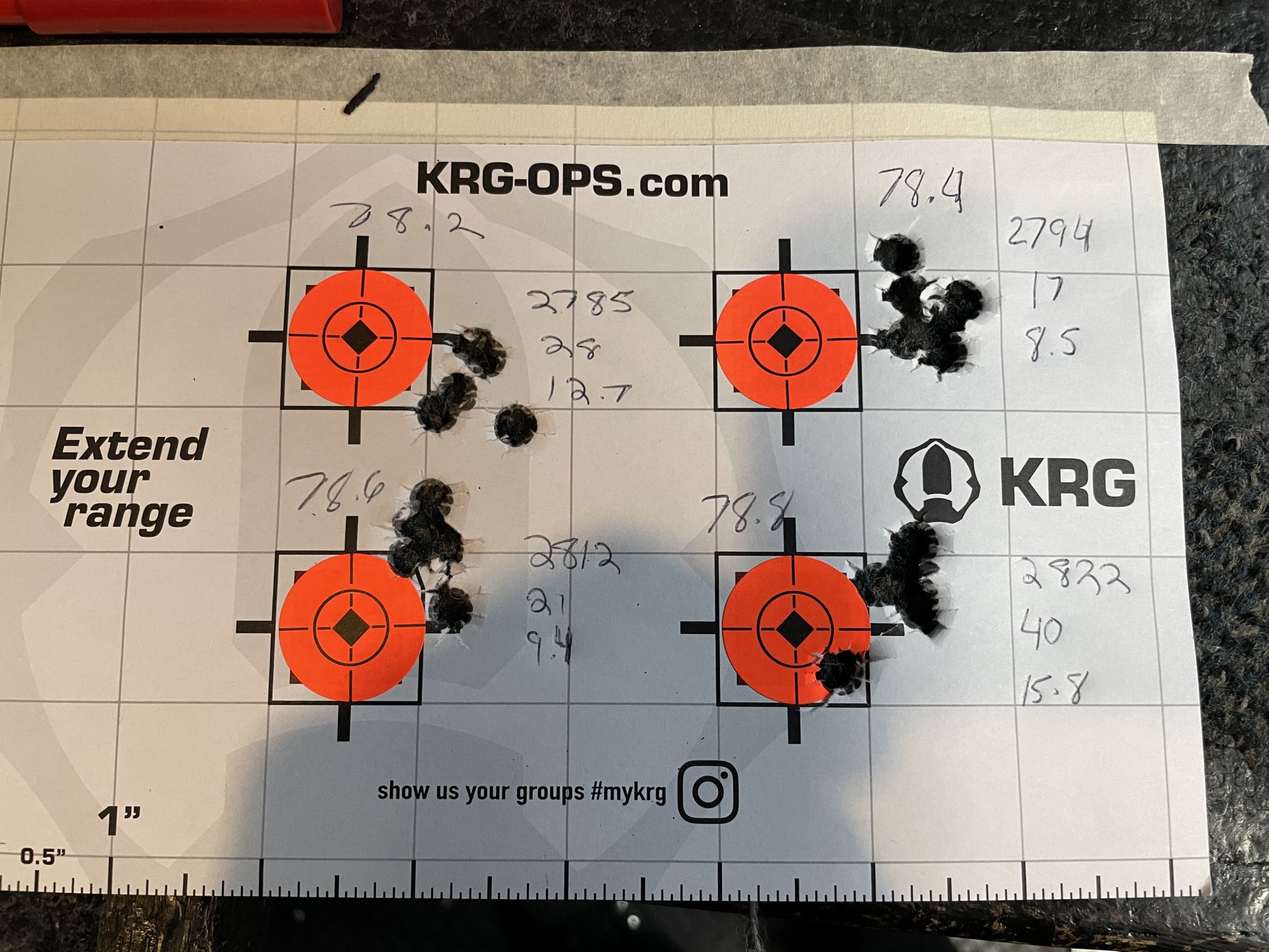

    Fairly new member here i have a jug of IMR8133 for RPR in 300 win mag. 220Gr Berger LRHT GM215M I'm in the begining stages of load development.
