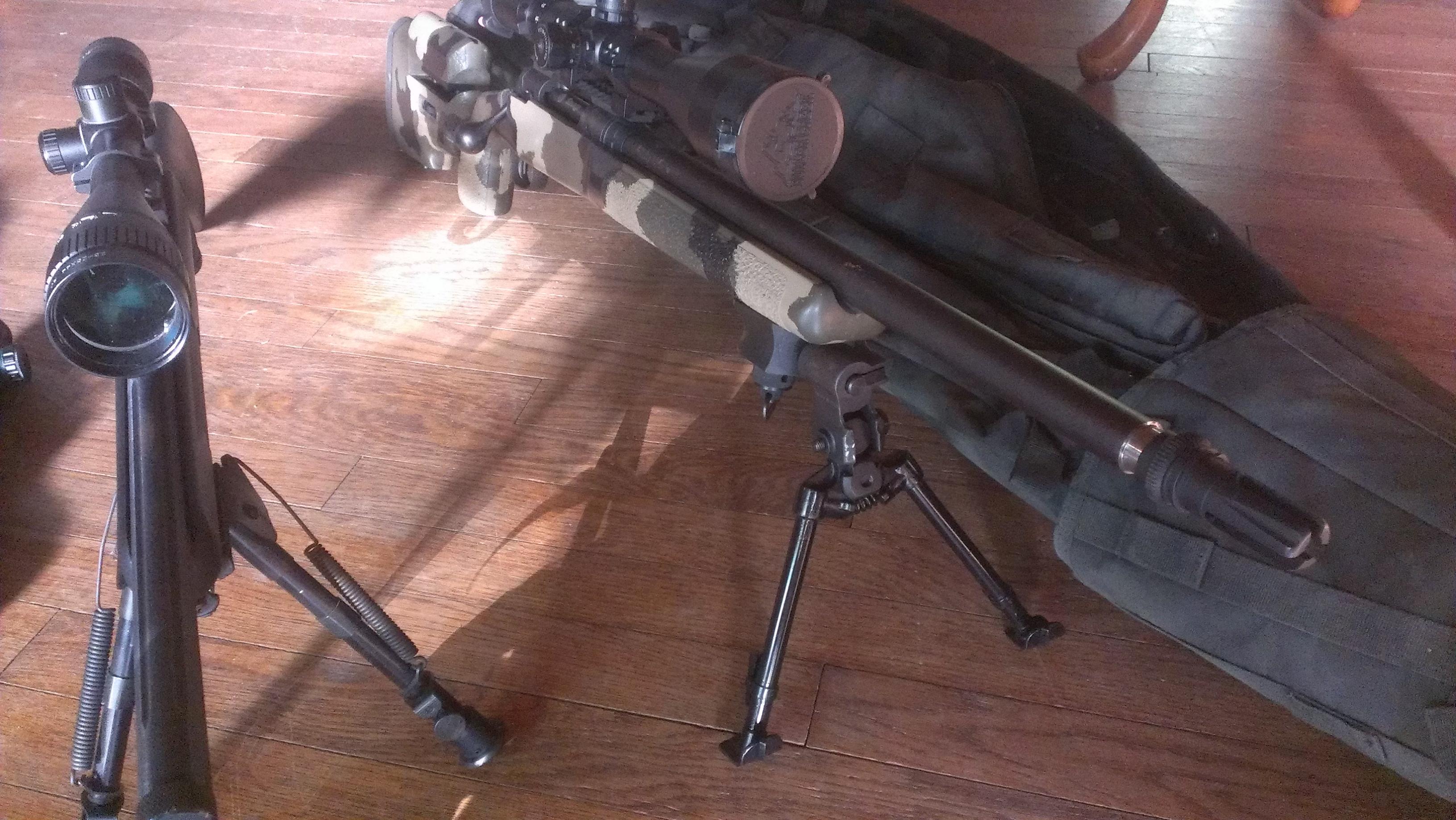

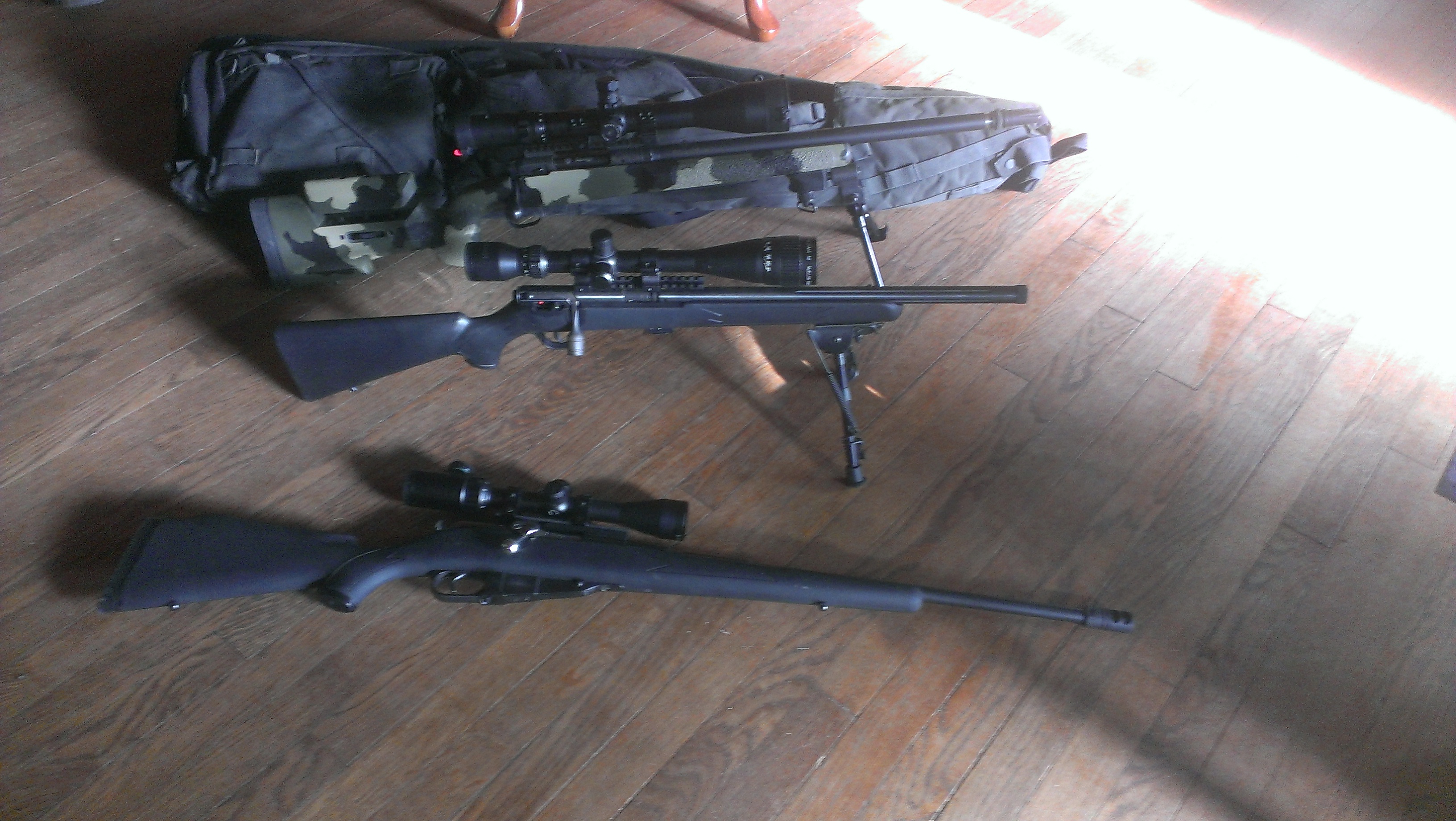

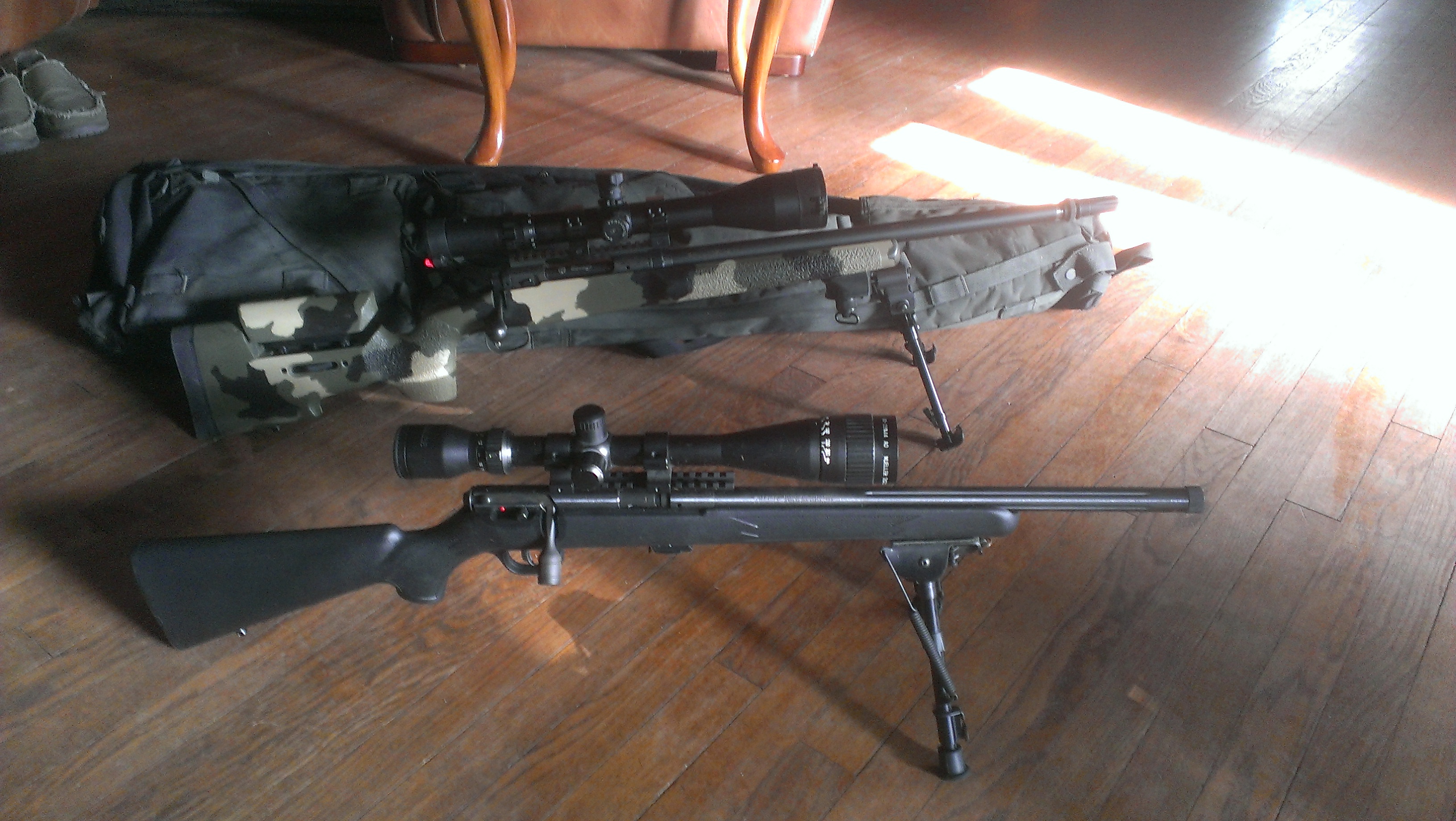

The other 2 are a Savage MKII .22 and the other's a Mosin in a ATI monte carlo stock with 6.5" of barrel cut off, machined locking lugs and bolt face, smoothed outer receiver and ATI scope mount and turndown bolt conversion. Then I threaded it and installed a brake to lighten things up some.

What stock is that? I kinda like it. But I will be sending it to CDI for sure now. I have talked to them and was surprised at how cheap it was to do. But I'm currently shooting 168's. But will develop a new load for 1k yards. I know about how easy it is to swap a savage barrel, I just need to buy the tools to do it.
Stock is a JP Enterprises.
