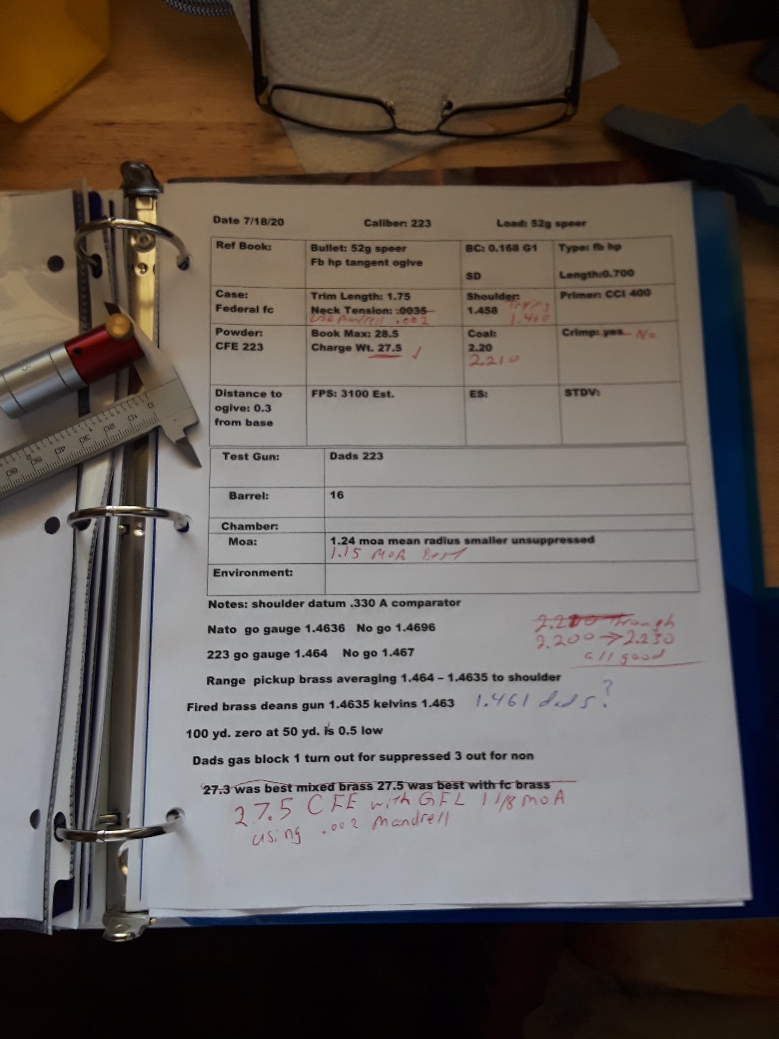

A new book will be 99% the same information. I started a small binder for 6.5 cm and printed off all the loading pages from different bullets, powders, etc. along with the saami spec and some blank pages for notes.

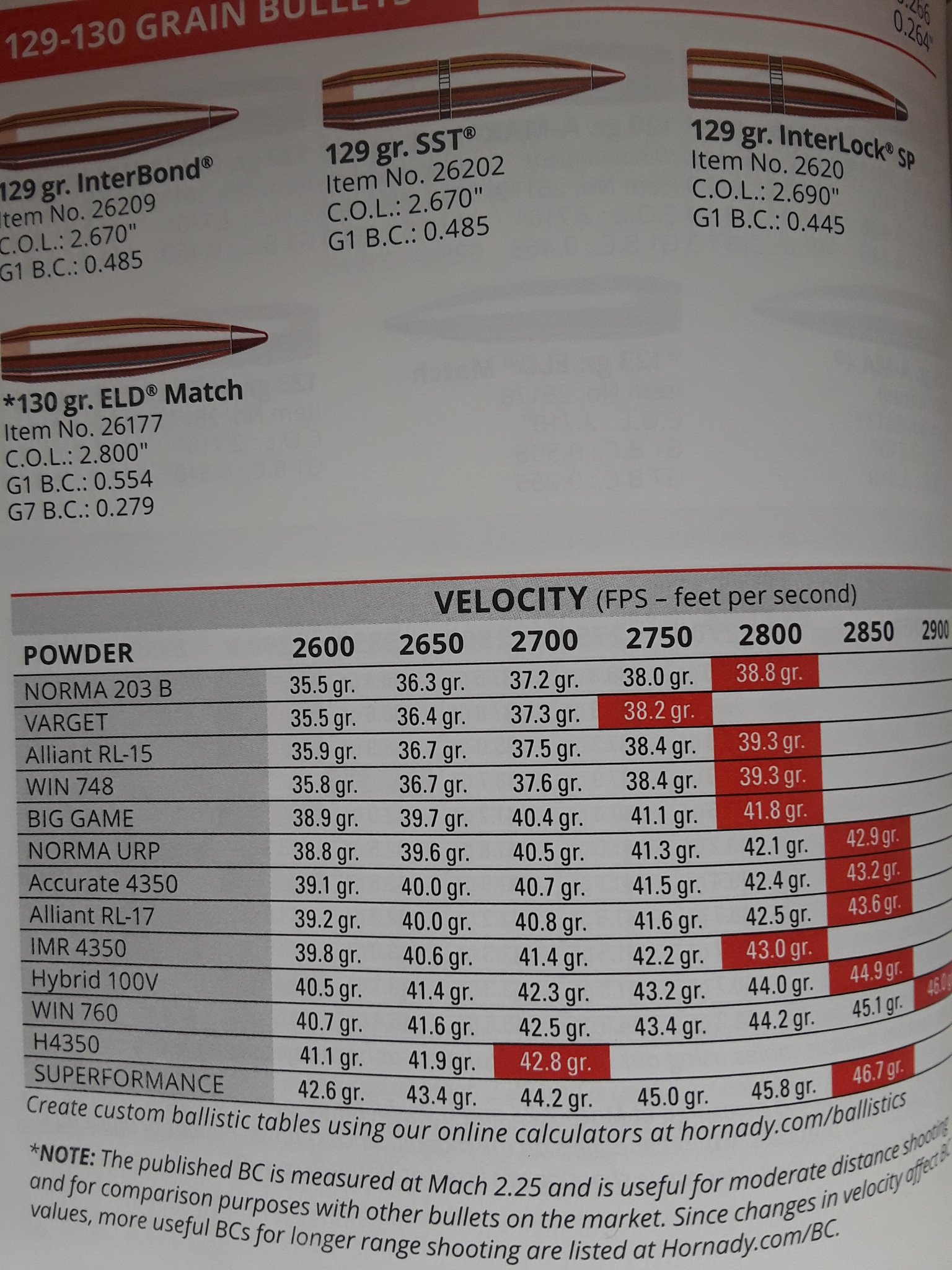

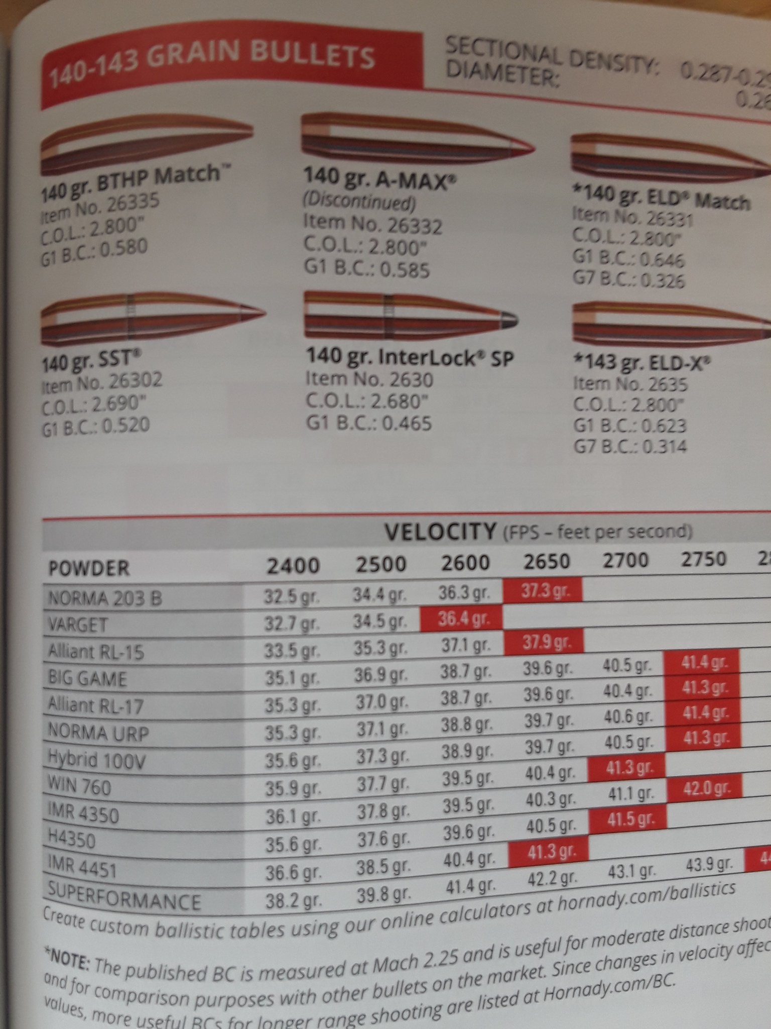

Just looked at my Hornady book and Lee book.
Hybrid 100v
The hogden site listed 7 different bullets.
Possibly the reason not more is listed is it is the wrong burn rate fot that application?
Reactions: Snuby642

Those apps look like a good way to print one page and put it in a binder.
I made my own word document to keep loads. As I take notes or make changes (in red) it's easy to update the sheet later.
When a load hits chizle in concreat status it gets a protective sleeve on it.
Also a printed page of saami spec for each cal in the binder for reference.
