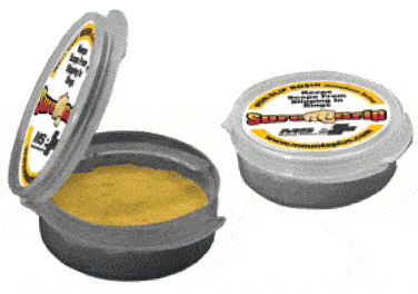

I had a ATACR slipping in a Spuhr even at slightly above spec torques on my MRAD 338LM. I used some scope grip rosin and it solved the problem. NF might be right, your scope might be functioning correctly but maybe the tube is slightly out of spec and not being gripped by the second set of rings well either.
The rosin is cheap, it's worth a try.
NF said both rings and the scope body were in spec, but hell yeah it’s worth a try. Thanks.
