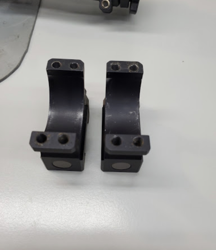

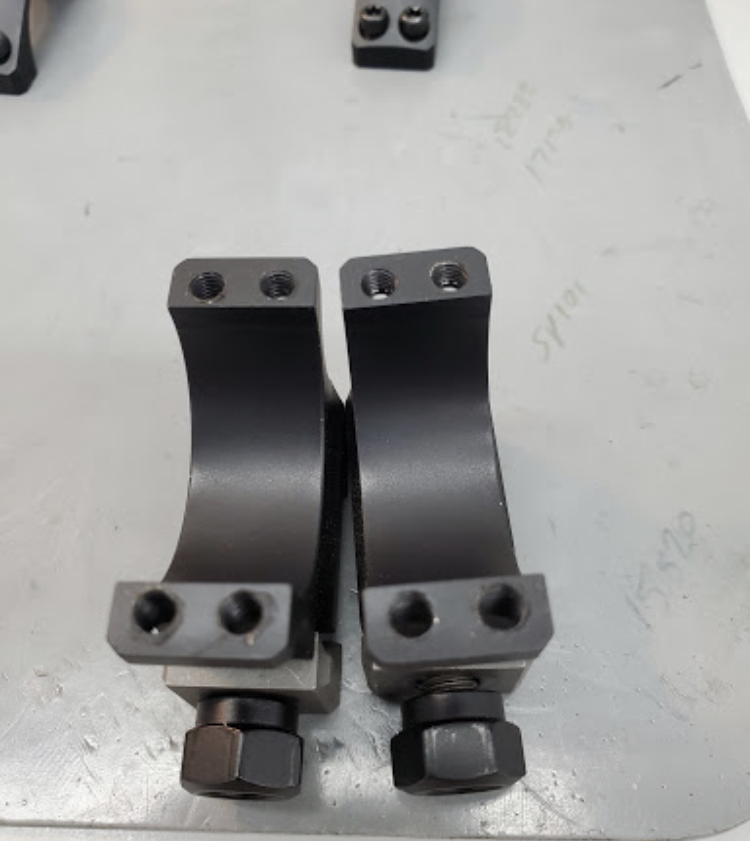

It’s definitely not loose enough to be moved by hand, and never had been. NightForce sent pictures back showing the inside of the rings. The first set looked like they had been lapped. The scope body had ring marks. I could buy it that there was MAYBE an issue with the first mounting, even though I watched the guy do it correctly. But not all these subsequent times by different people with different rings all continually producing the same results.
Pics of the two ring sets
Are all the base screws flush with the bottom of the picatinny rail slot? Because if the ring cross bolt is riding on top of the screw head then it could explain the poi shift.
No, they are recessed.
Is the picatinny rail bowed? Do you have something you know is perfectly flat to check?
With a straight edge its flat. Besides, as I mentioned other optics worked fine on it, and I put the NX8 on another base and rifle and it still sucks.
I don’t know what else I can do to prove it’s isolated to the optic🤷🏻‍♂️
You need a reputable gunsmith, someone well known who builds precision rifles, to test the scope on his rifle and replicate the problem and write it up. Then maybe NF will replace the scope.
I had a somewhat similar issue like this. I found that when I leveled the rifle and took the scope and top half of the rings off and laid a torpedo level across the bottoms of the rings, one was dead level and the other was half a bubble off. Once I bedded the rail and had both reading dead level, the problem went away. Might be worth a try.
Reactions: jafo96
Who did the first mounting? ( possibly the culprit), and since their was MAYBE an issue is it possible that this led to repeated failures despite numerous mountings with other equipment and experienced shooters?
Lapped rings and ring marks on the tube usually indicate an initial mounting problem!, how bad are the marks on the tube?. I wonder since the NX8 is a short tube that poor mounting ( if this is actually what happened) makes it prone to damage!, I hope not as this is a scope I plan to purchase but I'm not sure now that Nightforce is claiming the scope is GTG!

I have Purchased and tried several different rings and had the same results. The optic has been re-mounted several dozen times including a bunch by a night force dealer using the exact same tools they use set to the same torque settings.
The optic has been back tonight for twice now, only to be sent back as “not defective.”
Night force blamed me, the other gunsmiths, and their own dealer not using proper mounting procedures as the issue. It’s not rocket science. Their dealer mounts hundreds of scopes a year without issue.
Today I took my suppressed Tikka T3 X chambered in .223 out after getting the NX8 back. Same shit as the past year. It really is as if the scope is moving despite everything having been done exactly right countless times. A lot of times I will get two impacts touching or nearly touching, and then one flyer several inches away. Sometimes I will even get a lucky sub MOA group, but the vast majority of the time the groups are between two and 6 inches.
Im not starting this thread to bash any companies or start a fight. I seriously don’t know what else to do at this point and it seems I have a $2400 paperweight.
Night force has said it’s fine twice now and there’s nothing left they can do. Advice?
