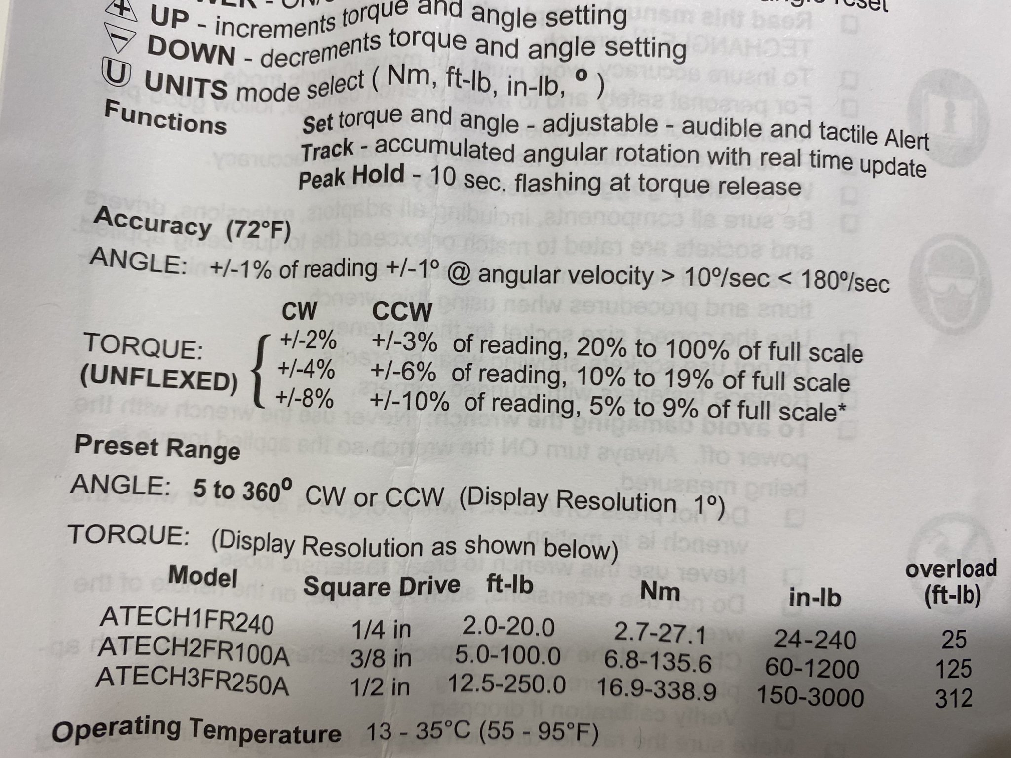

PSA.......I listed above a variety of torque wrenches I use for various tasks because:
1. The "accuracy" of the tool depends often on the magnitude of tool range-of-use (0-20 v. 0-120 in-lbs) as well as ambient temperature (which is probably a moot point for indoor assembly), and the sector of the tool range that you will be using it at, i.e. lower 10%, mid 40%, or upper 10% of the tools range. For example the Snap-On that has a range of 0-120 in-lbs has a different accuracy rating depending on which range of use AND whether one is using a right / left hand threaded fastener (see photo). A 10% error rating on a 120 in--lb scale is ~12 in-pounds......more than than should be used total for most common pistol grip screw installations!
2. One should know that most often the torque tool is appropriate for a left hand thread installation as well as a more common right thread installation; no so with Fix-It sticks which have no left hand thread torque option. Snap-On torque tools can be used to torque both right / left hand fasteners.
3. Whenever practical use the torque tool that has the smallest range of use that is useful for your specific application.
