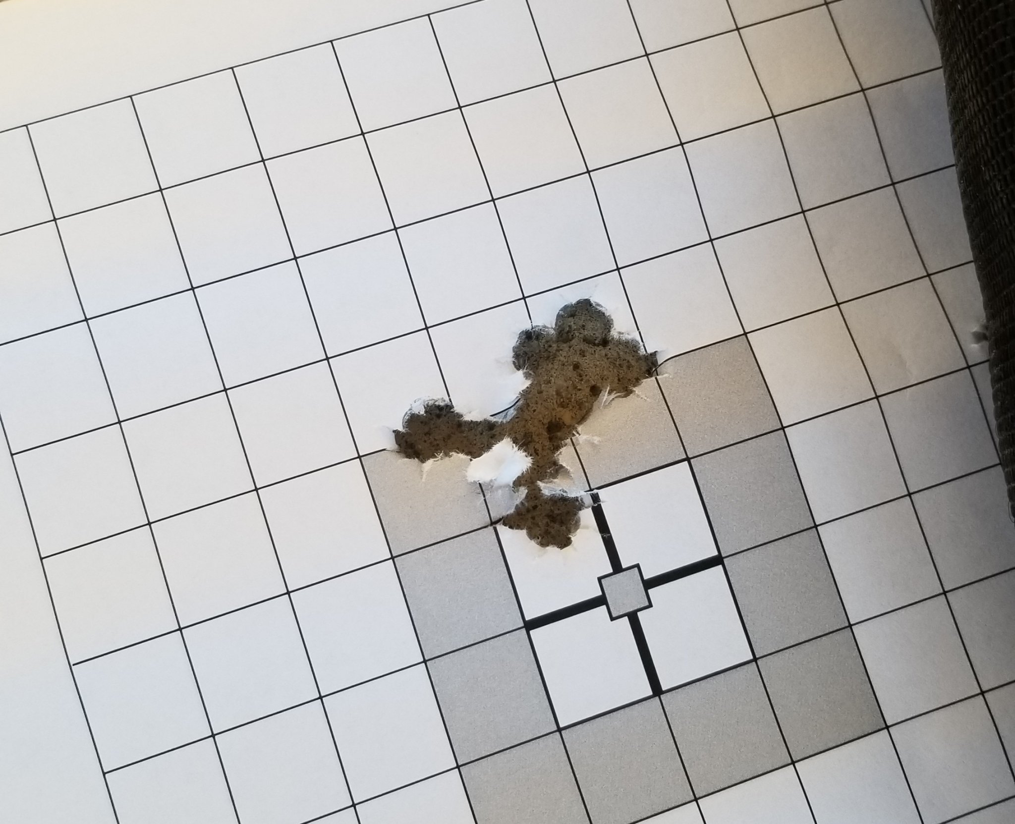

This thing shoots great. first two rounds were real close to being the exact same hole at 100 off a bag, and then I started screwing with the turrets haha.
I think 178 ELD-M and 41.5 grains of IMR 4064 is the ticket loaded to the lands.
