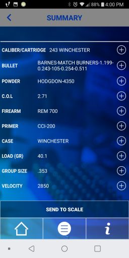

@x_789 , when you use the app, which button starts it's to trickler? For whatever reason I'm being a ln idoot and cant figure out which starts it. Impressed tricklenonce and it started going but it went at the normal trickle rate, not the rate where it is throwing a charge. Not sure if that makes sense or not.
@Ryridesmotox if you type in what load you want, Example 22.4 then hit load it will run at full speed acording to the last powder calibration. I only run powder cal when I change powders. I know first time I put a new powder in it would run out between 250-300gr. After I change powders and go back to one its calibrated before. It seems to learn it faster in about 100-125gr. I think it probably has a memory of last 5 or 10 powders and when it sees a similar drop. It will not run the calibration as long. That is just a guess but has been true on my machine.

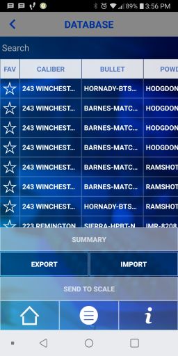

Using the app to send a single load isn't very useful imo. It really adds benefit when you build loads and then you have them in your database and recall them and send them strait to the scale. You can use it to track lots of items on a specific cartridge combination. If you are doing ladder testing you can build the base load then just keep changing your power charge and saving it. It can be useful if you play with. If you are just sending a single charge to the scale the app isn't really worth it. Faster to just use the keypad imo.
I cleared the app memory and started again, it worked, thanks. Now it makes more sense lol
As far as using the app to do loads, I'll probably store a load for a certain bullet then just save it. Then when I start my 223 workup for my new barrel, I'll save that. I'm a simple man... I like to just find something that works and roll on
