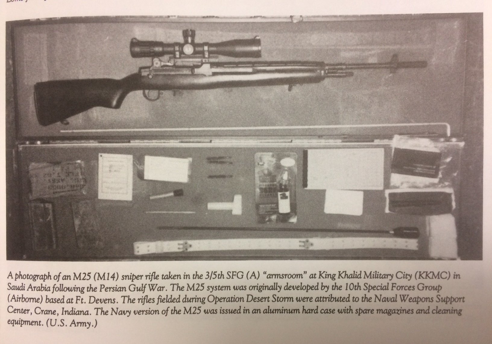

Interesting M25 Info and Pics

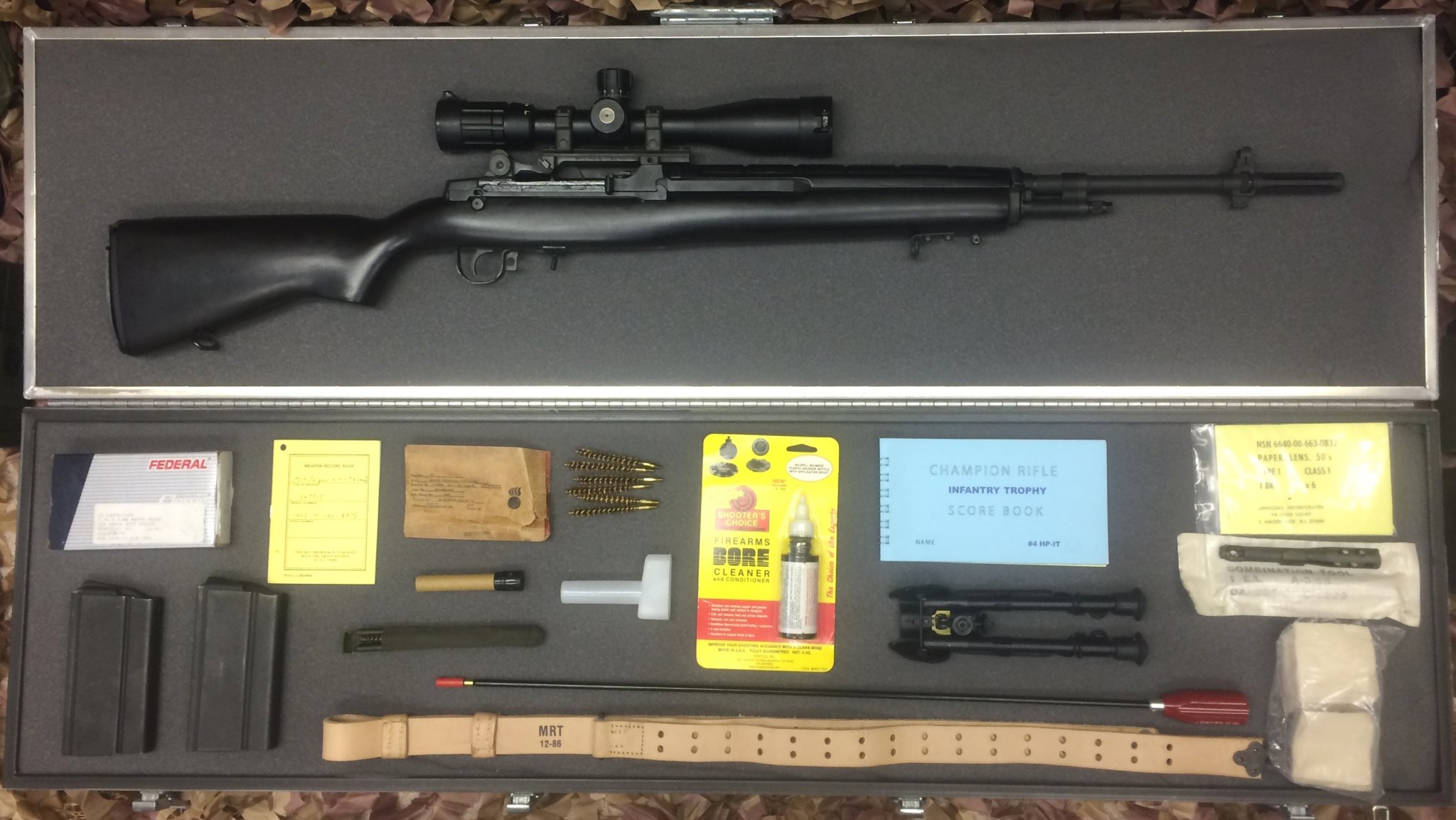

Sent the fine gentleman that runs the civilian rifle and pistol club at Devens my pictures from Curry and my hopes that we can schedule a shoot there and he mentioned his M1A was built by a 10th SF armorer and has a bunch of Brookfield parts in it.
I never made the connection that Brookfield Precision Tool was in Brookfield, MA.
Its a beautiful rifle. Ive see him iron sighting the Crazy Ivans at 900 yards over on Hotel range.
Im planning on shooting May 8th with the club at 600 yards Ill get some pictures of his M1A.

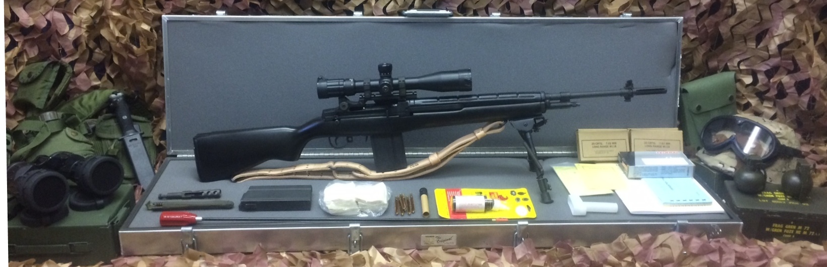

I let a friend borrow my M25 for a 3 Gun Long Range match and he actually took 2nd for the Heavy class with plain old 168gr Federal and a 100 yard zero. We had good dope for 175's out to 600 yards but we ended up with the wrong ammo.

Resurrecting this thread, as my Navy M14 Physical Security Sniper Rifle (aka Navy Port Security Rifle and to some people an "M25") is now finished after 2 years. First picture was the inspiration (pic is from 'The Long-Range War' by Peter Senich). Other pics are completed project.
