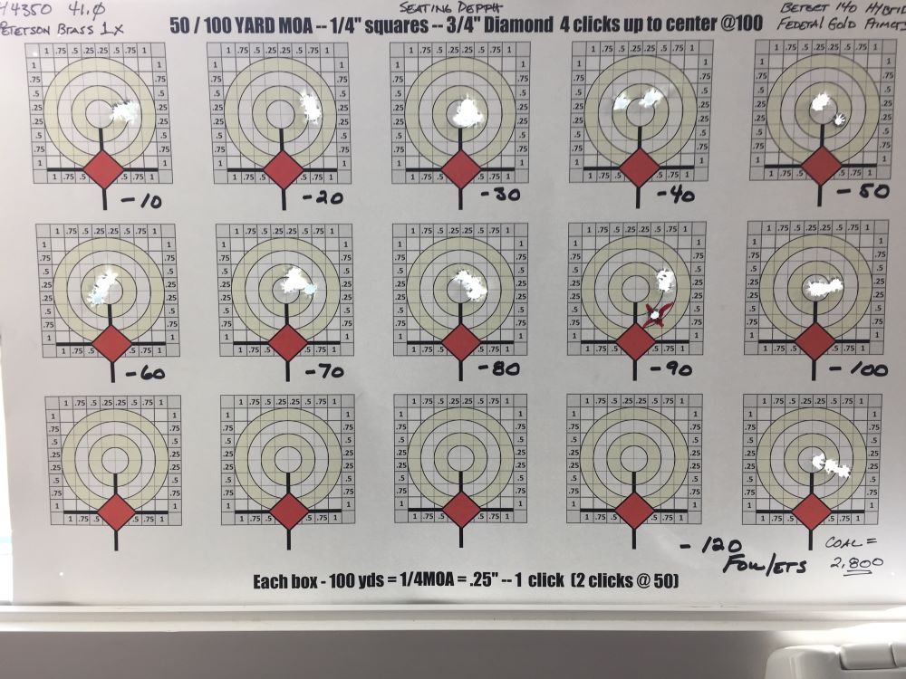

I recently worked up a load (Newberry OCW) for a new 6 BRA using 105 Hybrids 015 off. Familiar with rough starting weights, I only ran it with a few grains difference start to finish. The results were pretty obvious, the plots favored 31.0 grains of Varget at 2920 fps. 31.0 gr. shot .16" (Probably coincidental the smallest group was in the center of the node.) With the Newberry method of round robin shots, I don't think it coincidental that every 5th shot of 40 landed in the same hole.
I next tried playing with seating depth changes, 003 at a time out to around 060 and remarkably I found no appreciable difference, certainly none shot smaller.
I've done this with 223 SMKs , 75 ELDMs, and 6 & 6.5 Berger Hyrbids - and always found the charge weight to produce the most significant advantage over seating depth.
I'm certainly not arguing against the theory, I just haven't found it to show in practice. The targets below represent the results of OCWs and just shooting the same seating depth (With the 223 & 6.5 until the barrels were toast).

If that last pic is the seating test, there’s nodes in
.10-.30
And
.60-.80
Reactions: DellaDog

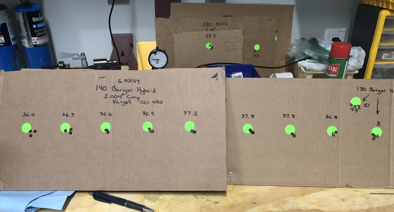

The OP's test is an example of an excellent rifle, fired by an excellent shooter, with a very forgiving bullet, powder and cartridge combination. Part of OCW testing is to find a forgiving charge weight at 100yds but it must be verified at distance. As to what distance, I'll leave that to the OP as he knows what he is trying to accomplish.
In response to the original question I'll explain why I think the area to look at is around 37.2 gr. I did not just pick a card. The POI centers for 36.9, 37.2 and 37.3 are almost identical. In fact, if the 3 groups were overplayed you would have an excellent 9 shot group. Typically, the group size is not of primary importance in OCW, but in the case of this rife and shooter, group size does aid in trying to find the node. Is this a node? It appears to be. To further justify looking at it further is based on the fact that the 36 gr group appears as a scatter node, assuming the shooter is as accurate on this charge as the others. That would suggest a node ~1.5% higher at ~36.5 and another at ~3% higher at 37.6 gr. If 37.2 turns south at distance then looking at the 37.6 area would be the next window.
When Dan Newberry developed his method it was before the more reliable and easier to implement chronographs such as the Lab Radar or Magnetospeed were on the market. It still works without that data. I will add though that chronograph. data in this instance sould help refine the the test. But as the OP stated even the SD's were consistent.
And this is why (no offense) I feel these types of tests are outdated. It takes this much explaining. And it requires shooting at distance.
With powder/seating tests separated, you are only looking for one thing each time and it’s readily clear what’s going on and what is better.
Then the only reason to test at distance is to make sure the bullet’s BC doesn’t vary too much from bullet to bullet which would then require sorting and/or tipping.

In my initial test, the most consistent numbers came from 37.2-37.5. I was having some sun/shade issues with my chronograph, so I would like to validate. Also, I was only shooting 3 shot groups for sake of speed. That's not a ton of numbers to base things off of. The group at 37.5 averaged 2832 with an ES of 6 and SD of 3. The group at 37.2 had an average of 2815 with an ES of 11 and SD of 5.
