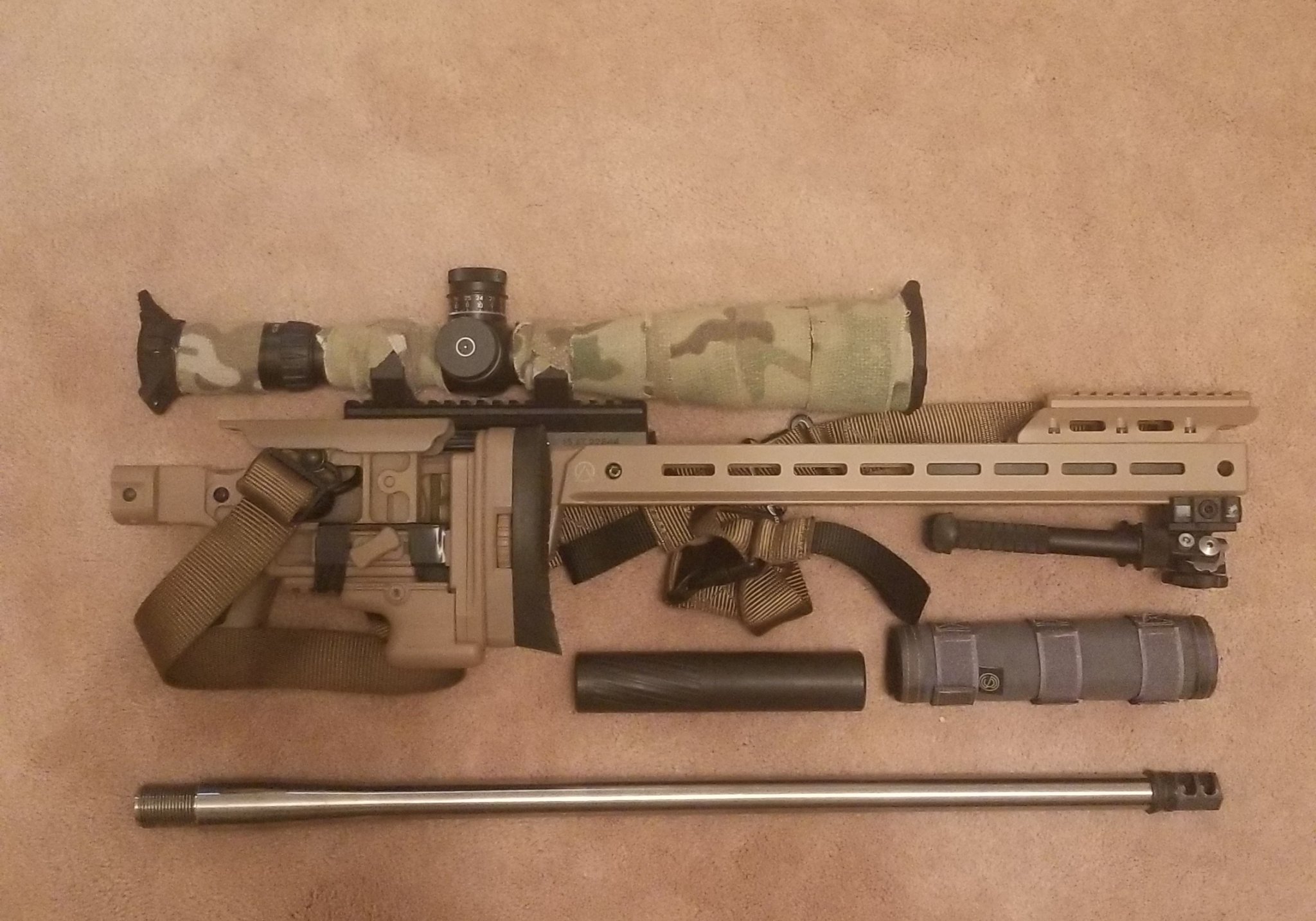

Does anyone know the going rate of an AT folding chassis? I might as well sell mine since I’ll never use it again.
The AT folding stock is worth about the same whether or not the factory chassis is attached to it. On any given day call it $250 - $350. The only reason anyone would buy the whole AT chassis is if they bought an AT-MPA that didn’t have the original chassis and wanted to swap it back.
A couple years ago I started this whole project by buying a stripped factory chassis with a fixed stock, and I think I paid like $200 or $250.

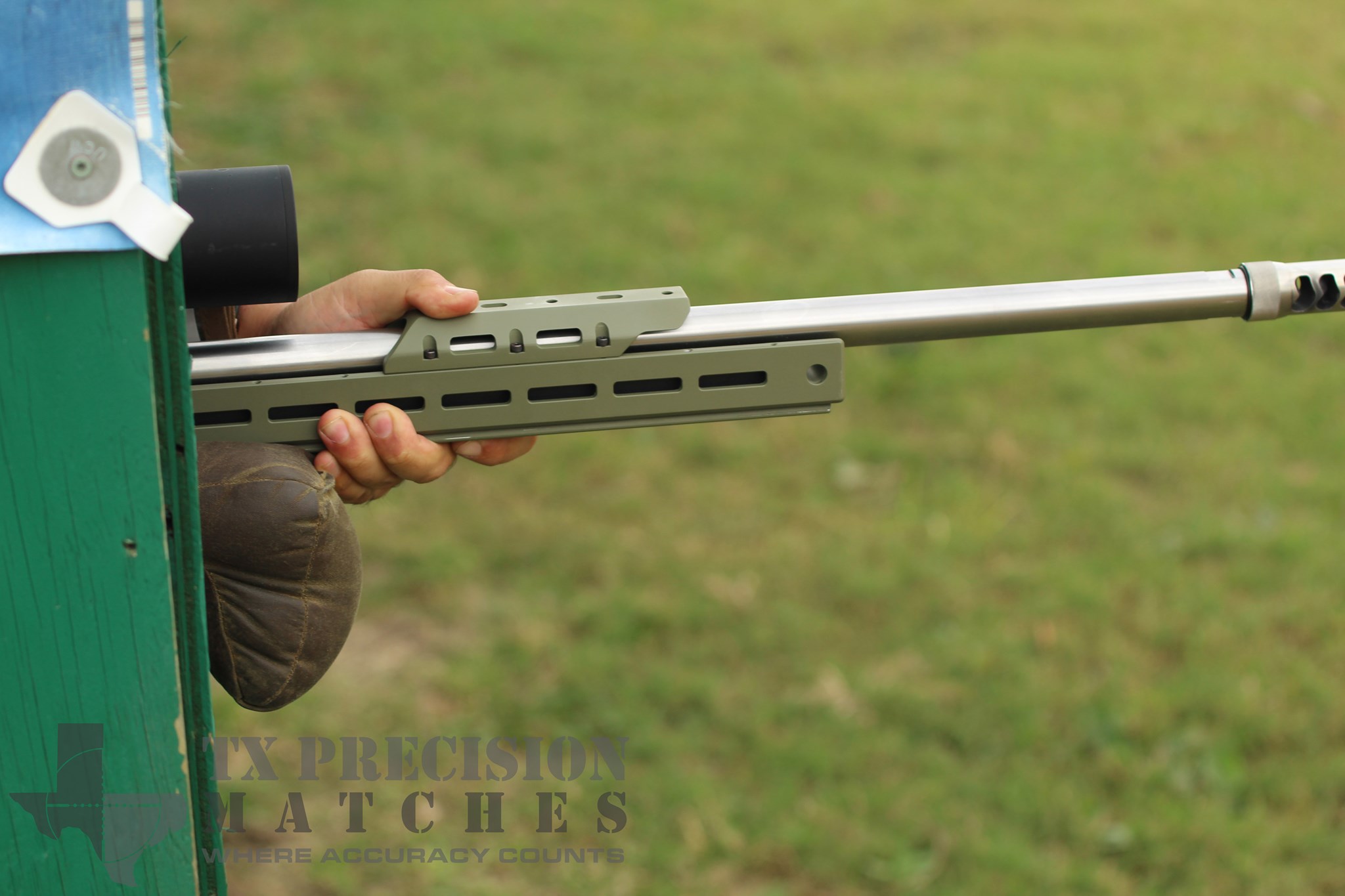

Sam, this chassis is awesome. It was great to take out the AT/AO for its maiden voyage.
Thanks to Cory K for taking some sweet photos yesterday--if you're out there---creepily reading snipershide.

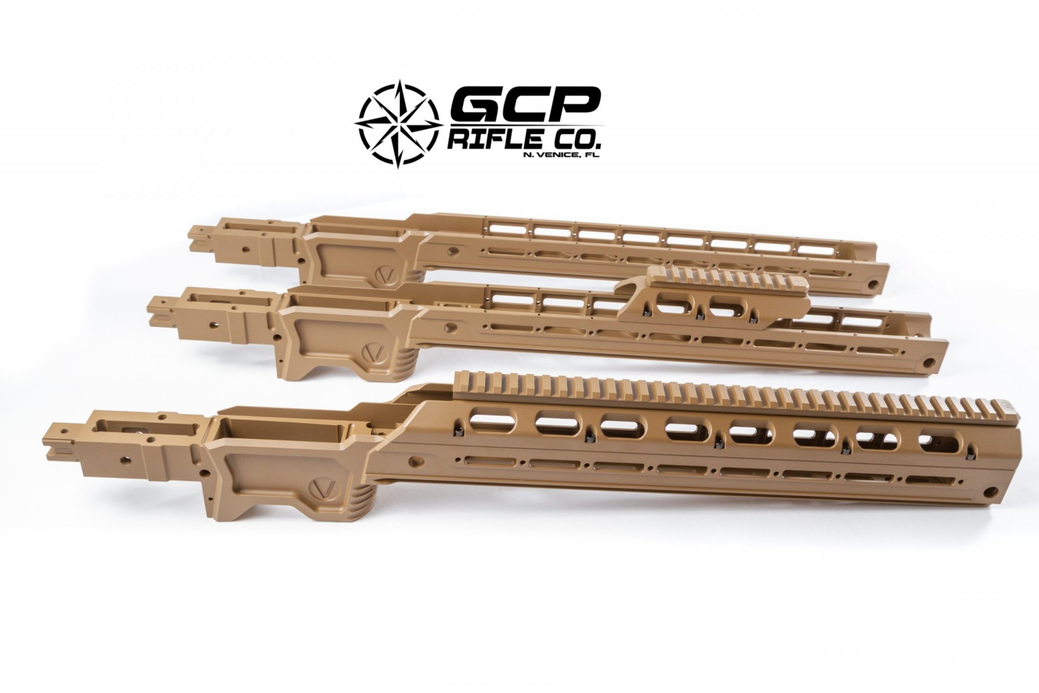

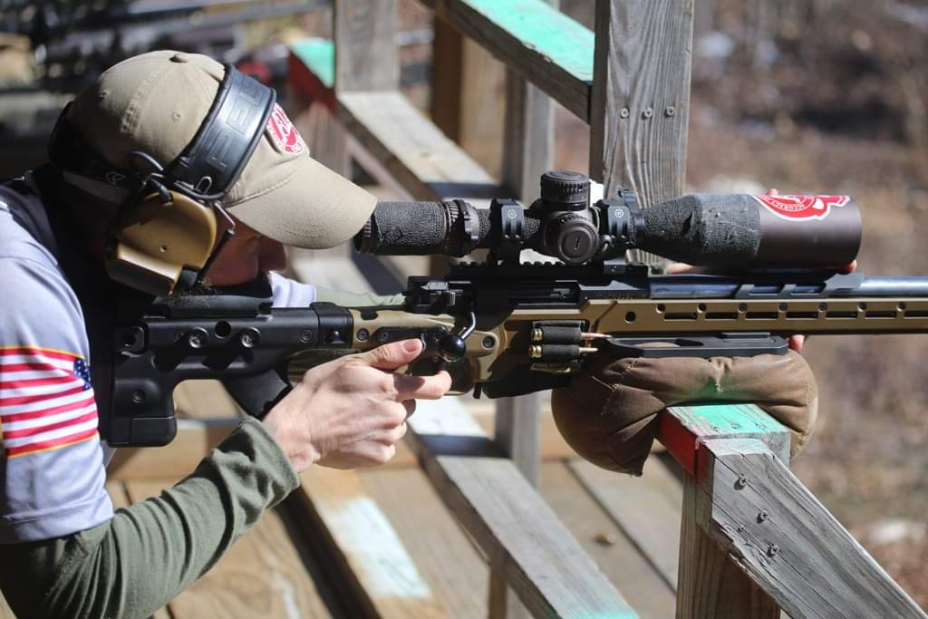

The NV mount was designed to have the picatinny rail co-planar with the "tall" 20MOA action rail. That means if you want to run NV, you will want to set it up just like a factory AX: tall action rail + 1.5" scope mount.
If you are using the NV rail for a forward support-hand thumb rest, then you can position it in front of the objective and run it slammed with a low rail and low rings.
If you want to run the objective on top of the NV bridge, but without the pic rail, then I would recommend either the low rail+ tall rings, or the tall rail+low rings. That's basically how I have it setup, tall rail + 1.18" Spuhr.

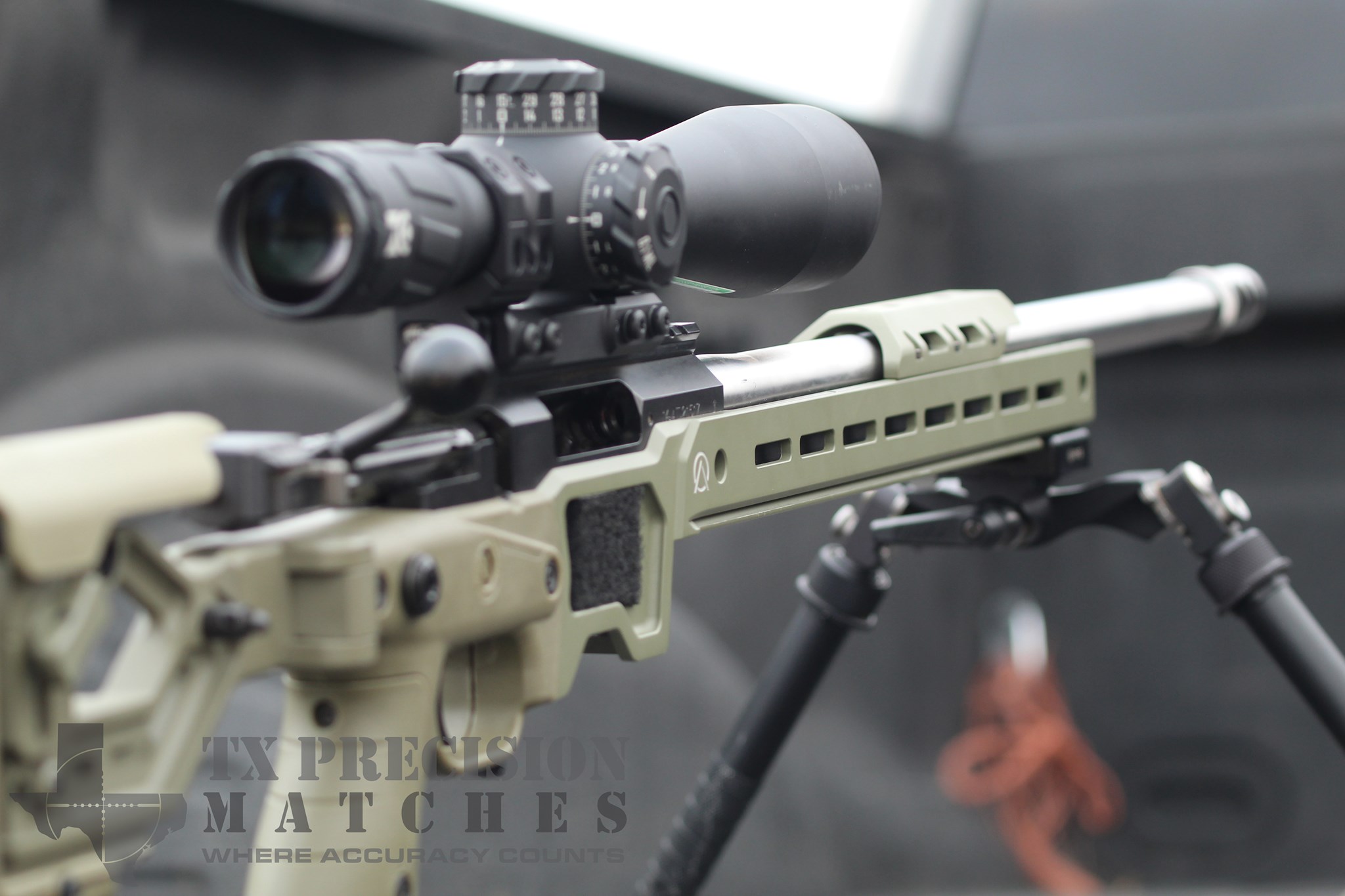

Looks like the non enclosed is the way to go even running a night vision clip on. Should let the barrel cool quicker with no downsides
Am I missing anything ?
is the rail adjustable back and forth ?
enclosed does look cooler

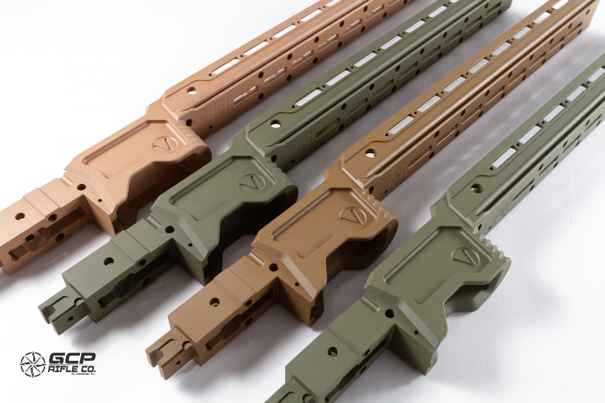

$799
Yup, you read that right. GCP Rifle Co has the AO/V chassis IN STOCK and ready to ship, cerakoted in your color of choice, for $799. Additional options include:
- Short NV bridge
- Full length enclosed NV bridge
- 20MOA pic rails for either length bridge
- Internal/external weights
- Full de-bond and re-bond by Rick at GCP
- Custom cerakote colors and patterns
If you're even remotely on the fence about upgrading your AW, AT, or AX, you're sick of waiting for other options, or you're looking to take your current AI rifle to the next level for competitions, don't hesitate to call Rick at 440-213-5585. We will get you taken care of for whatever project you're able to dream up!

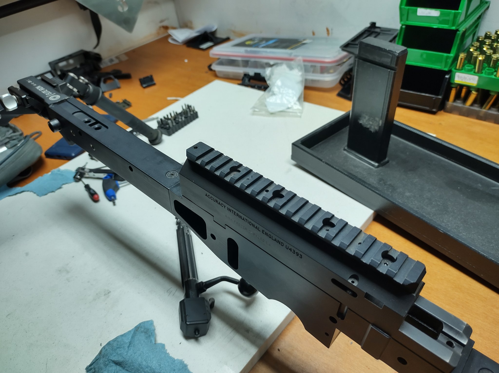

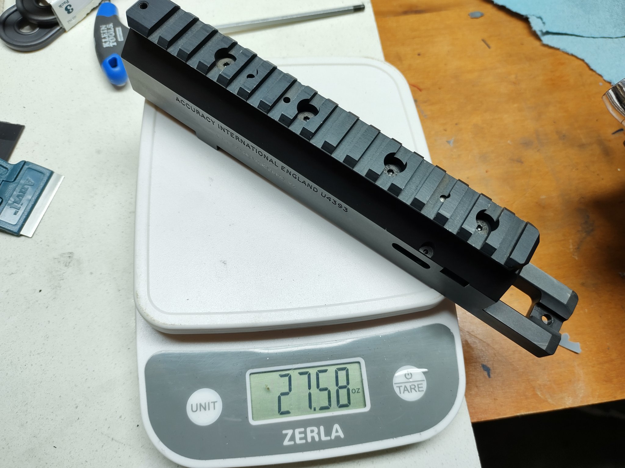

I believe the ~32oz weight is the bare AO/V chassis, add about 5 oz for the short NV bridge.
The bare AT chassis is 28oz, add ~4oz for the skins, add ~7oz for the NV bridge, then add a few more ounces for a bolt-on Arca/RRS rail on the bottom of the forend.
The AX chassis w/RRS auxiliary plate and top picatinny forend rail = 40.6 oz (this does not include a full-length Arca/RRS rail on the bottom of the forend tube)
Any other questions, let me know!

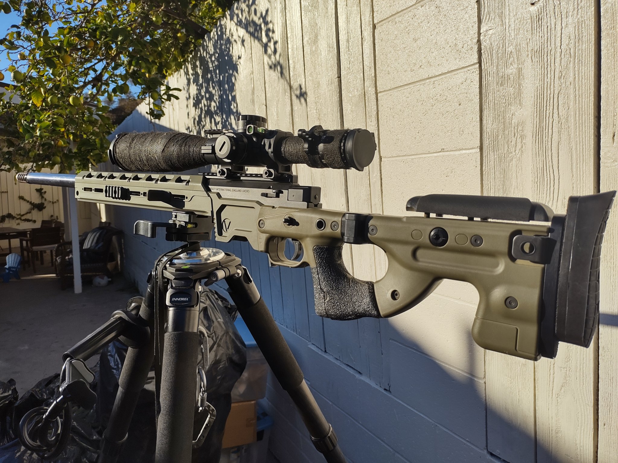

I did it, before going with an AX rear.
So my only gripe with an AO rifle right now is the AX buttstuck seems so heavy for no reason, entailing a decent amount of weight up front to counterbalance. The new AT-X buttstock looks nice and light.

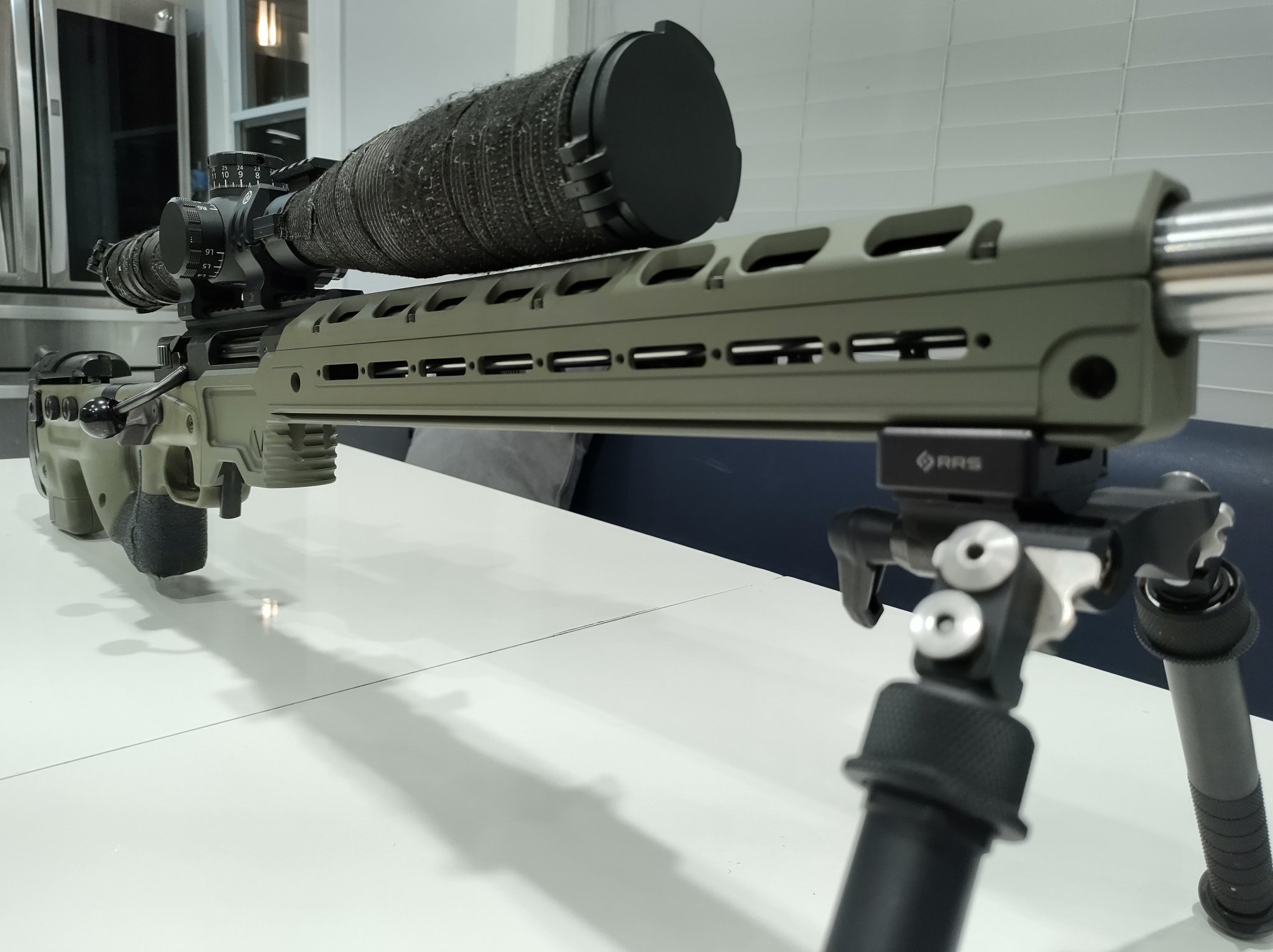

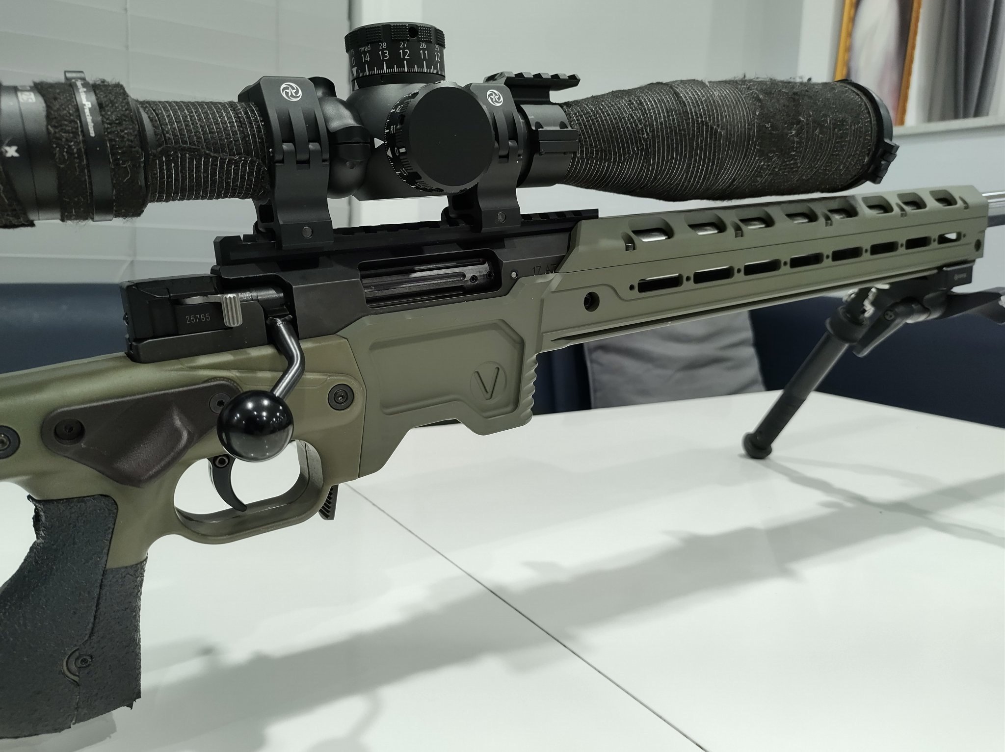

With the OG AO chassis, I'm running the full internal weight, mostly because Sam said it does a pretty good job of stiffening up that long forend... With a 24" MTU I'm something in the neighborhood of 22 lbs with bipod & all... A little bit heavier than I'd probably like, but she's a pleasure to shoot.
Not sure what the deal is with the Vision chassis, seems like somewhere I read that it's a lĂ  carte & you just order the pieces you want... If that's the case, I'd go full internal weight.

The Vision weights can also be installed internally. They are secured using the screw holes through the bottom of the chassis. I think you can fit up to four spaced out under the barrel.
I ended up machining a full length internal weight from brass. I prefer the solid internal weight.
