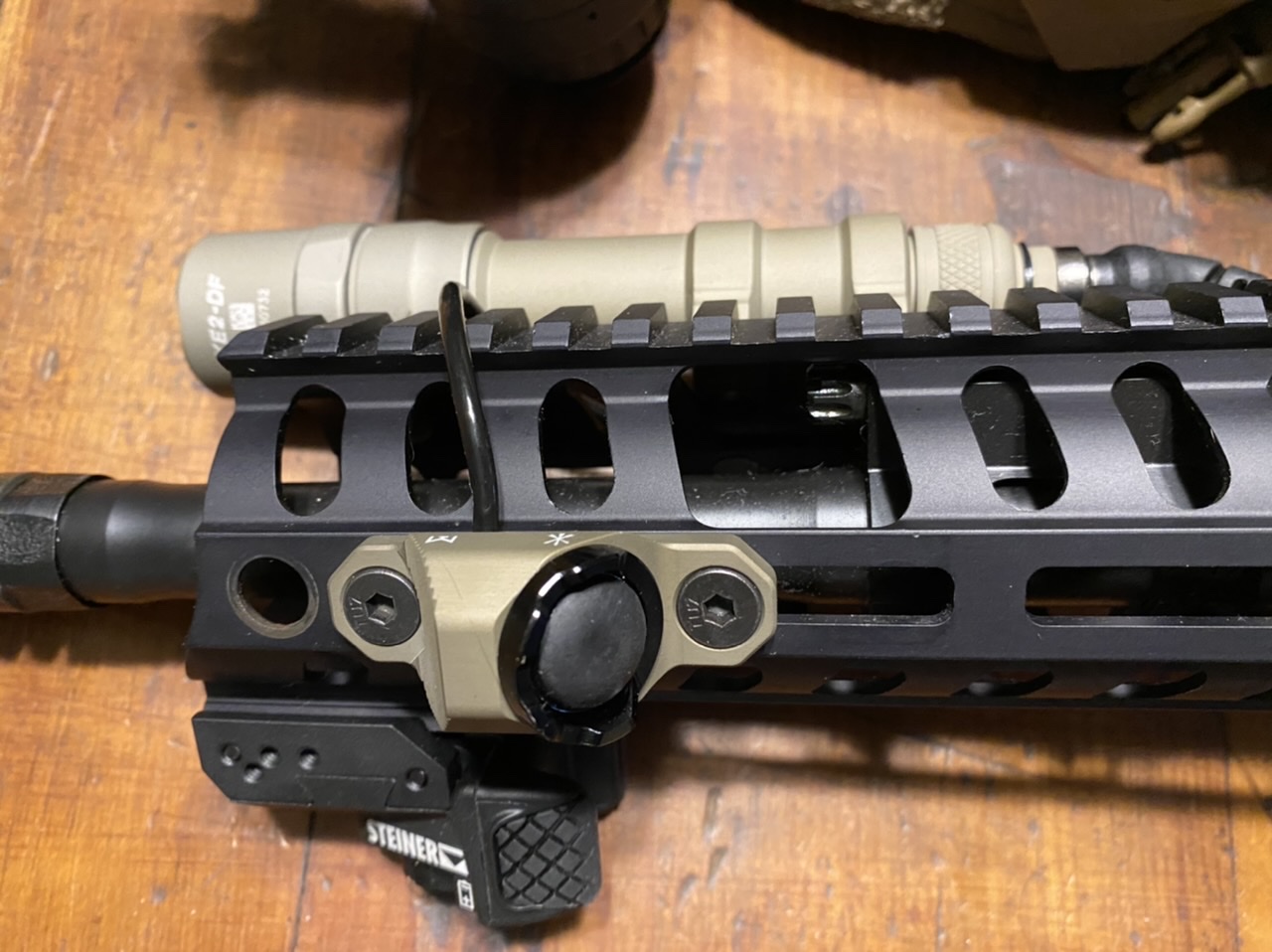

Get a dedicated IR/Vis laser plus a SF Vampire. This will give you ALL lighting options and will be stupid light and compact. You’ll have visible light and super-bright IR illumination plus slaved IR/Vis lasers on a single pressure switch.
Best of all worlds — light, compact, cheap (at or under $1K total), legal, supported/warranty.
For ultra lightweight I run this and it works great.
What is this setup?
