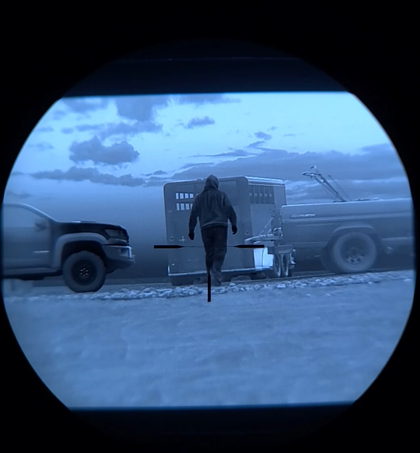

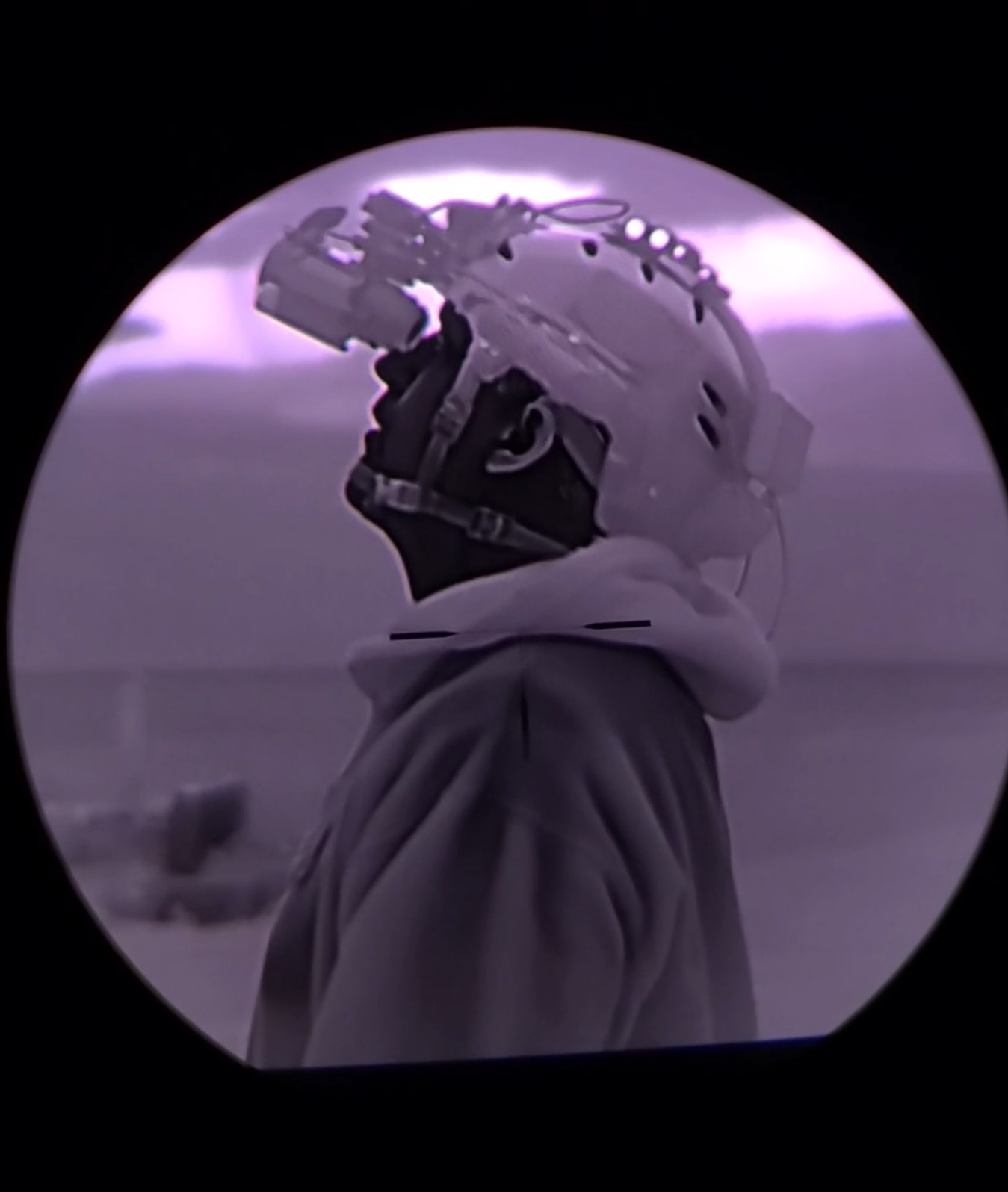

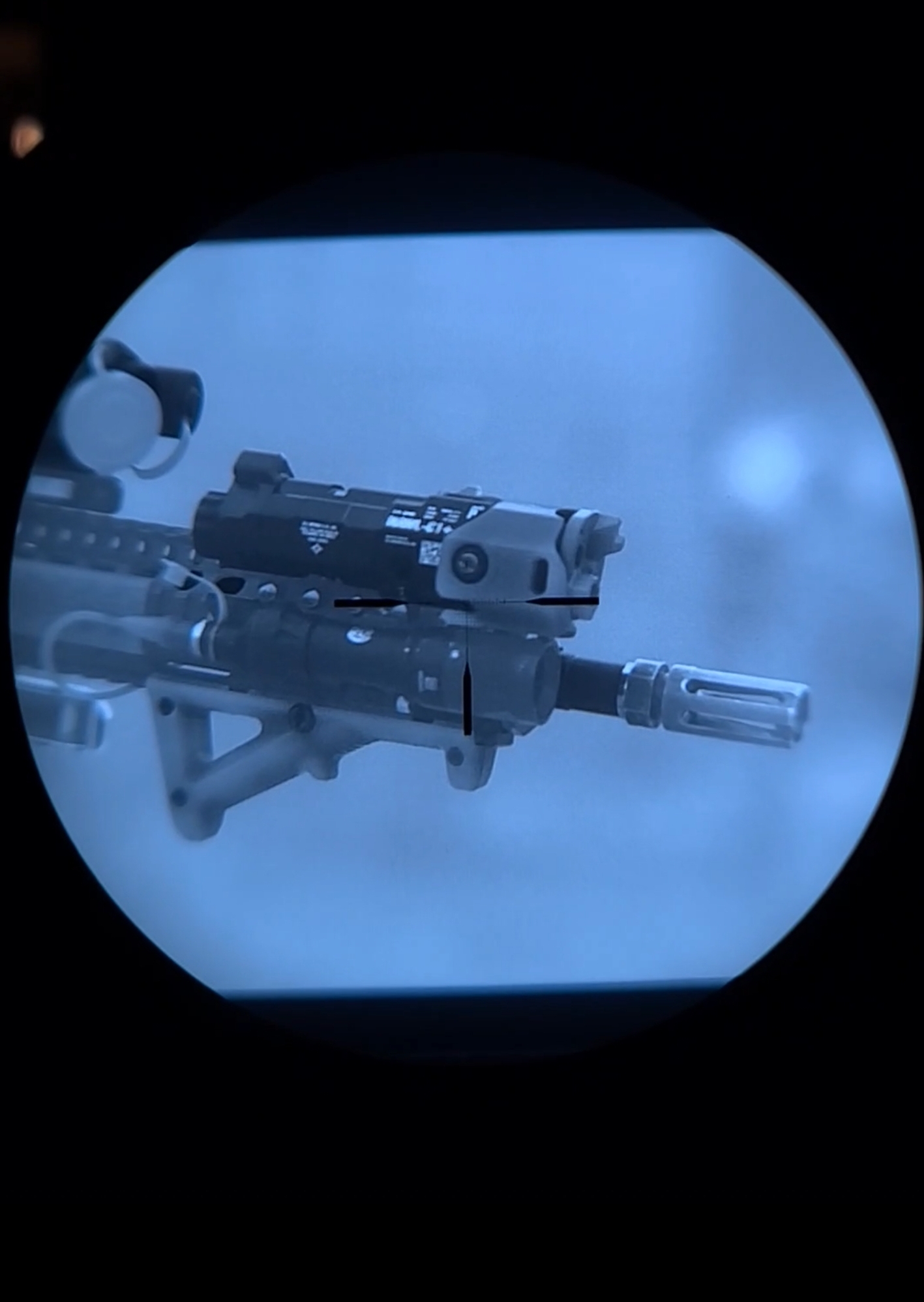

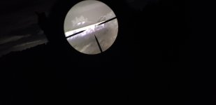

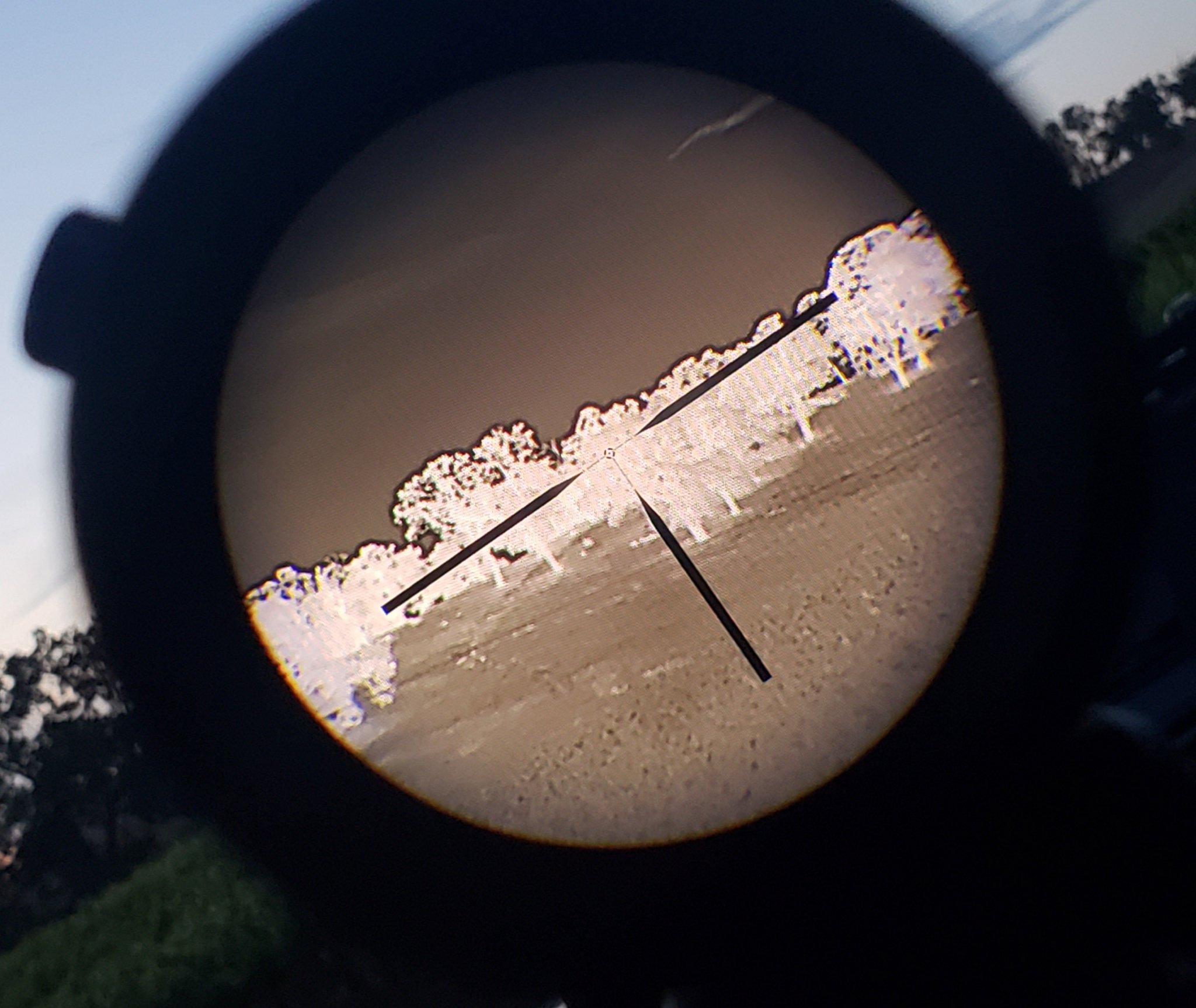

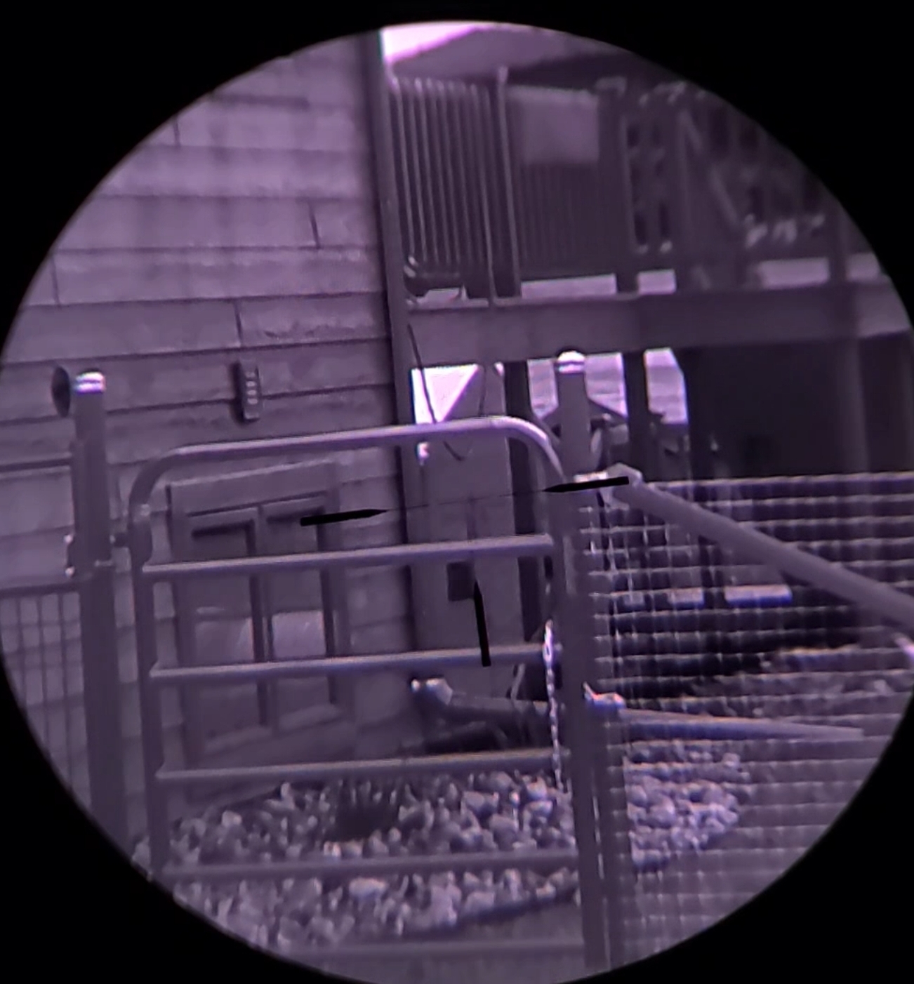

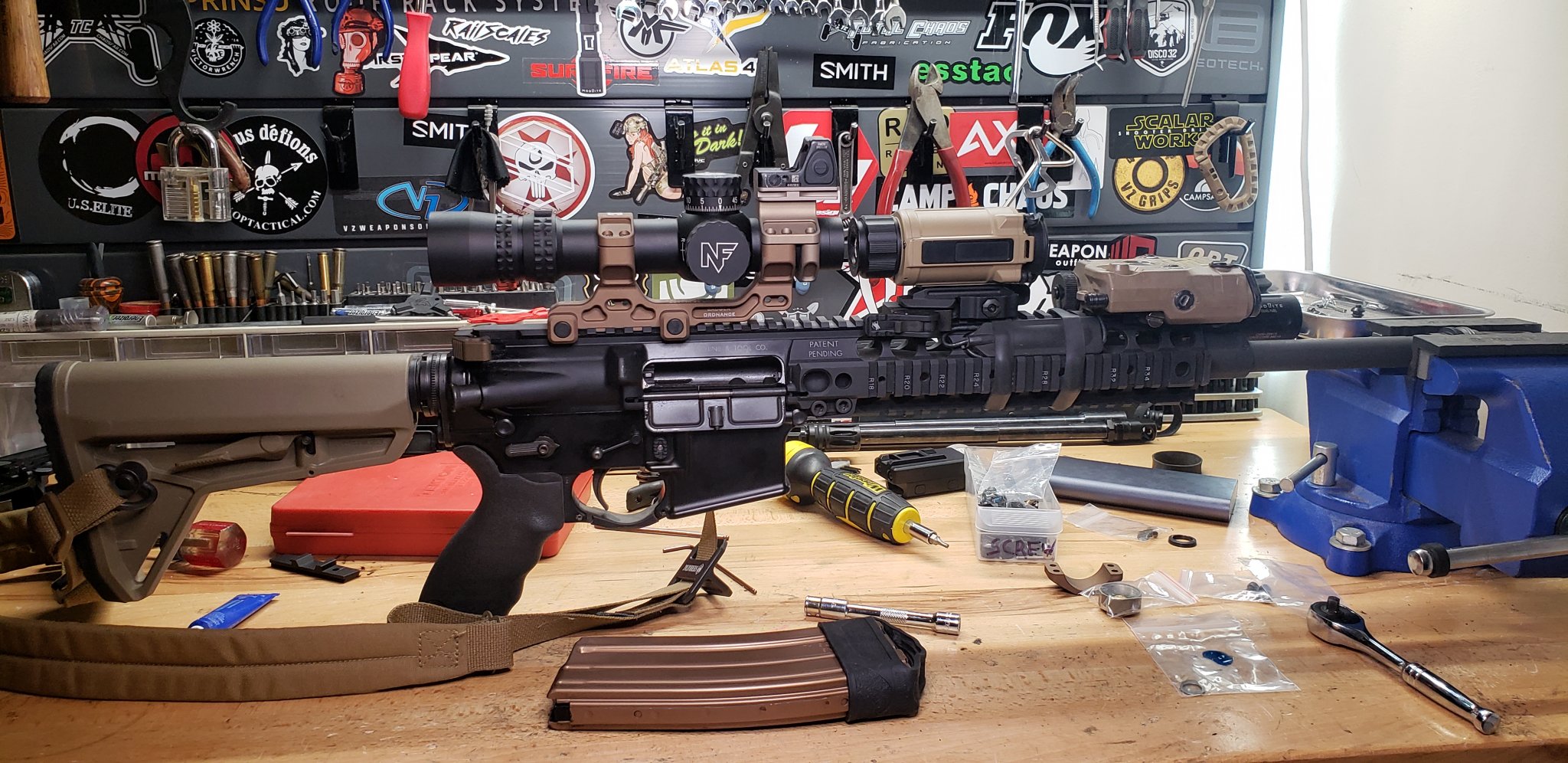

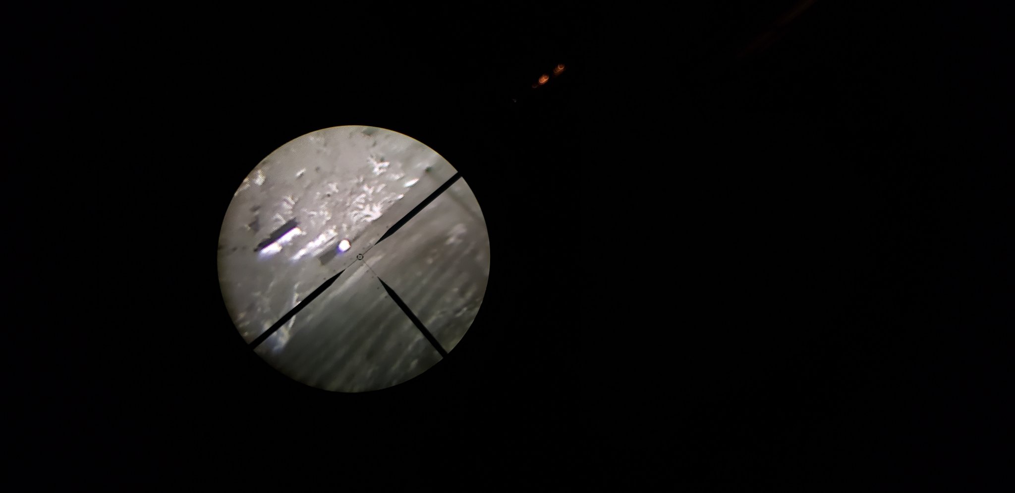

I am going to try and mount my gopro to the buffer tube for some better pictures, through the optic with a cellphone camera is not easy.

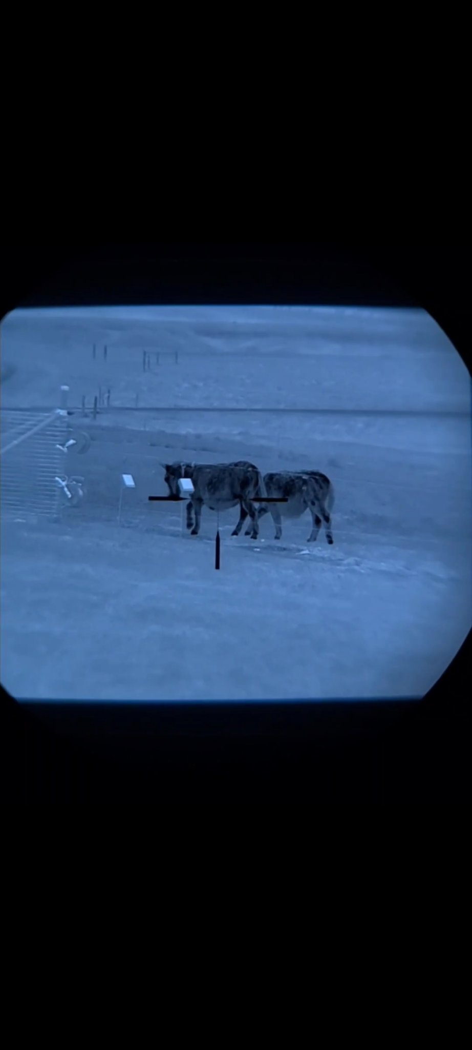

The house is about 250 yards 2x 4x 8x. The dog is up close on 1x, that hot blob is a cow eating (head down) at 600 yards. Image quality is alright, I was able to follow a rabbit at 300 yards and see its ears and hind legs as it moves.

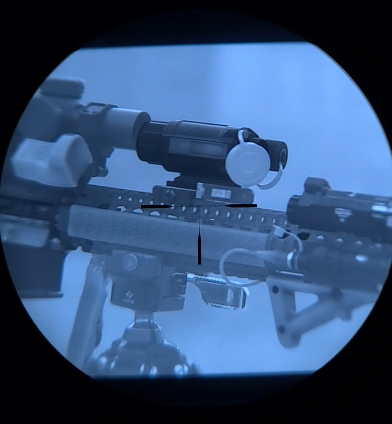

Couple of tech questions I can’t seem to find online and an observation... (I’m an opto-mechanical engineer, by trade)
1) how many “zero profiles” does the RH25 have? Do the zero profiles allow for setting it up for some rifles in clip-on mode or other on standalone mode? How does that work?
B) Is there a manual available for download?
iii) I noticed the factory mount has recoil/acceleration reducing features and the RH25 is rated to .300WM ... clever (I always thought someone should make linearly damped optic mounts for abusive weapons like the SCAR.) However this raises a host of questions, because most aren’t using it... wouldn’t our use of the ADM mount and pictail remove these recoil mitigating features and thusly necessitate a caliber derating? (ie: Was the weapon endurance tested & approved with the dampened mount or the pictail mount?) Does the use of a rigid mount on a weapon void warranty in any way? Perhaps the use of the pictail mount is the reason users see the screen flickering during recoil mentioned earlier this thread. I can’t imagine that’s typical or acceptable behavior on a unit approved for production... I’ve never noticed it on Yoters. Which is doubly confusing because I’d assume they share the same infiray micro II core and are rigid mounted.

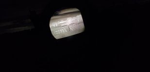

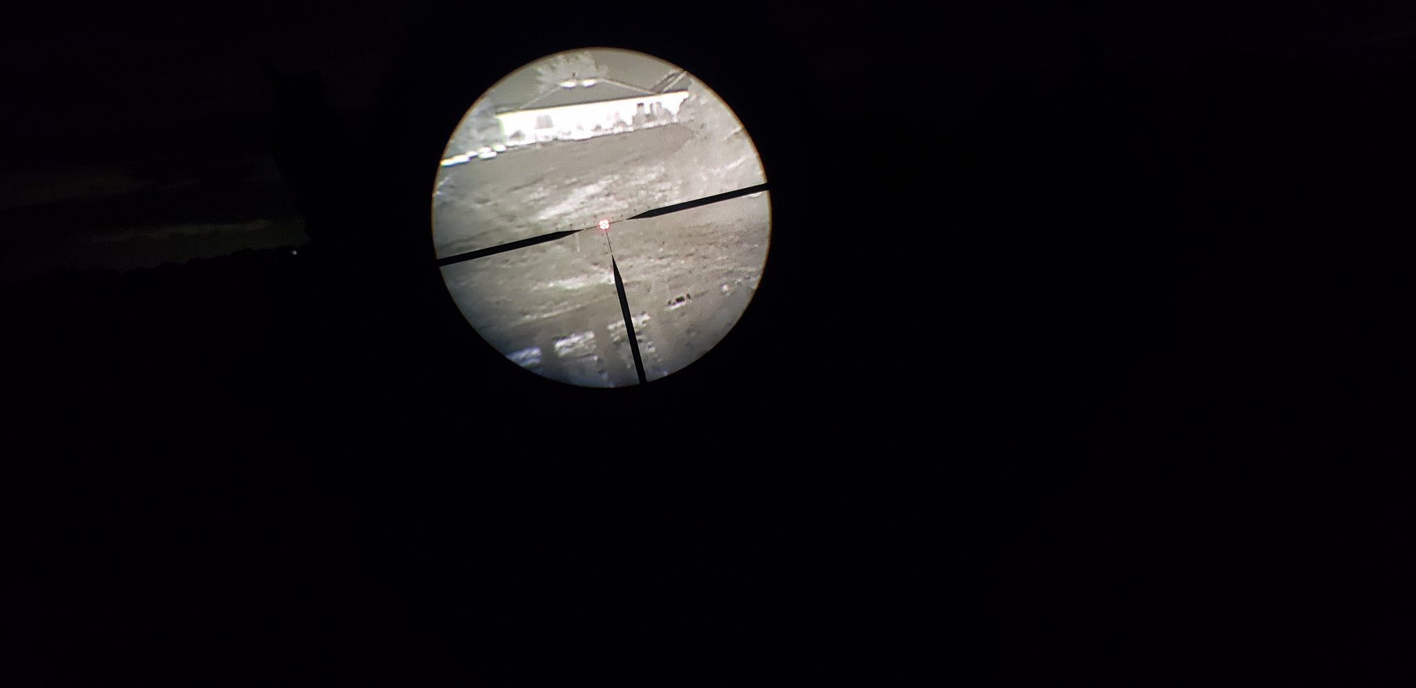

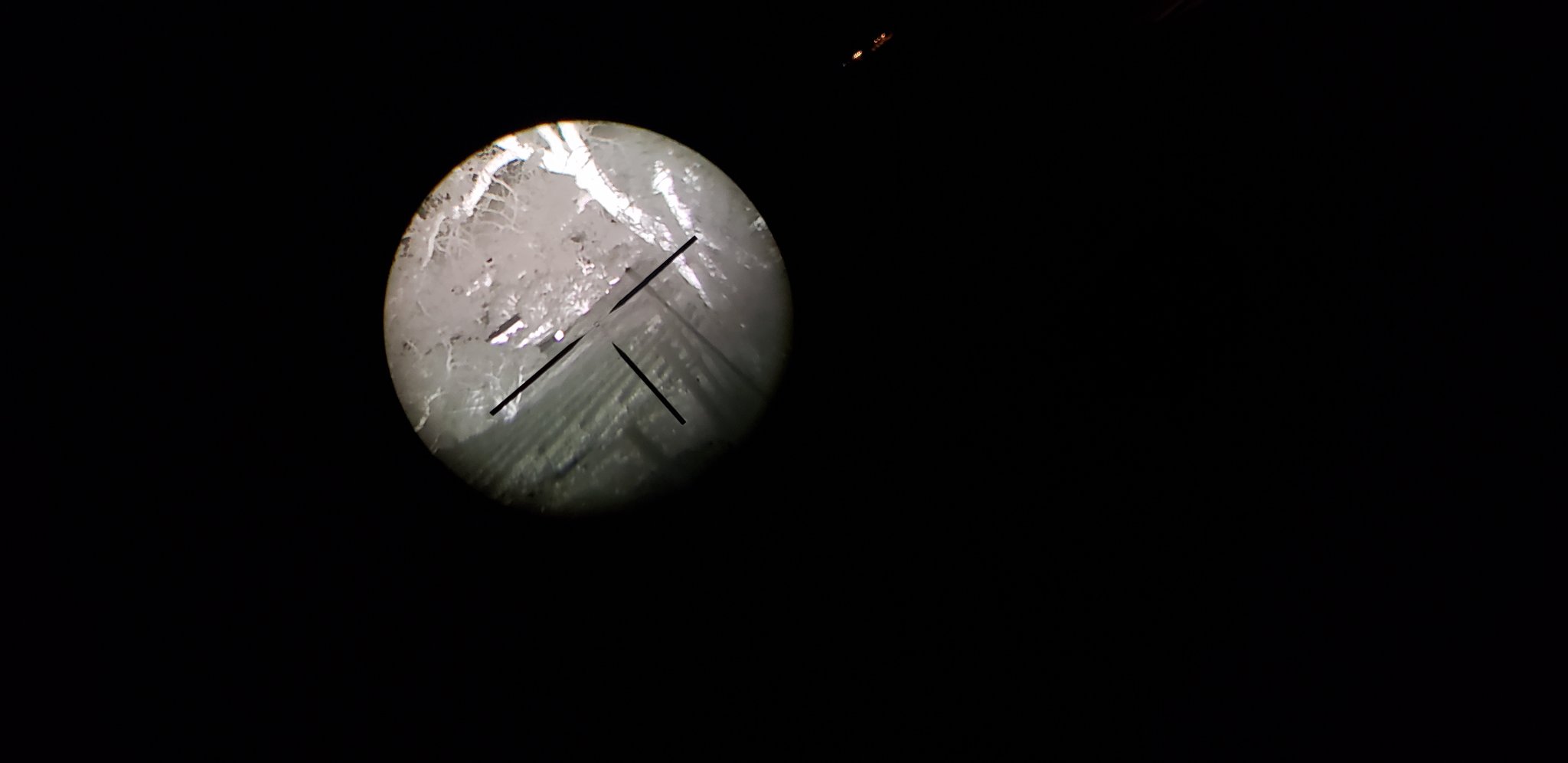

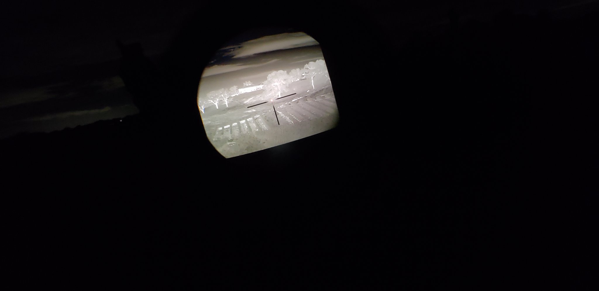

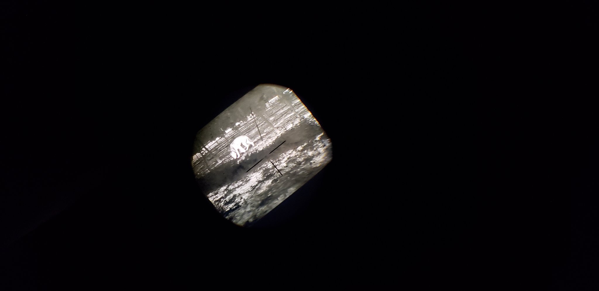

I haven't had much time to take pictures, and I suck at getting a accurate representation of what it looks like but here's a few more:
Top of the hill is 470 yards, 2x & 4x.
Here is the sections of the manual that talk about your questions. I haven't messed around with zero profiles, this unit will be used mainly as a scanner and clip-on for one rifle for me.

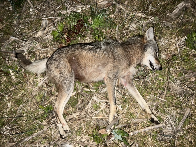

Nailed a yote at 150 yards with it later that night handheld/standing.

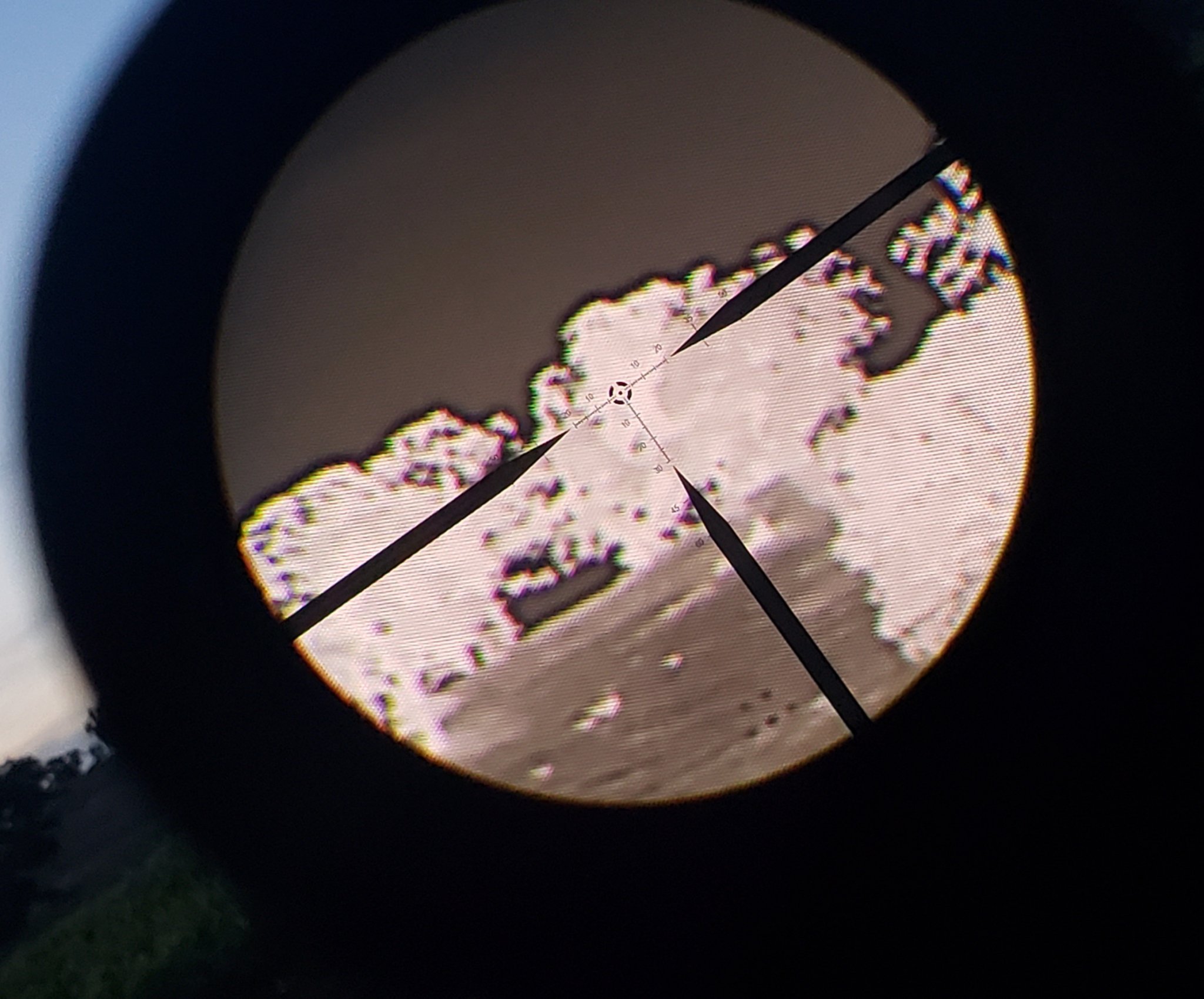

Taken just now.
I adjusted my RH25 focus to the point where there was zero parallax on my day scope when moving my head around. It was REAL close to the factory dot mark on the focus piece... like 1-2 mm left of it. I did this with the RH25 objective focuses at infinity and my LPVO at 6x.

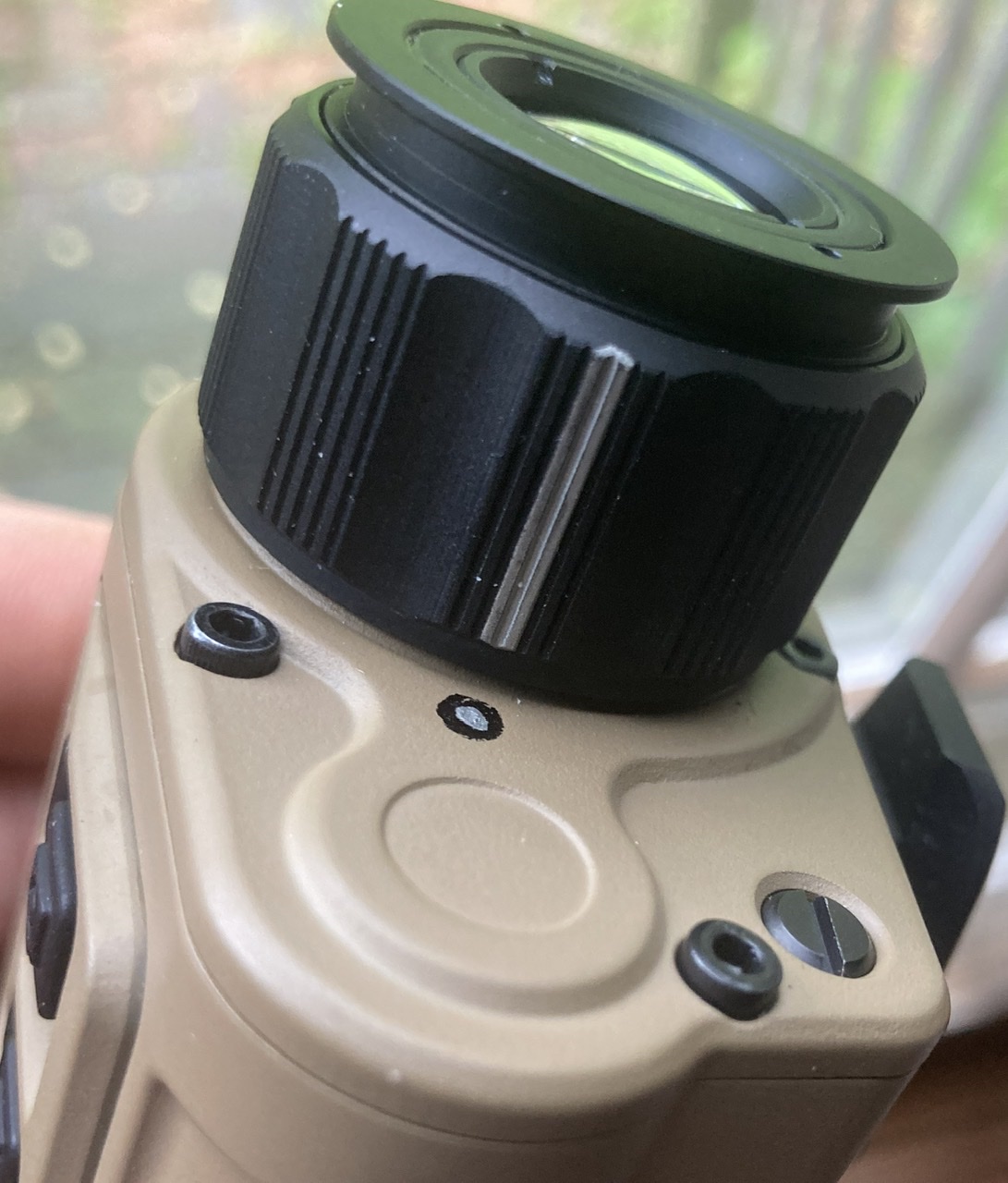

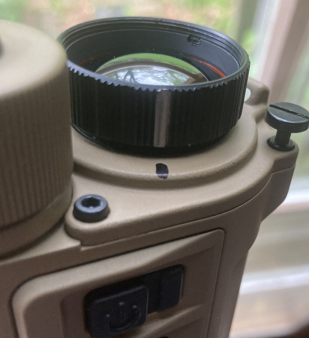

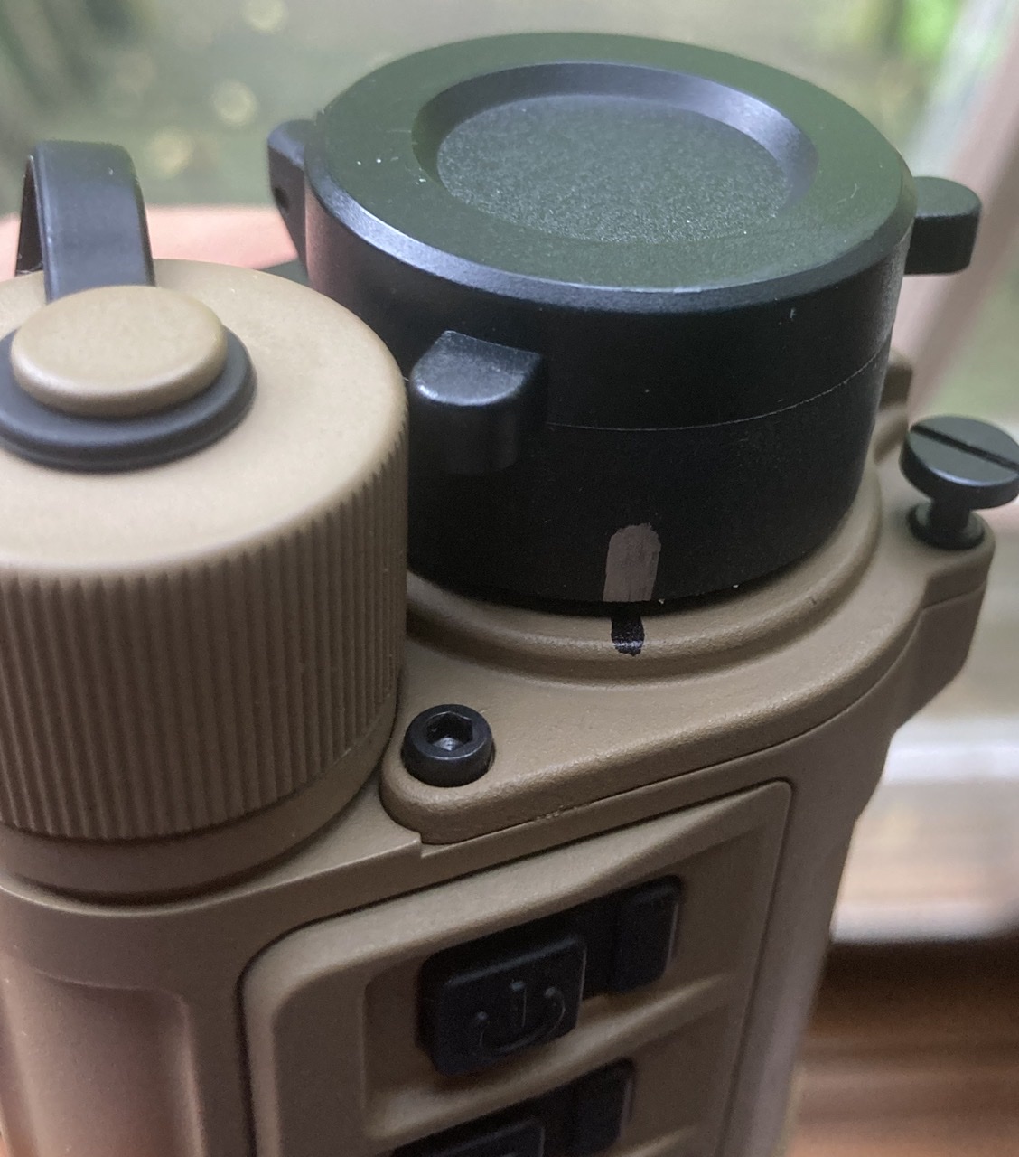

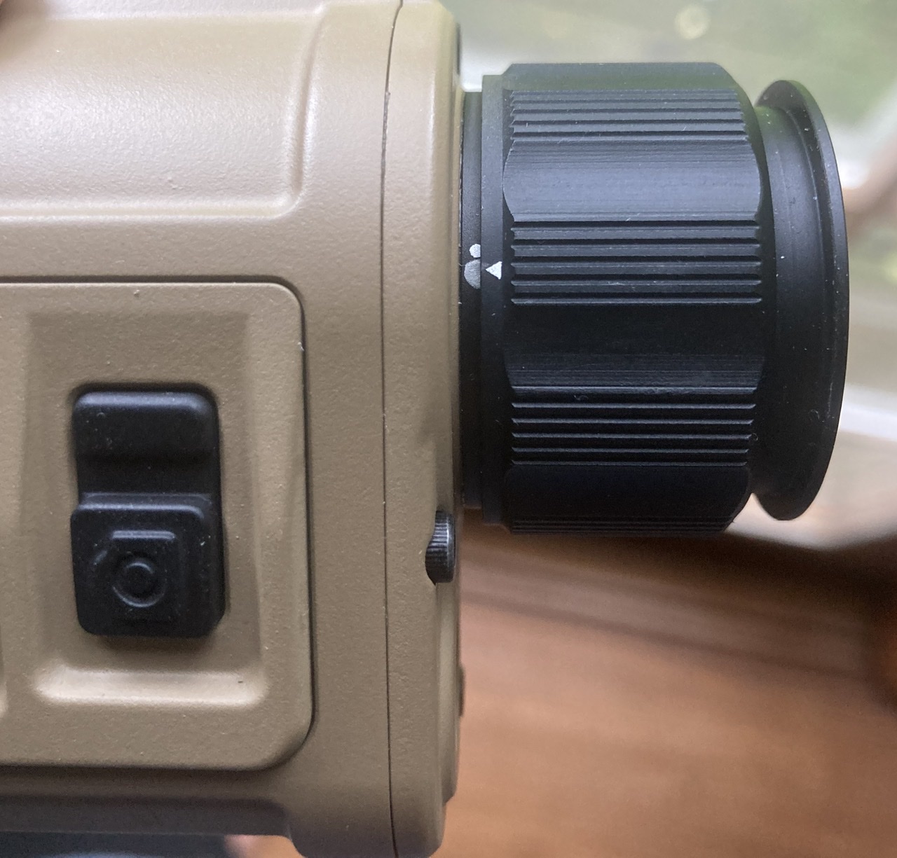

Looking through a day optic in clip-on mode, it seems like the RH25 ocular focus is WAY more sensitive/important than the RH25 objective focus or the LPVO eye focus. Being just a hair off on the RH25 ocular get noticeable real quick on 4x-6x and there’s also noticeable parallax moving your head around.
Standalone is pretty forgiving because the reticle is baked into the projected screen image (there is no head position parallax) and your eye will naturally sharpen up slight misfocus.
I went ahead and used silver/black sharpie to put a new dot for the LPVO Diopter setting and my eye’s diopter setting as well as the objective’s infinite focus point (and on the flip-cap too). So before ever turning it on, I can dial in the optics where they need to be instead of fiddling with it while looking through a scope.
I mark all my scopes/PVS14s this way. Easy and non permanent with a little rubbing alcohol.

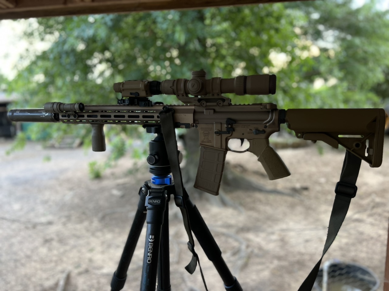

So… I have twin RH-25’s and have used both helmet-mounted, but only one of them on a rifle. I took the other one out today while doing a POI shift comparison with the new Steiner C35, Voodoo-S, SkeetIR-x, UTM-x, TigIR-6M, and UTC-Xii.
Mounted Unit #2, everything looked good, Clipon Mode engaged, popped off a round, unit shuts off. I’ve seen this with other thermals before and it was usually a not-fully-tightened battery compartment, so I go to tighten it, but it won’t go any tighter. Turn it back on, pop-off another round, unit turns off again. Swap batteries, check tightness. Check mount. Not too close scope, all looks good. Turns off again. :cry:
This was on a suppressed Geissele 16” DDC in 5.56, so nothing out of the ordinary.
Anyone else having this issue?

Measure the length of your batteries. My Nvision did that and it was due to the shorter length 18650s

Prob be good to tell us what batteries you're using, just so folks can keep track. And which of the two included caps you're running. And how many shots have you taken with the RH25, ever? I probably only have 20 rounds downrange with mine at the moment.
Reactions: TheHorta
Was using Orbtronic 18650’s tonight. NOT the included Nightcore.

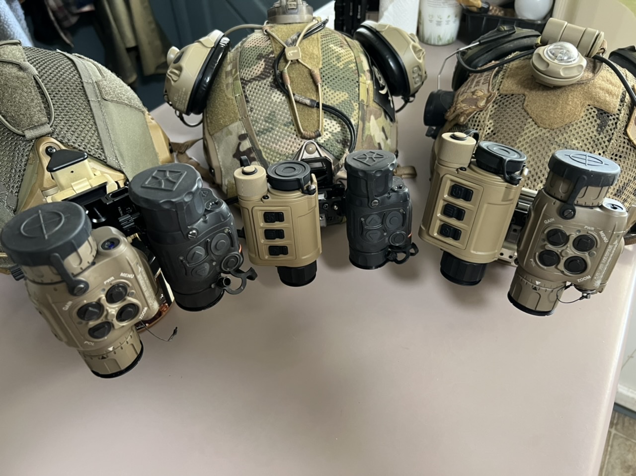

I bought two of these from Jay at Sureshot. yes, I’m running two thermals on a helmet—these coyotes aren’t going to shoot themselves. The units themselves are impressive. But Jay’s customer service was even more so. At one point, iRay was a bit later than expected in shipping Jay the mounting hardware. He offered to send me the parts off of his own personal gun and optic (wasn’t necessary but the gesture was much appreciated).
I’ll be a repeat customer for sure.
If I was running dual HMT, I’d figure out how to pan them apart 15-20 degrees so I got a 35-40 deg wide field of view.
I can’t imagine dual colimated thermals really helps all that much with depth perception given it’s very limited resolution. But the FOV advantage could be significant. It would mesh well too, I’d imagine.

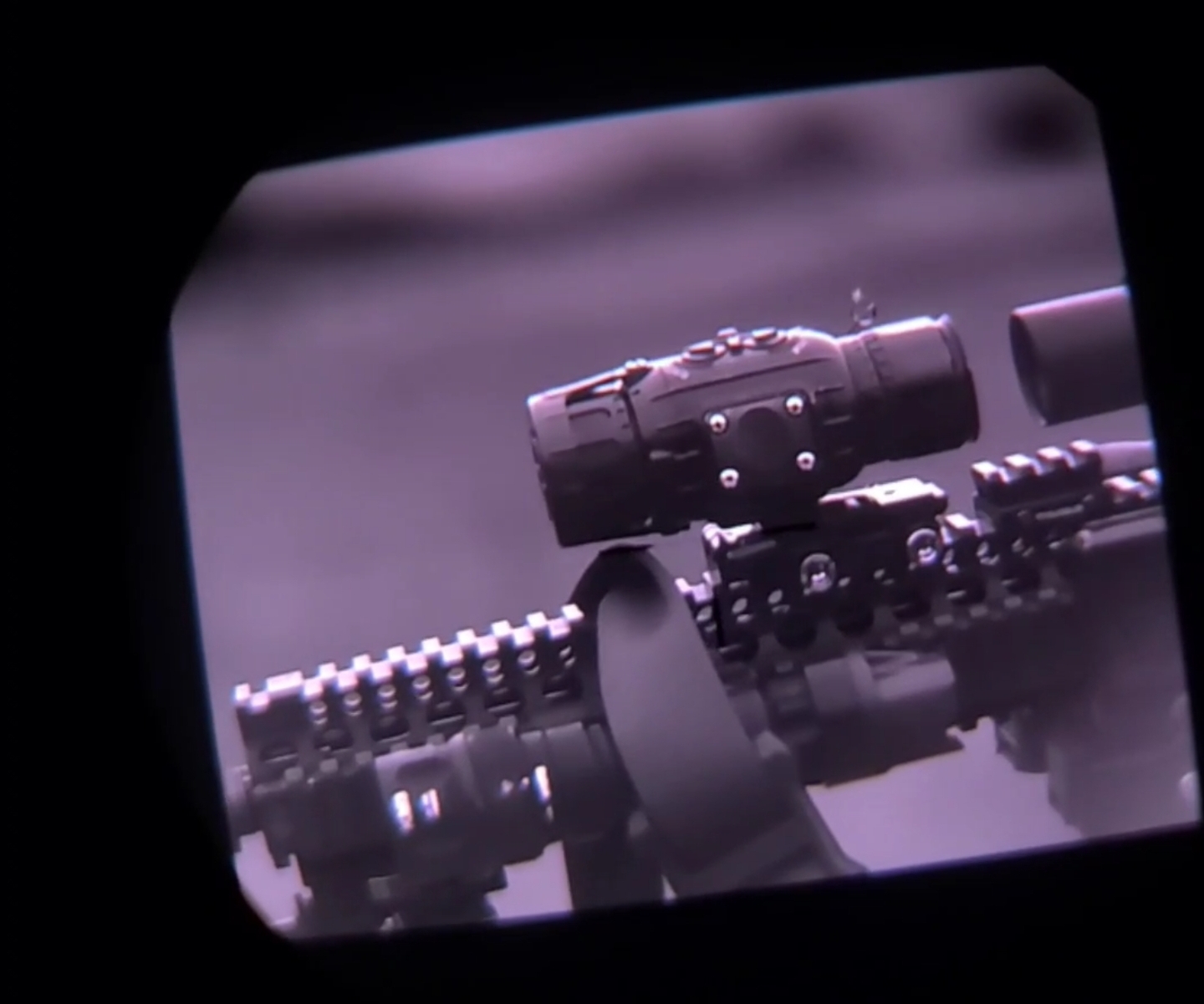

I just can’t seem to get this to mesh with my PVS-14. It’s close-ish. But odd at the same time. I tried a Wilcox Dual Bridge (clone) on a G24 and Rhino2 mount... so adjustability isn’t the issue. Now if I do the 1000-yard-stare, the PVS14 and RH25 images line up decently for objects about 10-20ft away... but things closer that or further than that don’t line up. And no matter how googly-eyed I go I can’t get images to line up at any long distance. Especially if I stare with my eyes converging at the proper distance, nothing ever lines up and it’s pretty far off. Unusably misaligned; like maybe 8ft offsets for objects 25yd away.
I think it’s because PVS14 eyepieces and this thing are so different (as opposed to an MH25+PVS14 eyepiece).
