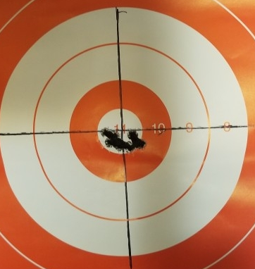

Bullet: .224” Hornady 75gr ELD Match #22791
Powder: 27.0 gr. Hodgdon CFE 223 (23.9 – 27.5) Tested OK. Very Accurate. No case damage. Slightly Dirty.
26.5 gr. Hodgdon H380 ball powder. 24.0 – 29.0 Tested OK. Not as accurate as CFE 223. No case damage. EXTREMELY DIRTY!
Target is 10 rds, 25 yards. I'm 77, so I shake a bit. A younger guy could do a lot better!
25y groups on snipershide. 🤣🤣🤣
1" @ 25y is 4 MOA.
1: It was 10 rounds leaning. The 25 yard range is the only range reasonably close, so I use what is available.
2. I was trying to help the previous poster. I reload every caliber I own except 22 and 32 rimfire.
3. Yes, I am 77, and I shoot every gun I build. All but one of my ARs are 80 percenters. I am currently welding up a CETME-C. and a PM-63 RAK.
4. One of the posters is very good at math and measuring. Not so much on class or tact.
5. Funny, I think it was one of the guys that tried to push me off of snipershide a few months ago because they were sure I was a fed because I didn't have many posts. :ROFLMAO: I was trying to help members just getting started in converting 6.5 Creedmoor brass to 8.6 Blk.
6. To the posters using encouragement, THANK YOU! Happy New Year! To the ones throwing shade - Get over yourselves. If you're not having fun, try a new hobby!
