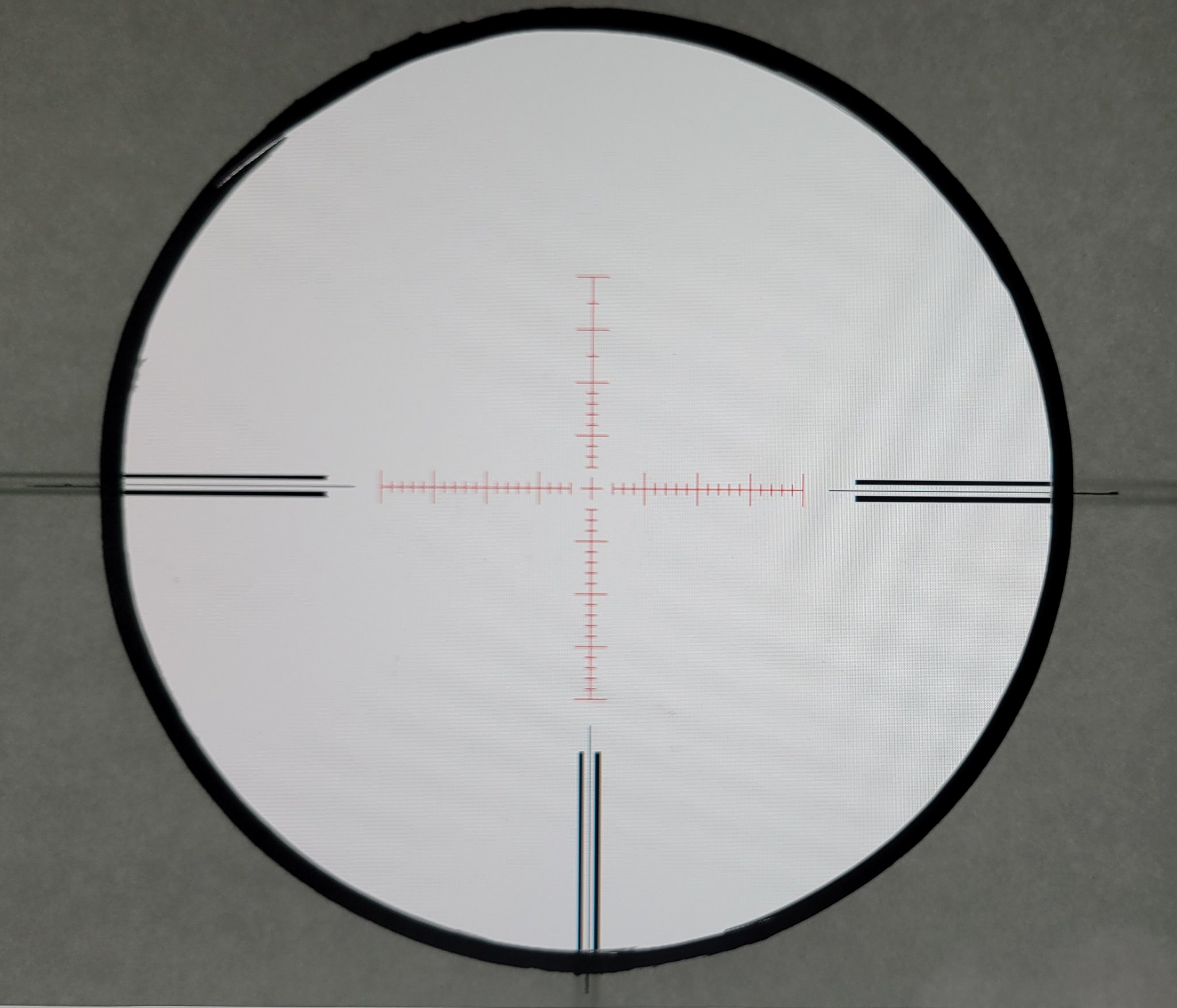

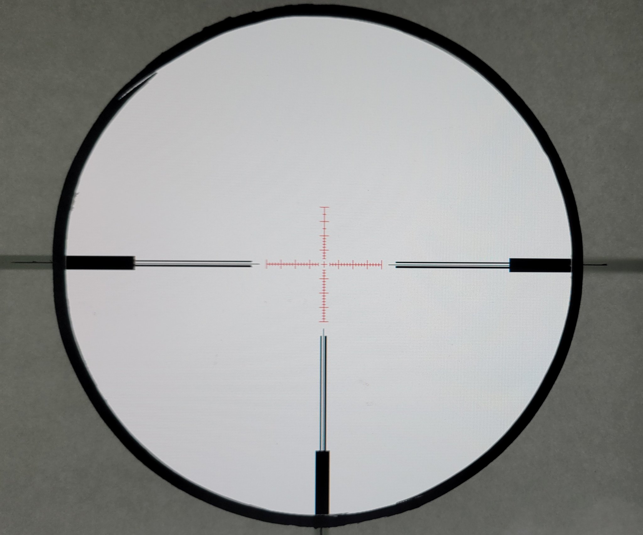

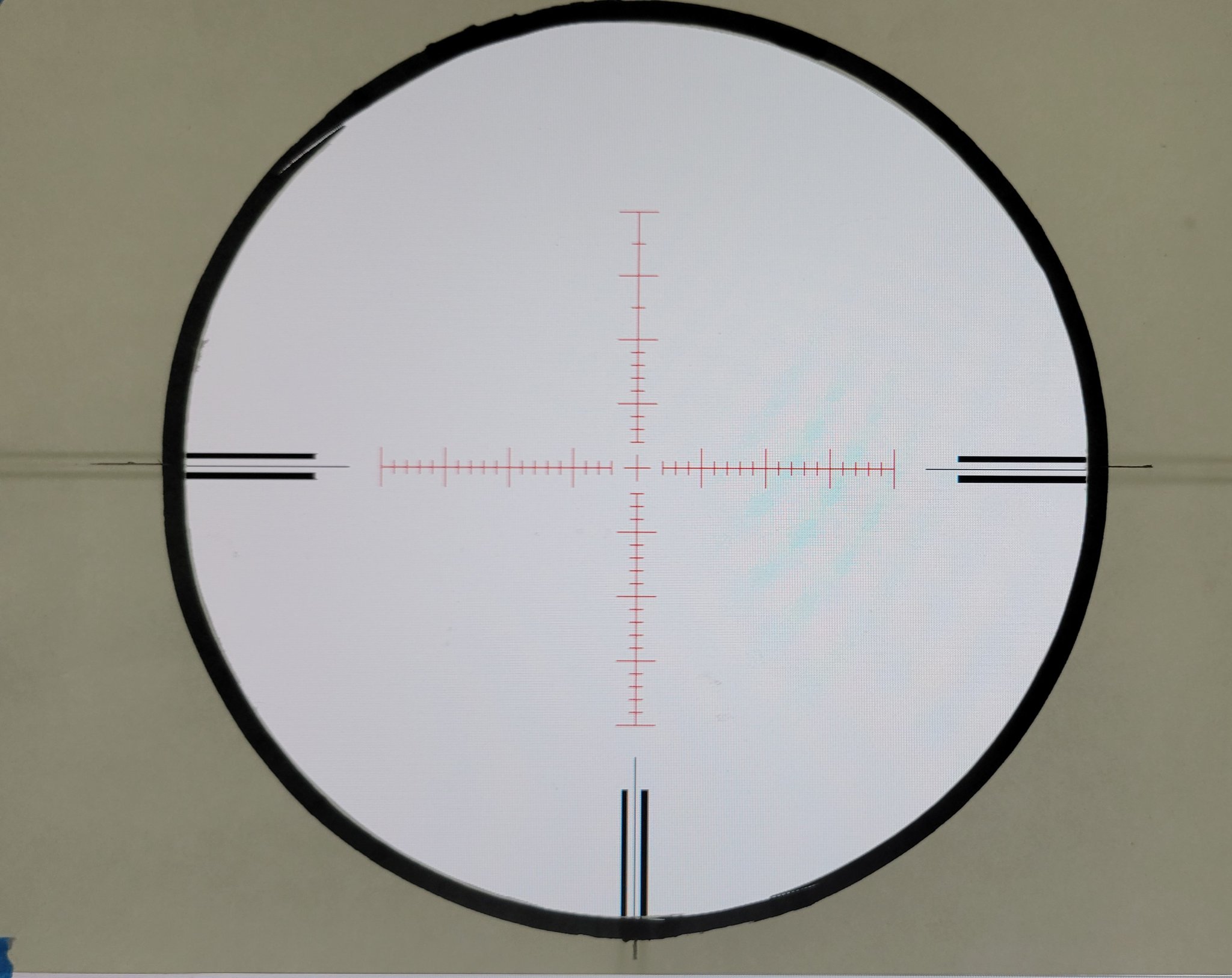

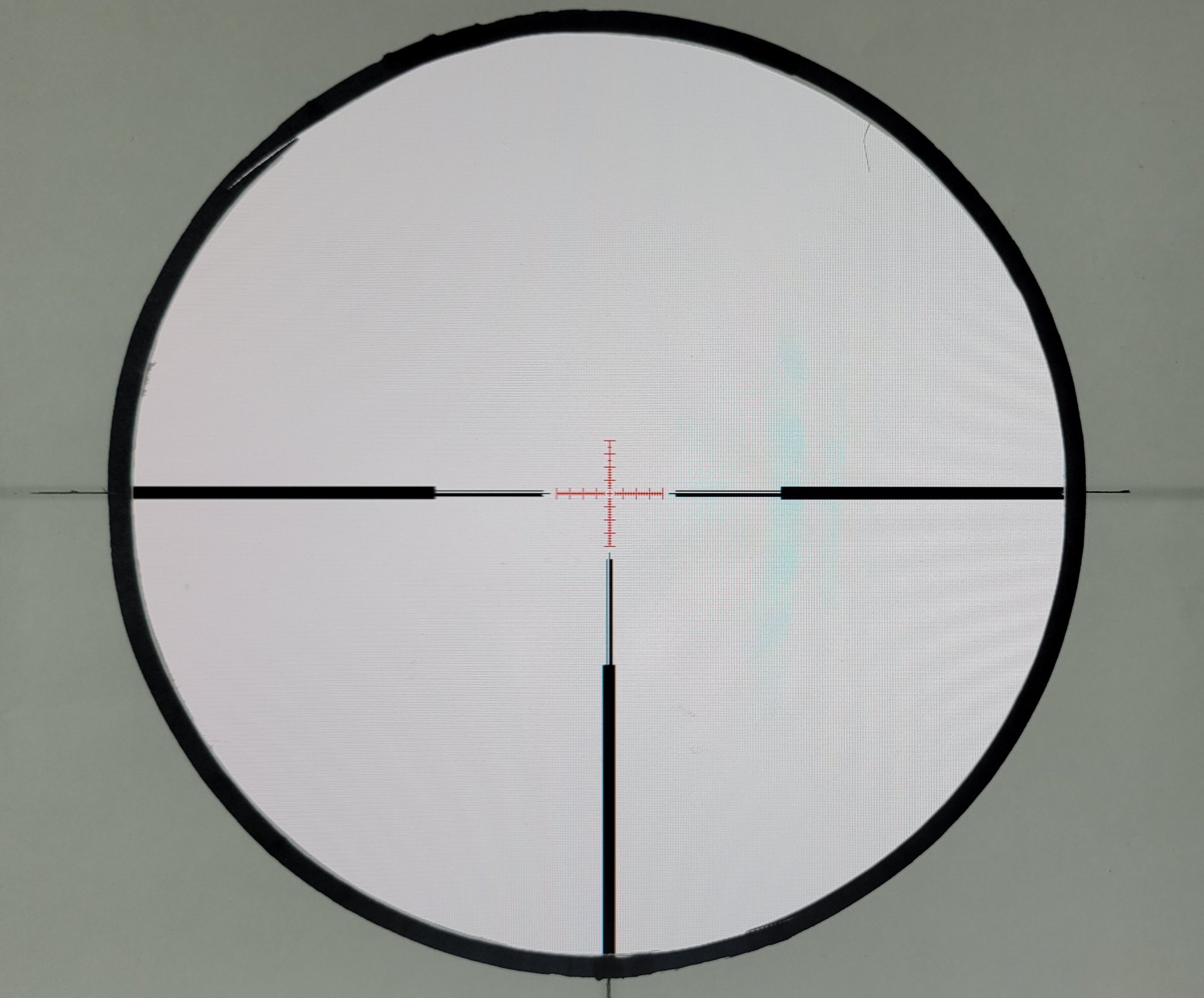

May have shared this in another thread. For a crossover scope in the 3-15/18 or 4-20 range, this is the reticle I'd like to see (the VMR-4 is actually pretty close).
Exposed Elevation, Zero Stop, Capped Windage, Illumination, less than 22oz.
Ratios etc are not correct, these are just for the visual concept with a static reference circle to sumulate the view through the scope. German #4 ish at low power, then functional mil reticle that's not overly cluttered at the top end.
This is created with a grid in Excel so each cell represents 0.1 Mil. I used the zoom at 10% and 60%. I'm not a math guy and don't know if that's how the zoom ratios work in optics, but 6x. The stadia lines are just "borders" in Excel so no clue how think they would be in Mils...
German#4 (Left, Right, Bottom) - 1.0 Mil
Medium (Left, Right, Bottom) - 0.4 Mil total with 0.1 Mil bars top and bottom each separated by 0.1 Mils and a centered stadia.
Major Hash - 0.6 Mil
Minor Hash - 0.2 Mil
Center Cross - 0.4 Mil
3x (10%)
6x (20%)
12x (40%)
18x (60%)
Ratios etc are not correct, these are just for the visual concept. German #4 ish at low power, then functional mil reticle that's not overly cluttered at the top end.
3x
18x
Personally, I think this is a solid design overall but I’d tweak a few small things if it were me. I’d make the lines at each full mil a little smaller/shorter, extend the .2 marks all the way down, and I’d probably prefer a dot center but would happily buy something with a cross like you have there.
The problem is, the thickness looks decent at low mag, but you didn’t scale it correctly at high mag. It would be much thicker as I’m sure you know, and therein lies the rub. Finding the right balance is hard, because it’ll either be too thin at low power, or too thick at high. Which is why the G2H donut of death worked so well. It was big enough to draw your eye in at low power, but was only minimally intrusive at higher powers.
A prime example of the struggle is the March FML-1 reticle and the original Razor’s EBR-2b. Those have thicker stadia, but a lot of people feel they’re “too thick” these days. You can’t have both.
Perhaps the one thing I’d try is combining a donut with having a thinner crosshair for the center of the reticle, say 2-3mils out from center. Then double the thickness the rest of the way out, and THEN have the #4 style posts on the outermost portion. So maybe .03 or .04 for the center portion, then .07 or so the rest of the way out, and then 1-1.5mil thick #4 posts. That way at low power the reticle still appears thick enough to see and quickly quarter a target, but as you increase in magnification the thicker parts “spread out,” leaving a finer reticle to use inside the donut for more precise, longer-range engagements. Just a thought, maybe it’s been done before.

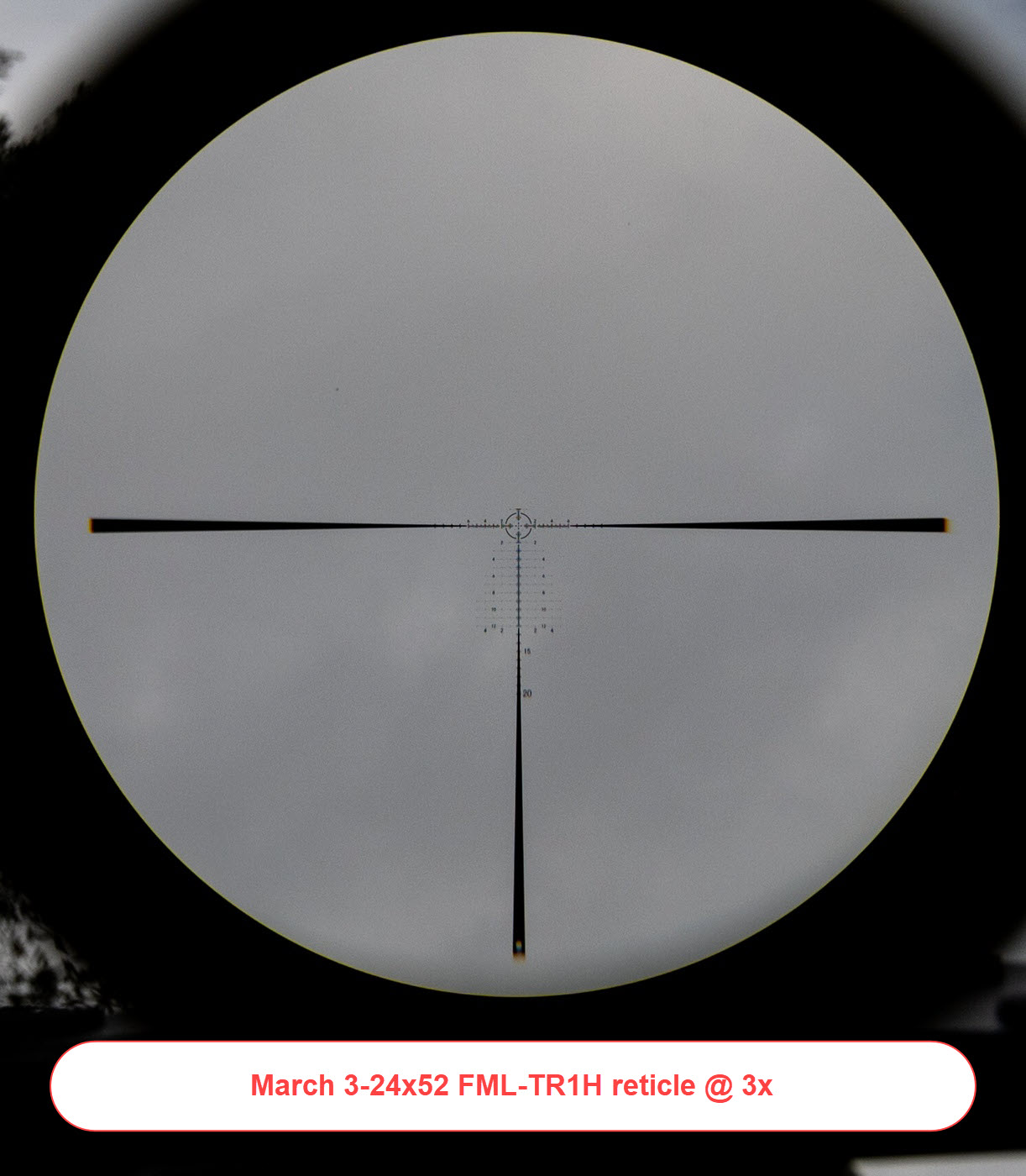

I really like the March FML-TR1H reticle they put in their 3-24x52 scope, that quadrant does not obscure at 3x but actually really helps pick center quickly
This is why it is important to have options, I am not suggesting they replace existing reticles
Oh yeah, I wasn’t respond to you, just throwing out my perspective for @Scott_at_Vortex whom I hope reads this and will no doubt immediately hand-craft my new scope lol
That March FML-TR1H looks pretty good!

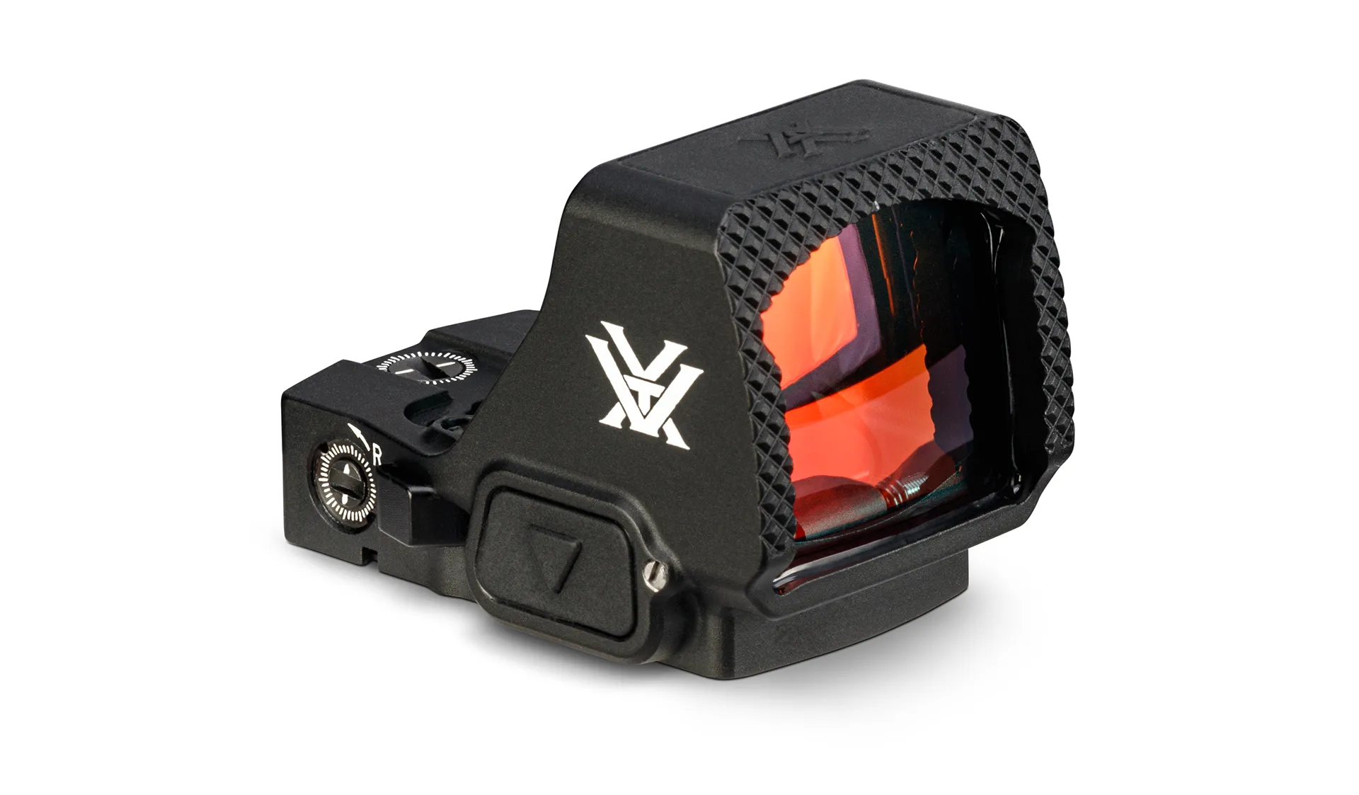

Pricing always matters, but with a lot of the red dot prices not being very far off Trijicon I always wonder how much market share is there esp. for an SRO use case. The plain RMR I've said for years is durable but optically garbage, even before everyone jumped into the handgun optic game and RMR could do no wrong, the RMR HD at least addresses that. The MRO release was a fiasco, so Trijicon is far from perfect.
The Defender ST is a good example, yes it's apples/oranges to an SRO in use, but let's make a pretty safe assuming that the XL is at least as expensive. Street pricing seems to be around $350, but I've seen SRO's recently in the $450 range.....not that $100 is nothing, but it seems like most folks would cough up $100 to run that over Vortex. Esp. with the Trijicon being USA made and the Vortex from China. Holosun 507 comp and some of their red dots that are pushing $400 street price are the same. If they were half the price I could see it but they are getting to be really close in price point.
Then again, people pay criminally insane prices for SIG stuff, so I guess marketing hype play a huge role with the average consumer. Plus at the end of the day more competition is likely always a positive.

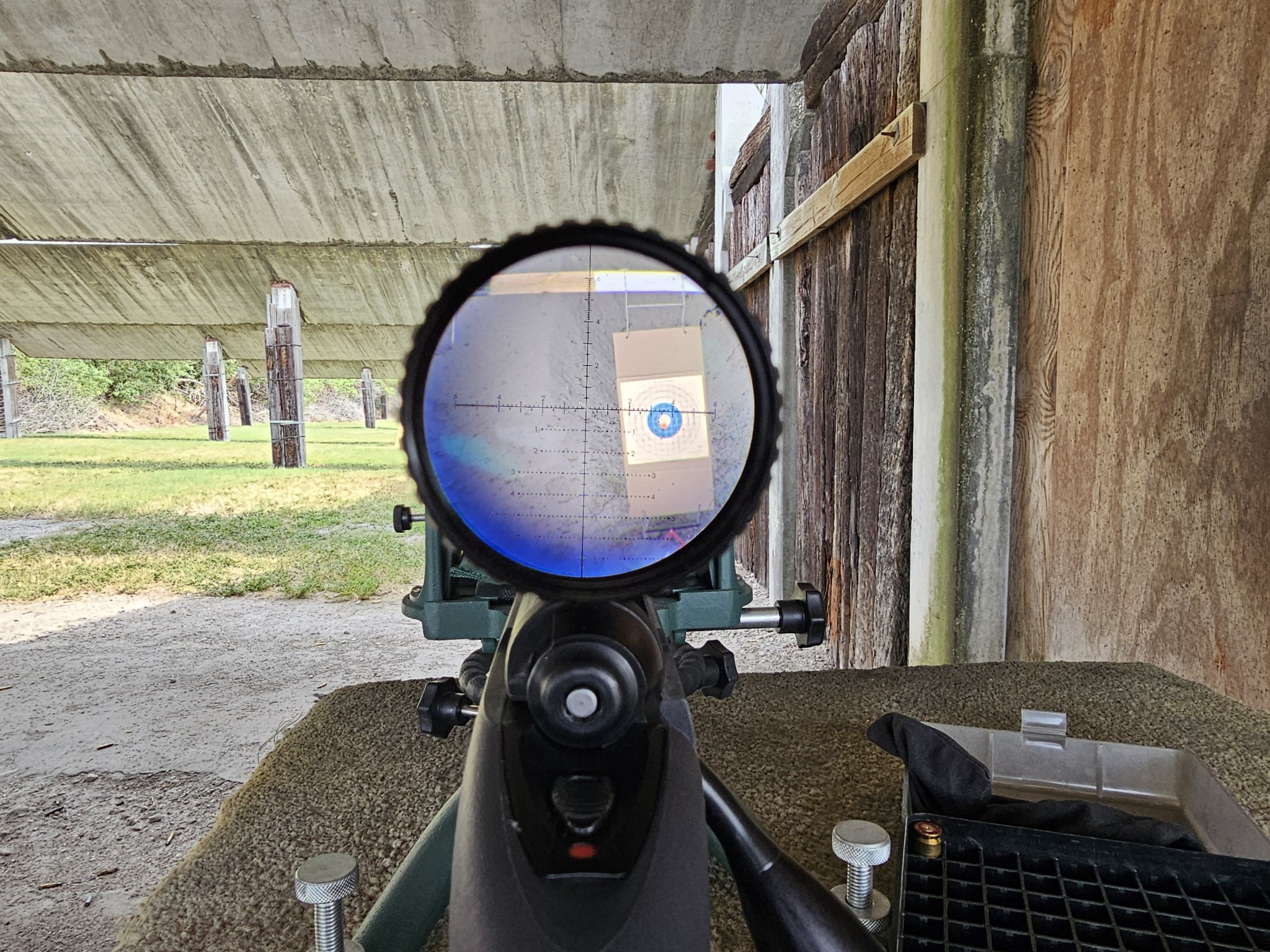

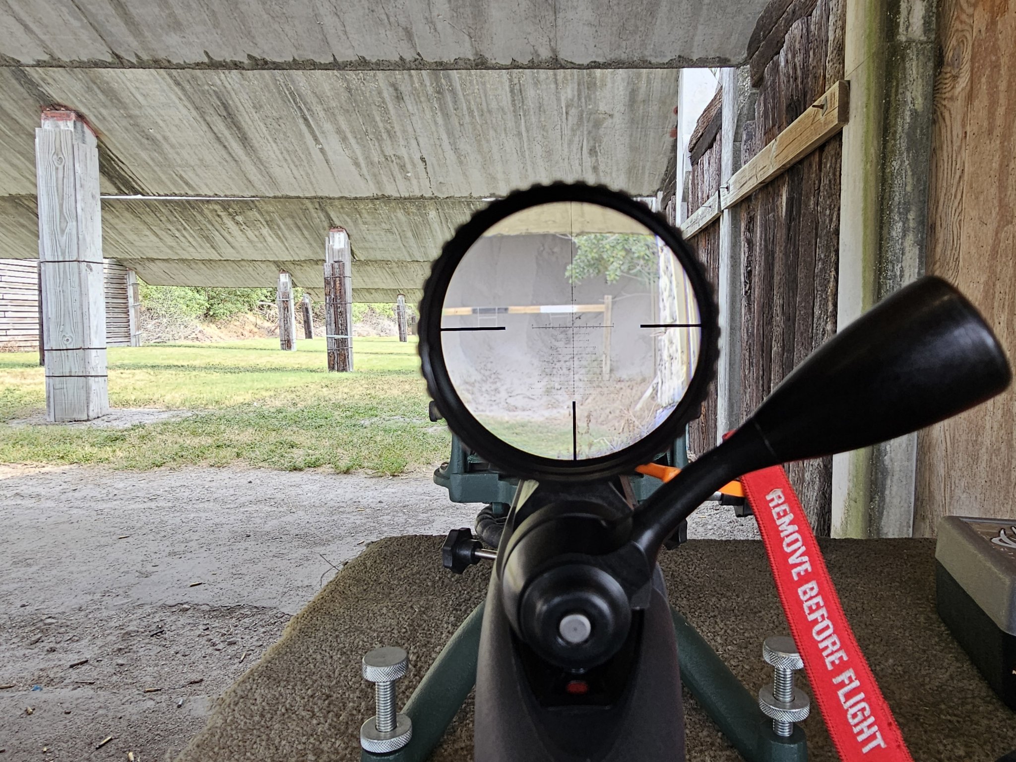

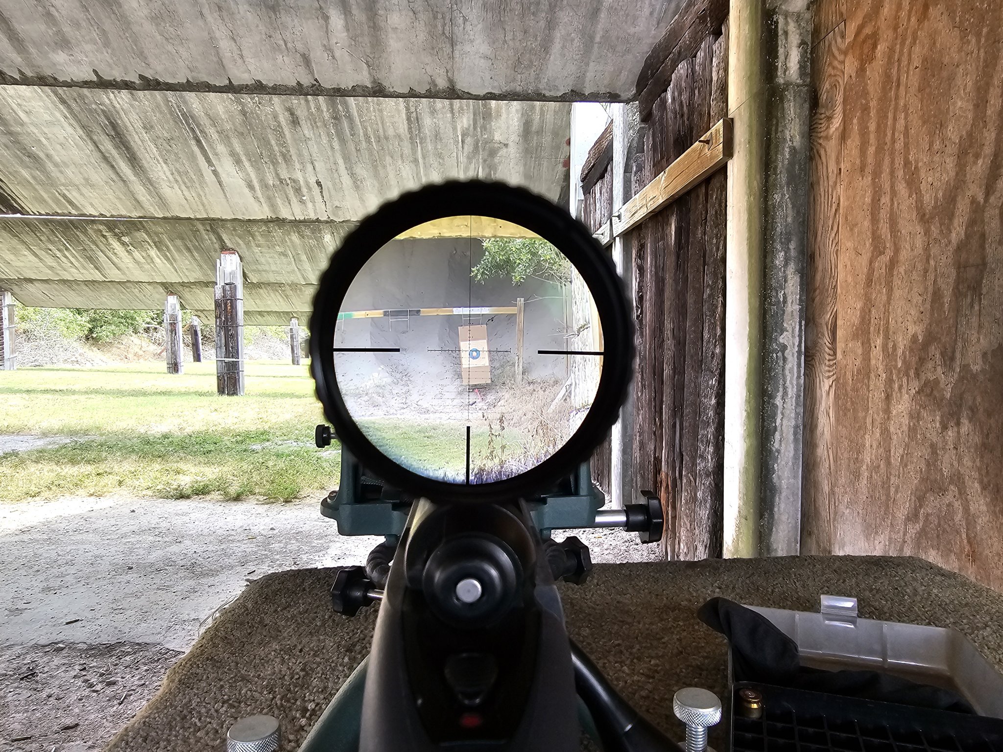

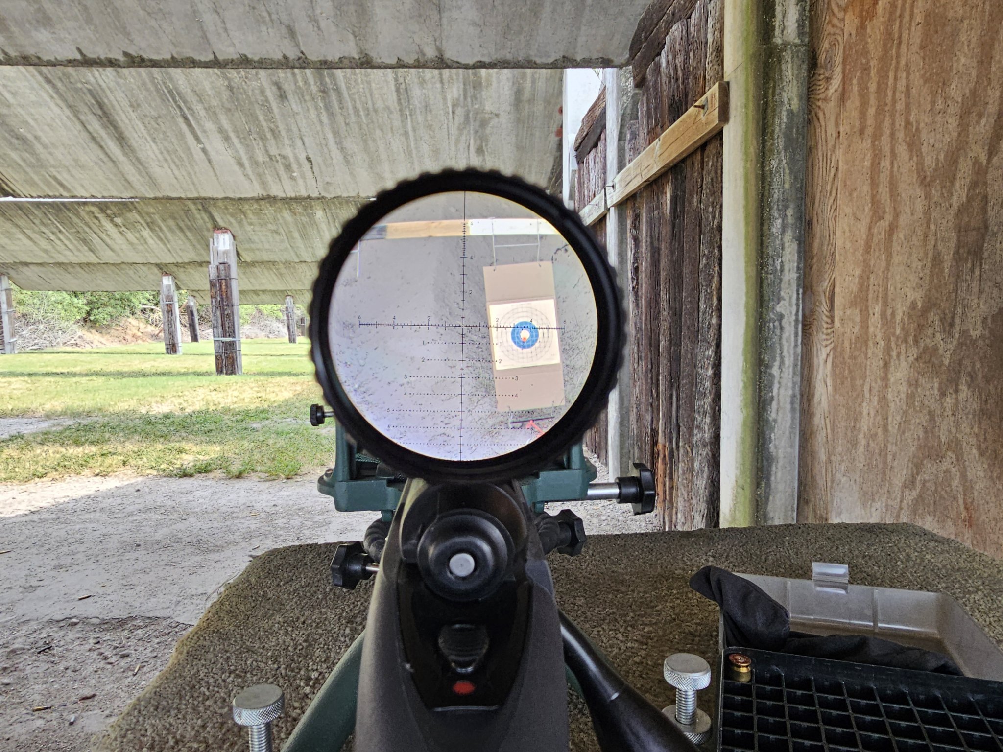

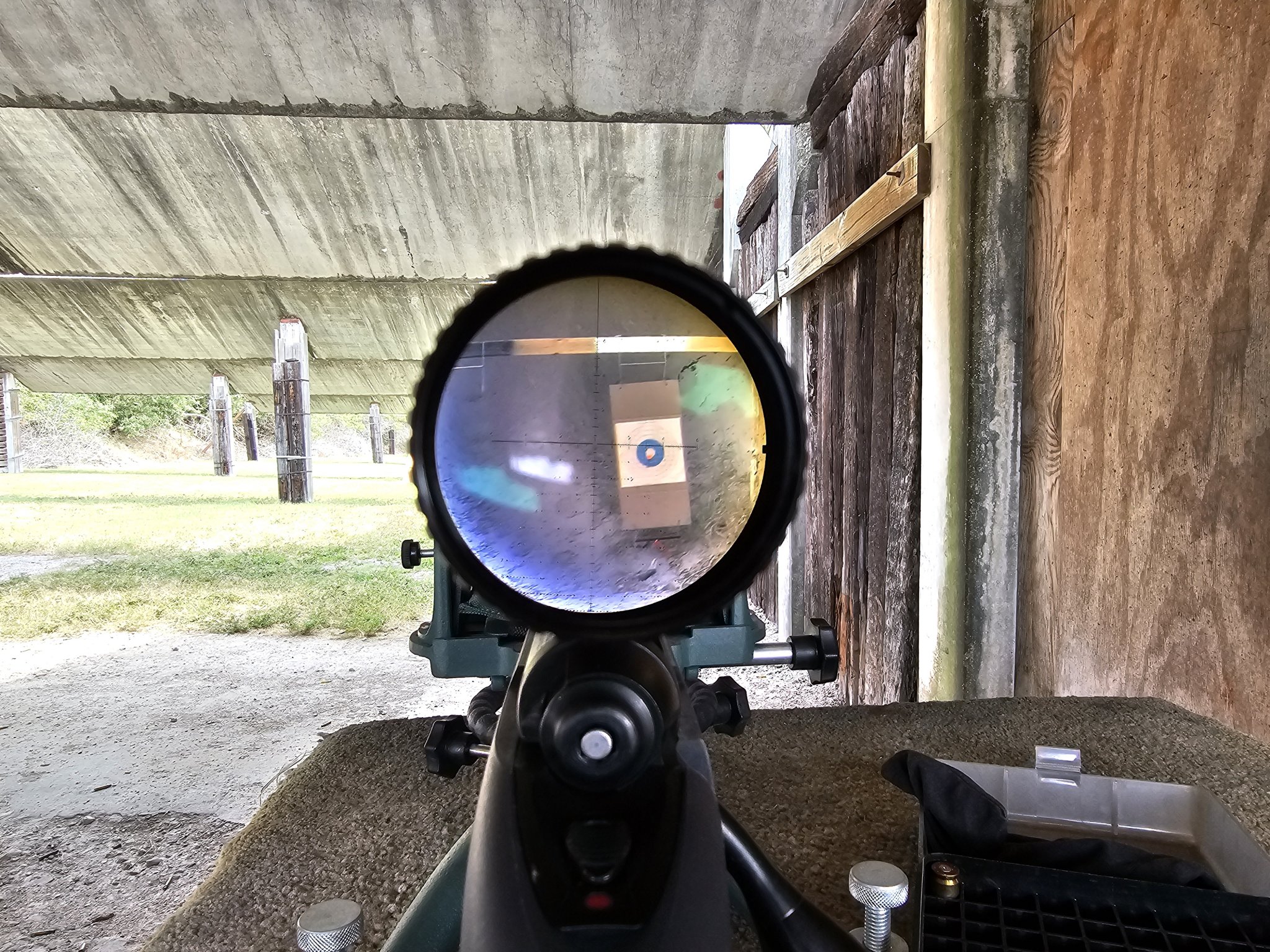

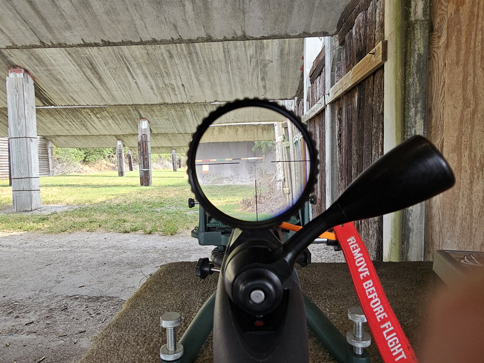

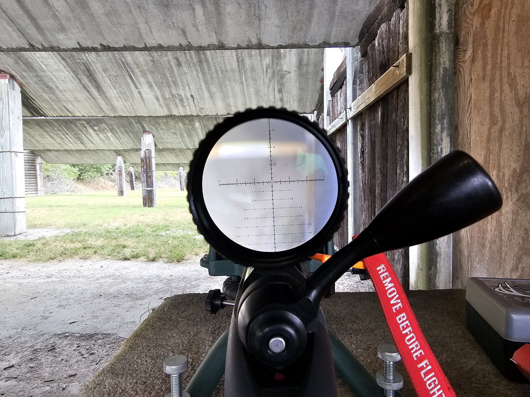

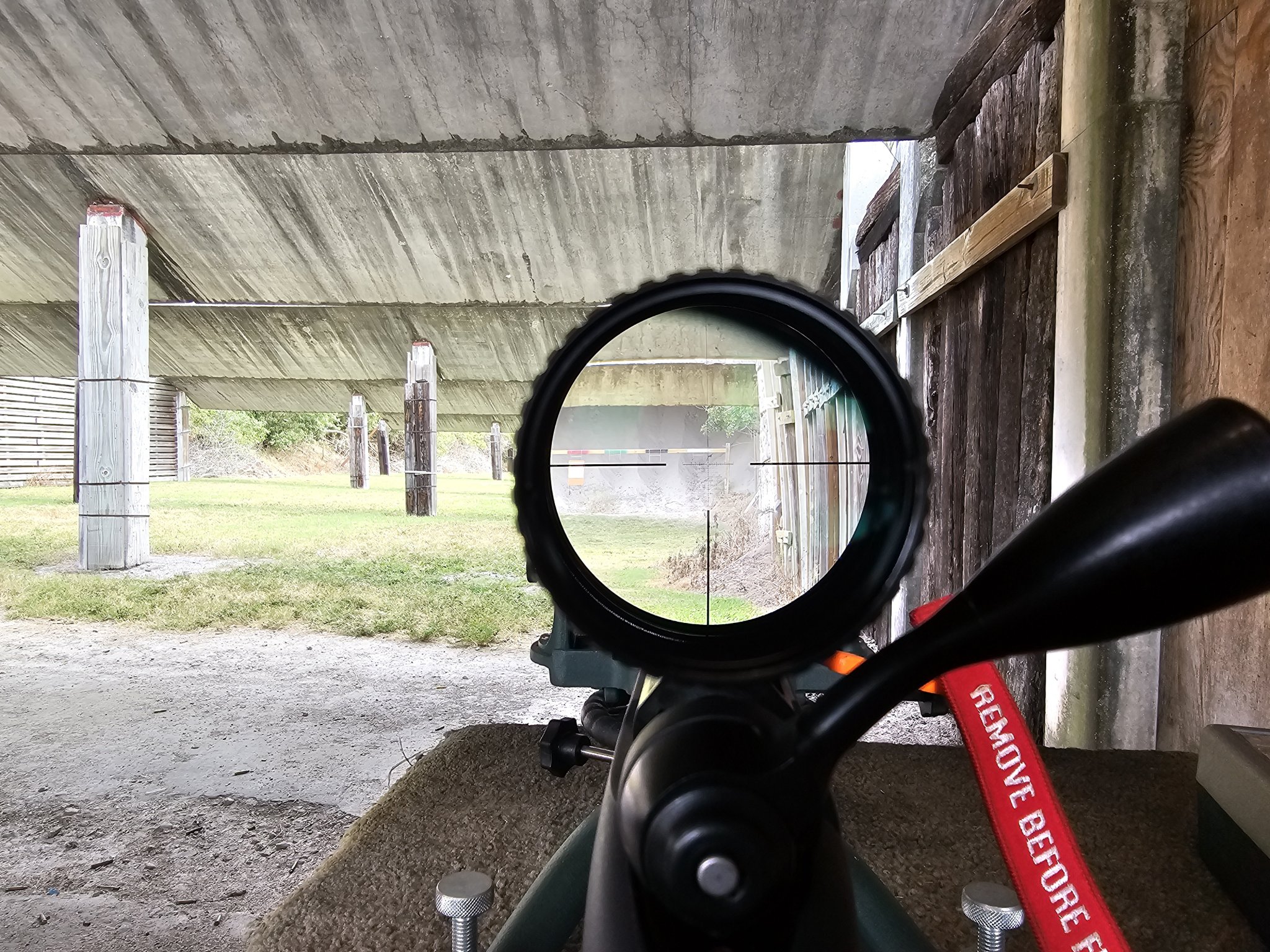

Various fudd pictures of a new vortex viper hd 5 25x50 ffp. Taken at 5, 10, 25. Seems very picky at higher mag. To get behind. This is just MY fudd opinion
The PST Gen2 5-25 gets a bit sensitive around 22x, I found rather than a tight eyebox it was more the exit pupil getting small with the 50mm objective.
Nice to see the huge FOV/image in those pics, definitely the thing I most like about the PST Gen2.
If a FFP 3-15x44 ever comes out I'd be all over it, 5-25 is just to much magnification for a hunting/crossover scope IMO.
A 4-20x50 would be even better.
my 40 year old pentax looks [pun] better and better to keep
I didn't have parallax set when took some of those pics. And they were with an android phone. No special equipment. My intention was just to show reticle at different mags. Scope is clear just hard to get behind @25. But between 25 and 20 it was fine. And as I stated i am coming from a 3x9 with set parallax. I realized that after I tried looking through it at 25 and it was blurry. Luckily I figured it out. Would have been embarrassing to bring it back only to learn parallax was set at 20yds. Lol
what yardage are the targets ?
