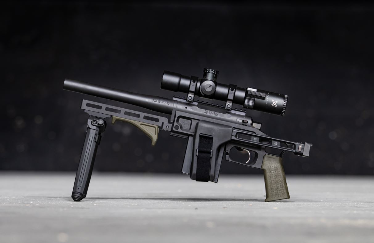

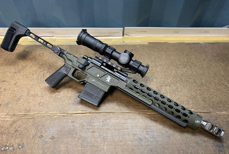

There’s guys building .308 R700 “pistols” in the 10” range with Black Collar Arms chassis. Seems like what I’ve seen has been positive, you just can’t expect to get any velocity.
I actually might prefer this, build looks freak'n sweet!

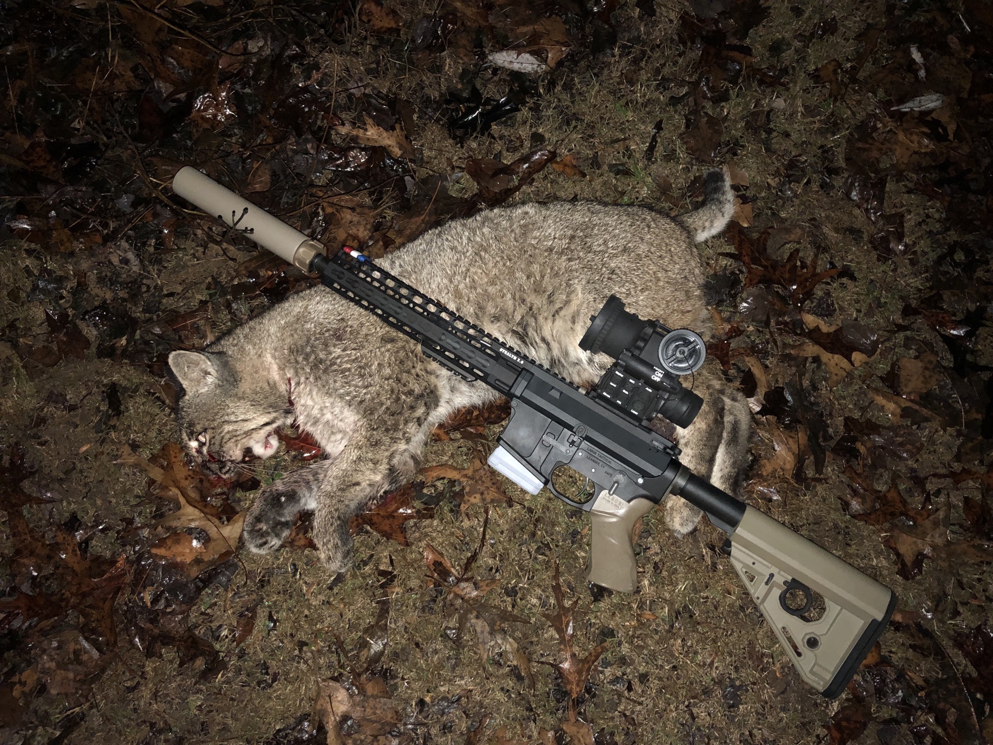

People keep saying 300 BO, did they miss the 500 yard requirement?
In real life I’ve had horrible experience with 300BO killing things. I wanted it to work so bad I stuck with it way longer than I should have. Fun to shoot, fun to suppress, but horrible at killing. Got rid of my last one earlier this summer.

I didn't see mr InstaStar say anything about killing. But Barnes black tip, and 110 vmax, and 220smk and 190 subx kill fine. Placement is more important than cartridge.
what makes you think a 10" 308 is going to be much different than a 10" blk at 500?
Supers or subs, and what bullet?
sea2summit
Trying to get past 100m
Belligerents
Mar 1, 2009
772
858
99
Yes;)
Last one I used was some 135s and they were cooking at about 2150. With that round this cat took three shots (broadside, running hit again spine-ish lost use of backlegs, then center chest) from about 40m and when I got to him he was tearing the shit out of a tree and I had to put a final round in his head. That’s not okay. Also lost a fox and raccoon, fox recovered days later I think because the dogs brought a decaying fox to the house.
Went back to 5.56 and haven’t lost any critters. This is a chicken/goat defense rifle so I really wanted the 300 BO to work for noise and ricochet concerns for neighbors. Ohh well, live and learn.

You used a non expanding / non easily fragmenting bullet in a low-mid velocity cartridge. On a thin skinned light animal.
Black tips, or 125 tmks or a Lehigh bullet would have been a different story.
And yes. You can shoot well past 500 with a blk.

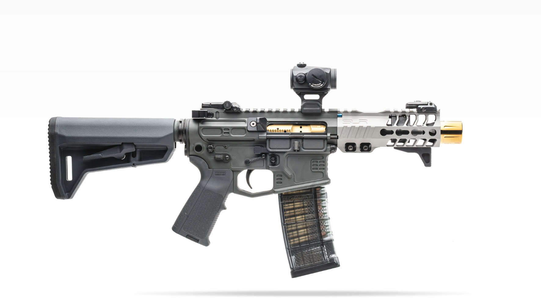

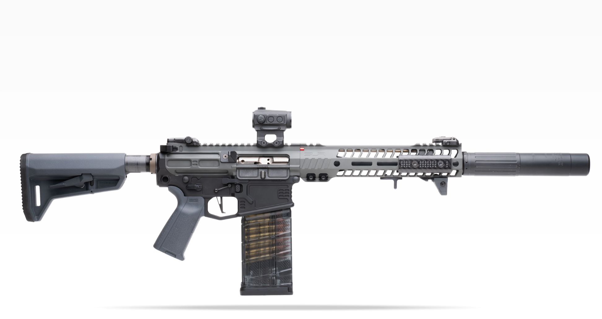

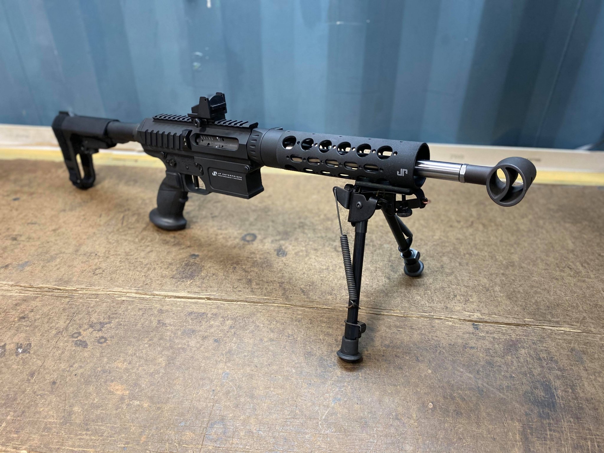

@LilGucci If you're wanting something to cycle forget it. You're going to waste time on a 10" or under large frame 308 / 6.5 Creed. You're far better off running a 300 BLK or a 12.5 Grendel if you want something that short to cycle.
Buuuuuut...
A really fun option for shooting subsonic to utilize your current plan would be to follow the black pistol build idea and make a straight pull pistol build. This setup has no gas system and was meant to be a handy deer rifle. Essentially if you're hot about doing a very short barrel in a large frame AR upper, this is something that might fit.
Unless you plan on having a 2nd upper I would prefer to go the route of the green pistol or something similar.
*ETA - Grendel Shorty
View attachment 7178177View attachment 7178181
That black JP SBR is absolutely gorgeous! And thank you, I might just skip this little project altogether and go with an SBR bolt-action rifle like I posted above, a 300blackout 5-inch pistol, and a 12-inch 6.5 Grendel. I think that'll work the best for me. So sad 6.5 Creedmoor wouldn't be able to overcome the limitations of the 308 caliber.
