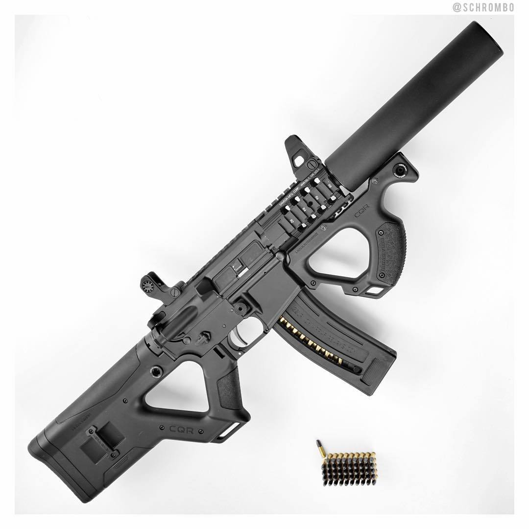

I was actually thinking doing something like that, just a 22 plinking gun in the m4 body and cerekote it with a can, like this Chiappa M4-22:

An M4 SBR would be cool, but since my heart isn't really drawn to either 22 or 375, I'd need it to be a killer gun with high resale value since I wouldn't be keeping it anyways. The guns I'm building are guns I plan on keeping for a very long time.
