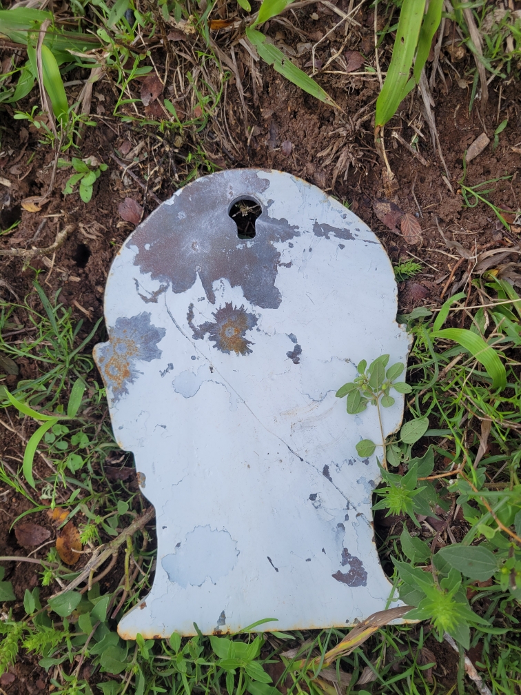

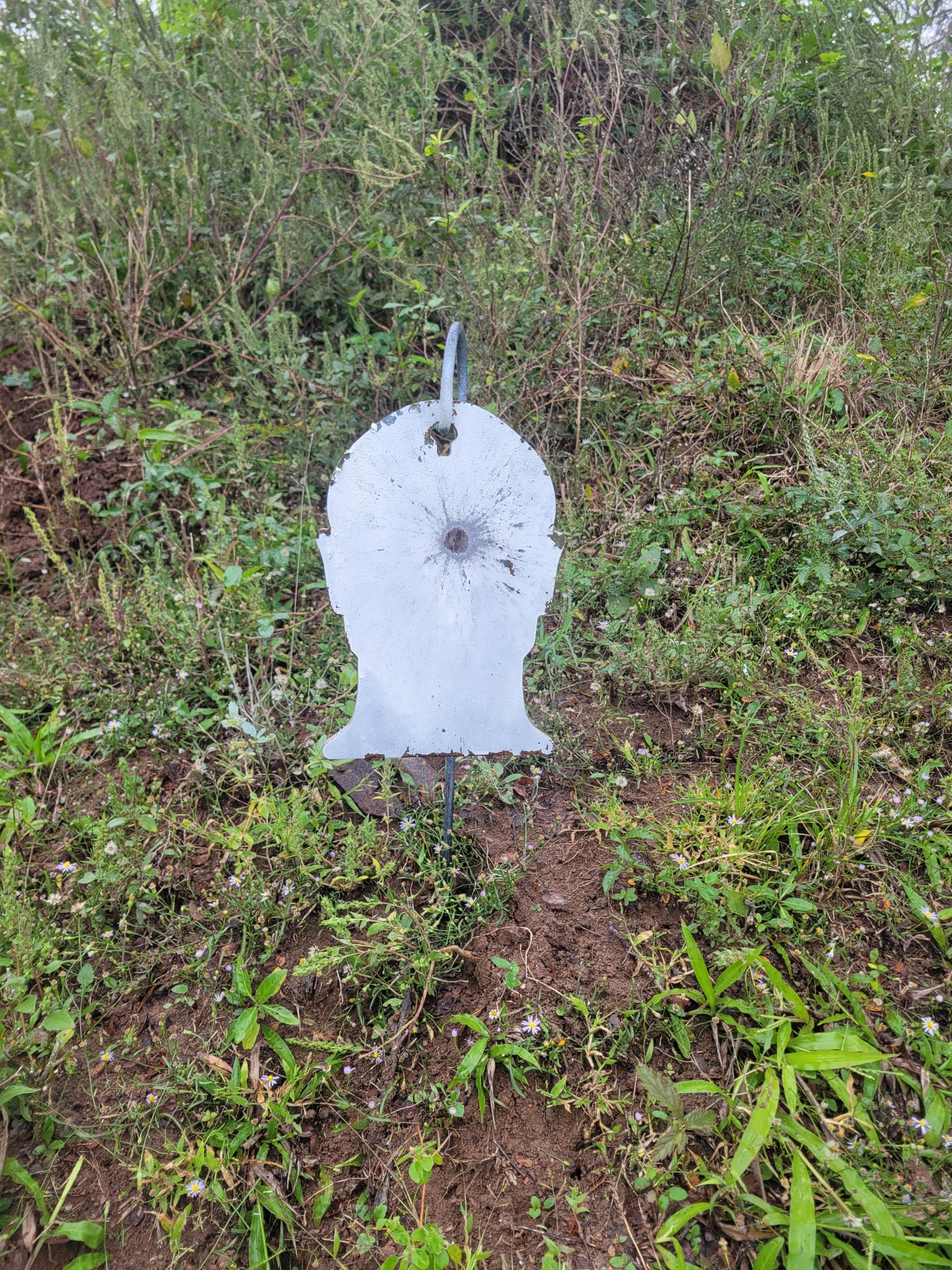

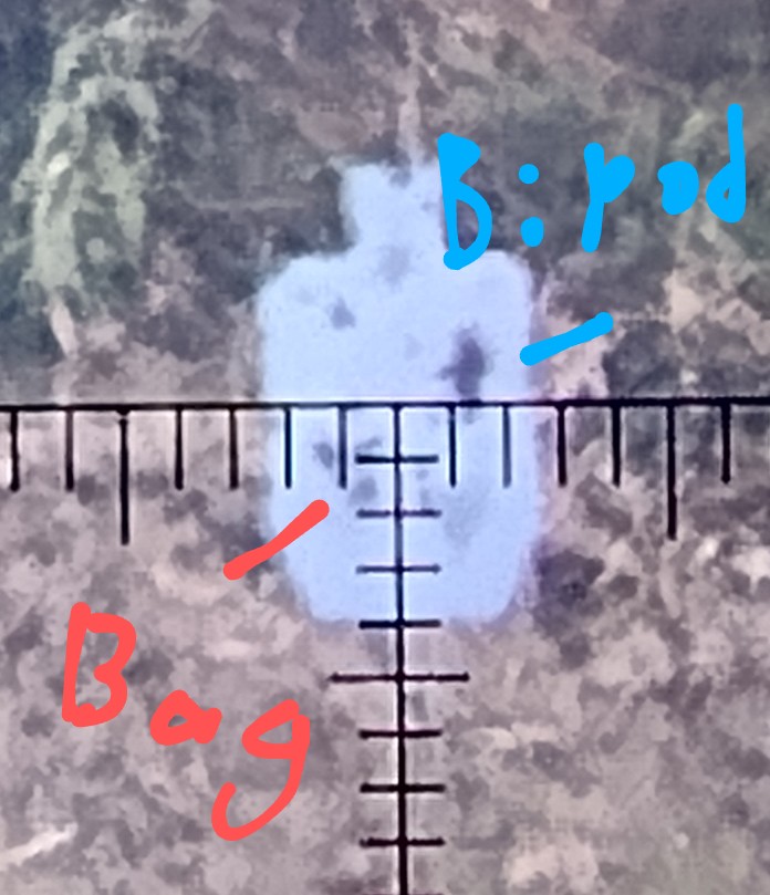

It's been a long battle with this gun. I've tried so many different buffer and spring combos and tweaks with the gas system but I've finally found a combo with it that shoots and isn't terribly hard on brass so I'm kind of reluctant to mess with it.
Top group, three rounds in there, 250 yards shot cold, prone off a bipod and rear bag. First two just left of the hole third shot is either right above it or went through it. Knocked the target off the hanger.
This one was three hundred yards. Cold, same setup. I don't shoot this rifle a whole lot and it's taken me quite a while to get a feel for the right amount of preload on the bipod. It doesn't like much. I shot a jug at 300 after the silhouette and preloaded a little too much, pushed the impact up about .75moa.

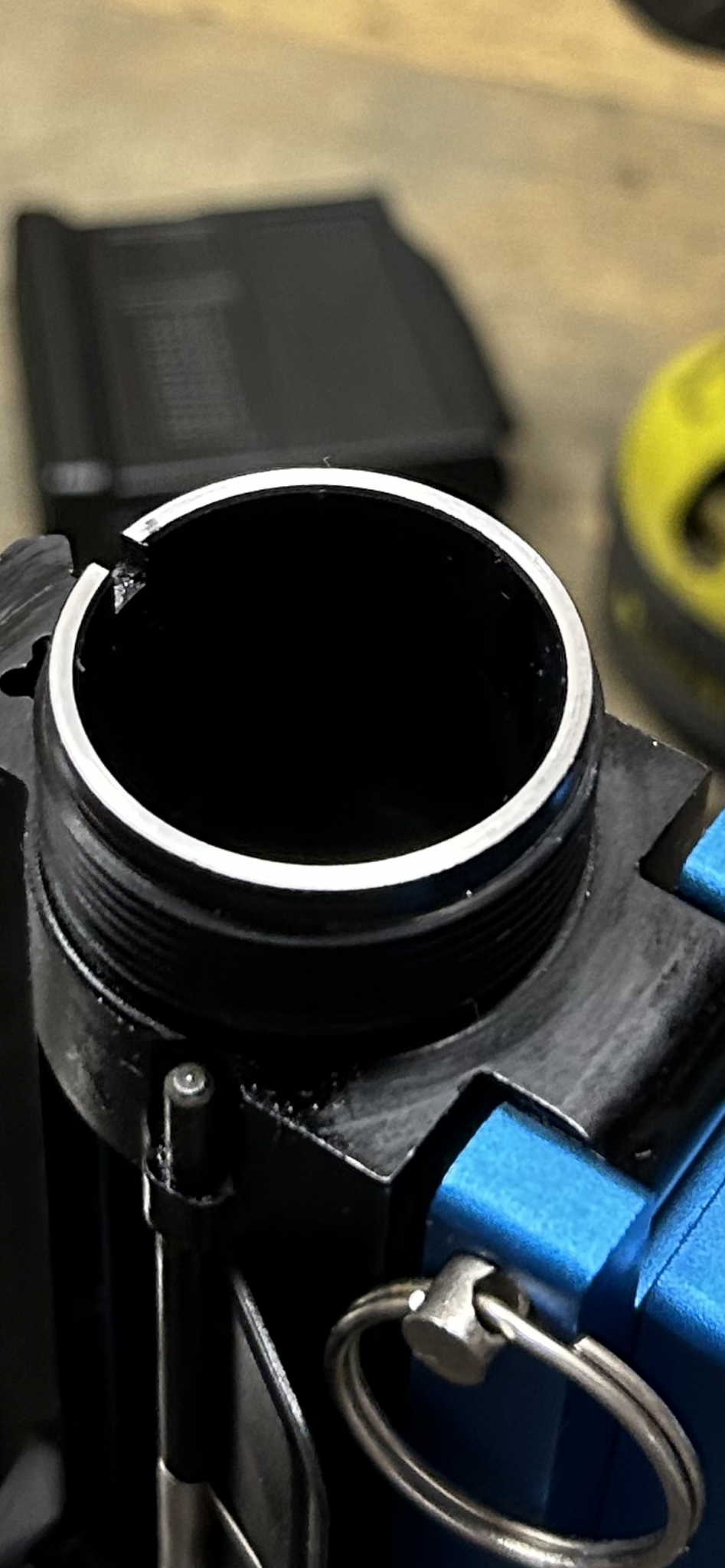

So I've been looking into this shim thing and you guys correct me here if I'm wrong...
You place the shim on the extension and try to push it in. If it crinkles then you have too much and need to remove some. You keep doing this until it is a tight fit and you need to lightly tap it in with a mallet.
My theory, and again correct me if I'm wrong here. My theory is you find where the shim is too thick and you start to crinkle it. You then heat up the upper and thermo fit the extension and the shim that is too big. In theory this will insure a tight fit even when you have a hot barrel.
Thoughts?

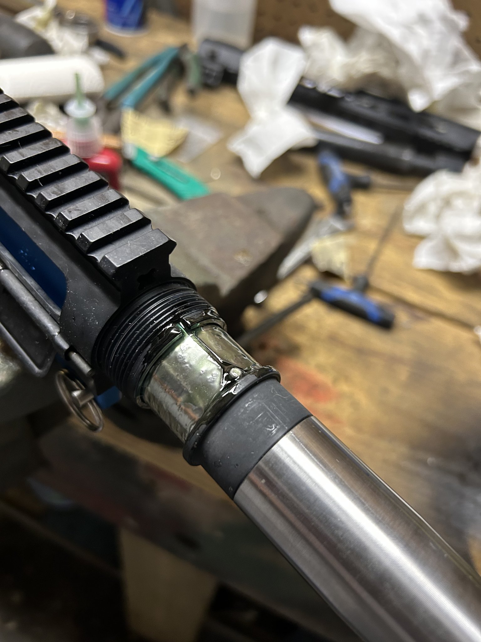

This is what mine looks like when I do the whole procedure. I order stainless shim stock in various thickness and I start something like a .002” shim and lube it up with 620 loctite and try it with heating the upper, if it slides in without crinkling the shim I set it and tighten the barrel nut to seat it fully. If it crinkles I go down to .0015” and then .001” until I get it to seat good. The bad part is each try I have to spend a little time cleaning up the loctite before I try again. I don’t like the idea of cutting material away from the shim to make room, the 620 might fill the gap and one decides to just cut some of the shim to maybe only wrap 80% or so around the extension, I feel like it could move in the direction of the 620 filled gap when it starts to heat up and might make the loctite malleable.
How hot are you getting the receiver? Are we talking a torch or a hair dryer?
So you're really going to town with the shim and almost a full wrap.
Yes, the more I have wrapped the better I feel. The 620 will fill all the little gaps that’s left. I have used a heat gun and a torch. It doesn’t take much heat, a hairdryer might work, but not sure. With a torch I don’t spend much time in one spot, and I don’t put the flame tip on the upper.

The whole reason I got turned onto the bedding technique was from Bill Alexander, who also looked at what the AMU had done with it. Bill said when he was doing fleet Grendel accuracy testing with 10 different rifles, all using the exact same components, high-end cut-rifled pipes, billet receivers, free-floated, same torque specs, trick triggers, high-end optics and mounts, 5 of the rifles would shoot no matter what you did, and the other 5 didn't.
He applied the AMU bedding approaches, and bedded the gas blocks too, then the rifles tightened up demonstrably. AMU used much higher sample sizes across large fleets of uppers for the team, and started making waves when they consistently out-shot the USMC Rifle Team.
I first tried it on a JP 18” .223 Wylde barrel I had in a generic M4 upper. It was shooting 5rd groups into 1.7” at 100, which is just not what I expected that barrel to do. The barrel was given to me and had a high round count on it already, so I figured I’d at least see if bedding would change anything.
I trued up the face of the upper, which was way out of square, then bedded the barrel.
Took it out again and I’ll be if it didn’t shoot .5 - .6 strings of 5rds.
Another notable rifle was an Iron Ridge Arms AR-10 billet set build with a Krieger 20” pipe. It had a DPMS aluminum gas block that was gas eroded out, had a standard RLGS tube with an ArmaLite gas position, and was shooting 1.5-1.7” groups at 100 with a known Sierra hand load that shot lights-out in other rifles.
I stripped it all down, got a new steel gas block for it, ArmaLite gas tube, and bedded the barrel into the IRA upper. Took it out and started zinging .6” groups with that same load.
The JP example, AMU testing, and Bill A.’s recommendations made me a believer, and the Krieger pipe in IRA billet set just confirmed it. When GAP built my different custom LR-308 and LR-260, I think they did similar accurizing techniques as well. Both are freaking lasers, always have been from the first groups to the last. One was an Obermeyer pipe, the other a Bartlein.
I also did some single variable testing with this with 22” Lilja bull barrel 6.5 Grendels in Seekins billet receiver and their handguards. No bedding: 1.2” 5rd groups. Bedded: .3” to .4” rapid-fired 5rd groups with factory 123gr Hornady A-MAX.
I just bed my barrels as a rule and have done so for about 13 years now. Everything has been MOA or better, usually in the .4 to 1 mil region with quality factory ammo. Even the little 12” Faxon 6.5 Grendel shoots MOA or under with most factory loads.
Bill A. also mentioned something about gas system input onto the barrel with the port acting like a jet, 90˚ off-axis from the bore. It was more pronounced with external piston guns if I recall. He used to offer Adams Arms piston Grendels back in the day.
I also had this conversation with John Paul, owner of JP Enterprise. He said from a manufacturing standpoint, it’s always hard to get consistent surface dimensions from anodizers, so even with perfectly-true machining on the upper faces, when you get them from anodizing, there can be a slant on the face, so it added cost and complexity dealing with it from that end.
He prefers the thermal-fit process if I recall, which they control with their extension tunnel ID and extension ODs in the parts feed into the builds.
Everyone can do whatever they want, but I know what I’m doing every time I put an upper together. For those that are trying to milk accuracy out of a trash, bottom-end barrel, I would advise to consider stepping up a price point or 2 and get something a little better before polishing a turd. Don’t expect miracles from some of the lower-end tent stakes floating around out there.

Anodizing has been brought up several times as a possible cause of receiver faces being not true or flat.
In my journeys I have measured new AR upper receiver faces several thousandths off from perpendicular to the receiver bore, some were not even very flat either.
However, anodizing would not cause this condition. If a receiver face is not true then it is almost always manufactured that way, or another process messed it up. Such as material was removed during deburing, sanding, sand blasting, or tumbling. Or one of these processes left grease or contamination in/on a part of the face etc. this can effect the anodizing process negatively. Many things can go wrong, and it takes effort to get it right. Often the blame gets pointed at anodizing though.
Having made many thousands of parts, and hundreds of different types of parts, sometimes problems have arose. Spending time in the anodizing shop with the owner and operator I learned a lot and how I could make better parts, and learned that anodizing was literally never our problem. If done properly, Anodizing thickness or dimensional change within a single part is extremely uniform and so small that it is completely irrelevant, in the case of ar receiver faces.
