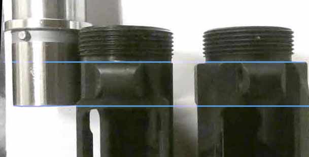

The problem with stiff handguards is they deflect the front of the receiver when you load them. Standard AR receivers deflect a lot unless you tie the receiver rail to the handguard.

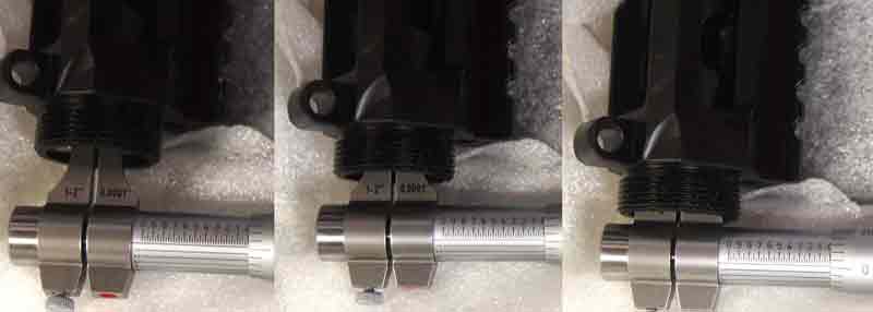

First off: Measure receiver nose I.D. for the first inch.
Unless it was machined poorly the bore will be smooth, shiny and straight for the inch that the extension fits in.
If it's at the upper end of the spec, maybe consider another upper.

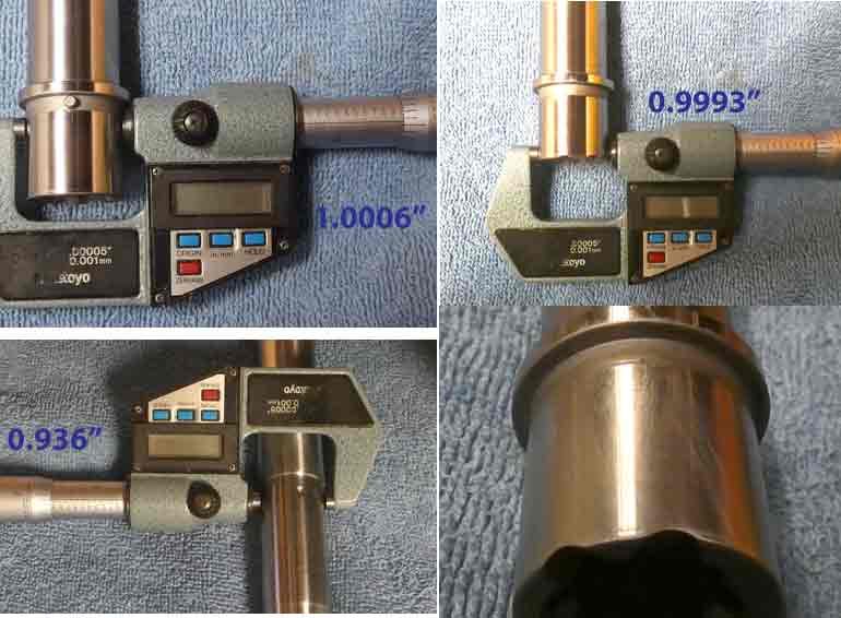

Next measure extension O.D.
I've found that the end diameter being a little small. Maybe to help getting it started without dinging up the front edge of the receiver.
Now you have just enough info to decide how much heat, or shimming is needed to get a true thermal fit.

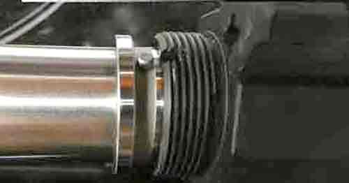

If you can slip most of the extension into the receiver, having to tap the last 1/4", this is NOT a thermal fit.
Most likely the extension is fitting tight ONLY at the thin threaded end of the receiver.
The rest of the extension, the part that just slipped in, is likely LOOSE in the bore.
Also note that most of the strength of the joint is NOT the nose but the body of the receiver.
A heavy walled receiver helps. The extension flange clamped against the receiver nose helps a LITTLE BIT in keeping things straight.
Figuring the heat/cold needed to slip the parts together requires just a little arithmetic (no algebra).
Expansion coefficients for 7075 aluminum, and barrel steel are easy to find. I'll leave that to you.
Receiver in your oven @ 200-220F, and barrel in freezer @ 4-10F should give you about 0.002" extra room to fit up
by the time you get them together and add a hand tight nut as the temperatures equalize.
I think having a "thermal fit" for the expected temperature in use, maybe 120 to 130F at the extension/chamber, not just thermal fit at room temperature will keep things tight in use. I think the upper and barrel measurements shown above could benefit from a little bit of shim stock, goop, or spray-on.
that's one of the reasons I like the Athena Chassis, the handguard is part of the lower, so none of the force applied to the handguard ever gets transferred to the upper at all.
