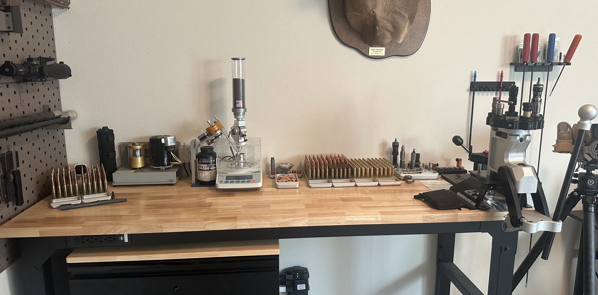

Components and routine. I reload the same exact way every single time start to finish and use the best most consistent components I can. Quality reloading gear, and components are essential.
I exclusively shoot:
Bullets - Berger hybrid
Brass - lapua or adg
Powder - h4350 or h1000
Primer - fed 215m
Reloading process:
Deprime
Dry tumble with corn
Full size die - (whidden or sac) (alpha munitions sizing lube)
Trim (giraud - seriously buy this if you are doing any other trimming)
Dry tumble again
Prime - (primal rights or a frankford hand)
Powder - (autotrickler or cm lite)
Seat bullet - (whidden or sac in press)
Having a clean organized workspace is also up there on my list and a lot seem to overlook. (I shot single digit long before I had a 419 press or an autotrickler - those are in no way required to shoot single digit)
Primer - fed 215m
Reloading process:
Deprime
Trim (giraud)
Dry tumble again

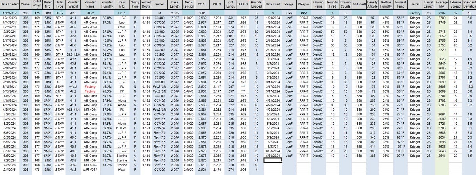

When I started precision reloading, I wasn't sure I could get my velocity's SD's consistently into the single digits for my .308. It seemed like this particular cartridge was difficult to do so from all that I was reading. I set a goal just wanting to get consistent single digits. Needless to say, I tried all kinds of things. The most substantial improvement to that goal was going to a really good scale like the one in your picture (FX-120i). It made a huge jump in my results measuring my powder to a single grain. This powder consistency also proved to help factory ammo where I redistributed powder in half a box of Federal Premium 175 SMK's and seated them to a consistent seating depth. Other things that helped a lot were quality brass (Lapua, Peterson and now some Alpha) and quality bullets (usually Sierra's for .308 and Berger and some Sierra's for 6.5 PRC). Consistent ignition helps some too (like with consistent primer seating). . .every little bit helps.
My reloading process:
Deprime
Clean Primer Pocket (pocket uniformer)
Anneal (flame anneal with Annealeez)
Clean necks with Steel Wool
FL size (Imperial sizing wax),no expander ball. . . or Neck Size
Dry Tumble in rice
Expand Neck (when FL sizing, which is most of the time)
Trim (Giraud)
Prime Cases (Lee ACP priming tool)
Powder charge cases (on FX-120i and hand trickle)
Seat Bullets (Wilson seater w/Micrometer, Harrells arbor press, no lube added)
The kind of results I get:

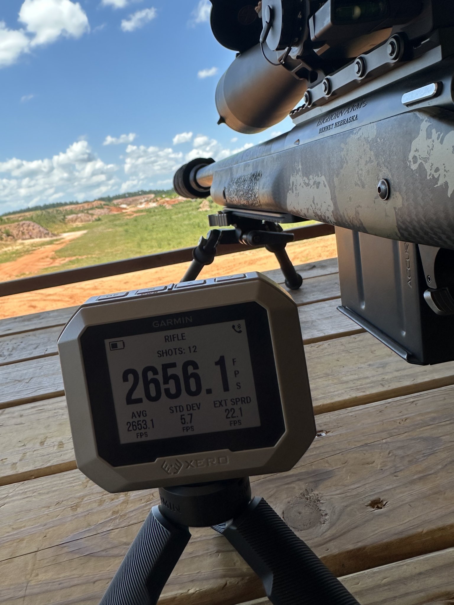

Yesterday, I ran 13 rounds of 338NM.
After first five rounds, ES 9.8, SD 3.8 - Okaaaay...looking good...
After next five (10 total), ES 34, SD 8.9 - Eh, I could live with it but don't want to...
After final three (13 total) ES 41, SD 10.1 - And heeere we go again - crap.
Very frustrating!

Garmin chrono ever since they first came out, Labradar for 6 or 7 years before that, MS3 for 1 year before that, and a couple different optical chronos (ugh) going back to the dark ages when that's all there was. God Bless you, Garmin...

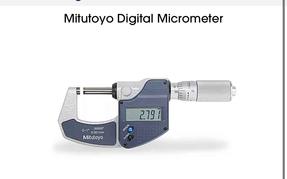

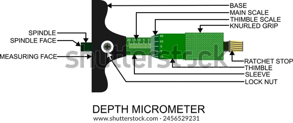

Show me a micrometer with a, “plunger style measuring piece” for measuring depth.
Reactions: supercorndogs
That’s a depth micrometer, it doesn’t “use the back”, and that anvil isn’t fitting inside a primer pocket, also, he already outed himself as not having a clue what he’s talking about. Nice try at white knighting for him though. Your type needs to stick together out there.
Have you ever seen one in person ? They make them plenty small enough for primer pocket work .
I have many. I have one that has a pointed anvil that would be perfect for this application. The one you posted will not work. The one your buddy posted isn’t even a micrometer.
I know it won't work...it is a colored illustration for reference only . Not for sale . :rolleyes:
Yeah, I got the Garmin then also. It's the cat's meow for now. Before that I had gone with with MagnetoSpeed v3 and have been waiting for affordable technology that works well to come along.
