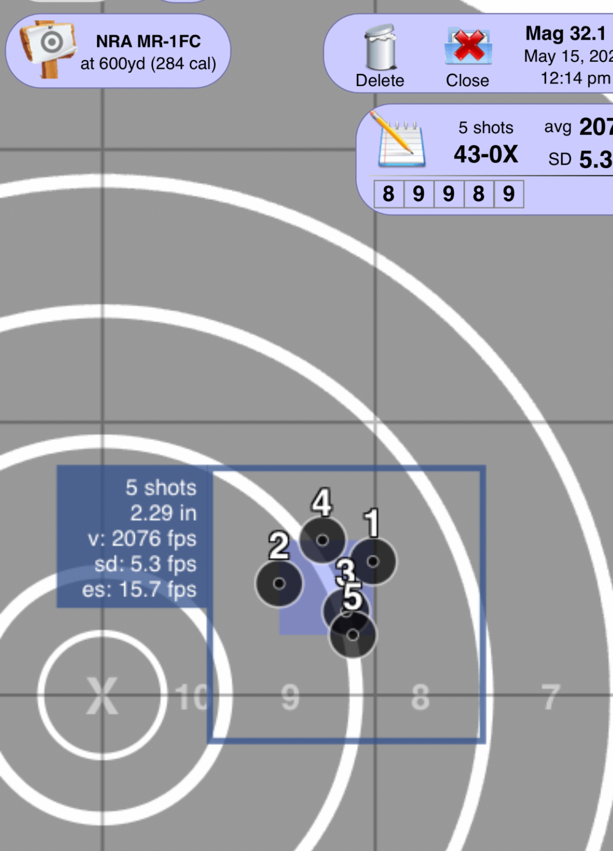

@Maurygold and @straightshooter1 mention of the Primer precision gauge is a great suggestion. I bought it recently and together with 21 C priming tool or the PMA one will turn your priming vudoo into a totally informed decision and repeteable process.
Me, tested yesterday the @CK1.0 routine. Pretty pleased by the results.
I will call it a day and keep on doing that.

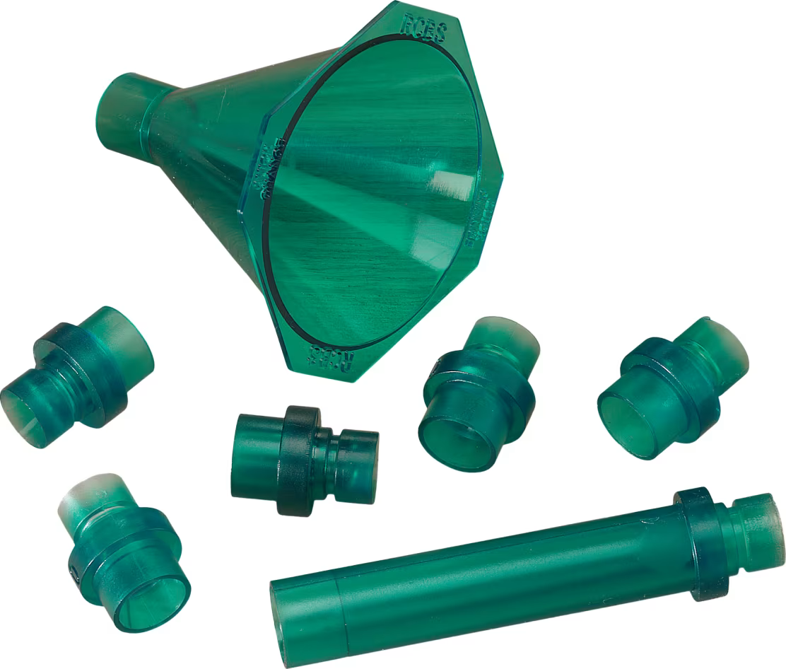

Drop tubes are vertical stacks on the funnel that accelerate the powder so it compresses better in the case when pouring.

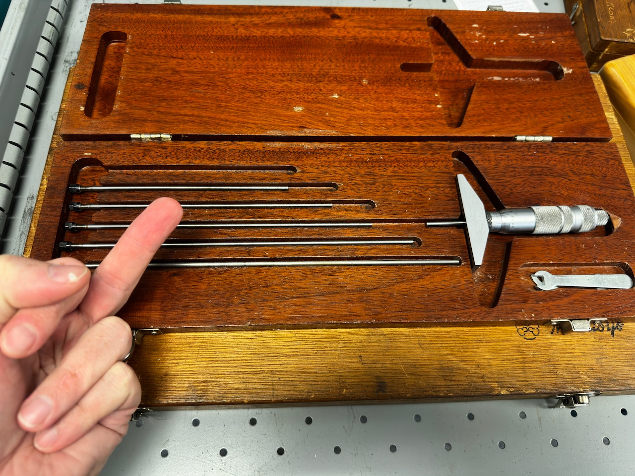

Have you ever seen one in person ? They make them plenty small enough for primer pocket work .
Here’s my Brown & Sharpe that are small enough to actually work.
But unless you’re indexing your primer seater off the case head somehow and not the rim of the extractor groove, or you’ve sorted your brass by rim thickness, then measuring primer pocket depth is all but pointless.

So is the drop tube just this long tube at the bottom of this picture?

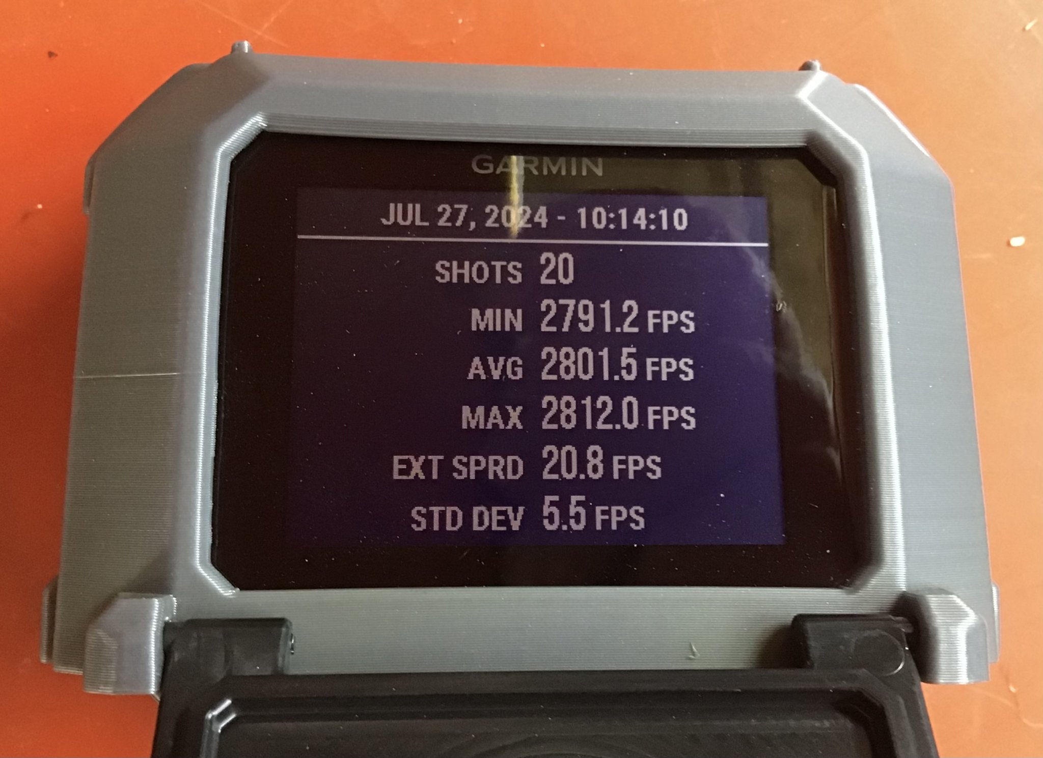

I’m shooting a 20” suppressed carbon barrel 300 win mag…… you may not think they’re impressive but they’re real and consistent and none of you ever do what I did. I posted straight off my Garmin what my last groups were.
You on the other hand cherry pick 1 year old chronos to try to look relevant.
The larger the case volume, the less of an effect a kernel or powder has on the total velocity. It’s simple percentages. Your SD’s aren’t impressive in the slightest. You should probably anneal.
Bro don’t you have more year old chronos to go try and find?
I haven’t needed to chrono in that long because my load repeats, but just for you, I’ll get another single digit 60+ shot string, with a caliber where one kernel is going to make a heck of a lot more impact than something with 80gr capacity.
I haven’t needed to chrono in that long because my load repeats, but just for you, I’ll get another single digit 60 shot string, with a caliber where one kernel is going to make a heck of a lot more impact than something with 80gr capacity.
Nah just screenshot your Garmin right now. They save. Don’t need you to go cherry pick more loads for the next 3 months.
And if you’re shooting a bunch without a chrono. Just lol at the lack of understanding of shooting and recording environmental impact on speed.

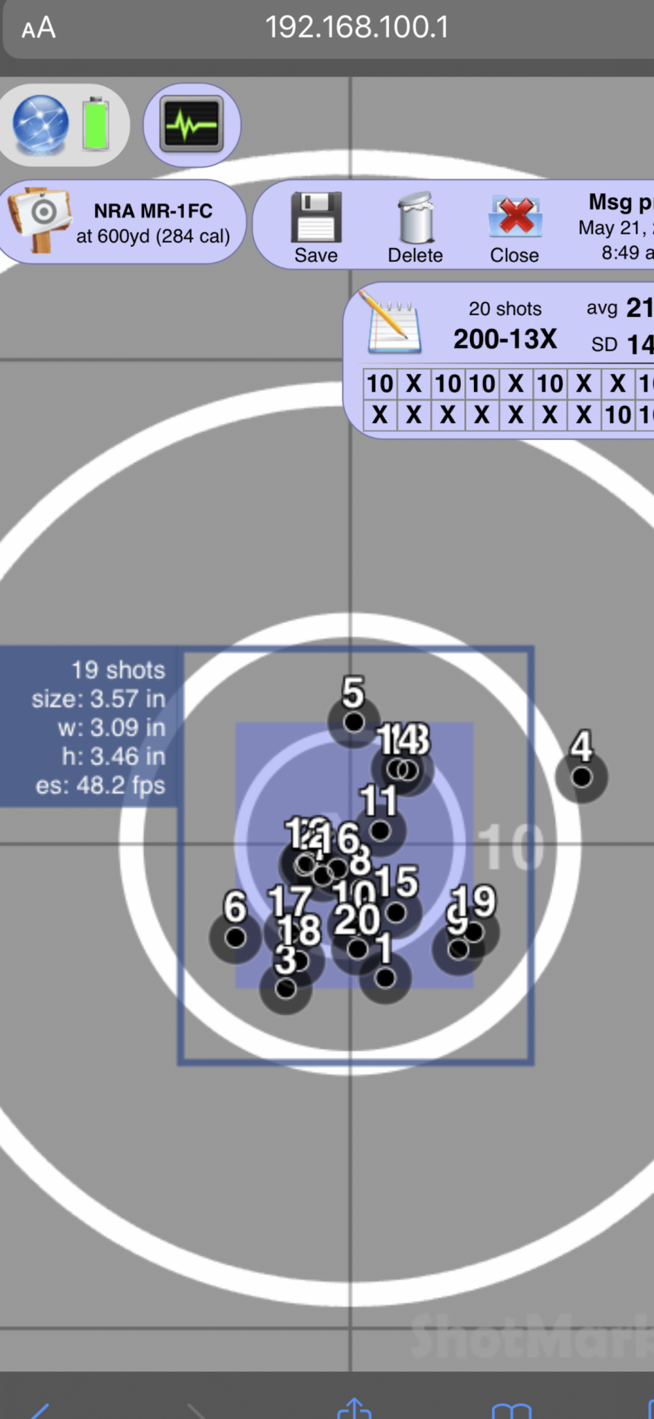

You have never posted a group of shots on a target. You call a picture of your chronograph a group. The same way you call a caliper a micrometer.
