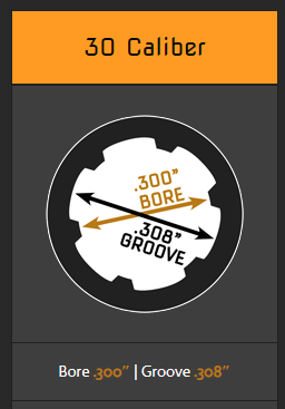

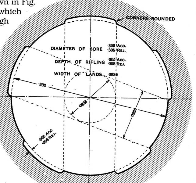

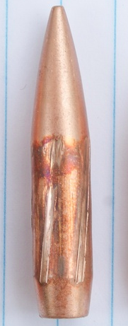

guys, you see this patch third from the left? It almost seems to say that the groove or I should say the four grooves are very wide. Why would they design the barrel like that? I mean only four of eight edges matter, right? each trench has two edges but only one edge is experiencing heavy force spinning the round.
I wonder if on some of these copper jacketed bullets with a lead core these trenches spin the copper around the lead. maybe some manufacturers don’t realize that’s happening.
If you want a modern bullet to shoot worth a damn its got to spin to stay stable in anything other than a perfectly spherical ball.
If you want it to spin you have to induce some mechanism of rotation. To rotate it you basically have to put some pressure on it from one direction. When the bullet is being pushed forward down the barrel its running into the lands which are pushed into one side as you said and if we consult newtons laws of motion: for each reaction there is an opposite. The right side of the rifling pushes on the left side of the bullet so it forces it to spin to the right.
The bore is drilled to.300", the grooves are then cut to remove that material out to .308". A bullet is .308". The bullet is basically an exact fit to the widest part of the barrel (so zero room to hydroplane lol) and the groove cuts into the jacket .004" on each side (3% of its diameter only). Thats enough for the press fit to hold onto the bullet and spin it but not enough to really disturb the bullets internals. If the lands were much wider you would have that much more displacement of bullet material.

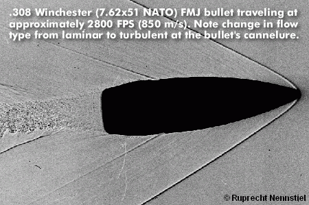

And those exterior grooves dont really effect or drag on the bullet in flight as the bearing surface it is in a laminar flow area and it just sort of glides smoothly past. A cannelure that cuts across the bullet instead of along it length causes a disturbance.

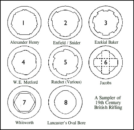

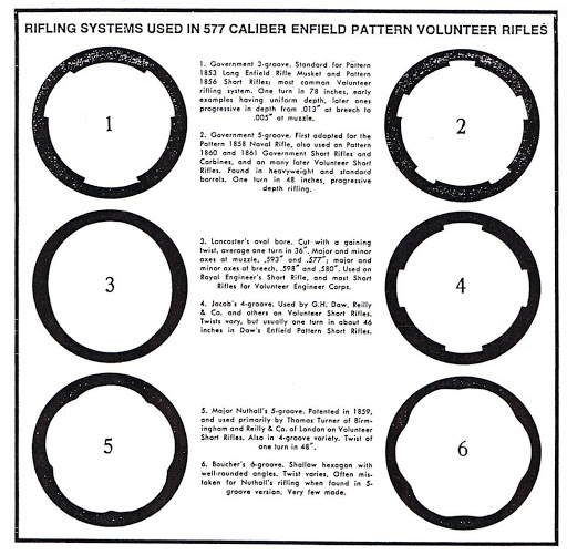

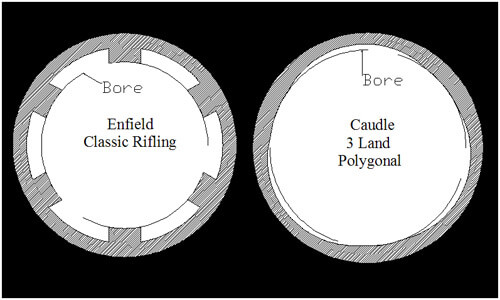

You noticed that the lands are small, what happens if instead of a 4 groove barrel you had a 5 groove or a 6 groove or a 3 groove, the proportion of the lands to the grooves with respect to the total surface area has to change. A 2 land barrel will have much wider grooves and lands than a 5 groove will but the total surface area of each should roughly total up to about the same.
Then you have the actual geometry of the individual lands; polygonal that was shared, you can also have a 5r
Or anything else thoughout history!
That said, when the lead core is swaged into the copper jacket its really freaking forced in there and its solid. If the bullet was created evenly and the barrel is even through out its length as it should be than any disturbance should be evenly applied to the bullet so even if it did swirl inside a smidge (which it doesnt) it should still result in an even result.

I'm not doubting their engineering...…….. My guess is the copper and lead both are being smeared in a spiral pattern but to what extent I don't know.
