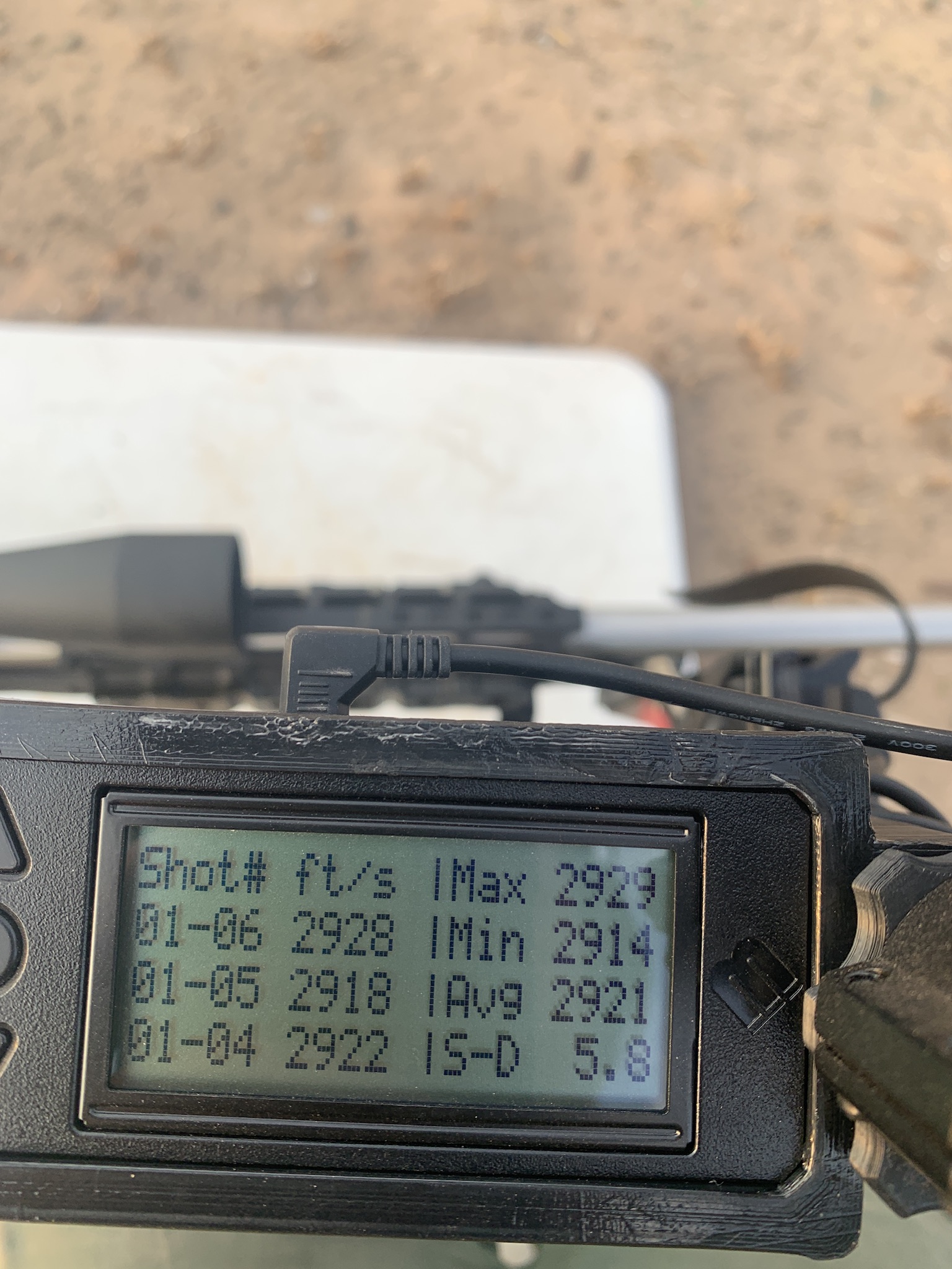

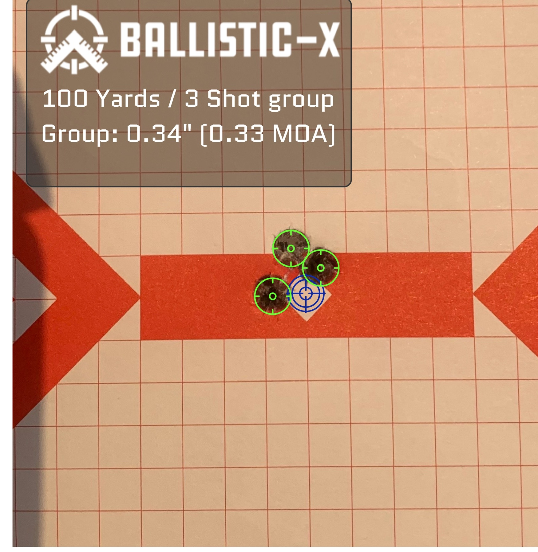

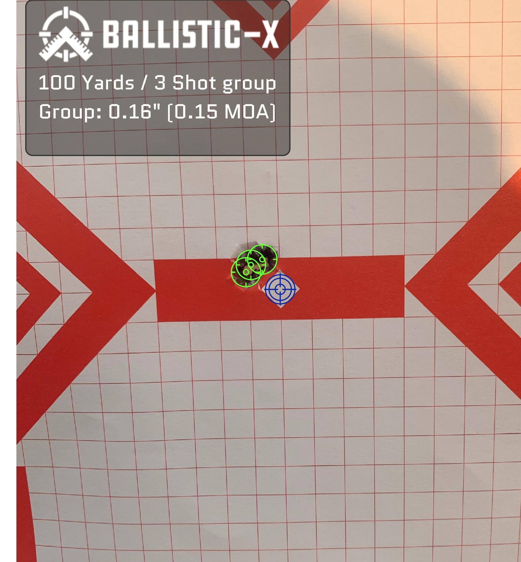

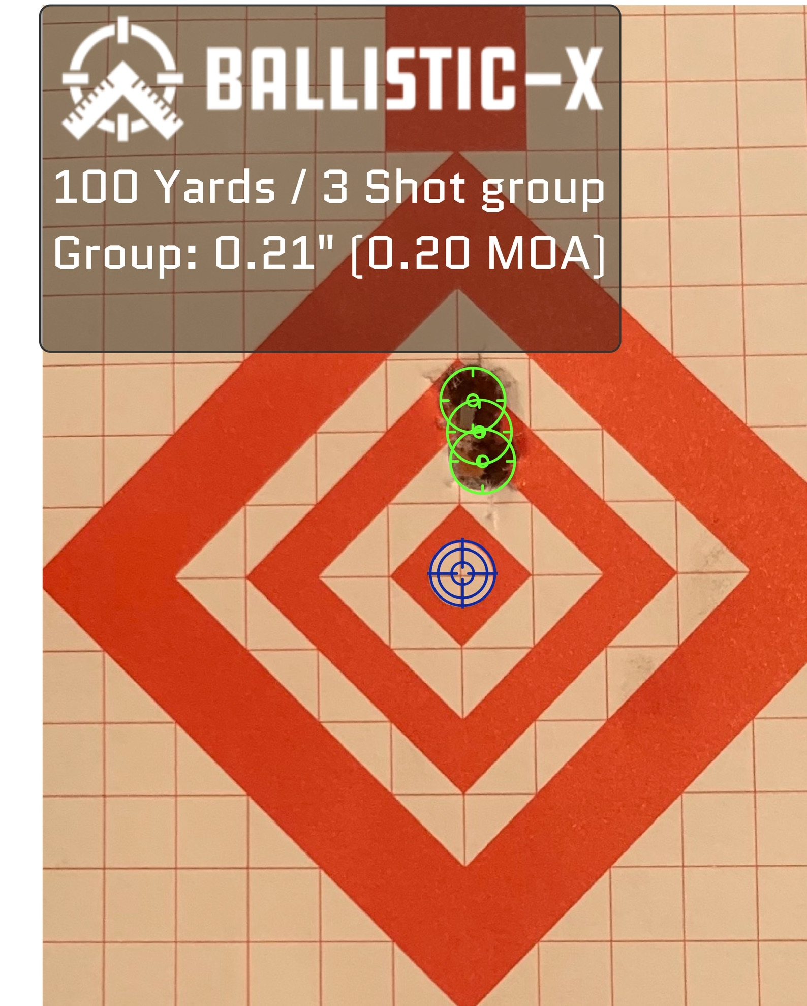

This is with a random 35.0gr varget, Berger 109’s. 0.020 jump. Reamer has the same body dimensions as 6.5x47, with a .275 neck and .150 freebore.

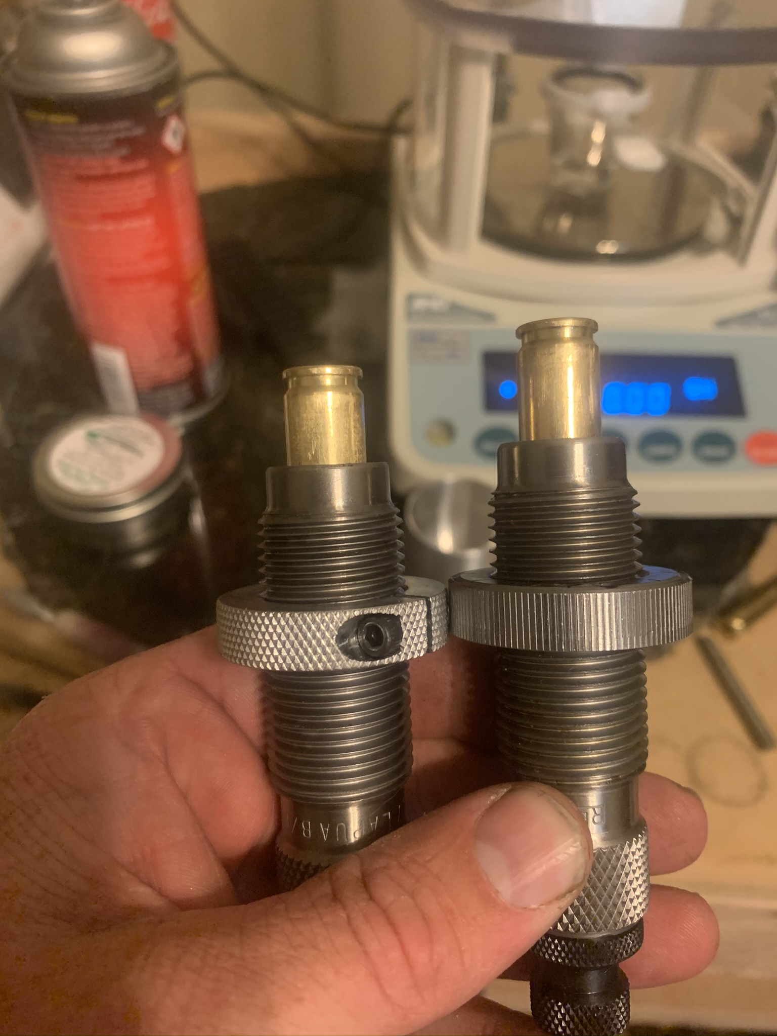

Here is two 6x47 casings fired out of the same chamber. The left is a Redding 6.5x47 die and the right is a Redding 6x47 die:
  • Wow
Reactions: Money Waster
Are those bushing dies or FL sizing does? What do you use for your reloads?
FL bushing dies. Apparently Redding is using a spec that is based off one of the smaller body 6x47 prints.
I use the 6.5x47 die with an appropriate bushing. Since my reamer retains the same body dimensions as a 6.5x47

Isn't it recommended to use a FL non-bushing die, like the Forster, to size down from 6.5 to 6x47L? It will size the neck all the way to the shoulder, and from what I'm reading it will also reduce the likelihood of getting crushed cases.
That’s probably the better route.
I use a .271 bushing, then a .268. Then I neck turn. Fired cases get another pass in the turner just to keep it all shaped up.
Keep neck dia at .275” unless ya like to turn necks
Yep. I’m at .003 or so clearance with a .275. It’s enough, but I turn to get .005-.006.
That’s another culprit of “finicky” 6x47. Some reamers don’t account for the added neck thickness from sizing down.
