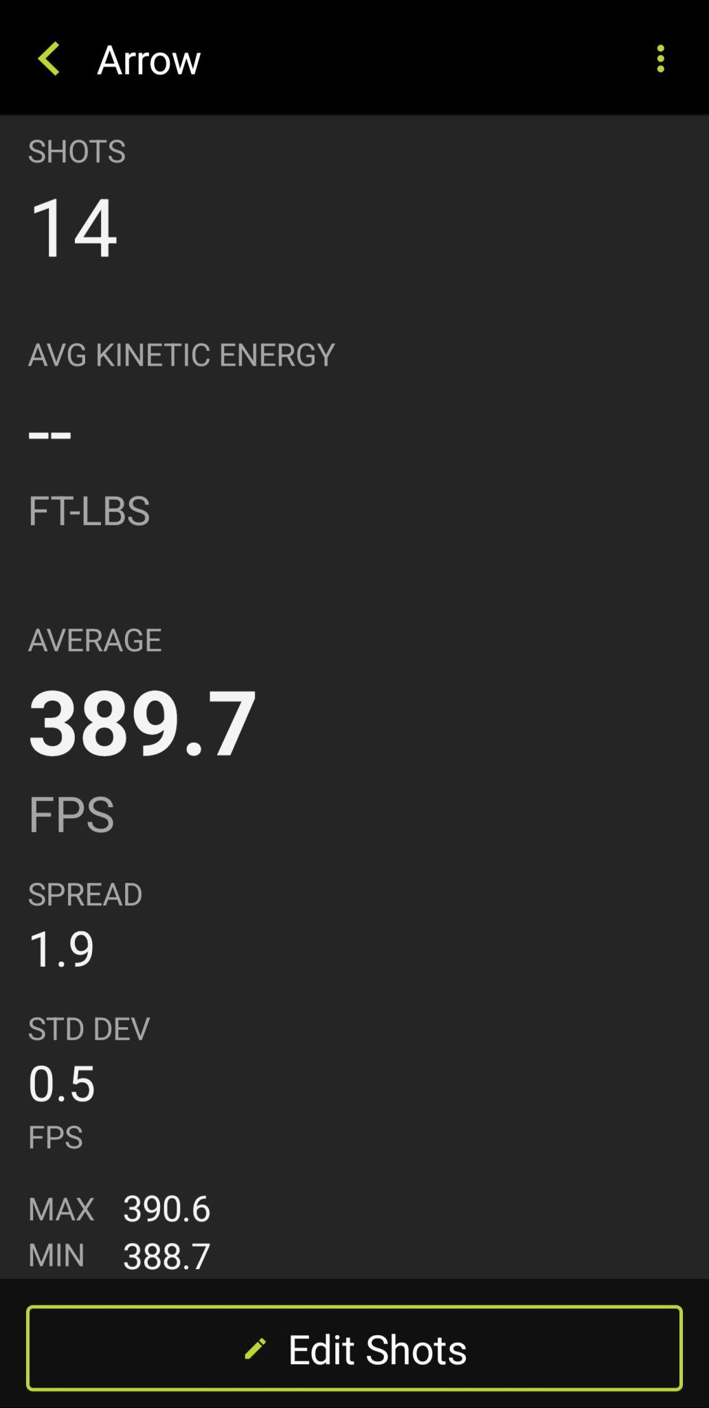

Couple questions about the garmin:
yesterday I wanted to see how heat was affecting my velocity and group so I waited 10+ min between shots for the suppressor to cool. To save battery I paused the session and powered the garmin off. Turned it on and resumed session right before shooting.
Only the first shot of the session was synced to the app on my phone. The rest of the shots look completely normal in the unit history, but even several sessions later, that session only has one shot in it on my phone.
Anyone else have that problem? Know a fix?
I forgot my other question lol. I’ll post again later
Maybe you need to sync the Garmin to the phone again?
I leave my Garmin on for the 2 hours or so I shoot, never saw the battery drain much. I only sync the phone after I get home and Im ready to send the data to my computer

Garmin out the box used a pellet gun and recorded every shot. Went to range. Set it and forget it
I "think" (but can't confirm, maybe someone else can) that if you Pause the session when you're not shooting, the battery life will be longer than if you leave it active the whole time. I can't remember if I read that in the manual, on a thread here, or if I just assumed it is like the LR in that regard.
Idk? But I turn mine off after each group not before syncing to phone and punching in title for it. It’s lasted well over 6 hrs like that. Steady running I’d say 6 hrs max. A pause I’m unsure makes it last longer too
I’d think any not-a-session uses less battery than a session because the radar isn’t emitting. So pausing a session turns off the radar, no? I bet it saves a lot of battery

I’ll bet, if you kept notes, the Xero was the faster one, because of the mount. Again though, insignificant difference.
