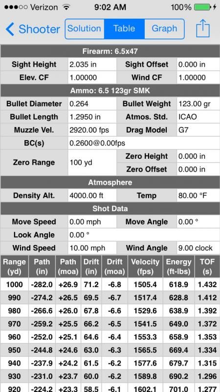

Having some issues with the Applied Ballistic app when entering either 3 or 9 o'clock wind values. The difference in come-up, just short of 1 moa at 1k. (Would like to print some charts). Is there a way to negate this?
Lost faith in Ballistic AE when I realized adjusting temperature values when using DA did not affect the calculation.
Are there any apps out there that disregard wind direction in elevation corrections while considering temperature?
Having some issues with the Applied Ballistic app when entering either 3 or 6 o'clock wind values. The difference in come-up, just short of 1 moa at 1k. (Would like to print some charts). Is there a way to negate this?

I didn't mention a tailwind or headwind. When changing from a 9:00 to a 3:00 full value cross wind, the elevation correction changes by just short of 1 moa. (Applied Ballistics app) This is a right twist barrel.
Oh shit, 3:00 and 9:00 was my intention.
Think I found the app that doesn't discriminate between 3:00 & 9:00 winds, while giving small elevations adjustments for temp swings all while using da. (Shooter)
I've always understood da includes temperature in the calculations but I have confirmed temperature affects elevation corrections with both Applied Ballistic and Shooter while using da. (Only changing the temp value). It's not much but makes a difference.
At distance, a 3 or 9 wind DOES have an effect on elevation, and it SHOULD have a different come-up, so AE is working correctly. The reason for this is bullets are travelling slightly nose up and pointed towards the twist direction, which means a wind from 3 causes a little less drop and a wind from 9 causes a little more.
Temperature is a factor in the calculation of density altitude, there is no "temp swing" at a given density altitude. While it is possible to have a given DA at multiple temperature points, the station pressure and humidity will have changed, and the resultant drag will be the same.

You are correct, going on an out of state hunt and trying to make da charts. I would've been fine if I didn't mistakenly change the temp. Wasn't much but got me questioning everything. Here's a sample of my match rifle data with just temps swapped out.
