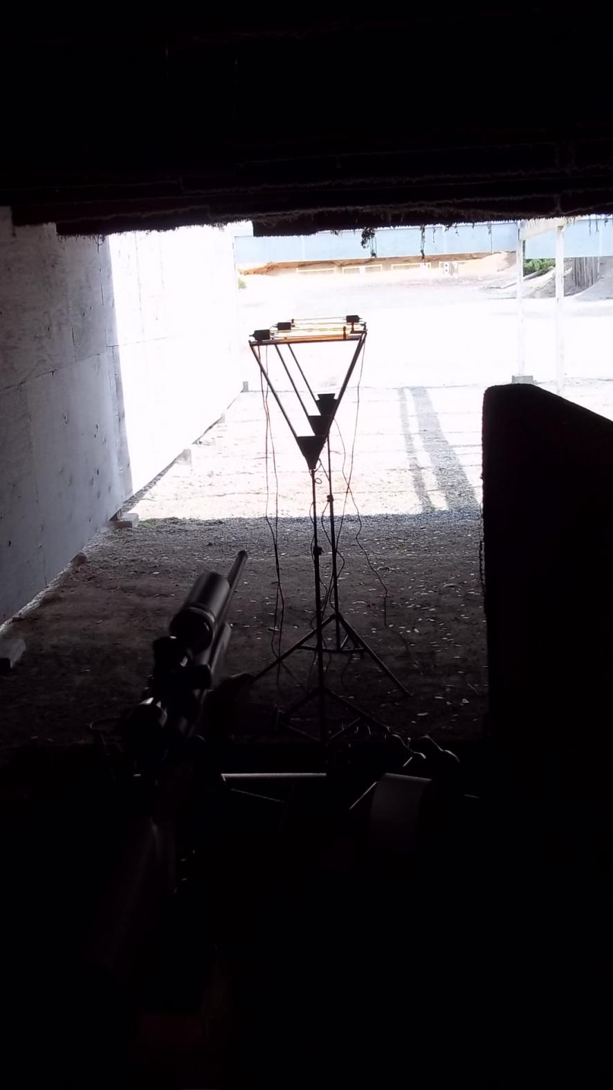

The pictures show me shooting over an Oehler 35 with the lights on to better capture the bullets as they fly over the proof channels and the rewards of producing very good reloads.
