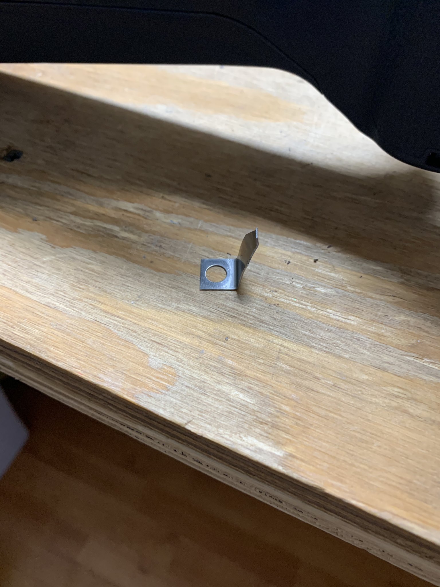

    my calipers dont go that far, but using a tape, they both come out to 7" center to center. I noticed my 6.5 did not have the little metal tab on the trigger housing, but the 223 tikka did... supposedly it’s to hold your mag in? The 6.5 fit in the new bravo, so I took the clip off the 223 and it fits. I’m guessing I don’t need the clip?

    That little clip is 4 polymer mags on Tikka T3 it's somewhat of a commodity in that you can't just order it from Tika last I checked don't throw it away hold on to it someone will probably need it
    Tikka rifles, aside from ctr/tav A1, use that small clip to hold the plastic tikka mags in place. Moving to a chassis using aics or ctr mags means it needs to be removed as it will do what it did to you.
