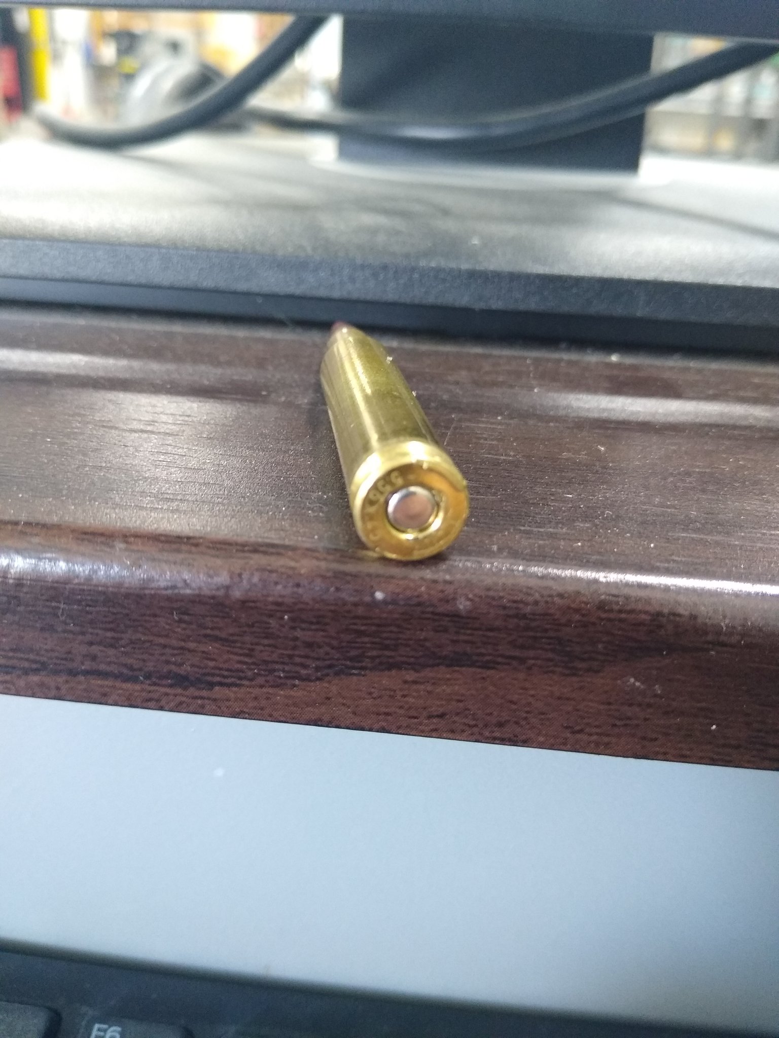

No I wasn't in a battle situation, I did leave the range to go home and take care of the problem in a safer environment. I don't think the RSO would have appreciated me mortaring my rifle, even if I had known about that as an option. I did get the round out by separating the upper receiver and lower receiver and with a screwdriver (and padding to protect the lower receiver) I pried the bolt carrier group open, it actually came out fairly easily. I just didn't feel like a had an appropriate place to mortar the rifle. The live round in the chamber came out easily.

A good chamber cleaning and evaluation of your reloads so it doesn't happen again.
The case had a damaged rim that wouldn't allow the bolt to fully engage with the case and therefore the firing pin didn't strike the primer.

That damage to the rim is from you trying to rack the round out of the chamber. That area is from the extractor trying to do it's job. There's something else going on here.
If it were me I'd get a hornady headspace comparator tool & check shoulder on a factory round vs one of your reloads.
Picture is sort of out of focus. The rim damage looks to be extractor slip over (on the back side of the rim).
You probably have an O-ring on the extractor spring and it is tight.
But, I doubt the rim kept you from extracting the round.
This may have been a one time event with a reload.
Things to look for are headspace as stated in post above,
Crimp bulge,
Chamber residue from steel case/polymer coated rounds.
BCG cam pin digging into upper receiver.
Using the forward assist to turn a little jam into a big jam :)
I check all of my loads in a Lyman case size gauge, once after resizing and once after seating the bullet. I've used the Hornady headspace comparator tool before on my bolt rifles. I haven't done it with my AR yet.
