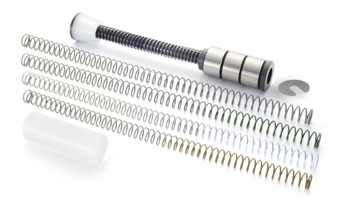

Is there a reason that nobody talks about the JP captured buffer system anymore? I know it used to be all the rage a couple years ago, but I haven't seen it mentioned for awhile. I have one in a large frame gas gun, and I'm thinking about throwing some upgrades in my 556 as well. Is there a better product on the market?5459.jpg

I've had a few. Definitely feels smoother than the spring sliding in an aluminum tube, no twang when shooting suppressed which is nice. Not sure i'd spend the money on a different product. JP is one of the few companies that really impresses me with fit/finish and design.

    If anything I think they've improved on it. Now you can adjust spring rates and buffer weights, they have versions for folders and large platform ARs.

    They do have spring packs that you can use to further tune if you want. But for an AR, unless you have a low mass bolt, adjustable gas block, tuning with this probably won't get you a whole lot. For me, personally it's just a nice extra that eliminates spring noise and smoothes out my AR. It's not going to give you any noticeable difference in performance.

    It eliminates carrier tilt, And it's fine tunable for the reciprocating mass and spring rebound rate. Whether you're running a combat style suppressed system or a fine tuned Long range precision rifle It offers nothing but added benefits. to this day I have still never seen any reports of a JP SCS failure, The only thing I ever read about is people not understanding how to adjust them.

    I have 2 guns with these SCS systems. Yes they quiet down the noise and do make the action feel smoother when racking the gun. I just received a Tubb recoil spring that many have reported will get rid of the spring noise in the buffer tube also.
    Figure I will try it for less than 30 bucks before I spring for another one of these SCS systems. Happy with the 2 SCS I have, just wanted to see if I could get 90% of the improvement for 1/5th of the price with the Tubb spring.

    Nothing that most SCS owners want to hear.
    I only tested it in small frame, so maybe in large frame or blowback it shows some advantages that I don't know about.
    I tested in two 223 AR's at opposite ends of the operating spectrum. One was a 22" precision type gun with heavy components and hot loads. The other my main 3 gun rifle with ultra light reciprocating mass and primarily using light 55gr loads. Both with thousands of rounds through them and any sproing noise long gone.
    At the time I had almost the full Sprinco range on hand and a variety of buffer weights. The SCS was borrowed and had all the springs of different rates with it.
    The 22" rifle was tested from prone and barricade, looking for movement from POA during firing. The 3G rifle was tested by shooting pairs offhand on paper from 10-40 yards and measuring the dispersion on target.
    In both rifles the SCS with X spring rate performed identically to the standard components with the equivalent spring rate. No discernable "smoothness" difference was felt during shooting.
    The SCS owner very reluctantly agreed that the SCS gained him the smooth feel while charging that a well used rifle has, in his brand new rifle.
