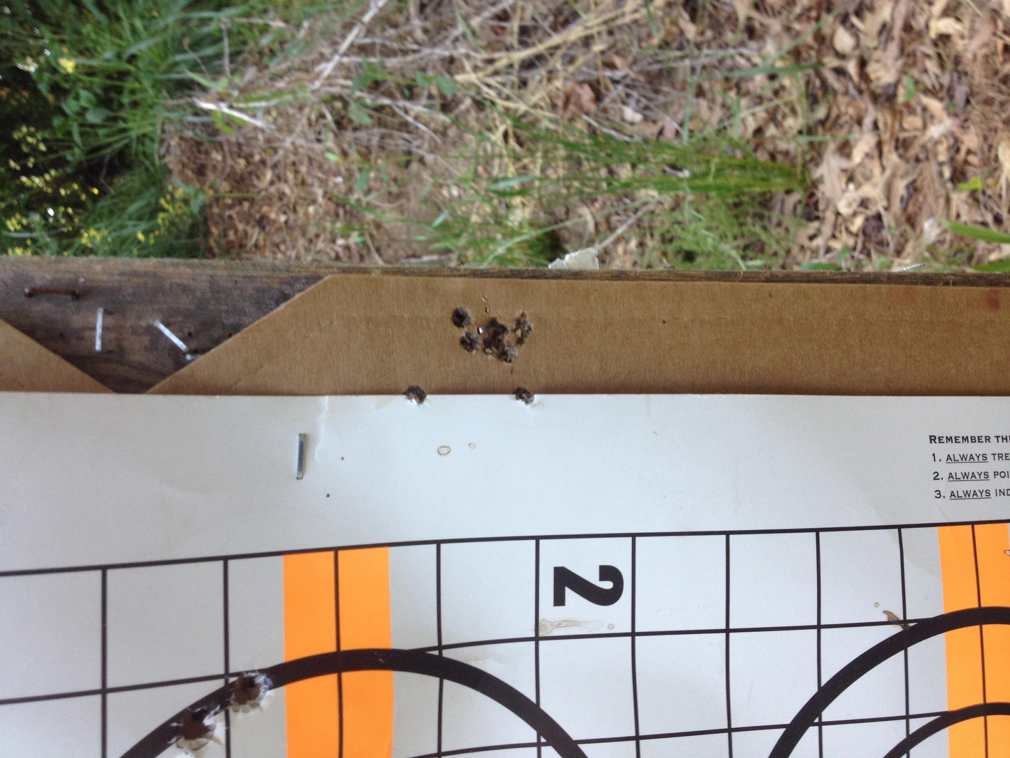

This is 10 rd of 77 gr FGMM (I think it was?) through a normal CL SR15 E3 upper I just sold on here from 100 yds. I actually bought an LPR upper to replace it and have a SF mini for it, will be identical to yours.
