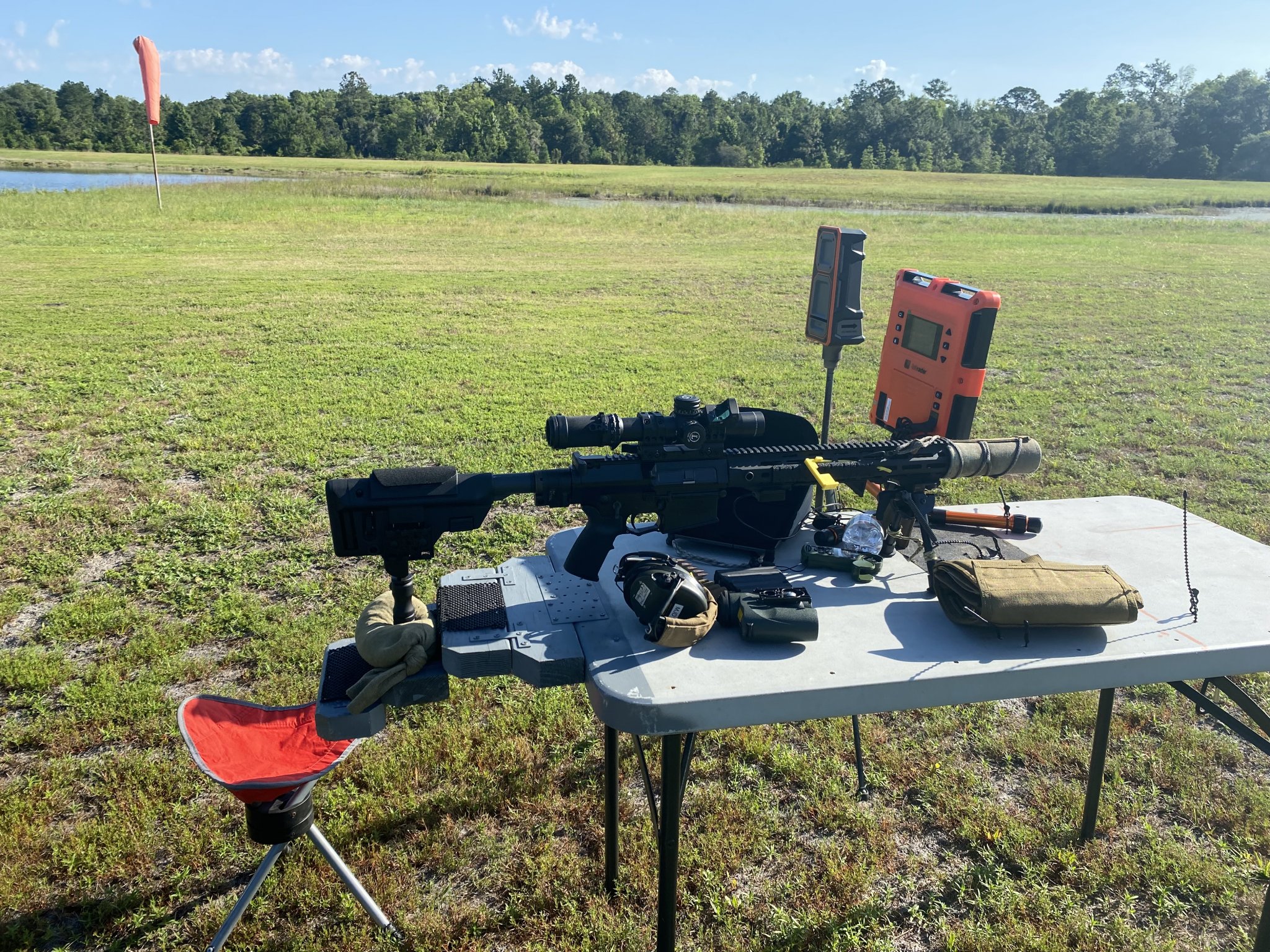

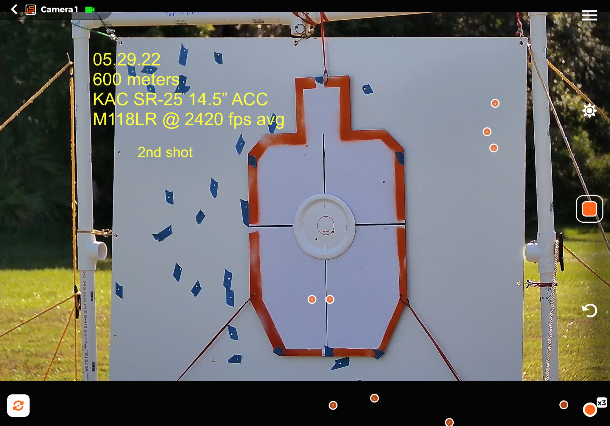

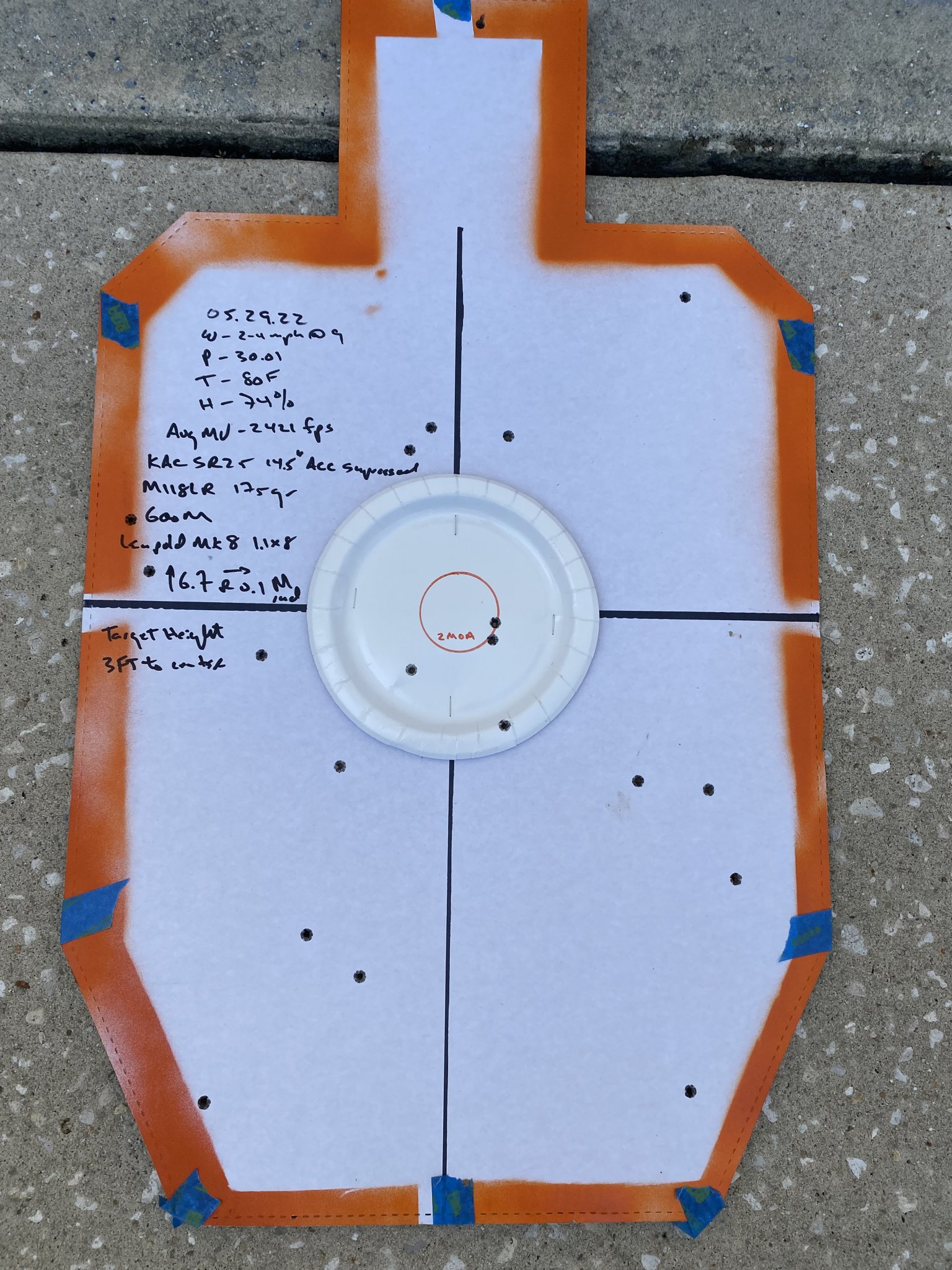

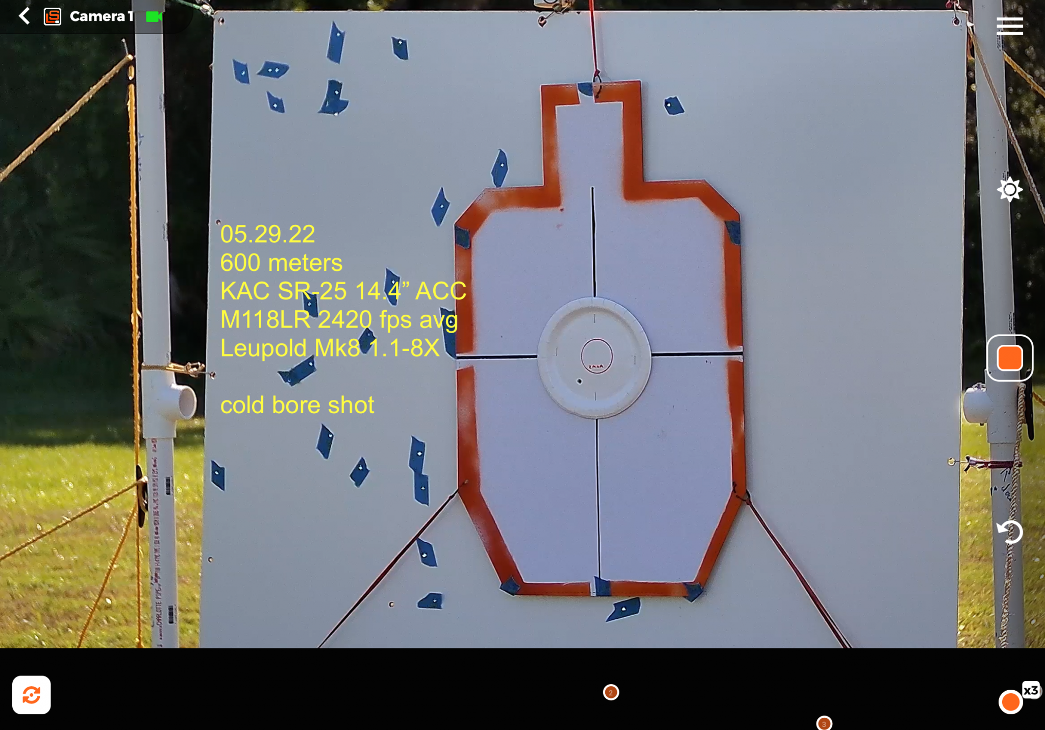

I have this SR-25 ACC 14.5" with minor modifications. A few 600 meter target photos.
Did KAC expect a better target impact @ this range?
Thanks.
Thanks.
View attachment 8235551View attachment 8235552View attachment 8235555View attachment 8235558View attachment 8235560
Did you shoot it unsuppressed?
I have not done so yet. I have scoured the internet and have yet to find target examples beyond 200 meter for 14.5" ACC.

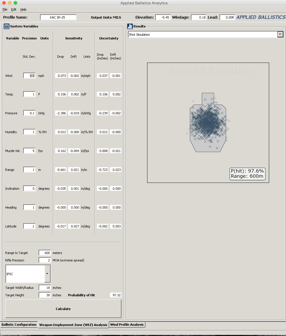

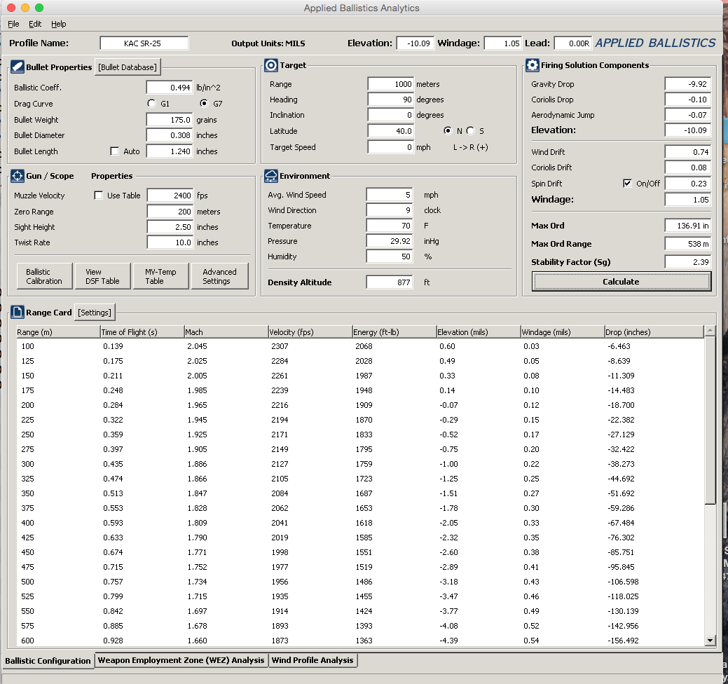

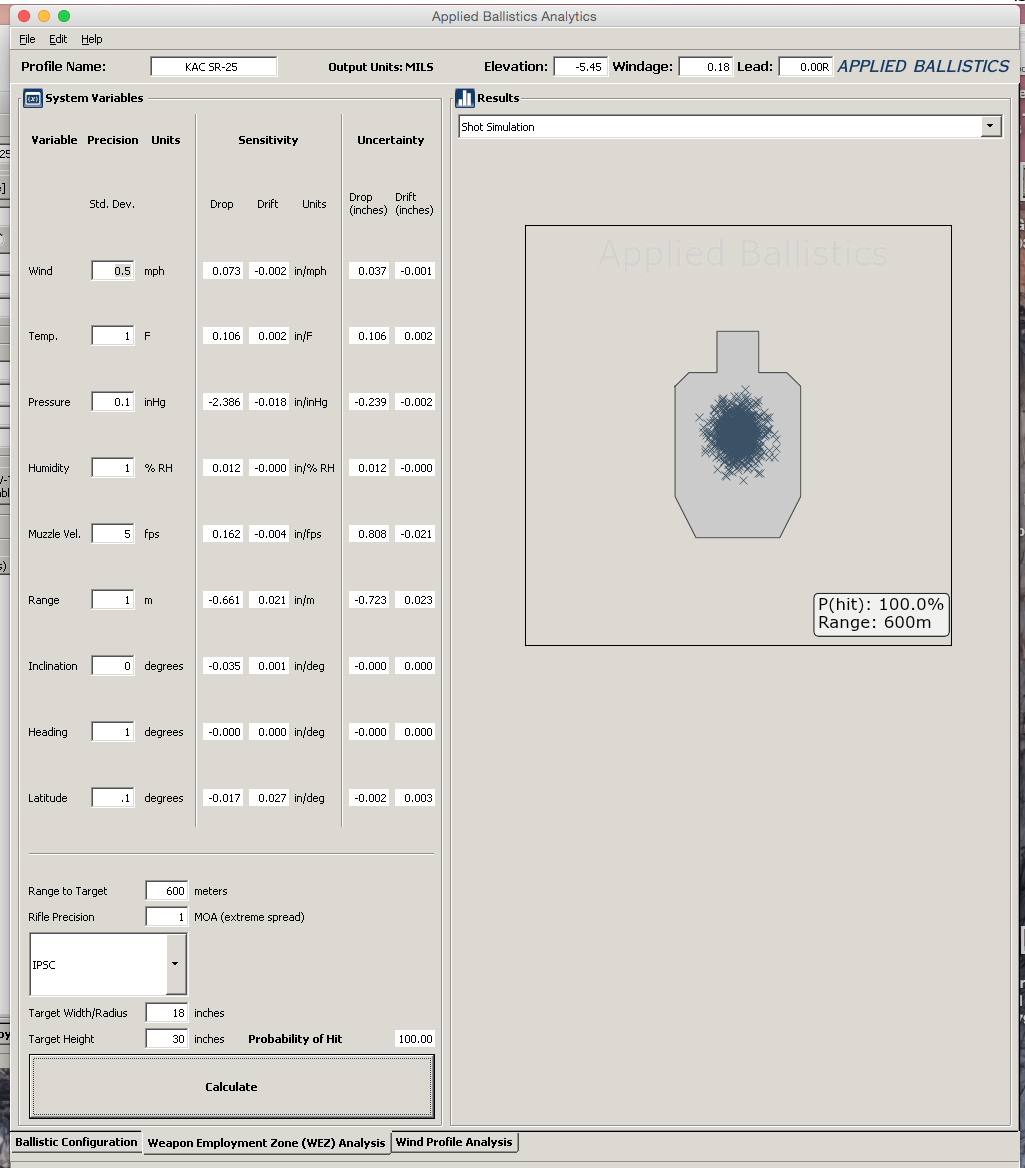

I have Applied Ballistics hit-probability given the all the relevant data input, but it is still just a computer model output. My muzzle velocities are
at 2400 fps and AB predicts 1496 fps @ 600 meters, close to trans-sonic.
AB predictions @ 1.0 & 2.0 MOA.......my target looks like an intermediate of ~ 1.5 MOA, as none of my shots were off the target. The 1.5 MOA is more in line with Bryan Litz's discussion on dispersion expectations.
Would really like to see others real target results at this range.
