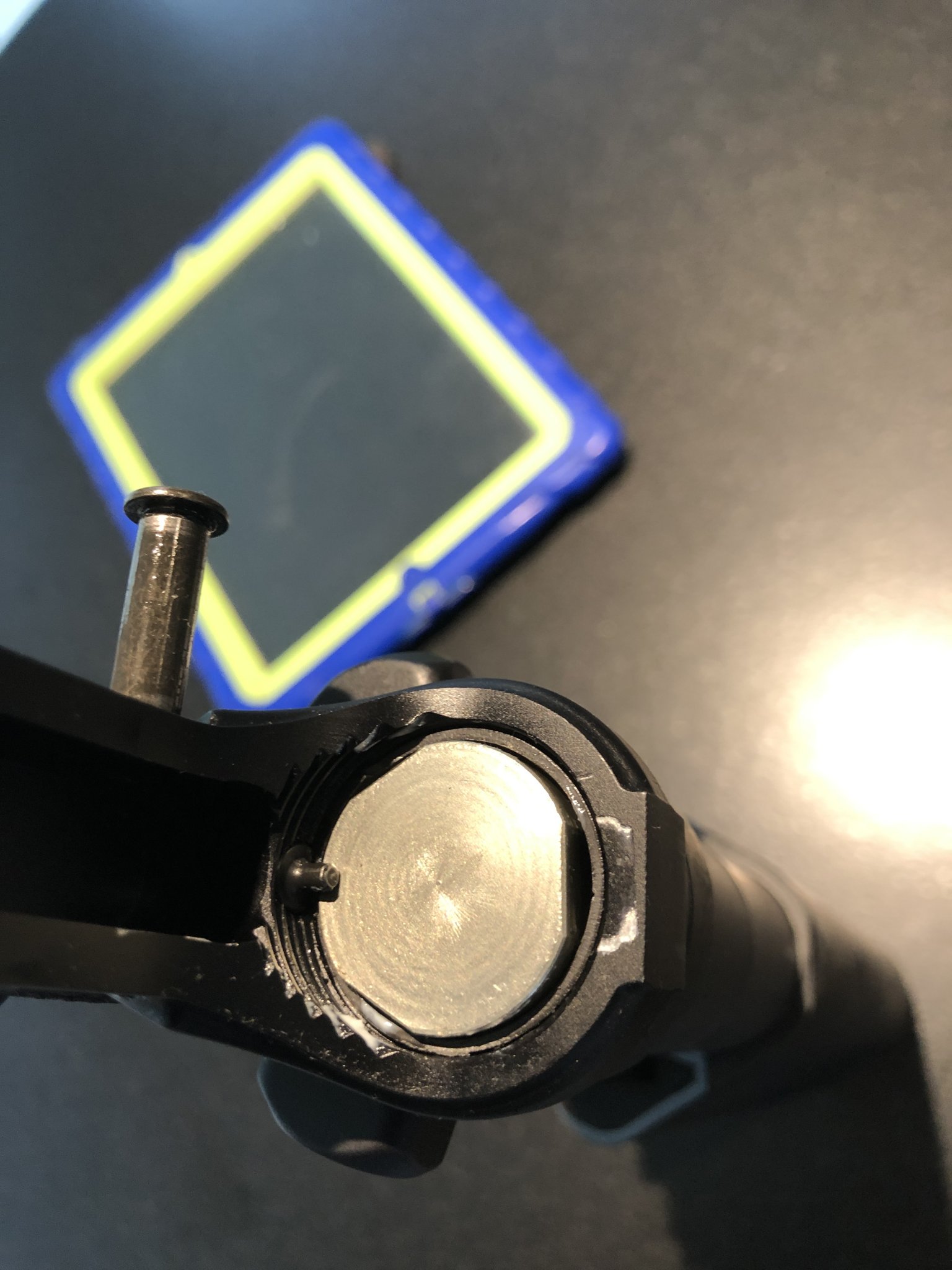

Last cleaning I noted a small ghost mark where back of the gas key is hitting the lower above the buffer tube.
Replaced spring and buffer anyway before looking for two quarters width.

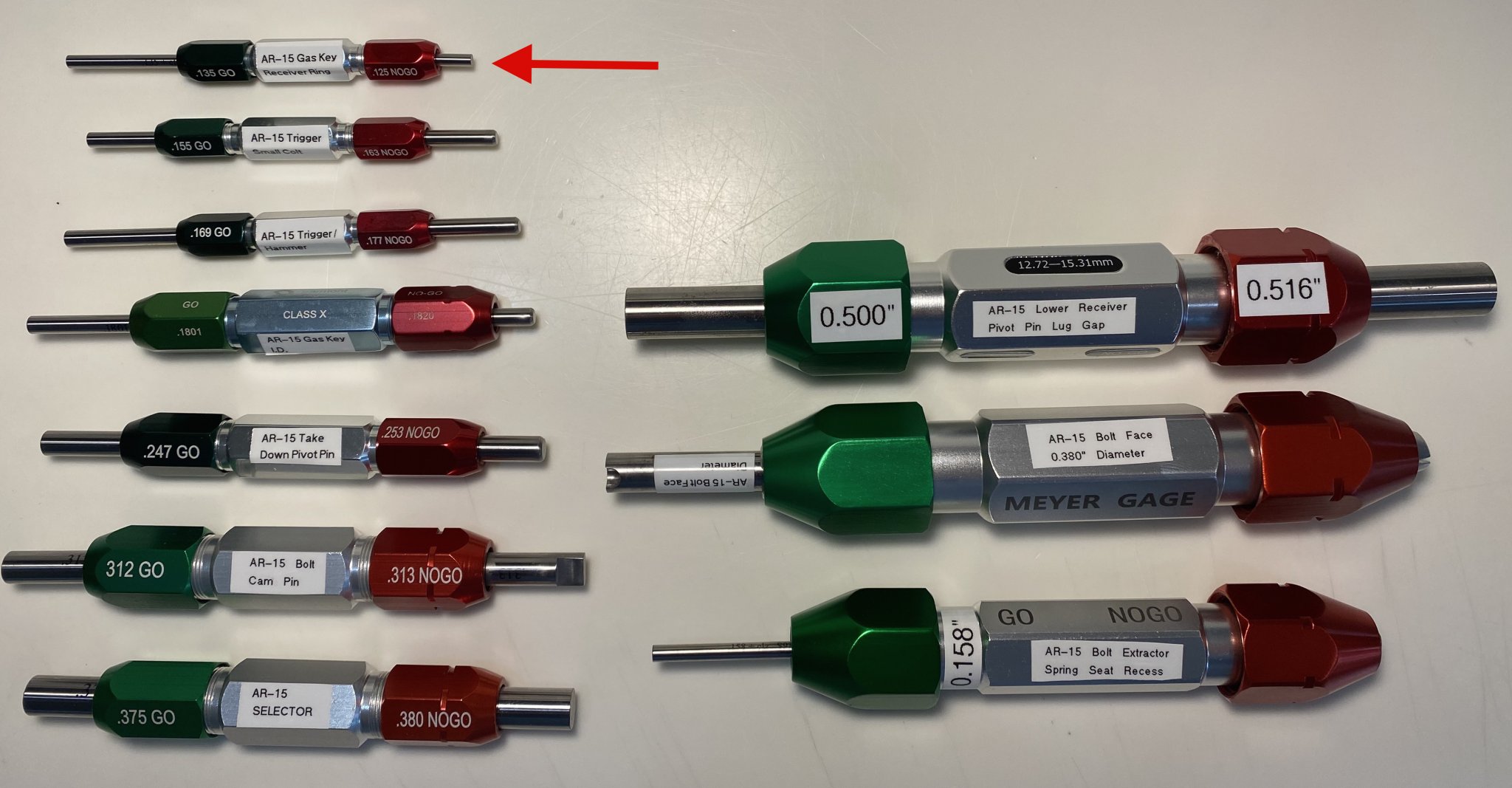

A few considerations:
Measure your carrier length......should be >6.66". IF it is, the buffer retainer pin location could be out of specification, i.e. drilled too
far rearward.
Make sure that rifle-carbine receiver tubes have correct rifle-carbine buffer lengths.
Gas Key-Lower Receiver Ring Min Gap Go @ 0.1350” No-Go@ 0.125”
U.S. quarter thickness ~0.0650” x 2 = 0.130”
I use this gauge to avoid carrier key-receiver banging each other.
Oof, there's something else going on there if you're making contact with the rear of the gas key on the lower.
I wasn’t sure if it was doing it when I had the 16 inch barrel on, at least never noted it, and have only a few thou rounds with the 20 inch barrel.
Would have thought the 20 would be conducive to less bolt speed but I probably have it backwards figure as longer barrel equal more bullet speed.
far rearward.

I don't think your impacts are being caused by excessive carrier speed, I think that something is short. The key should never be able to physically contact the receiver extension thread area. Super simple check is to remove the action spring, drop in the buffer, and then drop in the carrier. Removing the hammer can make this easier, but isn't necessary. You should see a distinct gap between the rear of the key and the arch of the lower receiver. I grabbed a random one from my inventory and measured a 0.167 gap.
I through a new buffer and spring in from LMT.
I’ll try the quarters gauge and May end up with one or two at the bottom of the tube.
Been kind of thinking of going back to the short barrel at some point but the 20 shoots real nice.
2A Armament sells Delrin spacers that are center drilled for the corresponding receiver extension port. They're a really easy way of adjusting carrier depth. A soft buffer bumper can cause contact as well.
Reactions: msgriff
In addition to the above, the buffer tubes are threaded 16 tpi, so every full rotation of the tube is 0.0625" of linear movement, that'd one U.S. quarter thickness per full rotation of the tube.
IF there is available space between the buffer tube edge and its retaining pin for one more spin without binding up the retainer function one can gain some shortening of the parts stacking. Of course OAL of buffer itself should be measured to be in spec, never hurts to check. Carbine buffer mil.spec length should be 3.250", rifle length 5.920".
