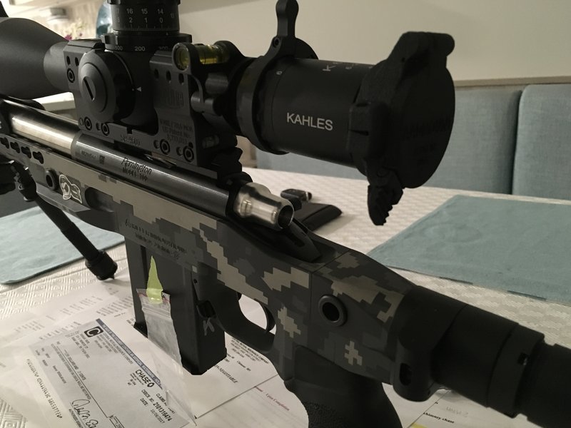

Just got the Kahles 624i GenIII, sighted in zero at 100. Shot 100, 200, 400, and 600 yards. Just getting used to the top mounted parallex but good glass saw hits on steel clearly at 600 no problem. Love the zero stop adjustment, best of any scope so far.
It own a Vortex razor gen II 4.7x27, a Nightforce Atacr 5x25, Kahles 624i, also the Vortex pst genII 5x25. Trijicon 1x8, and a Z5 Swarovski ...My eyes like the Nightforce the best. (I also sold my S&B 5x25 hated the H59 reticule.)
I’ll be shooting the Kahles a lot it’s on my practice rifle. Will update as I go.
