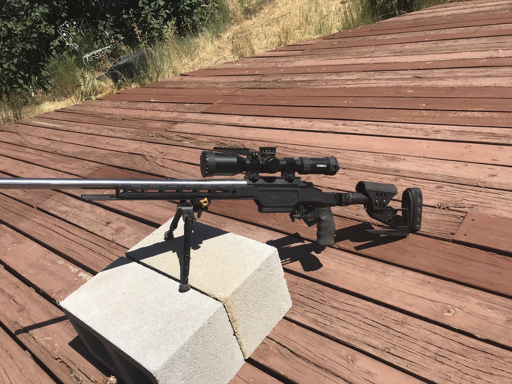

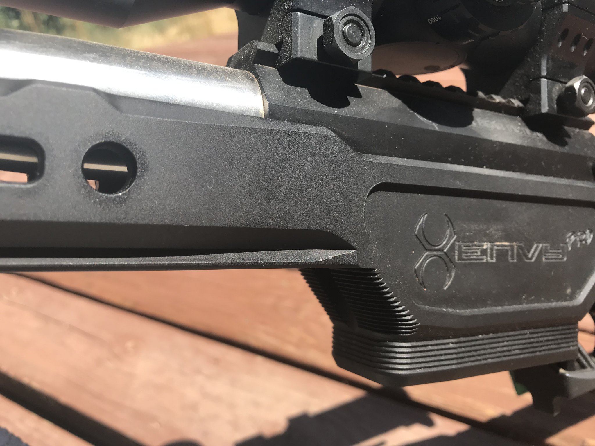

    Figure this would be the first place to ask, anyone looking for a BLACKBEAR inlet Envy Pro with full weight kit and options? basically what you get with a NYX minus the barreled action. Its the original one and not lightweight and is used but not abused. Just culling the herd from what I know I'm going to be more engaged with.
