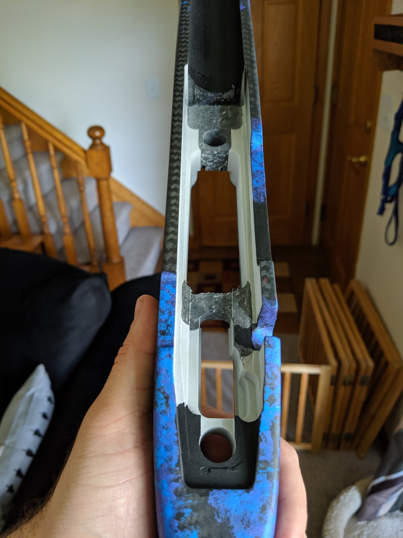

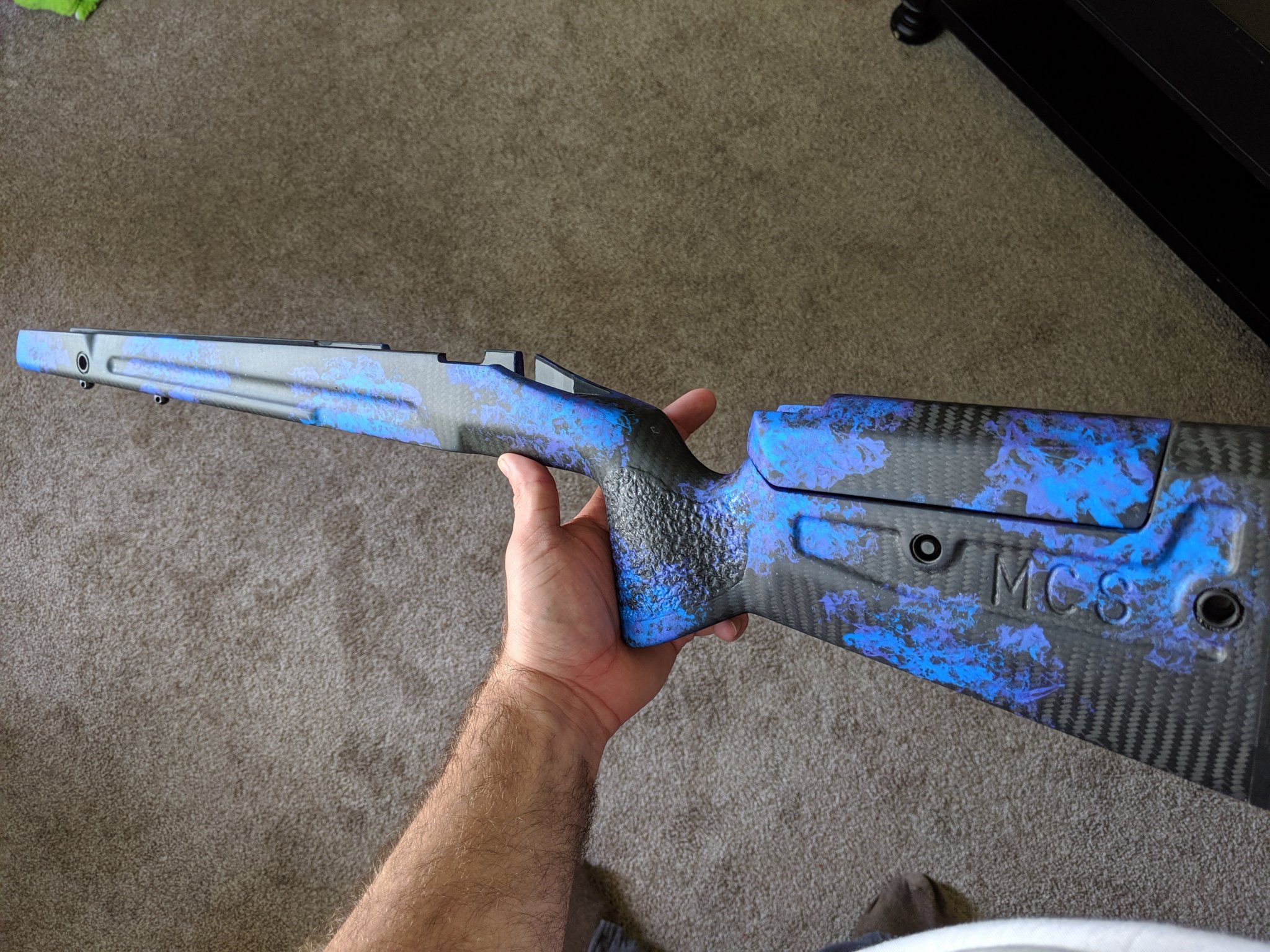

My PRS 2 came in today! All inletted by Manners. Don't have a black bear to test fit yet but at least I have something pretty to look at until then.
One thing did come up. And full disclosure I have not contacted Manners yet as I literally just got this. But it appears the pillars were not installed and instead shipped loose with the stock.
This is now raising the question of is it worth even calling and pillar bedding this? What are your guys' take on the matter?

My PRS 2 came in today! All inletted by Manners. ...
...This is now raising the question of is it worth even calling and pillar bedding this? What are your guys' take on the matter?
There is nothing to contact Manners about. Inletted does not mean ready to shoot. Inletted means ready to bed. Not saying you cant shoot but accuracy will suffer alot. With such a high end build def have it done right, ie bed it.
I don't think you bought a Manners composite stock and Black Bear action to cut corners. Sucks that you might have to do the pillars yourself as it is easier to bed an action onto pillars already secured in the stock as you can essentially screw the action down as per normal and use the pillars to determine where the bottom of the action will come to rest. There are other ways to determine the position of the action in the stock though and I understand some builders bed the pillars at the same time as the action.
You could also just ship the stock back to Manners to have them drop the pillars in like they were supposed to. Since you don't have the action yet anyway, that is what I would do. I expect they have a jig that makes it very easy to get those pillars lined up just right.

Just an update on the pillars situation. Got a hold of Manners and they are crediting me the cost of the pillars and labor. (I get free pillars!!)
They said that on this action it will need done by me or a smith to determine the proper height of the pillars with the bottom metal and action to make sure the mag latches and all that.

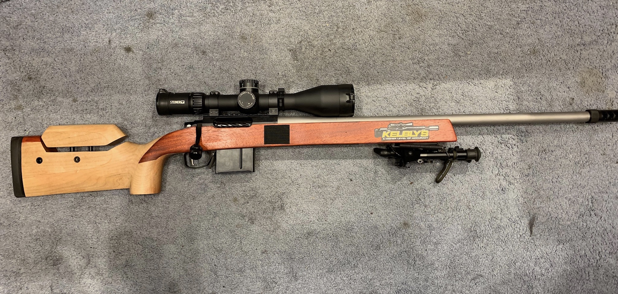

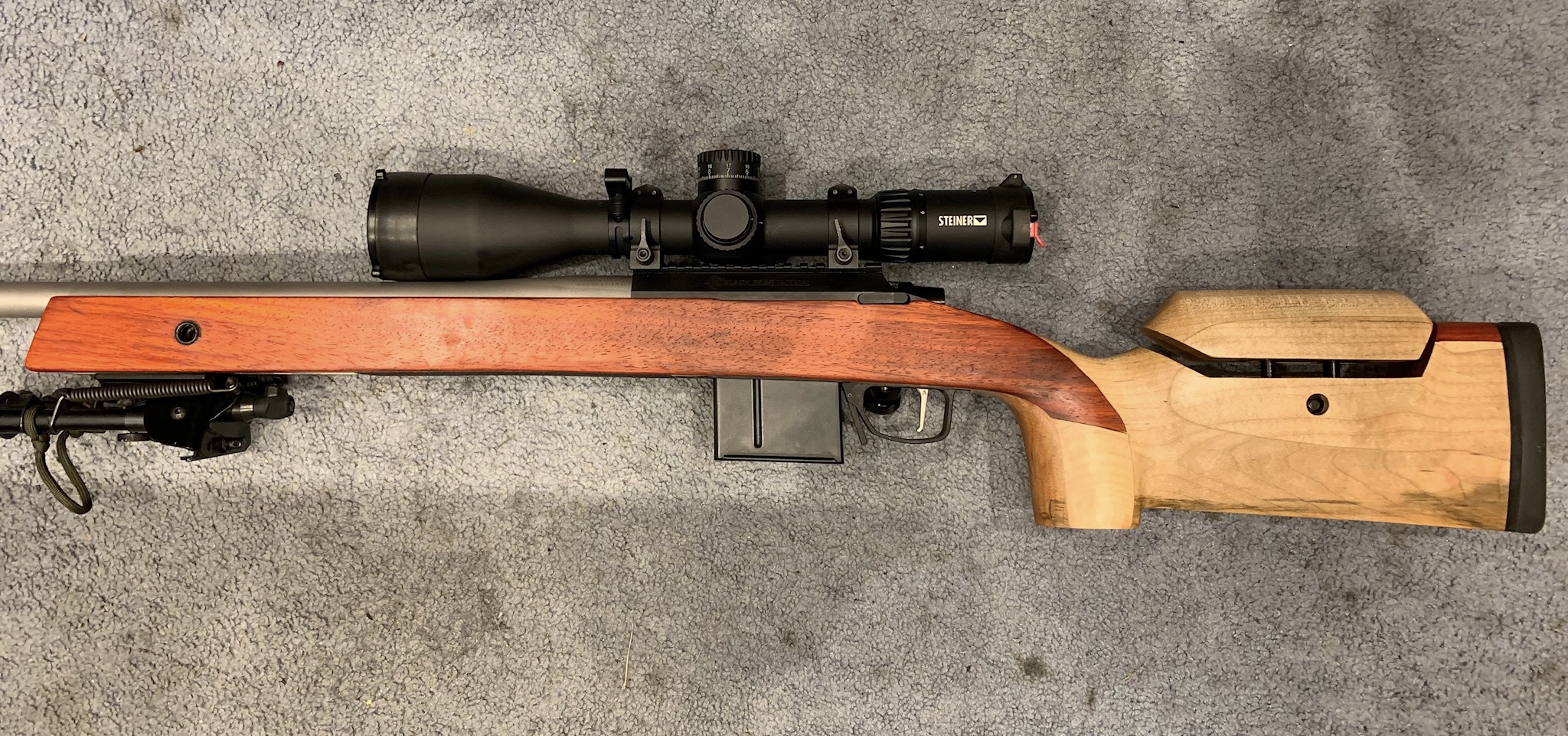

Spent a couple of days in the shop building on this Kelbly Black Bear. Chambered up a Hawk Hill Marksman and fit to a Mcmillan A5. I absolutely love this combo and she hammers! First string of load development was a success -- I think she's gonna eat whatever I put in it.

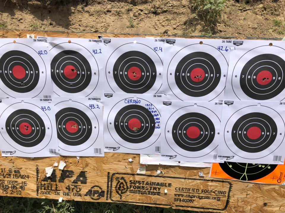

My Black Bear Tactical turned out pretty well. Krieger barrel, BixnAndy two stage trigger, CDI bottom metal, KMW cheek hardware. Stock is laminated maple and padouk, bedded with Marine Tex, added an Anschutz rail and flush cups. Pretty pleased with the Steiner for a budget scope. It will be replaced with something better soon.
Shoots pretty well, too. Still doing load development.
42.8gr seems pretty good.

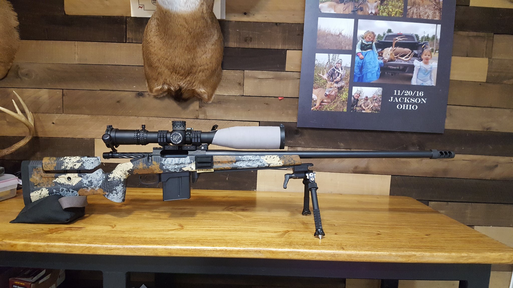

My 14yr old boy got it done all by himself this year while I was gone. He went out on his own, gutted, skinned, quarter and deboned by himself. And if you look close, yep that’s a Black Bear Tactical. @tmanners compact stock in Arctic camo, @Ian A. Kelbly Black Bear Tactical action. Kelbly’s and Manners are both excellent people to work with. If this was last stock and action I ever had, that would be fine with me.
Just about to get my gunsmith to chamber up a couple of barrels still thinking about a 22 br anyone running br cases though a Black Bear?

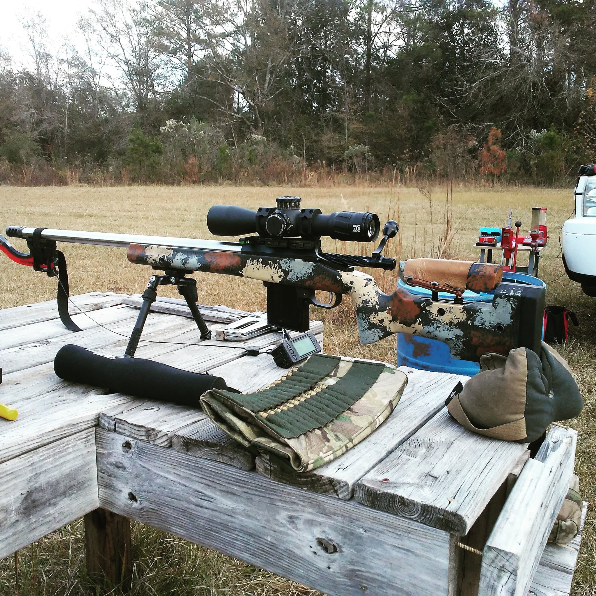

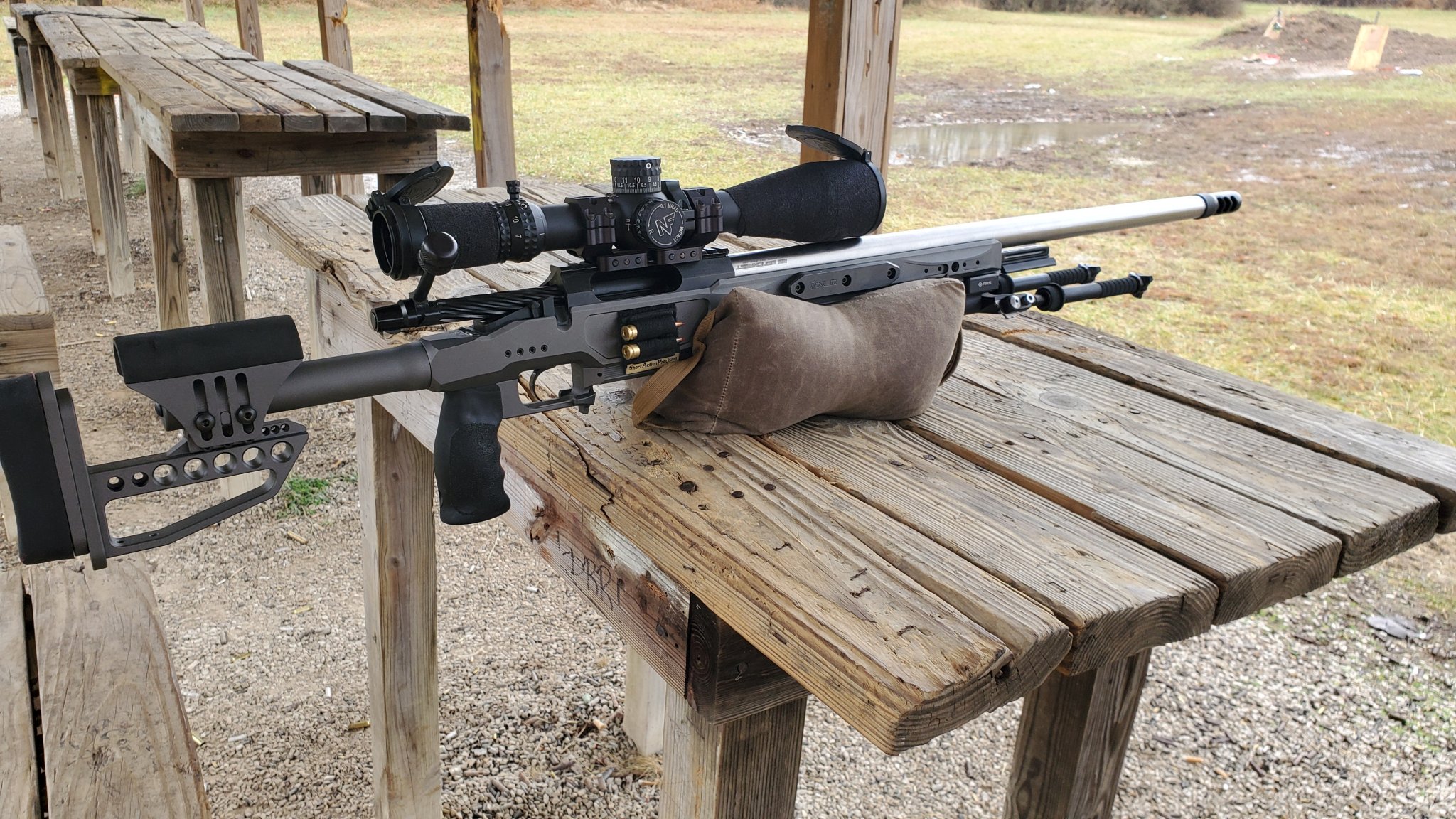

Ran my first "club" PRS match with my 22BR yesterday. (300 rounds on it now) I am using the MDT BR Mags and did not have to make any adjustments at all. I had zero feeding issues. I believe Kelbys does not recommend the BR cases in the Black Bear due to the possibility of them getting stuck in the raceway on extraction. I only had this happen once and it is when I was working the bolt real slow on an unstable platform. I noticed it and simply moved my trigger finger up and flicked it out without breaking cheek weld. I have had this same issue with by 6.5x47 barrels spun on and it is always when I am running the bolt slow.
This is great info for everyone to know. We LITERALLY want you to run your bolt HARD during matches... Reason being, especially with mechanical ejection, it covers you from short stroking and running into feeding/extraction issues.
