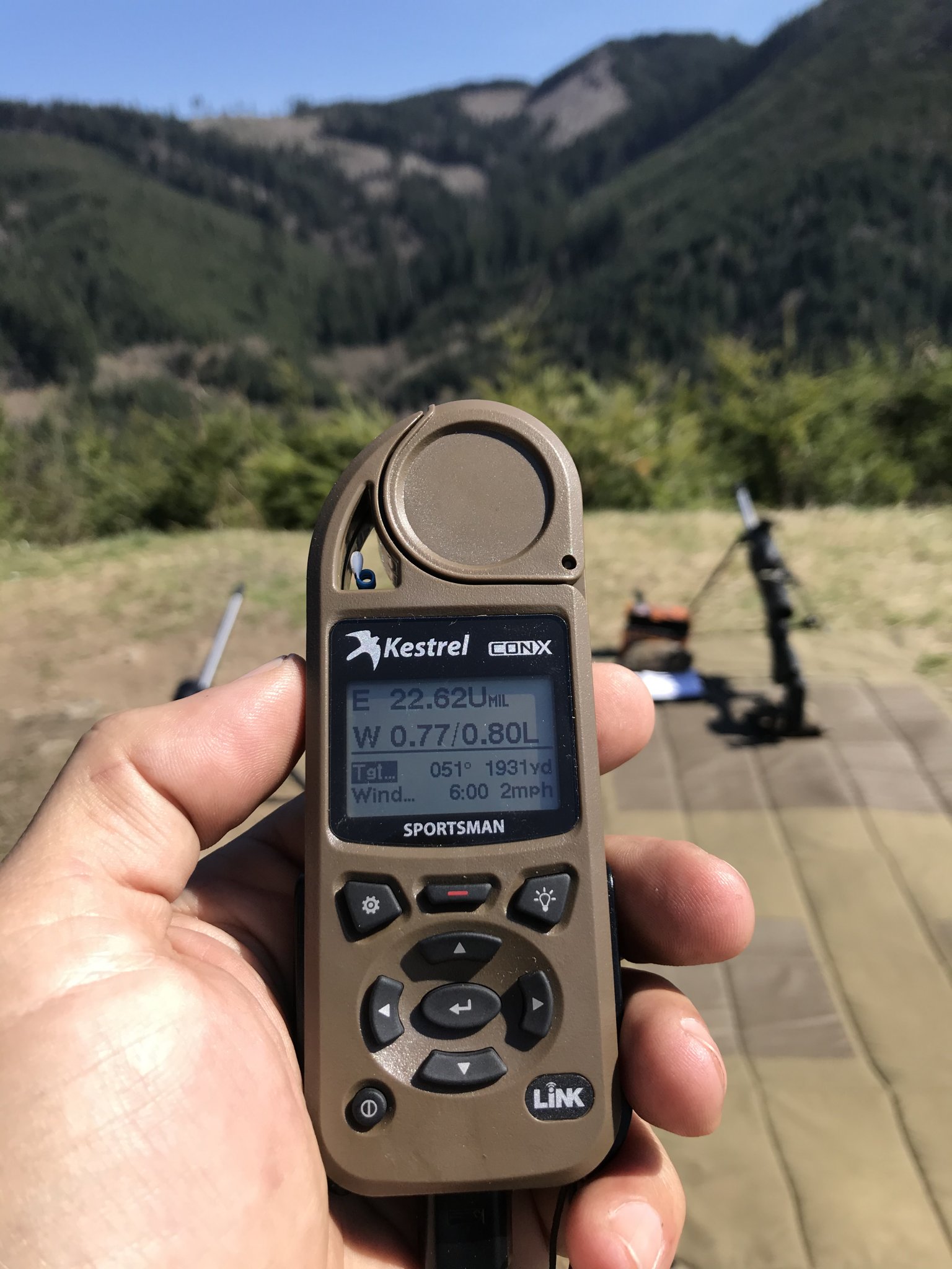

It’s not really necessary for those distances
The regular 5700 software worked excellent even further than that for me.
This was my first day with the sportsman, I trued it at 1525 yards and then tried it on the far steel at that location and it was basically dead nuts.
If you buy the upgrade you purchase it from them and they send you a upgrade file via email and you use your computer to transfer it to the kestrel.
