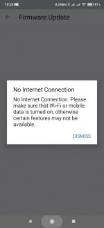

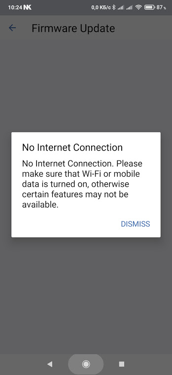

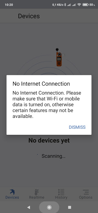

I've downloaded another Kestrel Link app. When the application is launched, it does not connect to the server and writes that there is no Internet connection. Internet connection is solid 500 mb/s
I connected the app via Bluetooth with my Kestrel and tried to update the firmware from the application, but it failed again.
an error popped up about the lack of an Internet connection.
I turn on the VPN on my laptop and everything works. But I can’t enable vpn on my cell phone, and I can’t update the firmware of the device.
most likely New hosting does not allow IP requests from Russia. Therefore, neither updating the firmware nor simply visiting the site works. you need to write to them to fix this problem.

Most likely I understood what was the matter.
Kestrel has launched a new site for shooters. https://kestrelballistics.com/
And the direction for other purposes and with other devices was left on the old website https://kestrelinstruments.com/
If you have Win10 on your laptop you could start a WiFi hotspot on it to share the VPN connection with your phone.
I use VPN extention built in my browser Chrome to web surfing. I can't share it
Access Denied​
kestrelballistics.com is using a security service for protection against online attacks. An action has triggered the service and blocked your request.
Please try again in a few minutes. If the issue persist, please contact the site owner for further assistance.
alex2x2 you have not been banned, if you continue to have problems with firmware update through your cell phone app call 800-784-4221
Your hosting server does not allow IP requests from Kz I called a few of my friends to update firmware of their Kestrel 5700 elite with link. everyone has the same issue. Nobody can't update
Your hosting server does not allow IP requests from Russia. I called a few ща my friends to update firmware of their Kestrel 5700 elite with link. everyone has the same issue. Nobody can't update
Well, I learned you are correct. Try turning off WiFi and see if you can link and update that way. Maybe cell service will bypass the block.

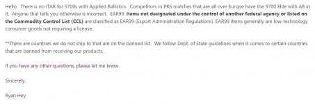

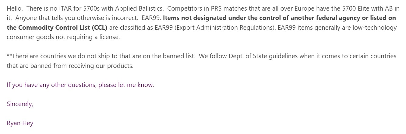

Yes. I have been instructed to watch ITAR and EAR99 restrictions in regards to all devices with AB on board.
is there a list of products that cannot be exported from the US due to ITAR restrictions? I use my Kestrel 5700 ballistic for shooting decisions and for observing the surrounding weather and water temperature.
Kestrel has a statement here: https://kestrelinstruments.com/compliance. It is the data inside the devices that restricts them to only EAR99 countries.
For example, I'm flying from the continental United States to Turkey with my family. In my luggage, I have a Kestrel 5700 Ballistics. I intend to use it only for personal purposes such as monitoring the weather, air temperature, and water temperature. Will I have any legal issues or not? Who can answer? Turkey is not on the list of countries under U.S. embargo.
Only applies to sales of it.
