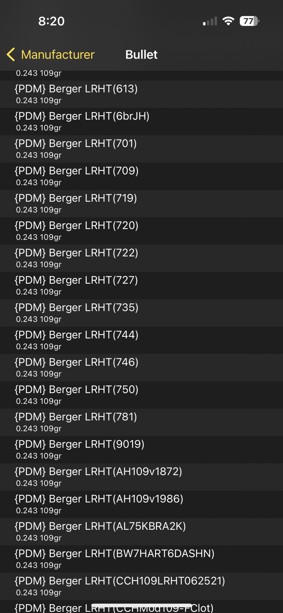

sorry if this is a dumb question, but I can’t seem to find the answer. I just went to add a new profile into my 5700 elite ab kestrel and am using the Berger 109 lrht . There are about 50 different bullet profiles and they all have that bullet and (xxxxxx) after them. What is the meaning of all of them? Also, if you use the custom curve, does it even matter?

I was wondering if that was the case but a lot of the number are only 3 long and the ones that have 4 are low. Like not velocity numbers. 1xxx etc. I agree with not using the custom curve so you can adjust. More curiosity.

{PDM} = Personal Drag Model the other number is so the person who shot it can find it in the list. They will have a print out from the mobile lab with that number and the session data.
If you select one you can choose between the AB custom curve, G1 and G7 as all of that was measured. As stated above these are of limited value as it wasn't your rifle and you have no idea what the velocity was. The curves are going to be different if it was a mild gas gun load Vs a 6mm AI +P Super Duty Barrel Burner Mach 20.
Reactions: smokinbobf4
Got it! Thanks! Kind of strange they have all of them on there. Couldn’t even find just the standard one for a starting point. Maybe I need to look better.
