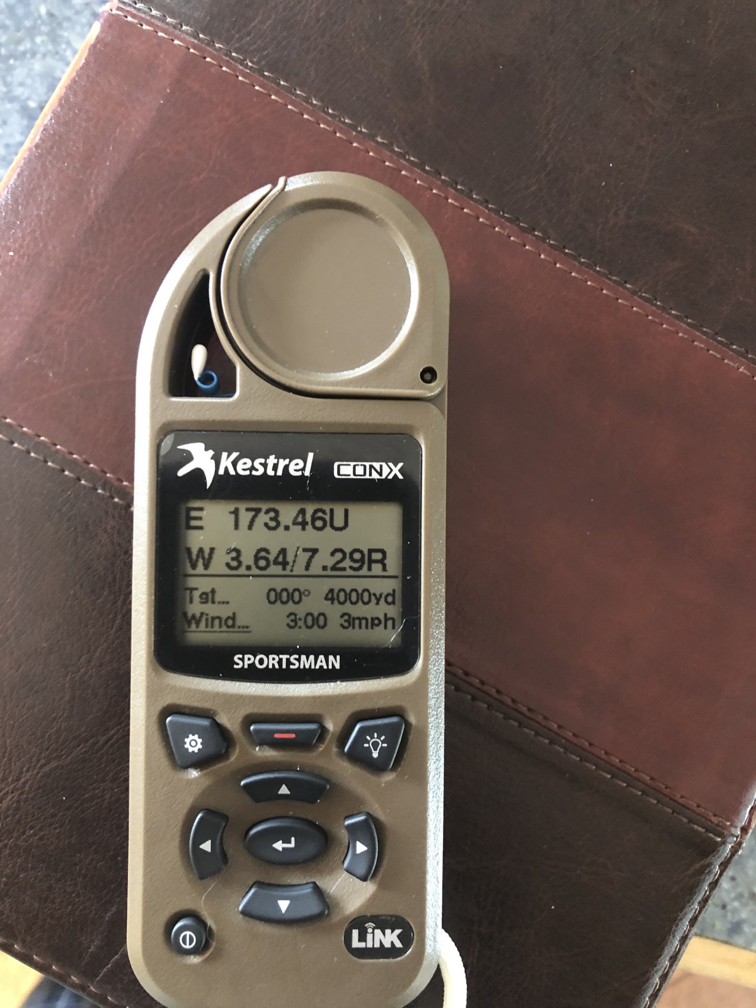

Can I ask how many yards this unit is good to? 1200? 1500?
Or do I need the Elite upgrade for firing solutions beyond 1000 yards?
For the purpose of this answer, please assume that I use 1 rifle, 1 caliber, 1 ammo, 1 scope. Same gun and same bullets every day.

4000

Per Kestrel 5700 Sportsman specs on Kestrels website it says it does not calculate drop curves so in long range shooting past 1000 (transonic and subsonic) fine tuning on your part will be required. With the Elite firmware upgrade you got the more advanced long range feature set... if that is something that matters..
Either way, you can upgrade to.elite any time and your way ahead vs buying the elite...
