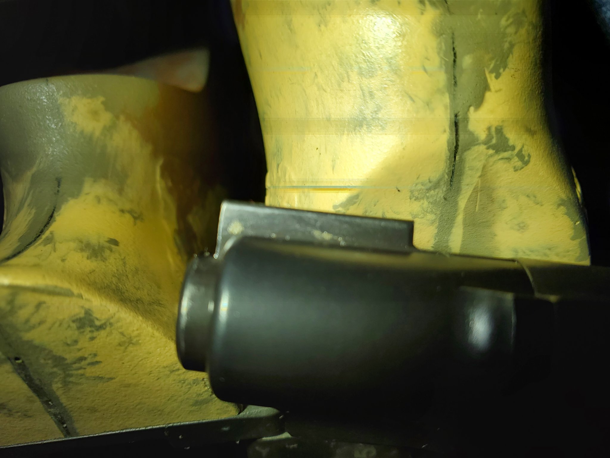

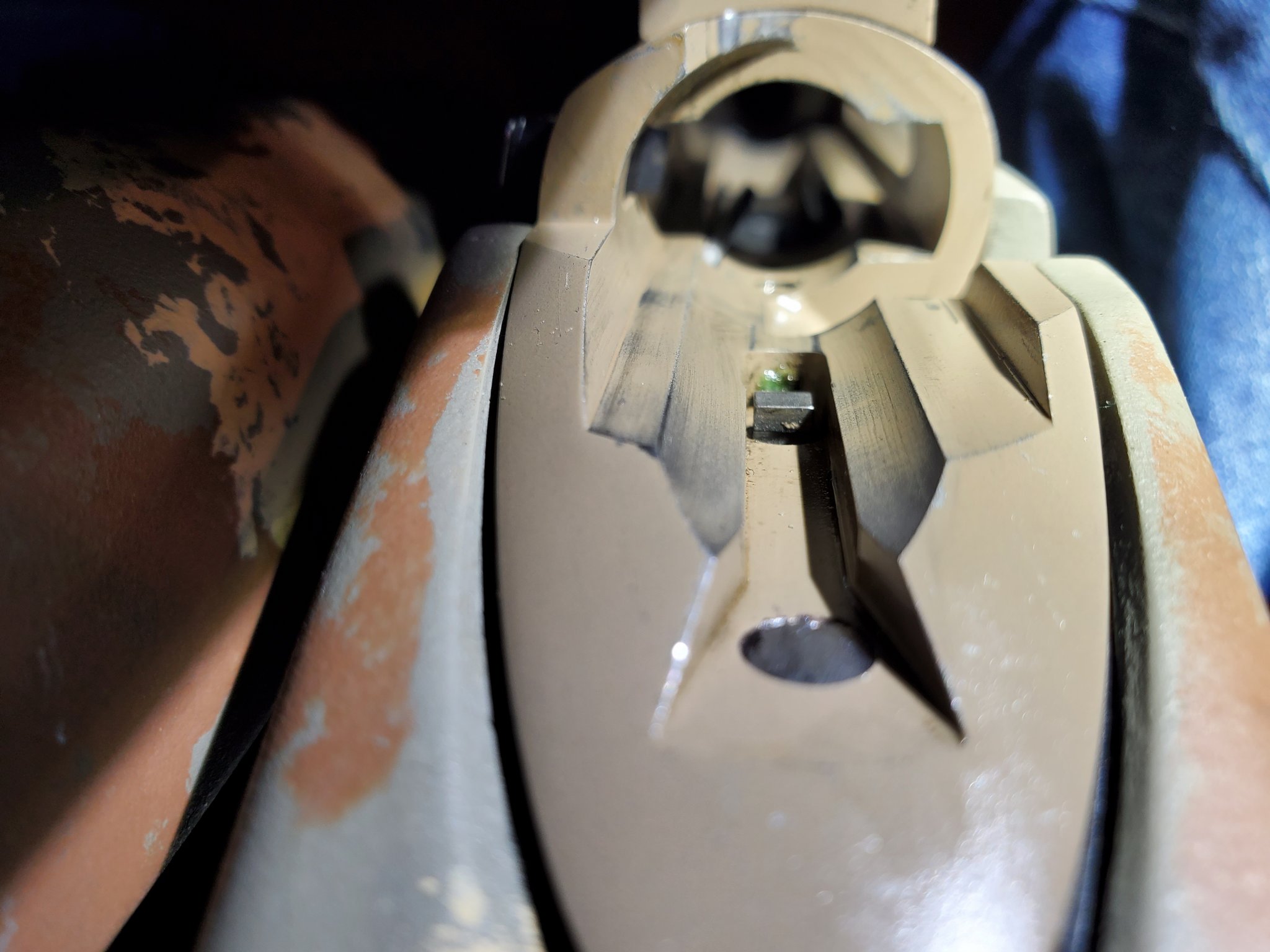

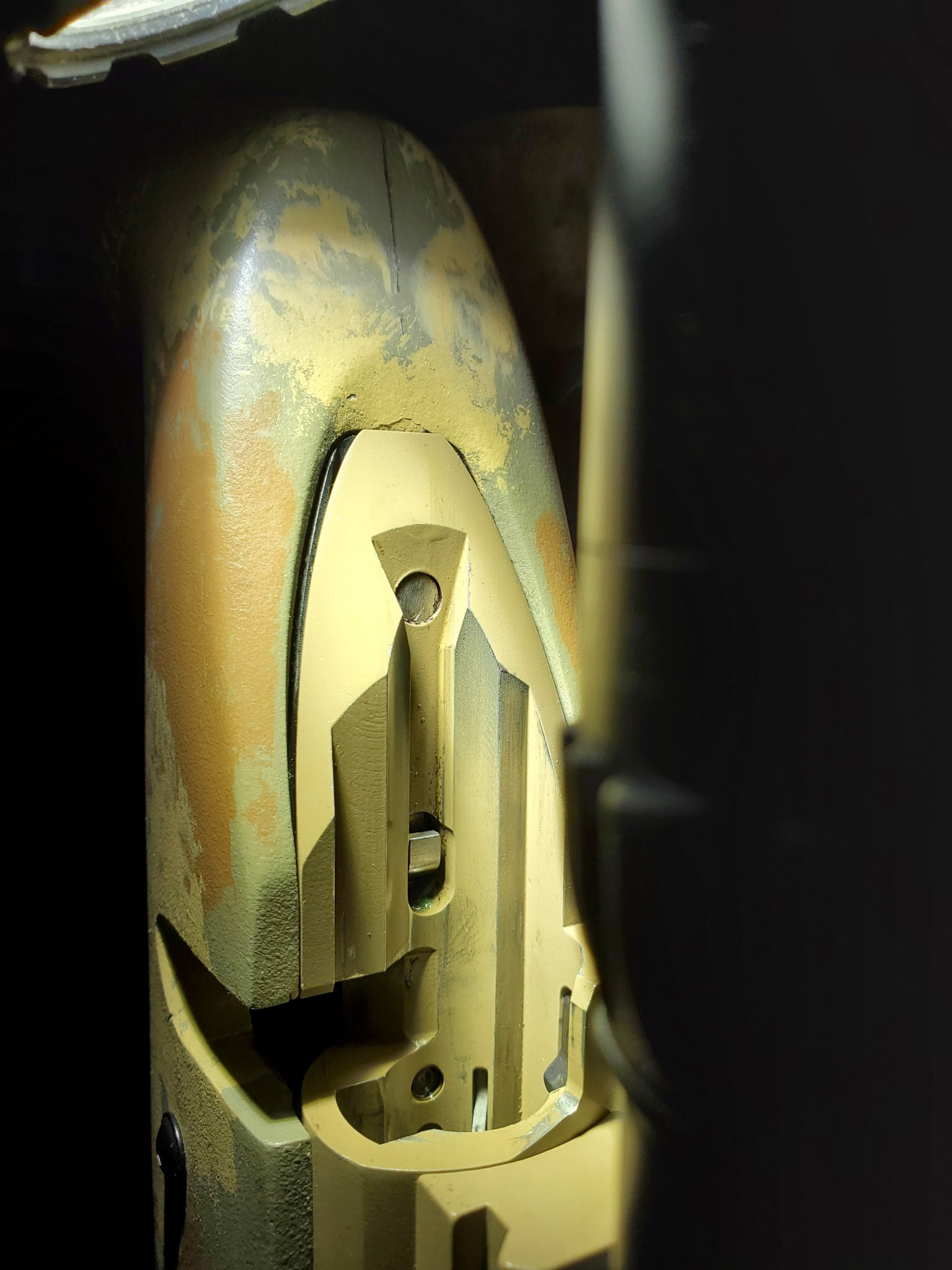

So, my Kimber Advanced Tactical has been having a intermittent cocking issue. I some times it just don't cock. I ordered a new trigger thinking mabe there was wear causing some issues. I installed the new Trigger Tech trigger and the problem is still there.
Anyone have any ideas what it could be?? I am thinking something has worn out of spec in the 2k rounds or so I have shot through it.
And if you run the bolt back and worth and try again it usually cocks.
The trigger is what holds back the firing pin in the cocking process. But this issue happens with both the factory and the Trigger Tech, so I crossed them off the list of possible problems causes
I was just wondering if the bolt motion felt smooth or is it an interference issue. It's either the bolt or trigger hanger issue. If you eliminate the trigger, break down the bolt for inspection.
I don't see anything abnormal.. I really think this thing is somehow wearing itself out of spec.
Well I just completed 2 100rnd dry fire cycles. And it malfunctioned 2 times on the first 100 and 1 time on the last 100.So that is not a high malfunction rate, but any malfunction rate is not a good thing as far as I am concerned.
