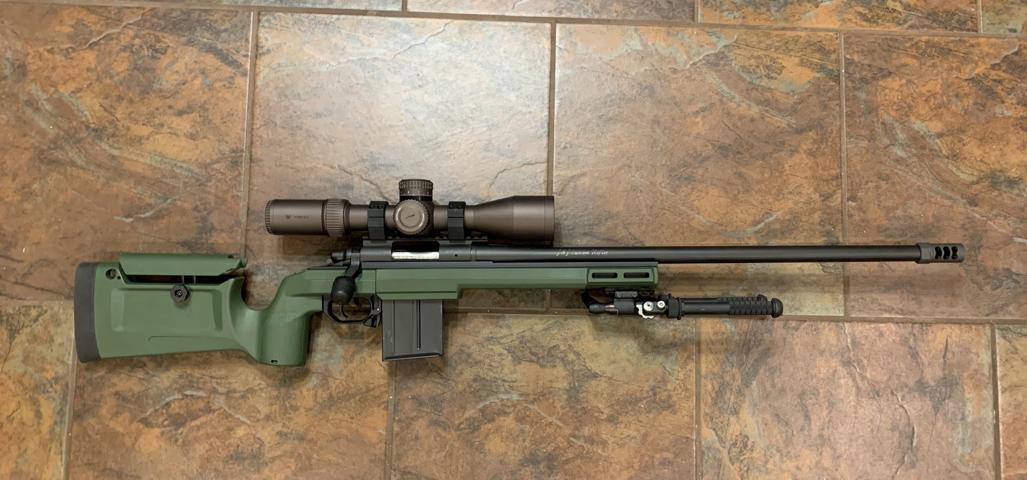

I’m 6’3” and it’s out there quite a bit. I just get it level, lock it in, and forget it for the most part. It’s at the very end of my reach while in the prone position. But I like it lot. Getting the Bipod out front about another 4 or 5 inches helps me with stability.
Atlas PSR on KRG spigot mount with aluminum L2 rail; I'm using the KRG ARCA rail for a heavy barricade stop on an ARCA clamp for balance besides its original function, and to attach to a tripod via ARCA ballhead when desired.
