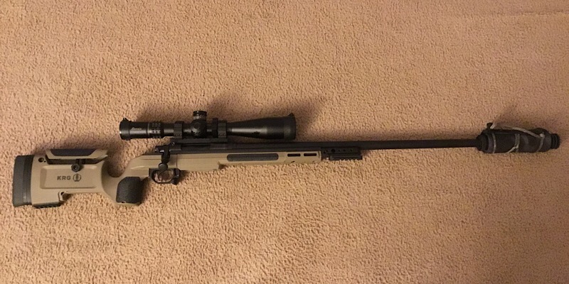

Alright gentleman, this is my final product after messing around with going back and forth for 2 weeks. Adding weight to rear, grip, and butthook, I lined the cavity with Saran Wrap and took #8 shot from shotgun shells, and covered it with excess Saran Wrap. As for the fore end, I went from adhesive wheel weights, to double sided tape and Saran wrapped #8 shot, to now and ending with lead decoy weights from academy. 3.5 oz each strip and had to trim to fit accordingly. Good thing with this lead, it’s soft enough to cut.
I managed to get 17 lbs empty, no bipod with #9 shot and epoxy. I left the hardener out of the epoxy in case I want to remove it. Rear was easy, front a little harder to get enough weight to balance. I like the decoy weight idea.
perfect. like I said, I messed around with this for 2 weeks plus. I know my wife is glad I'm done bc she's tired of me working on my guns on the kitchen island. haha
Curious how the stippling works out. Thought that might be a nice grip as well
I was going to before I left, but laziness/lack of time got the better of me. Once I get back stateside I'll get around to it.
Yup - and it doesn't permanently alter your stock. Dremel tools, soldering irons & youtube start a lot of work for gunsmiths. :eek:
I guess the black paint to make the KRG logo pop might be harder to completely remove, but I really like the contrast. The talon tape is easy and has a great texture IMO.
I use talon tape on mine and I love it. It’s a great feel on my hand and cheek.
I really like the contrast. That's probably my biggest and only complaint about the Bravo, is the solid FDE. If it came from KRG with a little black thrown in, I think it would do well as an option. But, just lets users customize their rifles even further.
What mags are you using in the havak? And did you have to modify the mag release to get them to feed/run smooth?
AW mags. I'm not having any issues feeding 100% of the time, but I do get a hang up about 5% of the time. I've been talking with another member, and I think the havak bolt needs to be ran hard when cycling.
you might take a look at the havak thread over in bolt actions. I did talk about with single stack mags, I was having issues with the 6 o'clock lug hitting the feed lips if any upward pressure on the mag. when dry firing, only issue I've had with the AW mags is the 6 o'clock lug will bind up on the leading edge of the follower. I had to file a little bevel on the leading edge so I can dry fire with the mag in at home

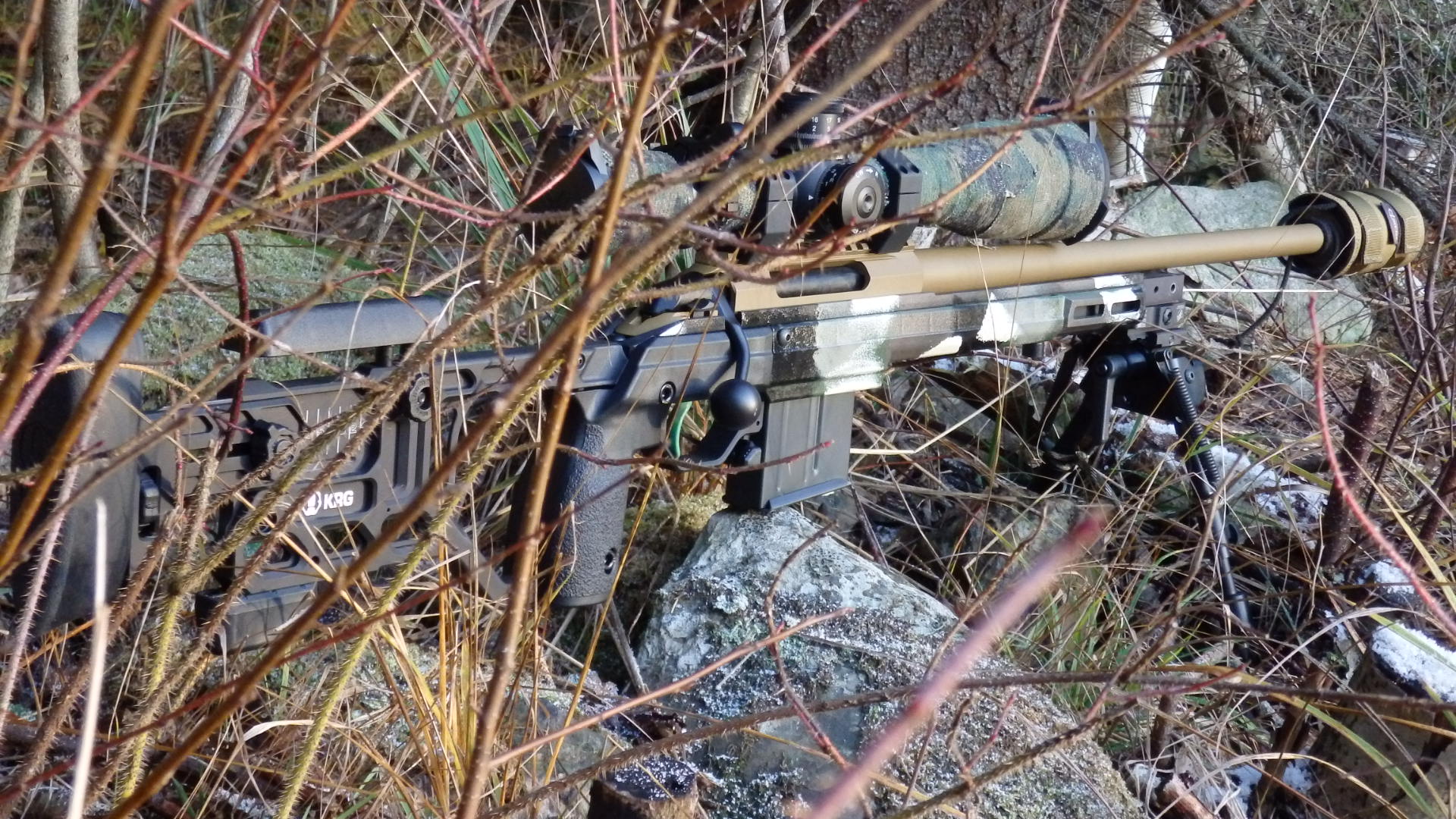

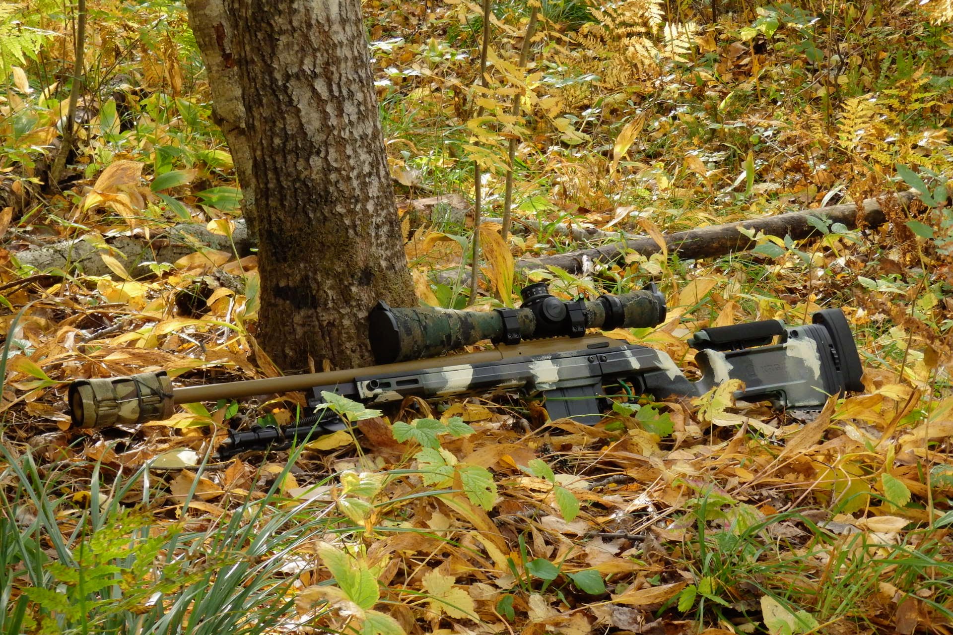

krg still continuing to impress me. shooting my first match after switch to the bravo. we'll see how she holds up Saturday
So you gotta tell me who did that camo job and what I it called?
Looks very gap camoish which all gap camos are my favorite they all look killer and so does this! Do devulge in the details kind sir!!!!
I have done the job.
Use a sponge to do the paint job, not straight from the can.
Spray the paint for a plate or similar, and then just dipp the sponge to the paint and touch it to the stock, dont wipe it, straight contact and then off.
Start with the dark to light colors.

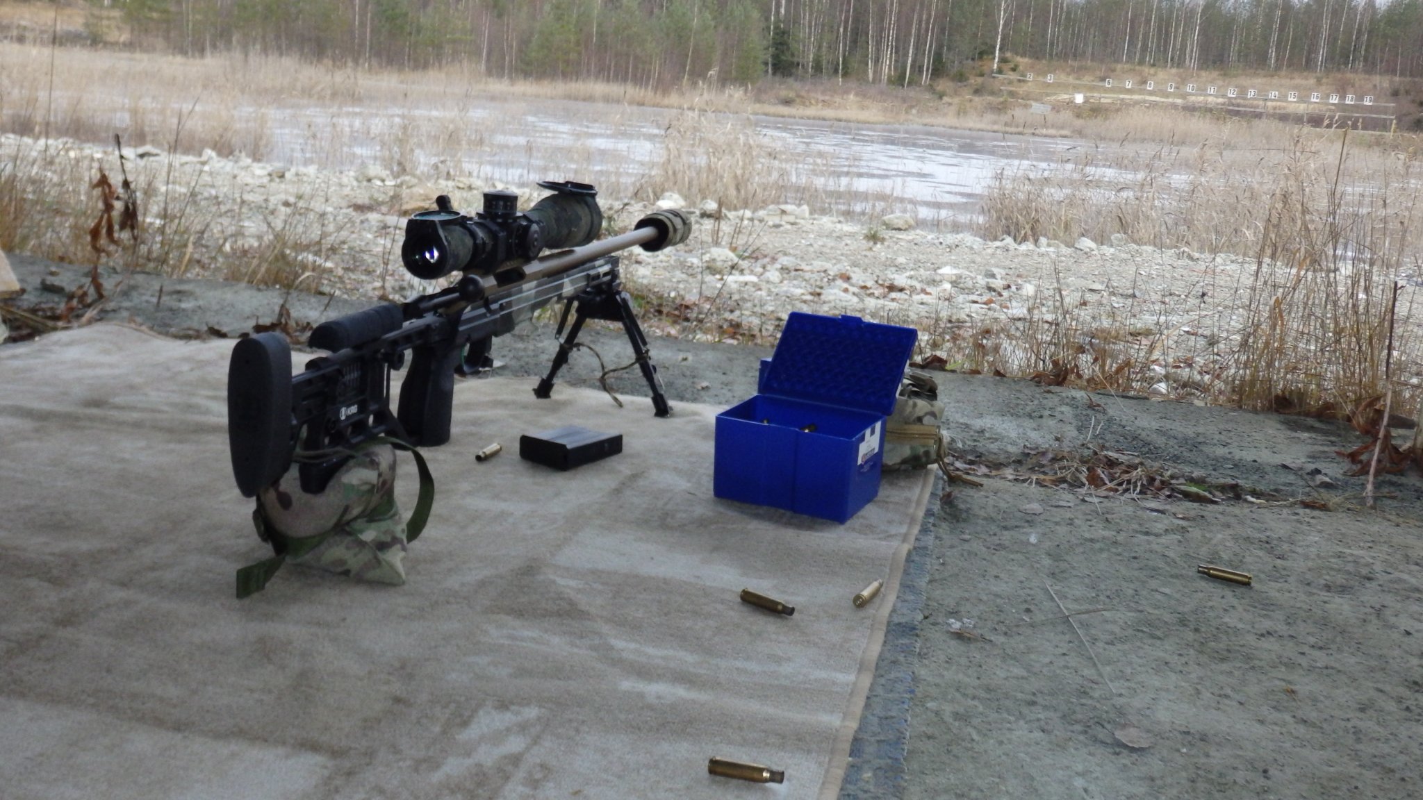

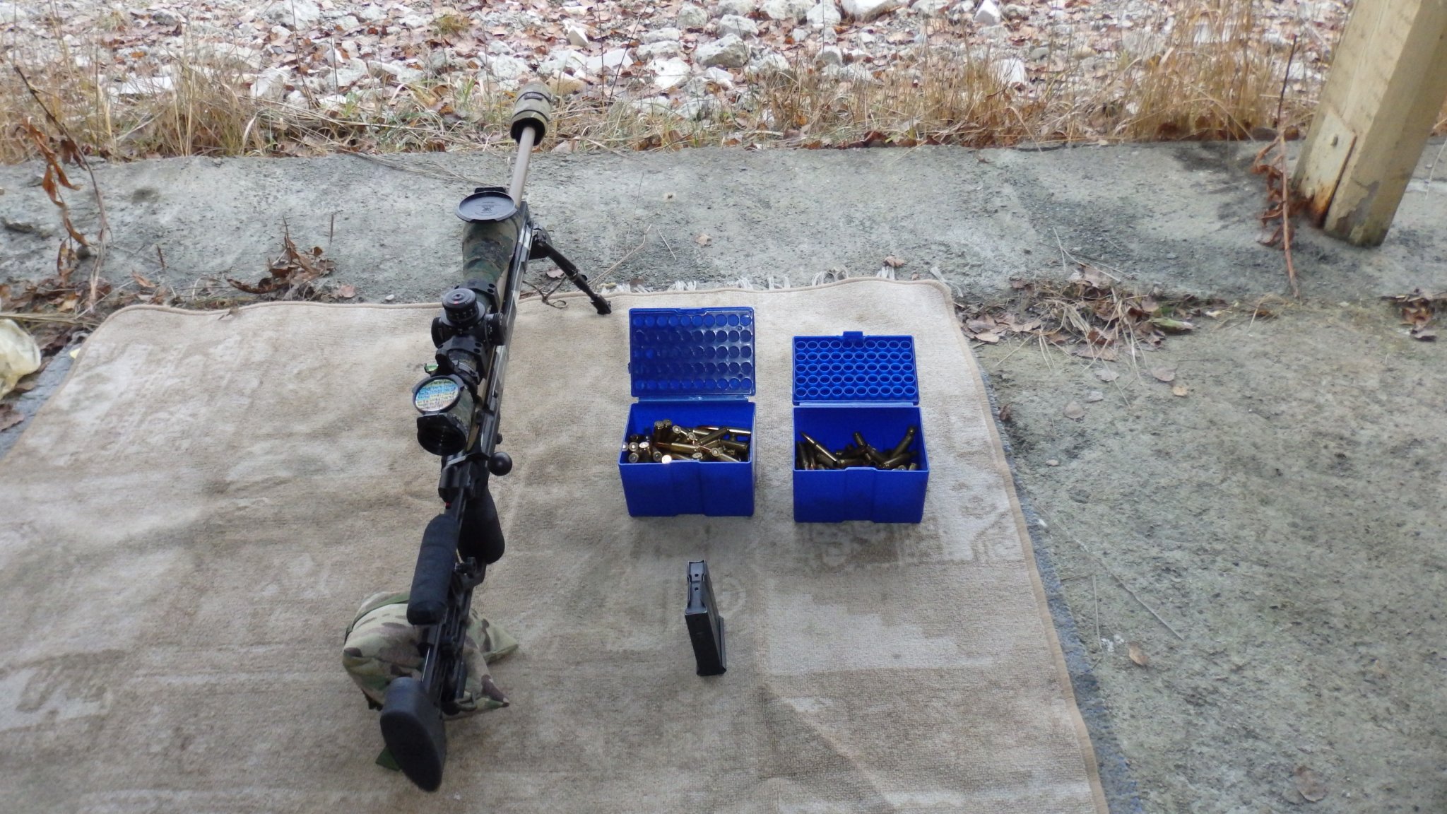

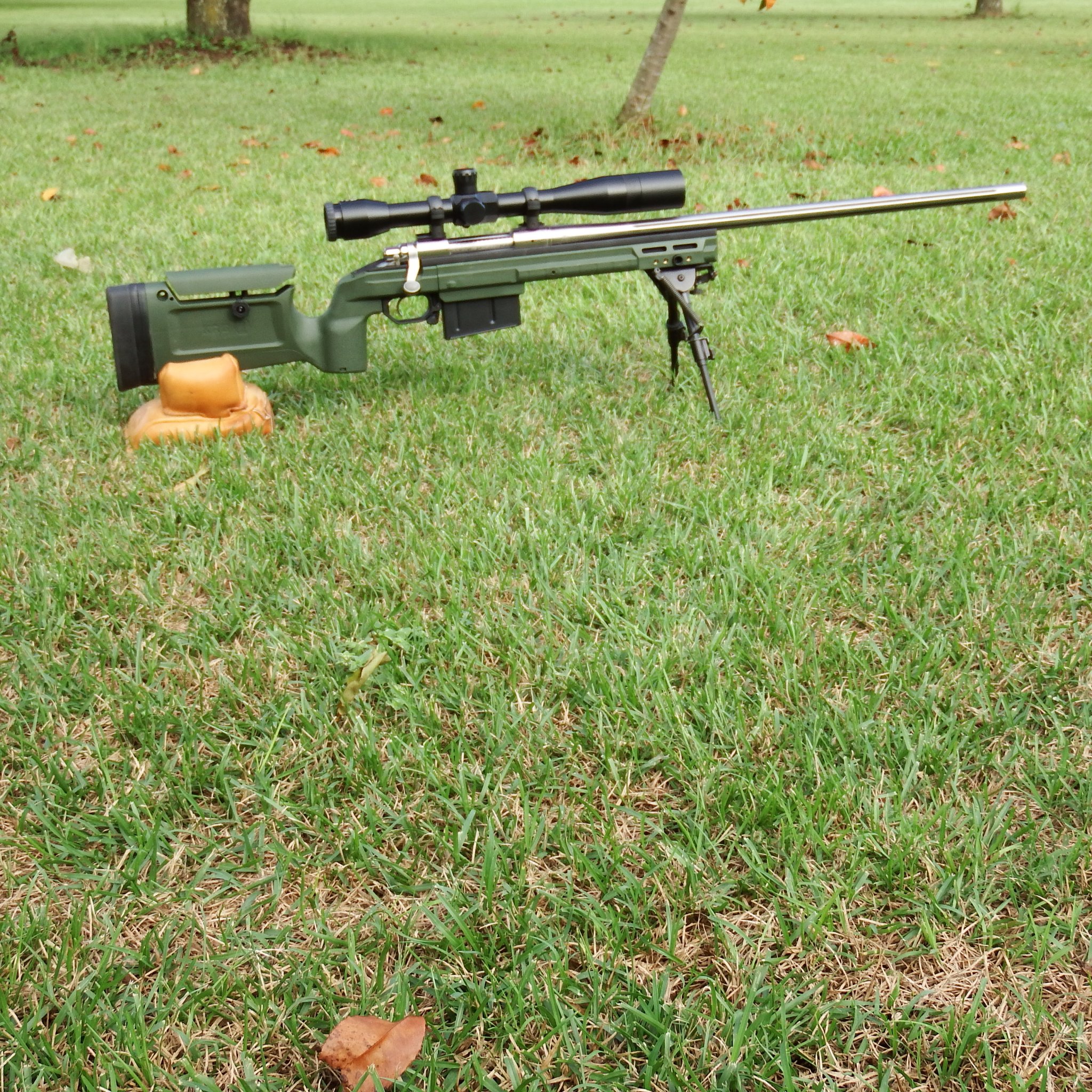

Pretty nice! How did you buy it I couldn't find anything bit the bravo rear end on the website.
How long was the install, was it worth the trouble to say go from match to hunt kinda thing?
I am working in a gun store, and we import KRG chassis, so this was kind of jod advantage:).
Have not tested this rear stock in the shooting range yet, but if i have time, i will do testing tomorrow.
If you want, i can report range testing here?
Reactions: King_beardsly
That's a handy, you get to handle all the awesome stuff that comes import and found out the trg rear fits the bravo
