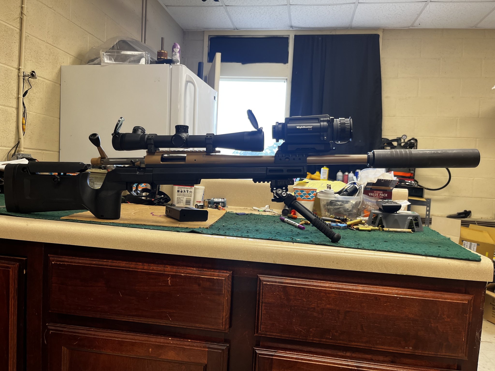

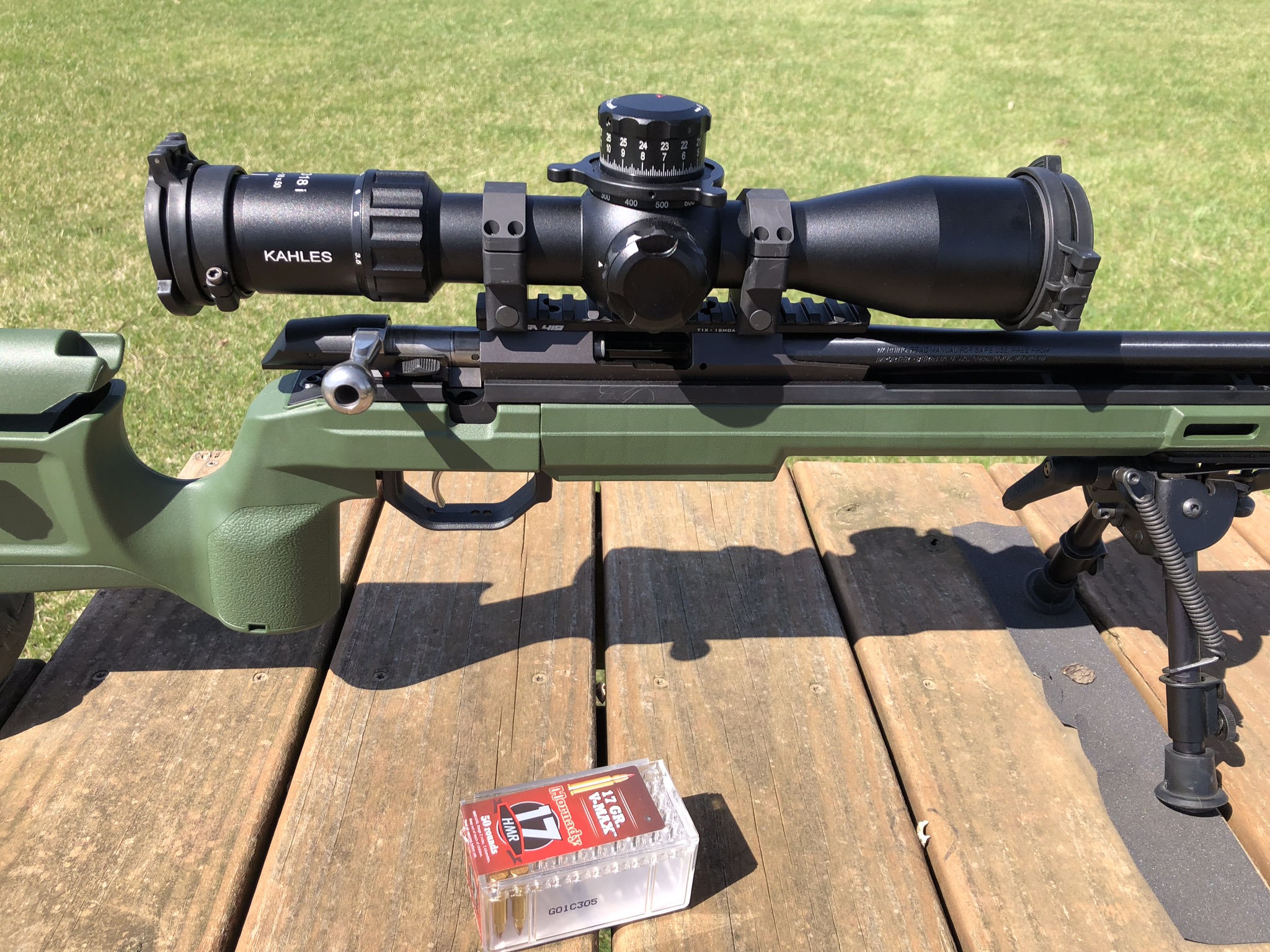

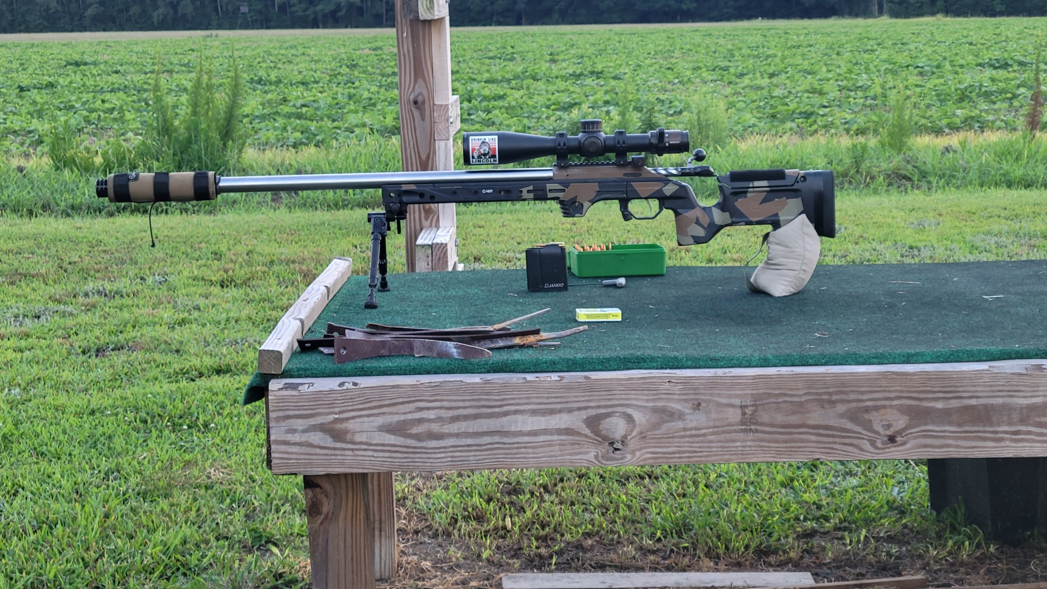

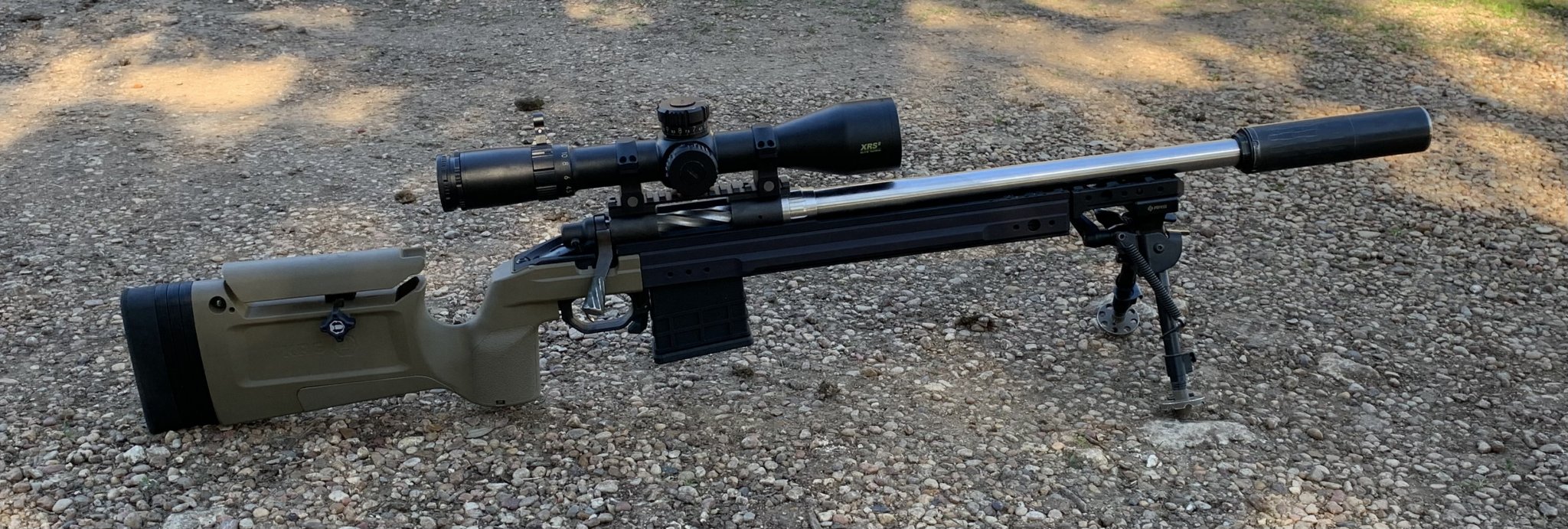

Does this count? T1x critter getter in 17HMR.

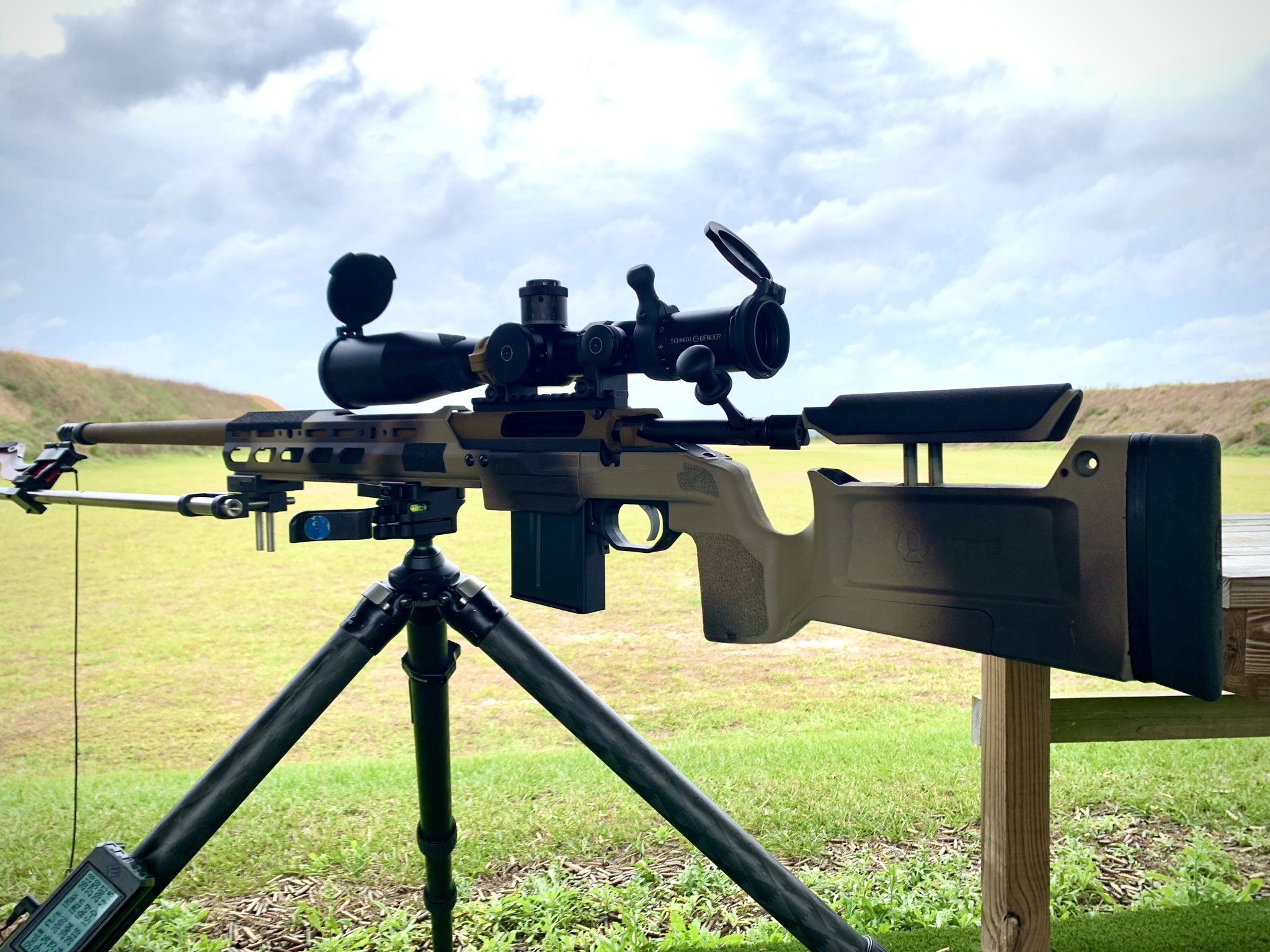

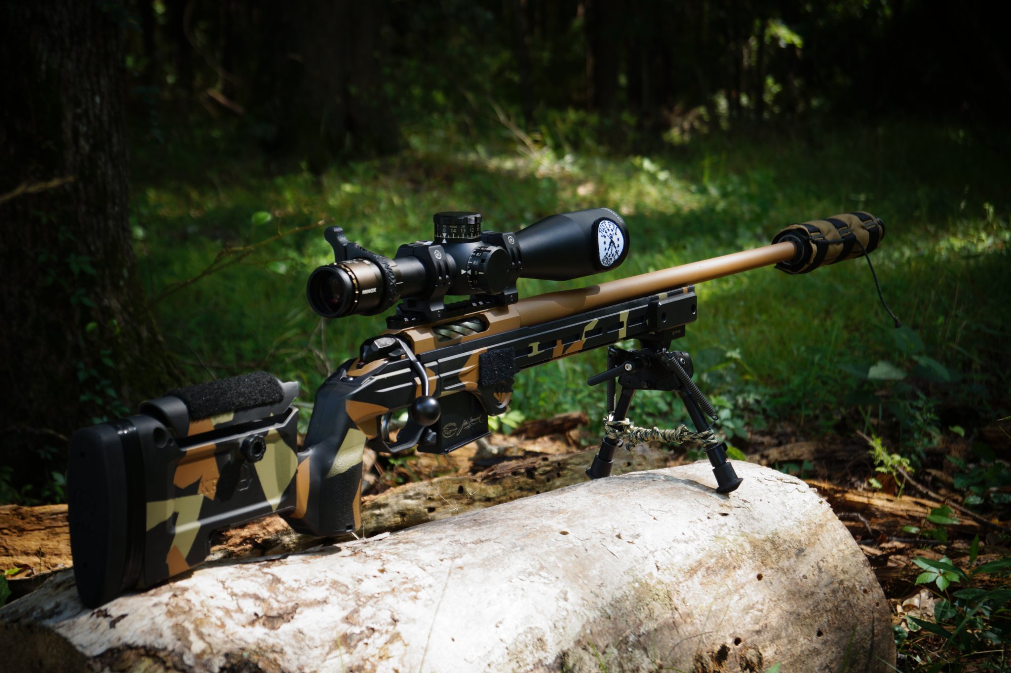

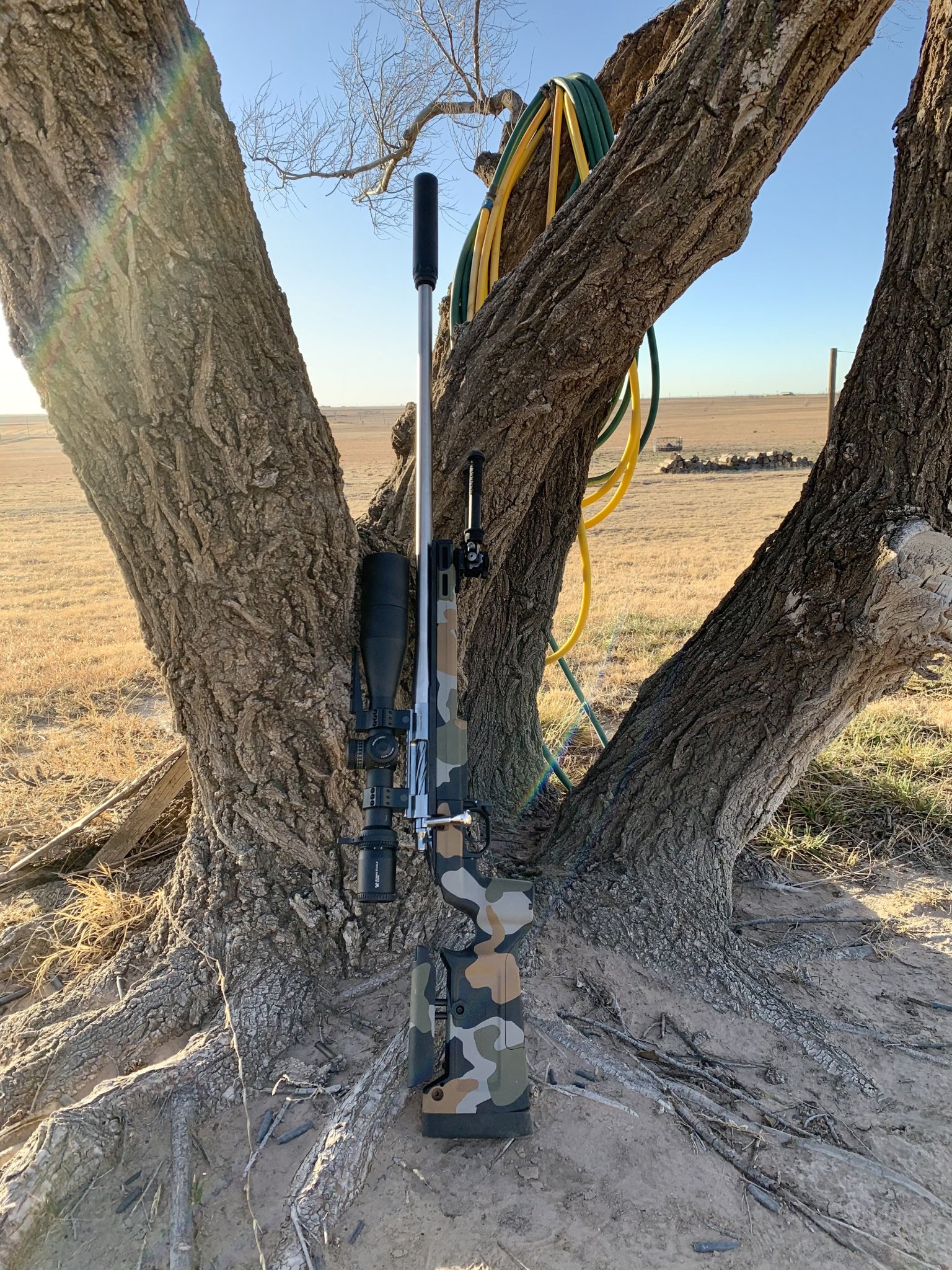

It took me two years to fire the first round on this project but it was worth the wait.
7mm-6.5 PRC
Archimedes SA LH w/ 0.535 BF and 45MOA rail (I can go to 2k with this setup)
Krieger MTU 28” 8.5 tw
KRG Bravo with Gen 2 enclosed forend
B&A TS Pro
Cerakote barreled-action (AI dark earth)
Atlas PSR w/ RRS SC-ARC (not pictured)
MDT 7SAUM mags
A419 Hellfire 30cal
PMII w/ P4F
Badger rings
Accuracy 1st level
Tenebrex caps
7mm-6.5 PRC
B&A TS Pro
MDT 7SAUM mags
A419 Hellfire 30cal
PMII w/ P4F
Badger rings
Accuracy 1st level
Tenebrex caps

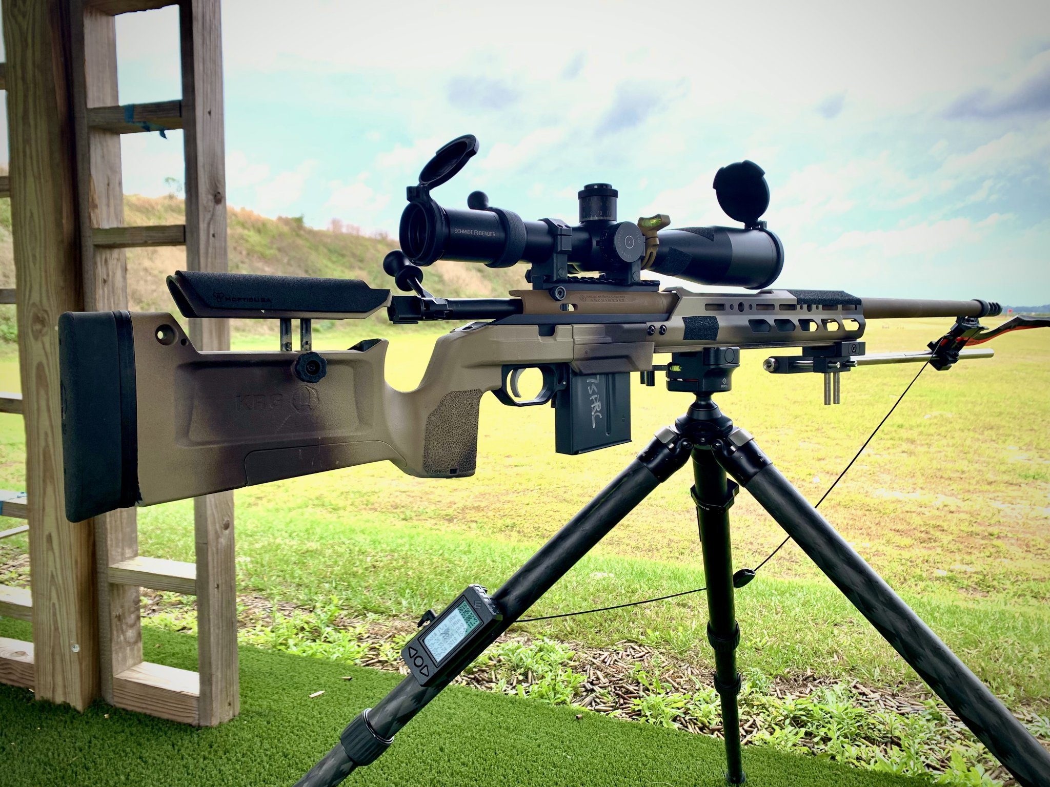

That MagnetoSpeed mount looks pretty solid. Who's the manufacturer?
MK Machine. It is, I run this on several rifles and the mount / ARCA combo makes it really convenient and reliable
I use that same Mount works great I removed the heavy steel rod an bought a piece of 5/8 fiberglass rod. It lighter and plenty stiff and long enough for my suppressor.
I was going to try a 6061 rod but it had quite a bit of movement in it since I was using most of the 2'. In the end, I just ordered a 12" section from MK, screwed it together, and have never looked back. It's way more stable. YMMV

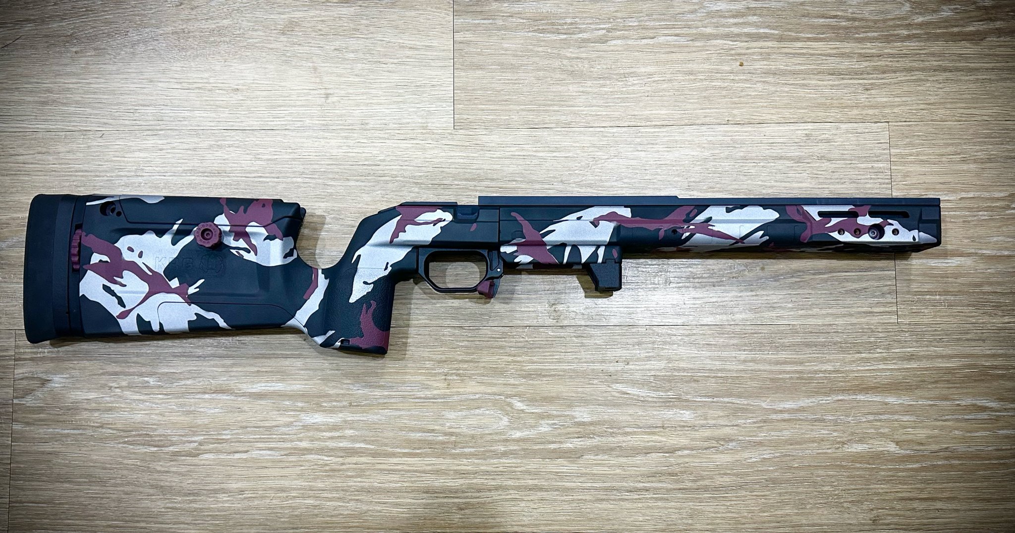

I see a lot of the cheek pieces in this thread have a soft material adhered. Is that a fabricated product for sale?

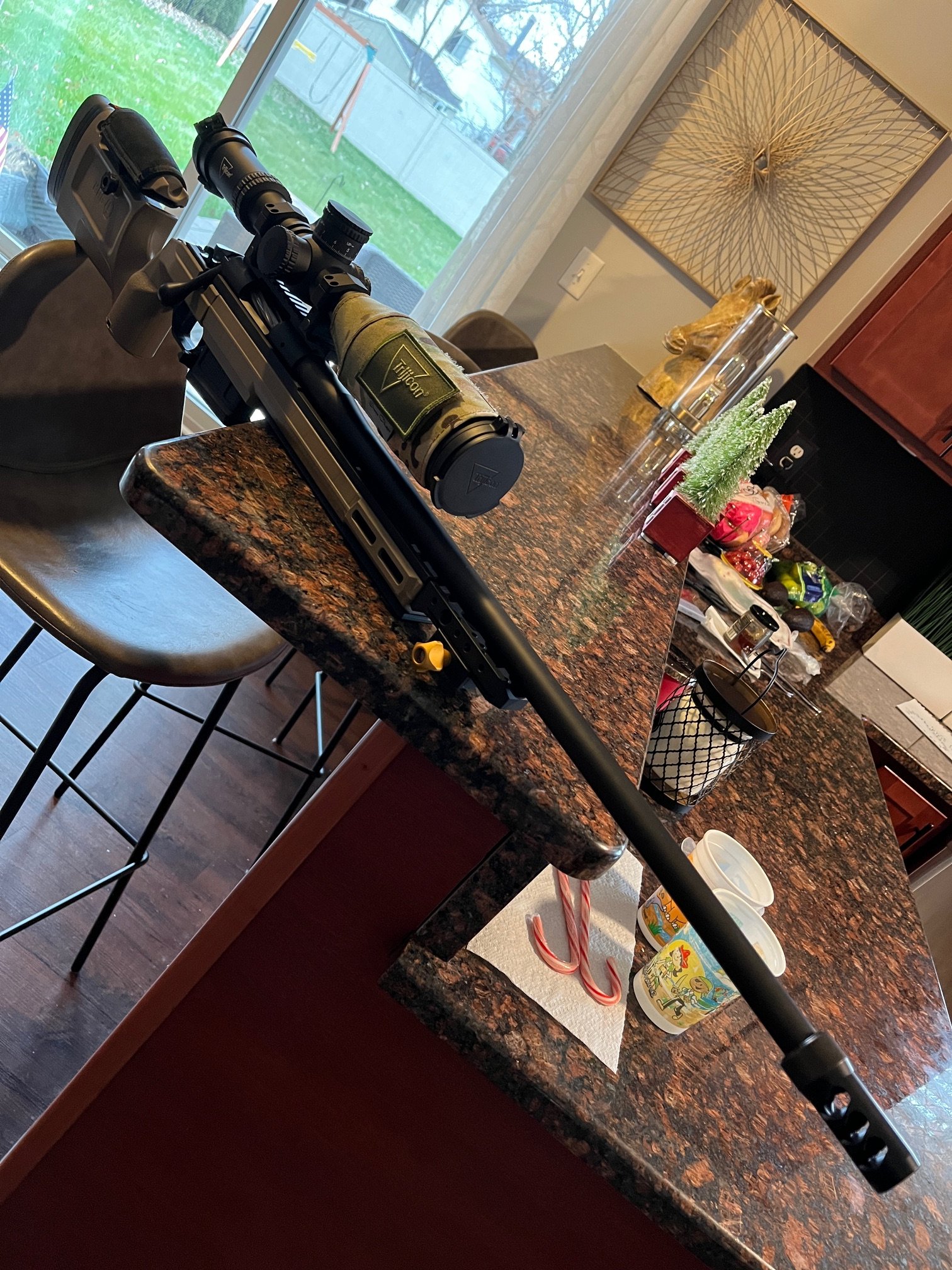

Finally picked up a Bravo to play with. Probably won’t keep it long. It looks good, but now I have feed issues they weren’t present with the rifle in a Manners. Kinda sad cause I wanted it to work real bad. Had to find some higher rings as well for the clip on, but that was expected
Reactions: TM6 and kindabitey
Finally picked up a Bravo to play with. Probably won’t keep it long. It looks good, but now I have feed issues they weren’t present with the rifle in a Manners. Kinda sad cause I wanted it to work real bad. Had to find some higher rings as well for the clip on, but that was expected View attachment 8292804
Have you tried adjusting the mag well? There is a screw you loosen (barrel action out of the chassis) on top of the trigger guard that adj the mag well.
Reactions: TM6
I have not, will look into that though. Thank you
The magwell (forend) and the trigger guard both adjust so you get the perfect fit. That’s gotta be the problem.
I would get the magwell tight first then adjust the trigger guard.
I’ll get into that this afternoon hopefully. Really like the way the bravo feels and I don’t have to get another stock inlet for an efr.
Reactions: RFutch
Adjust it with a mag inserted, makes it easier to get perfect fit first time. Also stand rifle on butt and squeeze forearm and buttstock junction together while you tighten the tang screw to 40in lbs after you torque the two action screws.. This will ensure a tight junction and prevent sag where the two pieces meet and also keep your mag adjustment from slipping.
