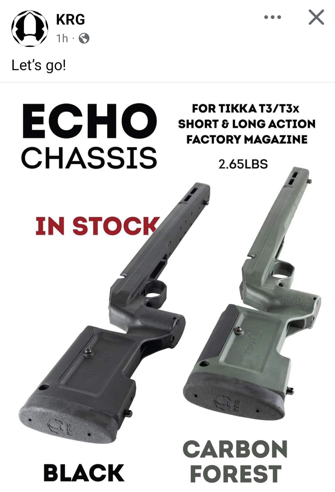

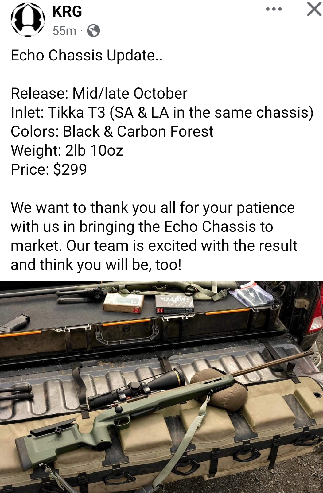

Looks like it's these thing are available now, saw this post of Facebook.
Interesting that they have managed to drop 7oz of weight, hopefully it's mostly out of the butt area.
If so these will be very hard to beat for a Tikka hunting build.

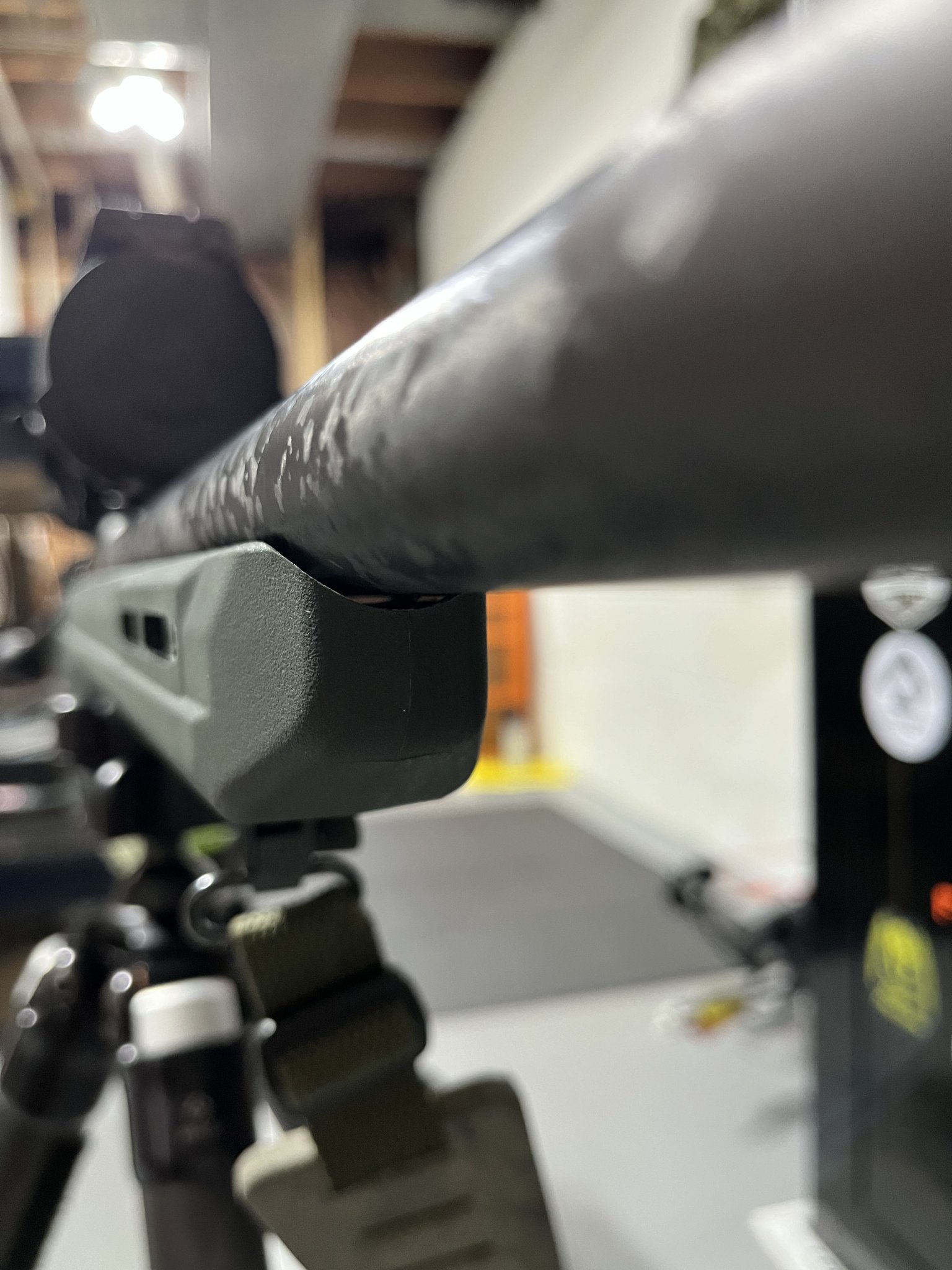

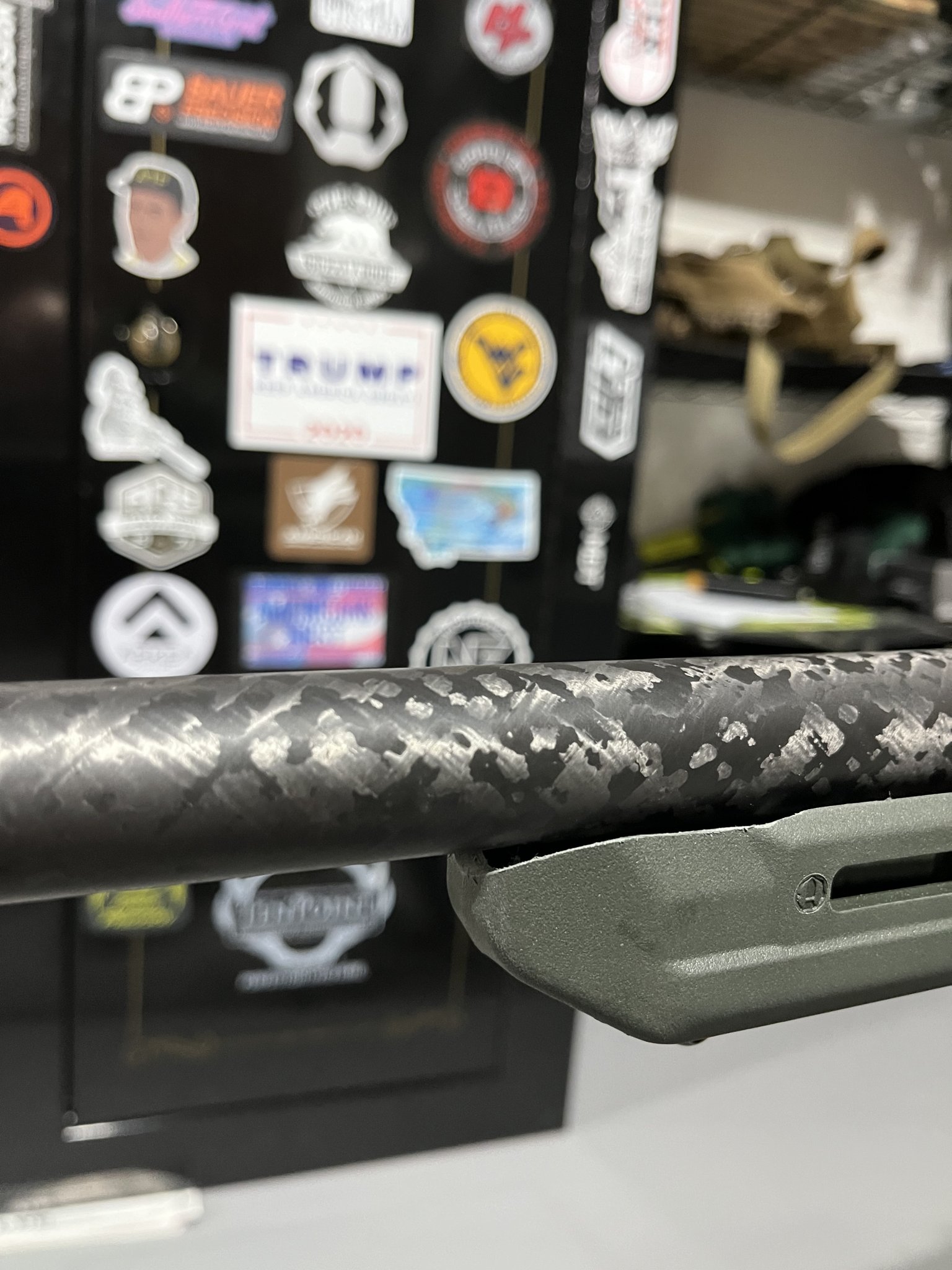

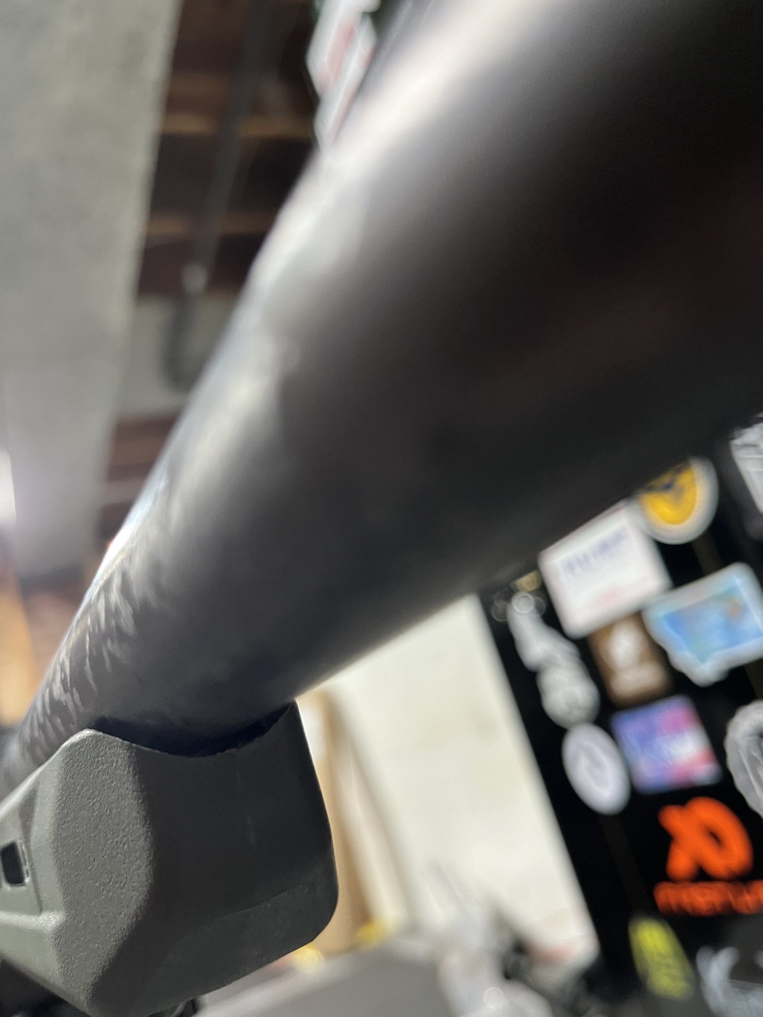

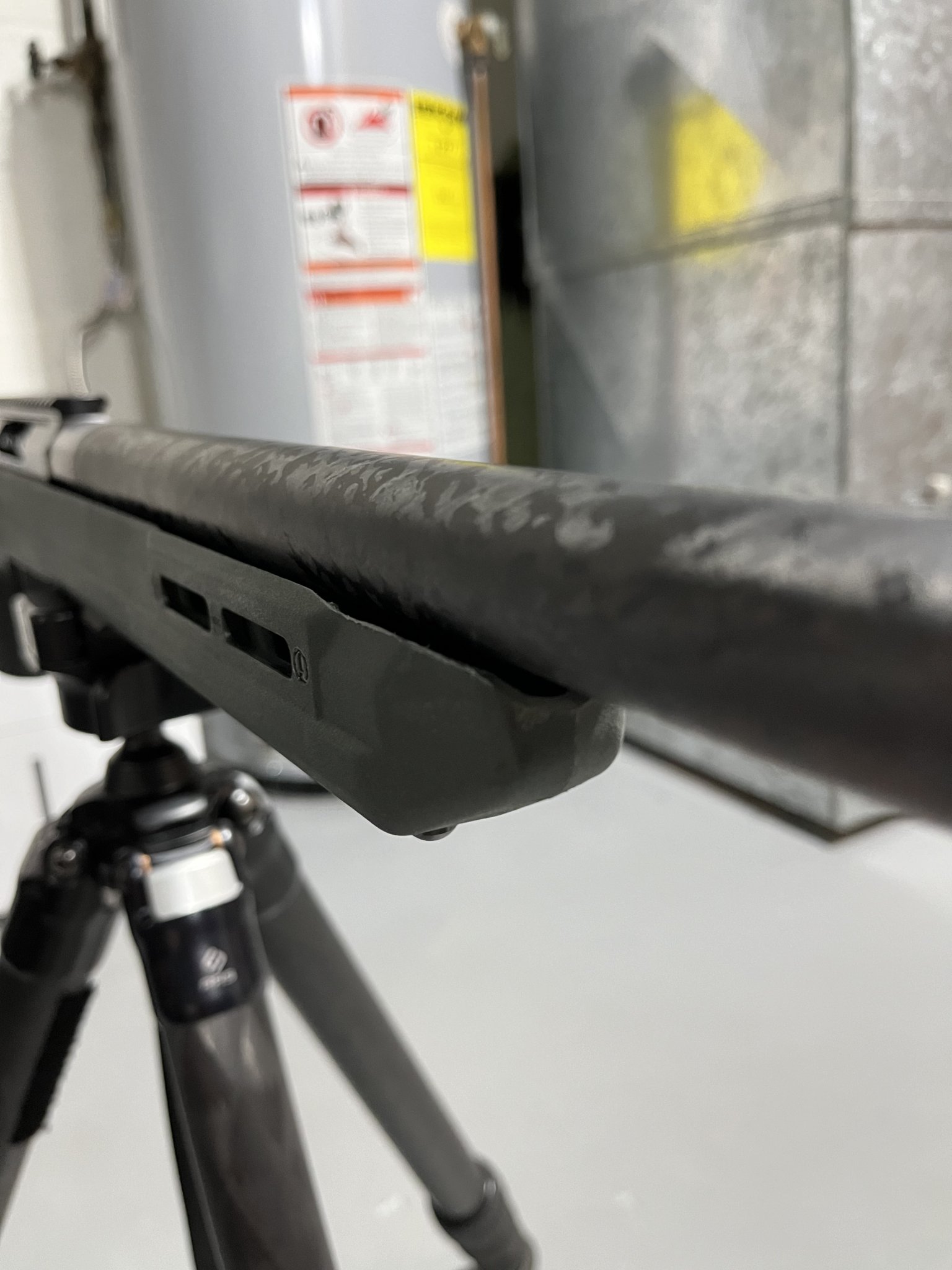

@YotaEer - It states .95 at the fore-end, but will this barrel channel accept a barrel contour similar to that of Proof Sendero or even larger? I know it says Varmint, but can't find any details about how wide towards the shank.

I guess I’m about to find out on the proof sendero bit. That’s what I have. 24” long
Not sure the answers on the longer arca rails. I asked them “how do we attach an arca rail to the bottom?” And their reply was only that they modified their short arca rail to fit the echo.

KRG told me that they do not know if a Proof Research Sendero Contour barrel will work, but they did say the Proof Sendero Light and Bartlein #13 Remington/Varmint Sendero Contour will work.
They told me only the ARCA short will work, but a L2 picatinny will also work towards the fore-end for a bipod.

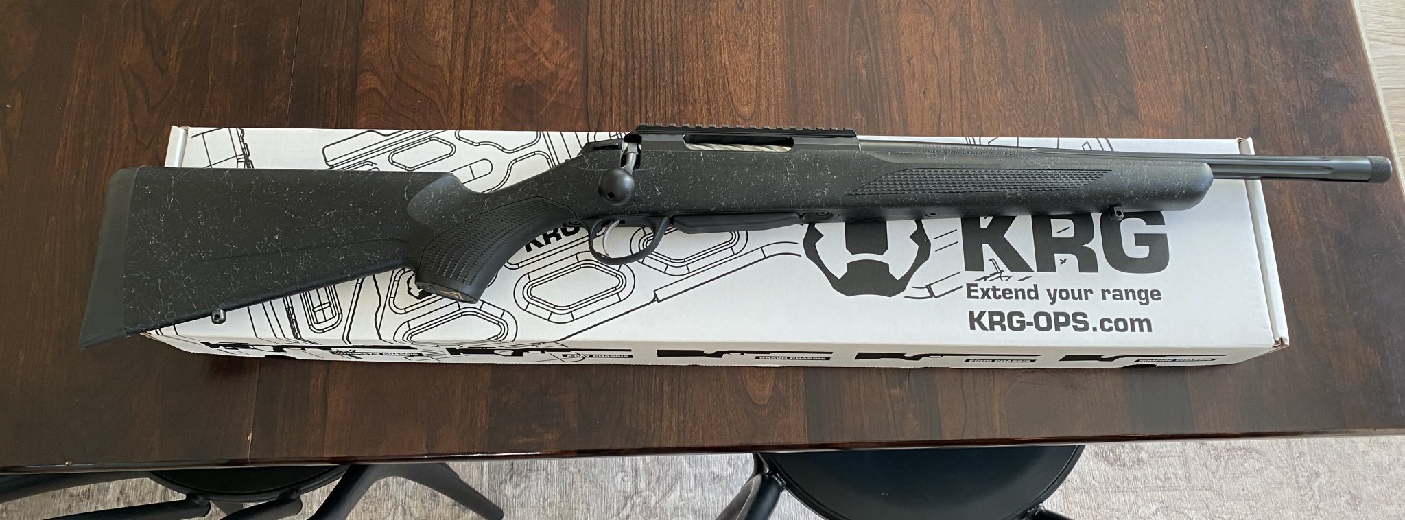

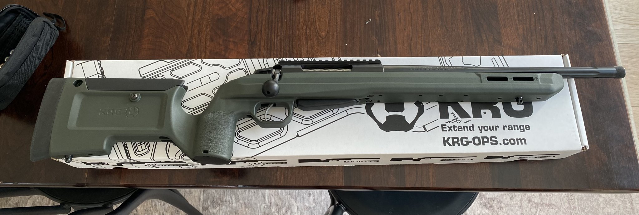

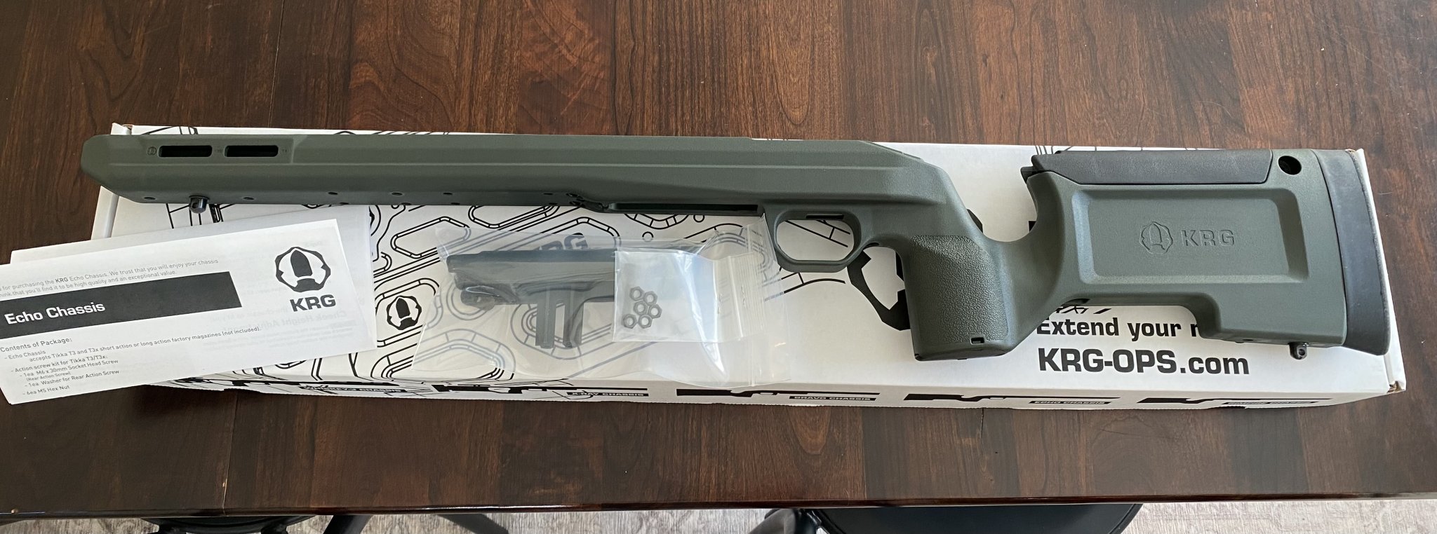

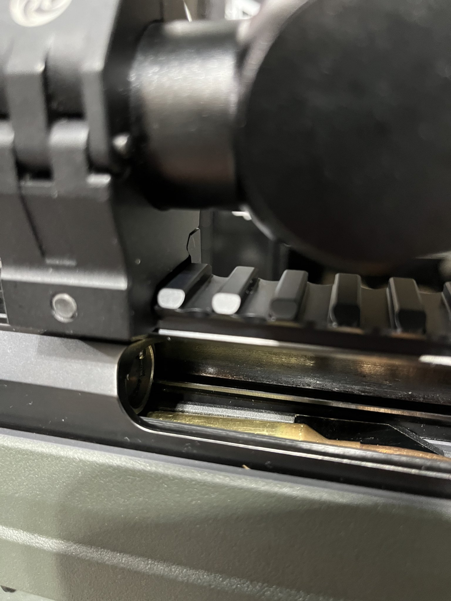

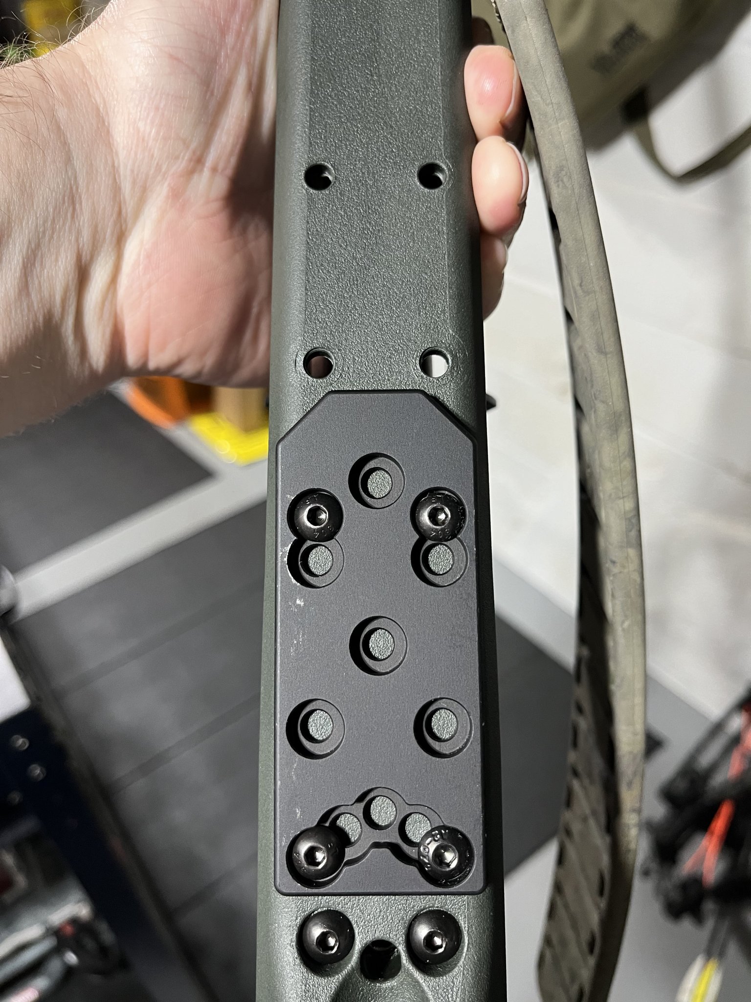

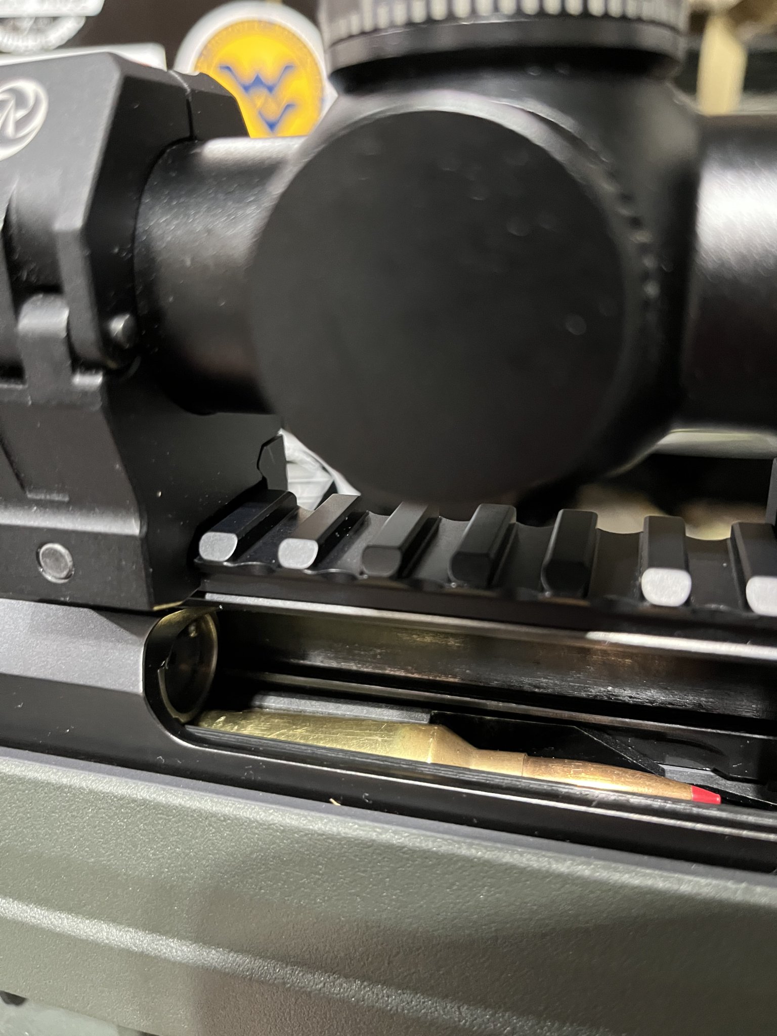

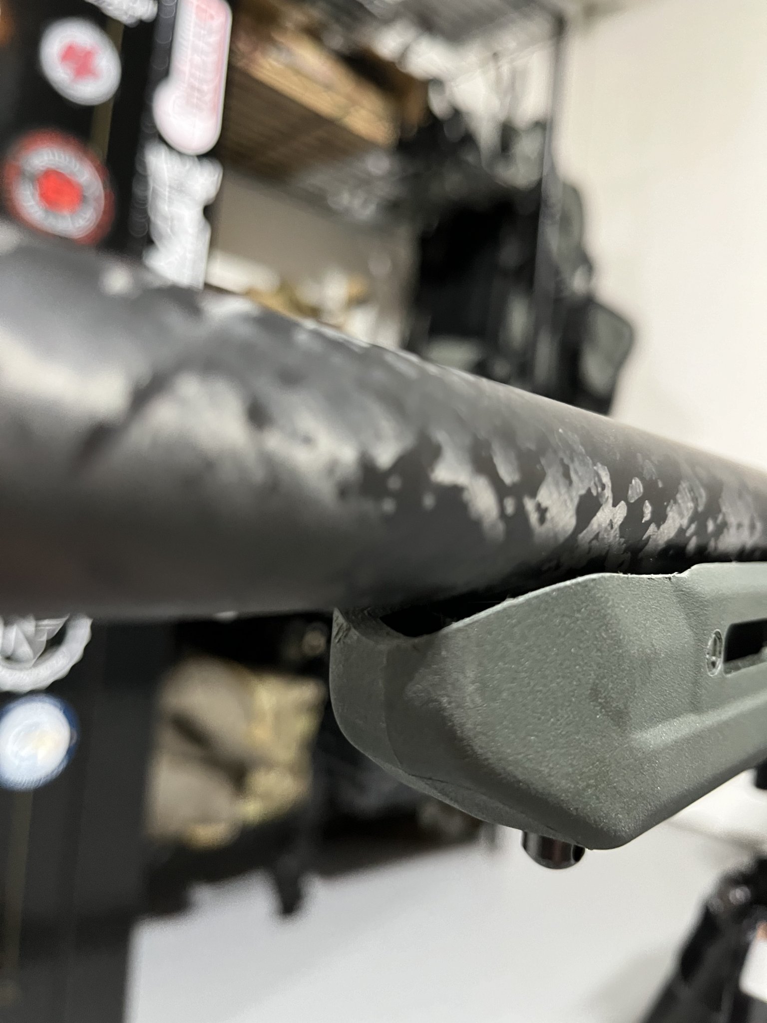

Ok, I have a Tikka Roughtech Ranch in 223 I dropped in. Overall impression: I like how it handles and feels. It balances better than the Roughtech stock, and I like the vertical grip better.
The stock as it arrives. It comes with 2 cheekpieces, I regular and 1 lightweight.

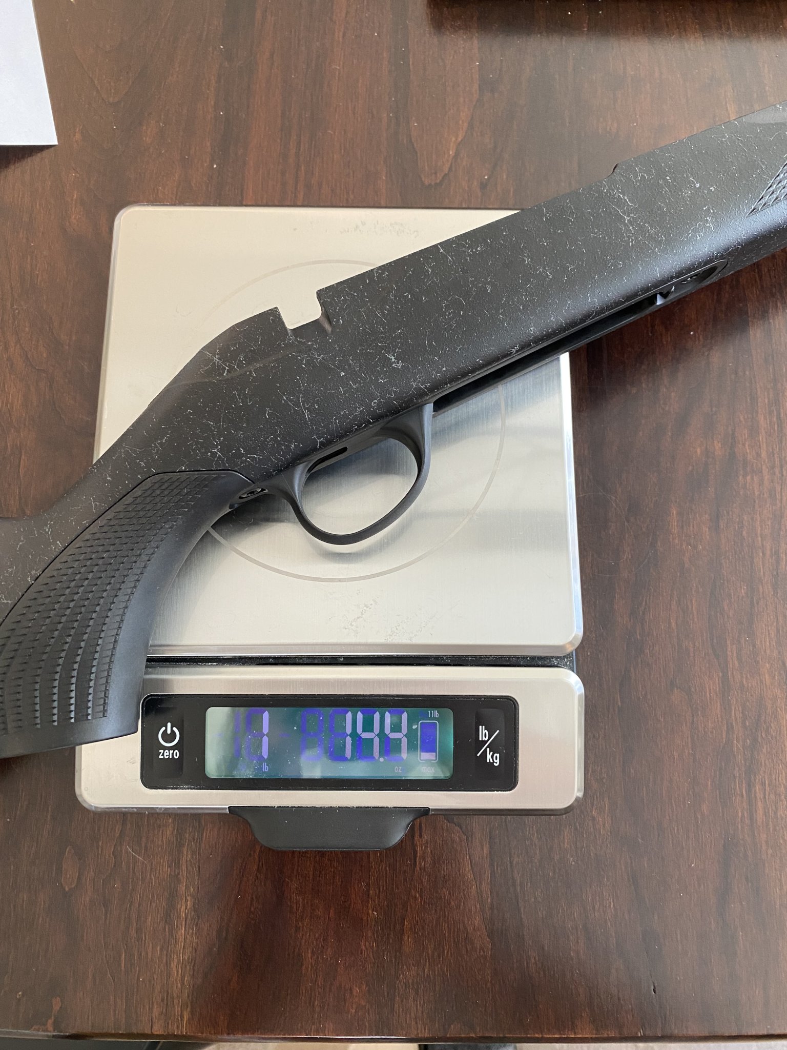

The Roughtech ranch. Stock from the factory weighs 6 lbs, 8 oz on my scale.

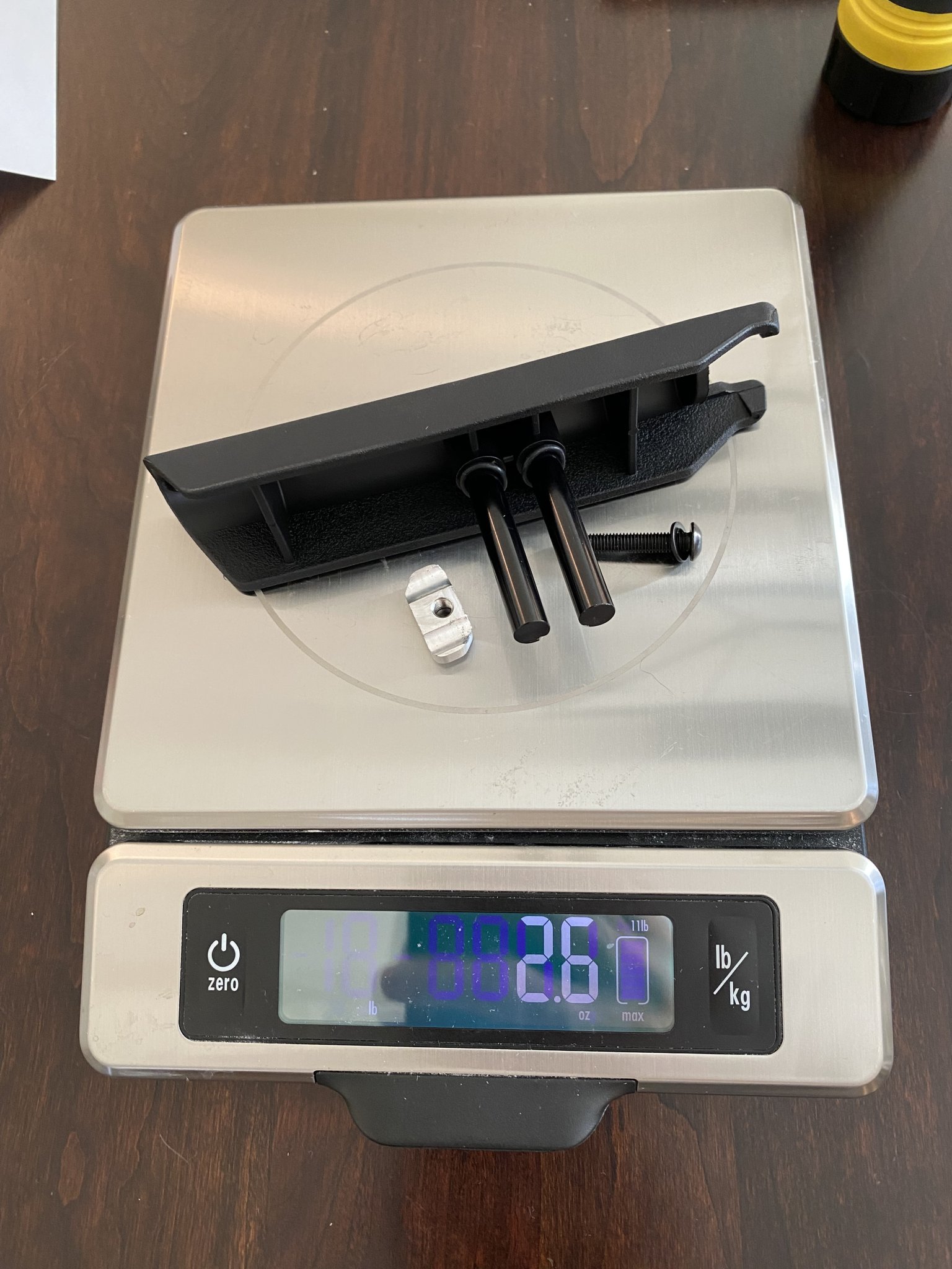

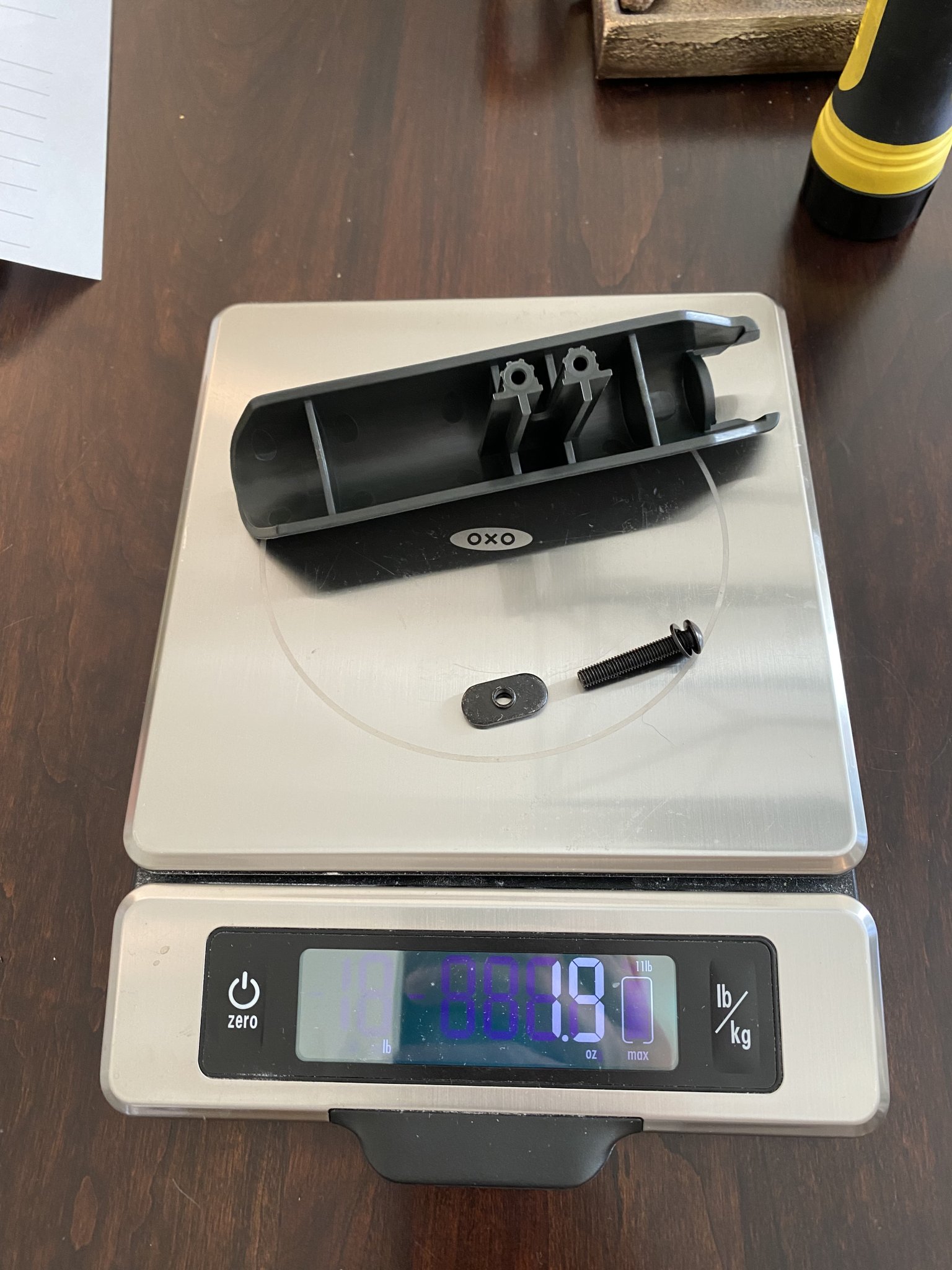

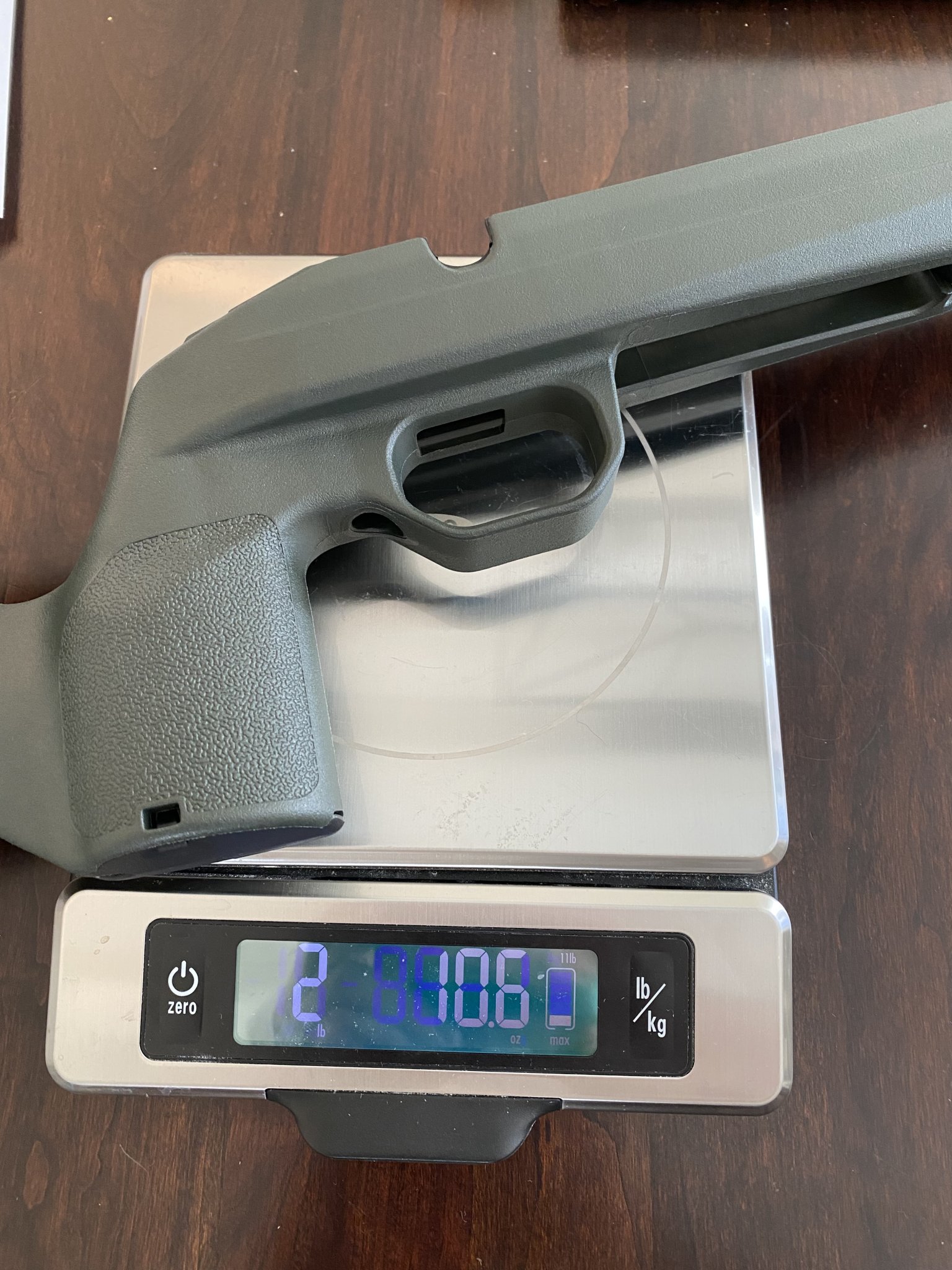

Without mag, the Roughtech stock is:
Vs the Echo:
Install is easy, though slightly different than a bravo. First thing that annoyed me (and it’s minor). The front captive action screw needs to be threaded into the action to allow the action to sit onto the lug. I like to put an action in, feel it seat on the lug, and then start the action screws. With the captive front screw you have to start the screw into the action before it can seat on the lug. Minor irritation, and only on install. There may be a way to pop the mini internal chassis out and avoid this, but I didn’t try.
With the action installed, the setup now weighs 7 lbs, 4 oz.
Balance is nice, centered right on the forward 1/3 of the mag.

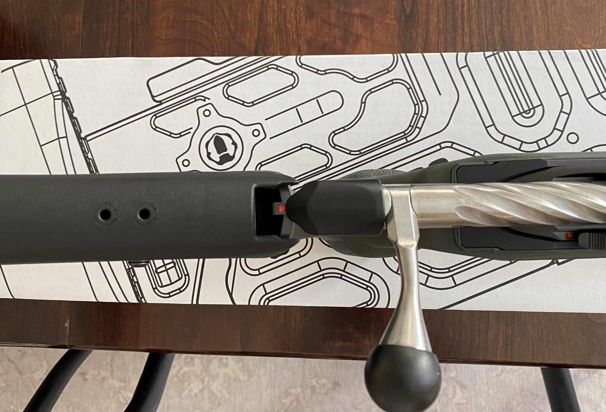

Things to note: with the cheek piece down, you can’t remove the bolt from the action. I haven’t had a Tikka Bravo, just Remington 700 Bravos, but I don’t remember that being an issue with the Rem Bravo.
Is the lightweight cheek piece light enough to warrant install? For me no. The main difference is the clamping bar and hardware. Standard piece with hardware was 2.6 oz, lightweight with hardware was 1.9 oz.

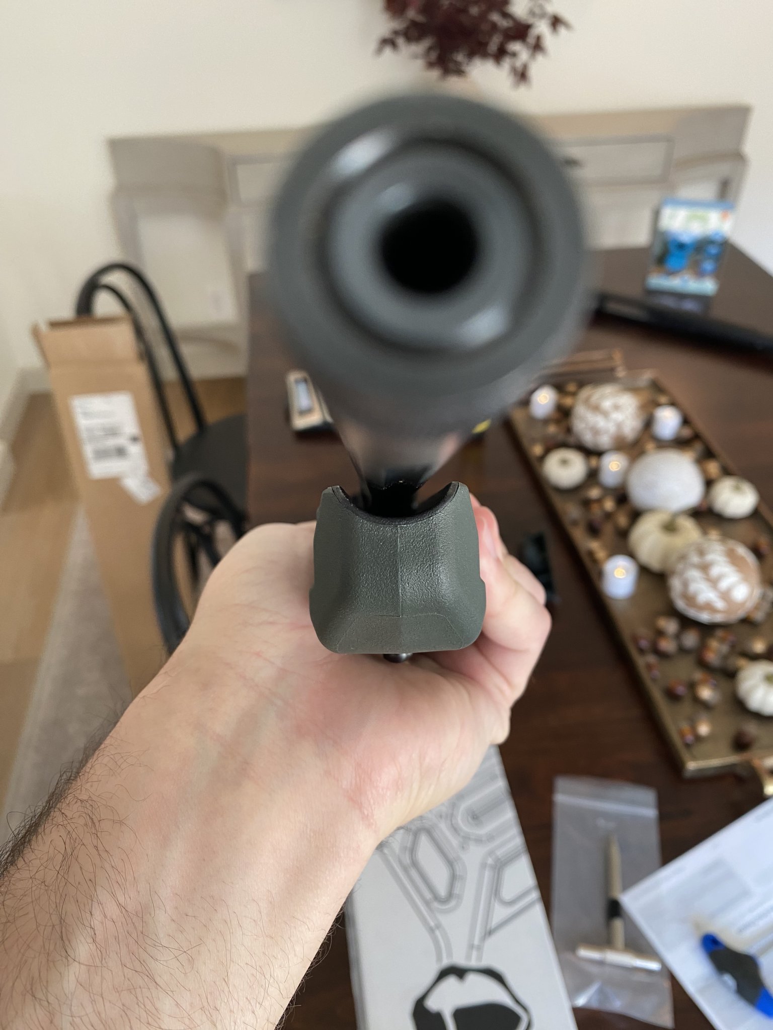

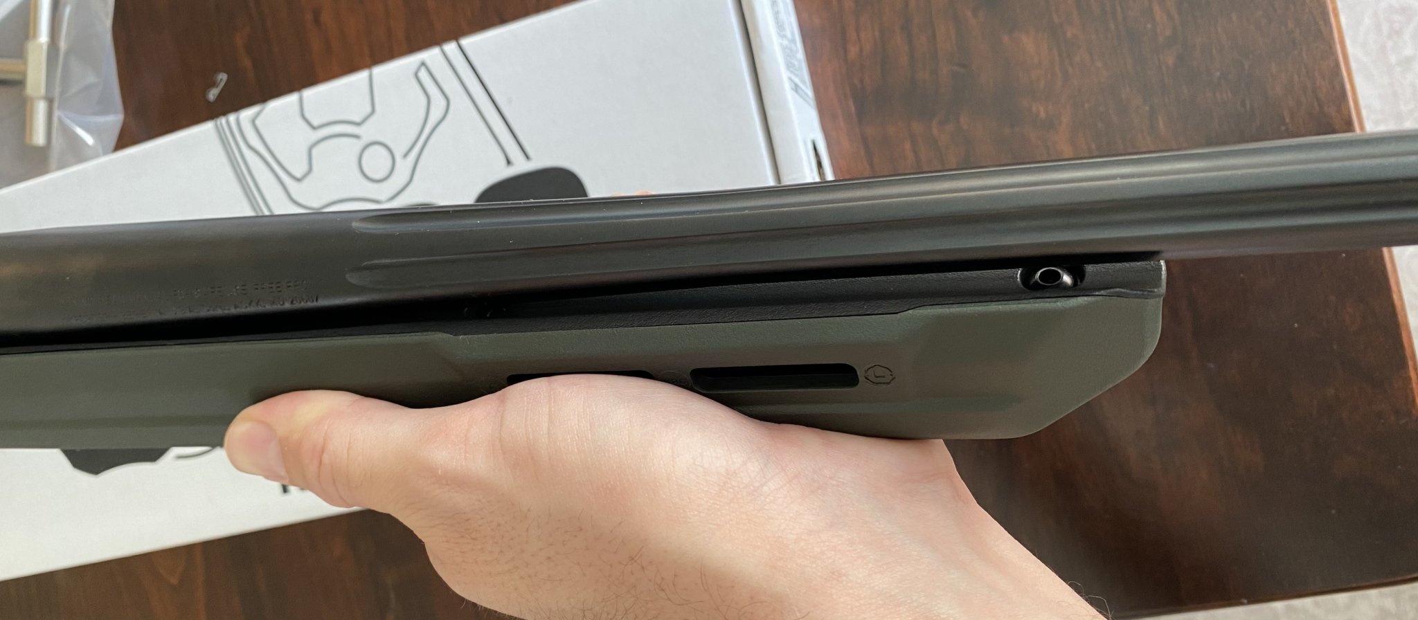

With the normal insert, the Roughtech Ranch barrel has generous clearance.
Overall: I’m happy with it. I like Bravos but this feels less chunky and more streamlined, and the forend is nice and stiff. Definitely an upgrade from the Roughtech stock, and a nice light alternative to the Bravo for trekking around with all day.
Vs the Echo:

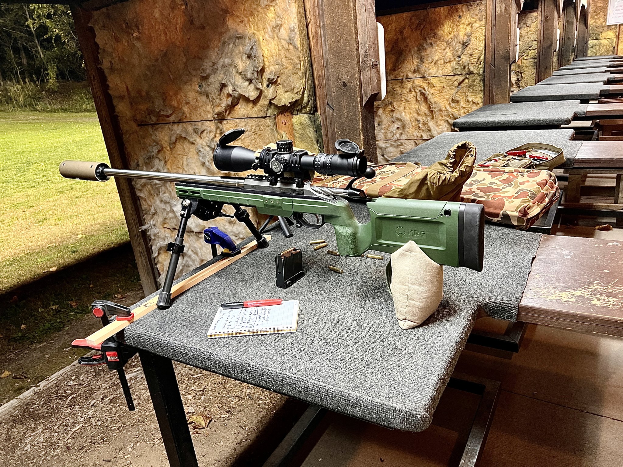

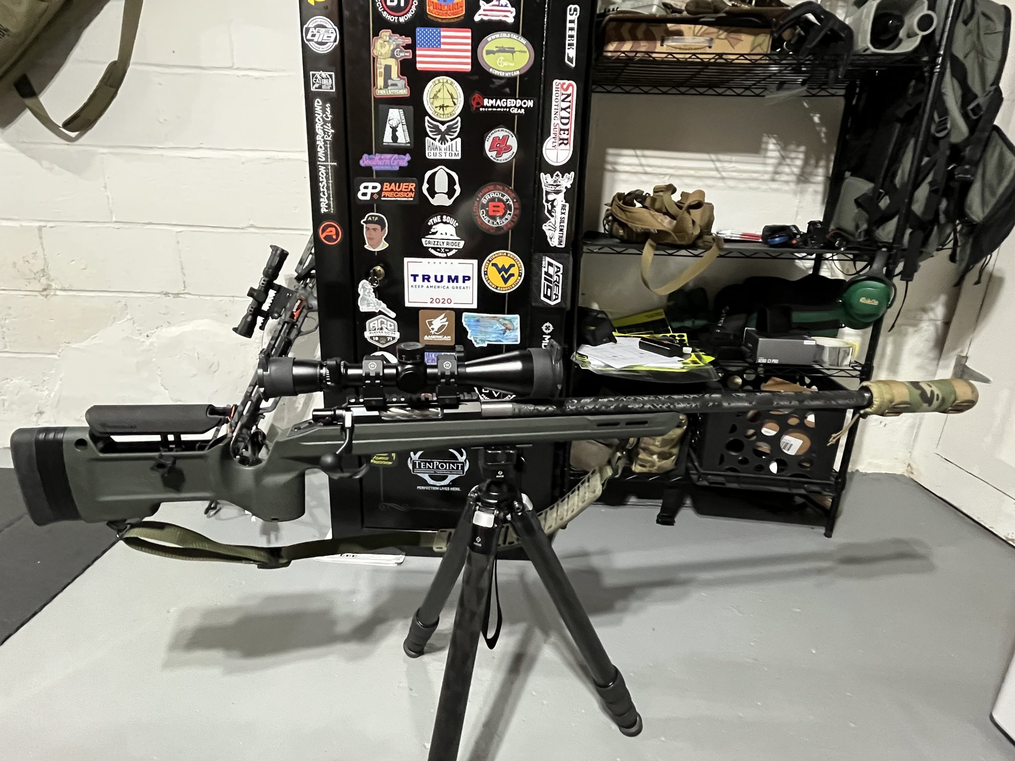

My Tikka T1x with 16" barrel was basically impossible to get balance in front of the magwell, regardless of what weights I threw at it.
I rebarrelled it with a 25" Medium Palma barrel and it just barely balances in front on the magwell.
My 19" 260 (CTR contour) won't quite balance in front the magwell with a lb worth of suppressor hanging off the end. Neither will a 24" 6.5CM CTR.
The factory CTR/Super Varmint stock would balance in any of these scenarios.

Are you adding the internal weight and any of those heavy full-length Arca spacers and full-length heavy Arca plates?
I got my Bravo to balance on a tripod with a 22” Mueller Remington Varmint weight barrel + suppressor, a NX8 4-32 w/ARC Mbrace, a light KRG full-length Arca plate and the aluminum adjustable buttplate (not LOP). I’d have to check again exactly where it balanced. No internal weight.
Below is the gun. Differently spec’ed than what balanced on the tripod: Had the stock pad on with a heavy spacer (no adj butt), and regular rings.
To run with a rear bag on a bench I needed to actually add weight to the butt for better accuracy. I threw in the heavy barrier stop inside the handgrip and used a heavy lop spacer with the KRG thin buttpad.
However, I agree I wish the butt was lighter or really, in my case that the forend was heavier. I’m not a PRS guy btw.

To add to the discussion about weight.
I went and weighed my CTR (adjustable) stock with a 223 CTR magazine and it weighed 2lb 14oz.
The standard T3 lite stock is less than 2lb but isn't really a fair comparison to the Echo.
So the Echo at 2lb 10oz is pretty good going. Giving all the cartridge options of the T3 (not limited by AICS/CTR mag length) the Echo looks to be a very nice option for T3 owners.

So I pulled my 6.5 prc out of the bravo and put it into the echo.
As I suspected, the barrel didn’t clear even with the larger barrel channel insert. it does barely clear with the insert completely removed. Enough to fit a few sheets of paper down the entire way back to the recoil lug, even when putting some pressure on the bottom.
Like KRG said, it does work and I don’t think it will be an issue for the vast majority of shooters. However, with the insert removed, there’s enough flex in portion of the echo ahead of the front sling stud that I can get it to contact the barrel if I really press.
This would never be an issue shooting off hand or from a tripod, but I could see it being an issue if you’re really loading a bipod at the very front and have to remove the insert to get a proof sendero or other large contour to clear.
Overall, it’s just a sleeker, lighter bravo. Same fit and finish, grip, levels perfectly etc. I like it.
Unfortunately, one issue I do have is that the regular old plastic tikka mag I have is very loose. It won’t fall out, but the back of the mag drops about 1/4” which is enough to keep the bolt from grabbing a round. If I press slightly on the bottom or hold it upright then it feeds fine. But just letting it hang in a tripod it won’t feed. Maybe metal hells canyon mags would be the fix? Any other suggestions?
Weighs exactly 11 pounds as pictured

I’d compare its specs to that or the proof sendero and see how it compares. Mine does clear fine.
With that said, I’m still going to take the dremel to that small area in front of the sling stud to open it up slightly more for peace of mind.
I also ordered a mag retainer spring for my mag issue. The echo install instructions say to keep that installed with this chassis but I don’t have that spring anymore. Never needed it for the bravo AICS chassis and now can’t find it.
So some very quick work with a dremel and fine sand paper opened up the very front of the stock to give plenty of room for the proof sendero. I took off maybe .2”
If KRG would just do this from the factory then it would be a real no brainer for tikka hunting builds.

Has anyone installed the short arca rail close to the magazine well? I don’t think there are threads. Maybe I’m missing something
Bartlein Carbon Wrapped #13 Remington/Varmint Sendero fits without removing the insert.
Yes
The 2 screw holes closer to the Mag well have threads. The 2 holes at the front need to utilize the nuts included with the arca rail from KRG. If you remove the barrel channel insert, you’ll see there’s premade slots on the topside of those holes for the nuts to sit in and not rotate while you tighten the screw.

Yes
The 2 screw holes closer to the Mag well have threads. The 2 holes at the front need to utilize the nuts included with the arca rail from KRG. If you remove the barrel channel insert, you’ll see there’s premade slots on the topside of those holes for the nuts to sit in and not rotate while you tighten the screw in.
Got it, thank you!
