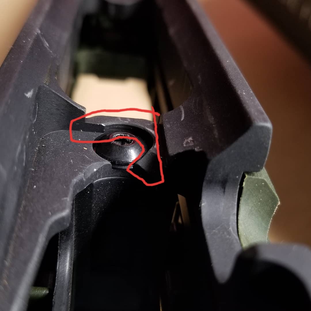

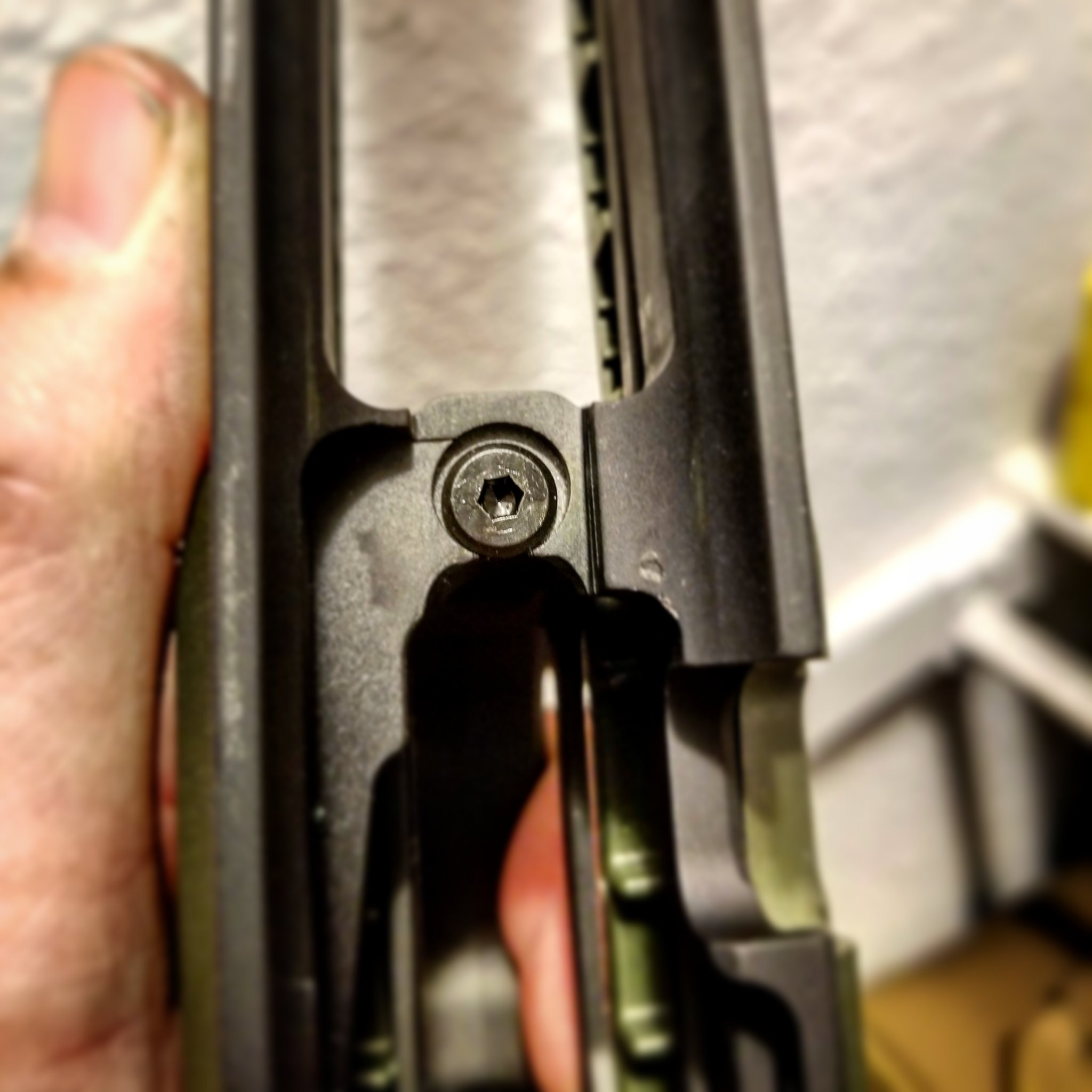

This little ridge around the screw is what needed to be reduced. As well as a low profile screw head, which I just filed down as well

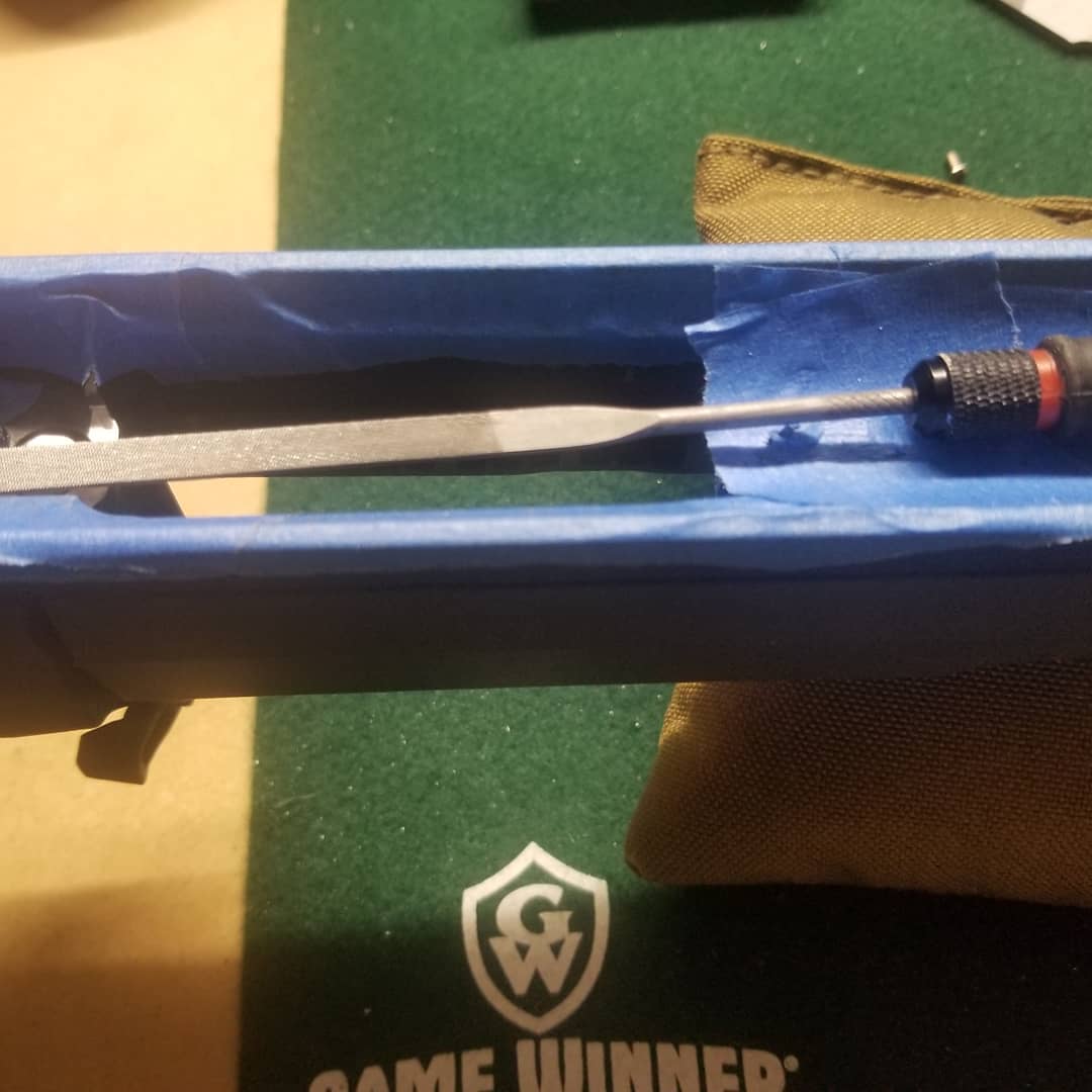

Using a small, flexible file I slowly started to reduce that lip. Of course it helps to tape off the surrounding areas to avoid unwanted filing.

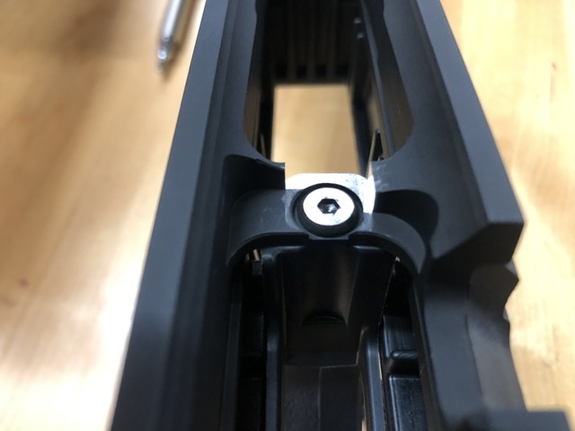

After a few hours of filing and checking the trigger hanger clearance I finally got enough material removed. I did test this without the front trigger hanger screw installed.
I went to the local hardware store to match threads and bought a couple spares. Took them home and filed down one of them to be low profile. It now sits flush without any wobble from the hanger or screw.

Low profile hanger screw, low profile trigger guard screw and that little bit of material was all I needed to get it to sit flush.
Oh and the screw lengths were another variable but nothing major.

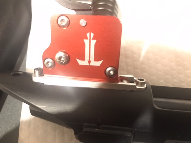

An alternative that worked for me, I called Impact and requested some low profile trigger hanger screws and ordered a -15 trigger hanger. This raised the trigger up a bit more and removed the interference.

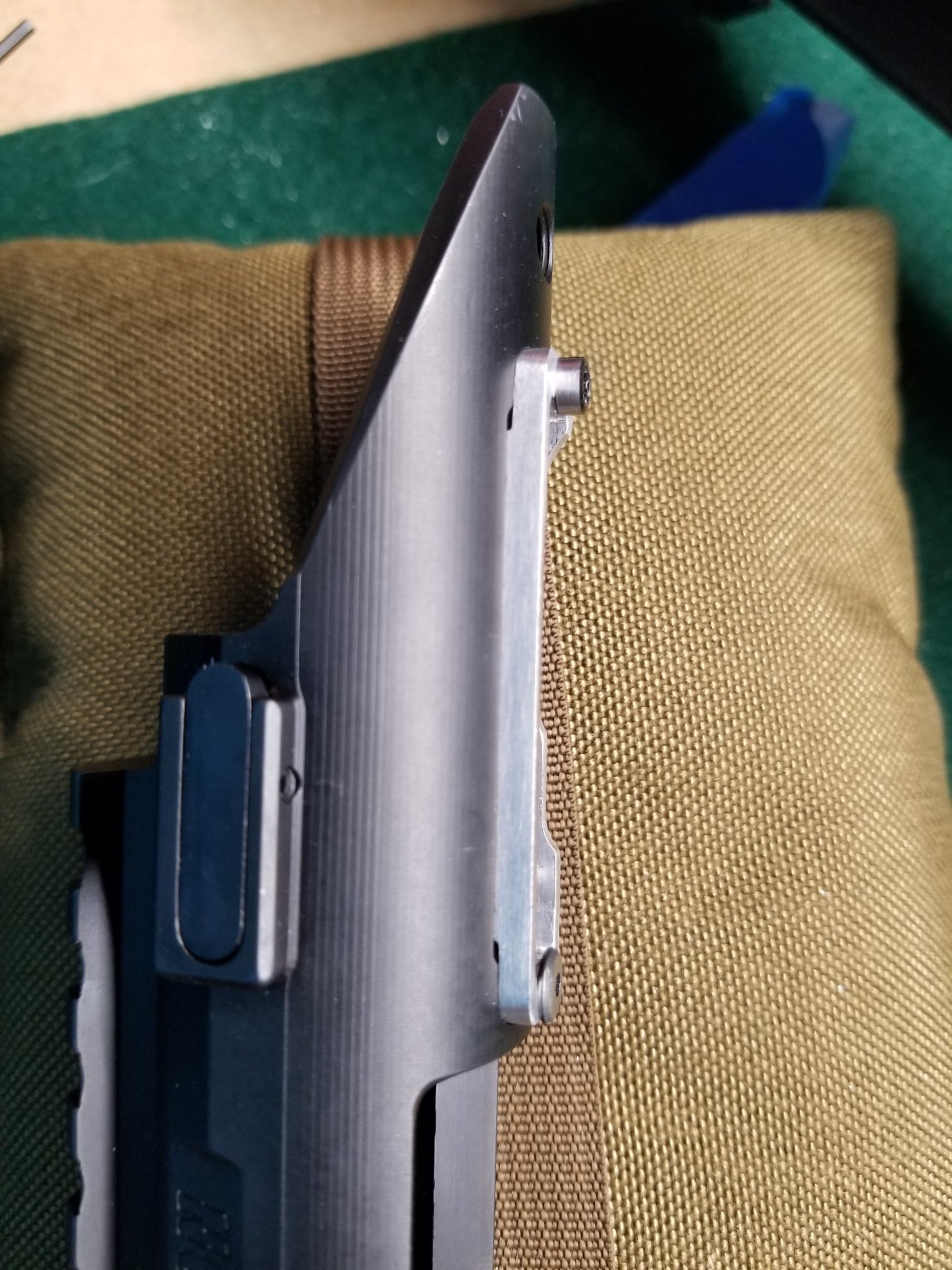

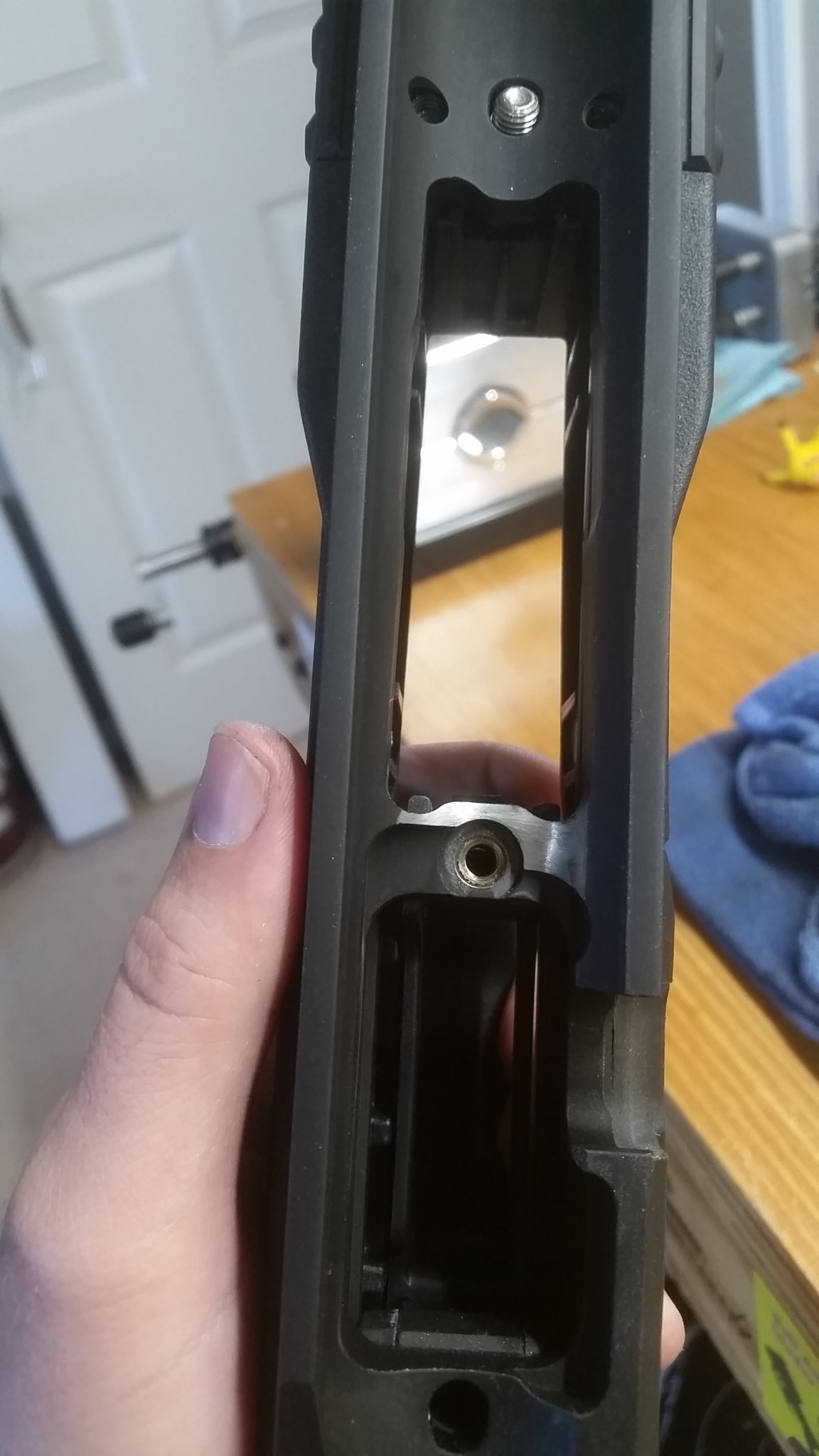

Following this thread I did it on a Gen 6. A dremel and cold beer job. Removed material from the chassis, replaced trigger guard screw with a flat head machine screw, and ground down the front trigger hanger screw head by 1/2.
I removed the material as shown above on the stock, but I also filed down the trigger hanger and trigger hanger screw a bit.
Felt like I was taking too much off of the trigger guard screw. This helped alleviate that

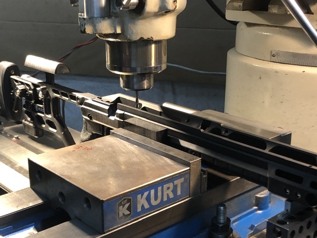

Finally got my KRG Whiskey Gen6 in and got it milled for the Impact 737 action.
Joe Pieczynski of Advanced Innovation LLC in Austin helped me with the work.
Everything fits great/torques well with no aftermarket fasteners.
Joe is a very talented machinist/engineer with amazing capabilities and ideas to match. If anyone needs custom milling/machining work or concepts don’t hesitate to drop him a line. His YouTube is great if your into machining!

So another alternative to prevent milling the hanger....get a -15 hanger AND low profile screws from impact. That removed any need to mill the trigger hanger or screws. If they don't have the screws you can find them at a hardware store.

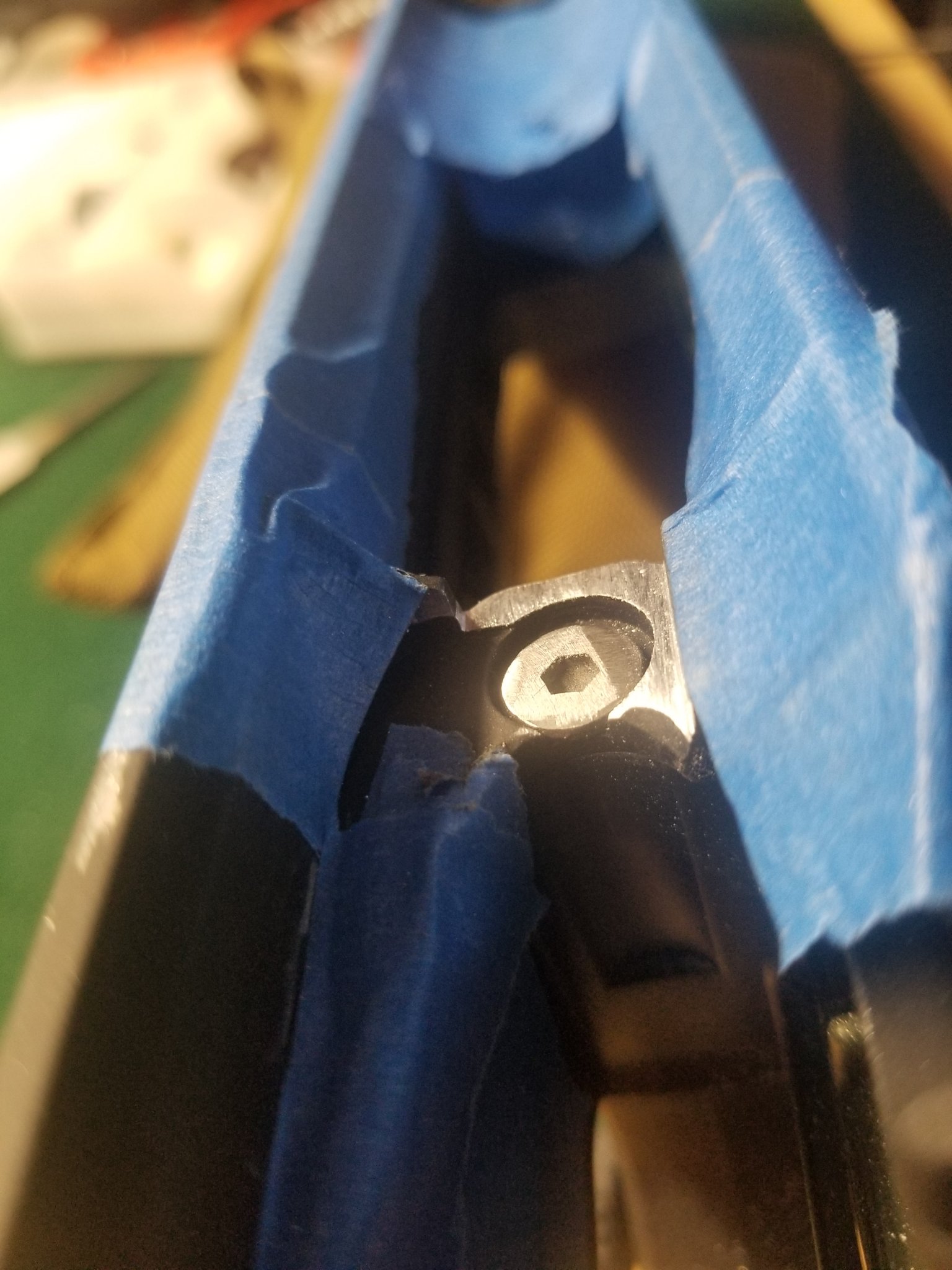

I got a router tip for the dremel and taped everything else off. I am not a machinist or even have a lot of skills. I just went super slow and took a little material at a time. The pics here and from KRG made it easy (still somewhat nerve racking but it worked out).
Using a small, flexible file I slowly started to reduce that lip. Of course it helps to tape off the surrounding areas to avoid unwanted filing.View attachment 7067844

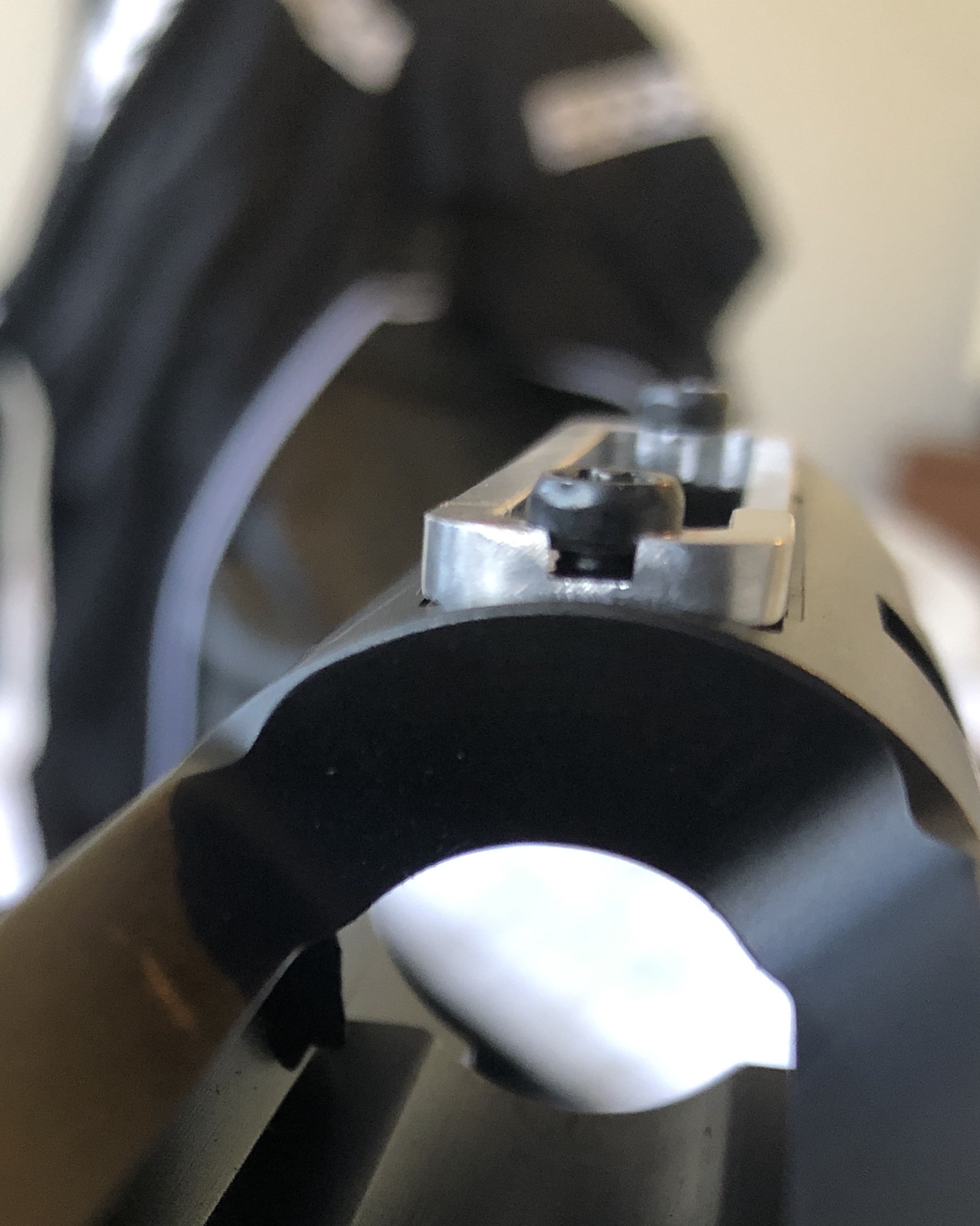

Eventually I dremeled down a T-15 and In order to make it fit into the action without bottoming out now their is noting left to grab on to with a torx bit.
My hardware store had nothing else that would work so I’ll probably need to order whatever this screw is called in the photo.
