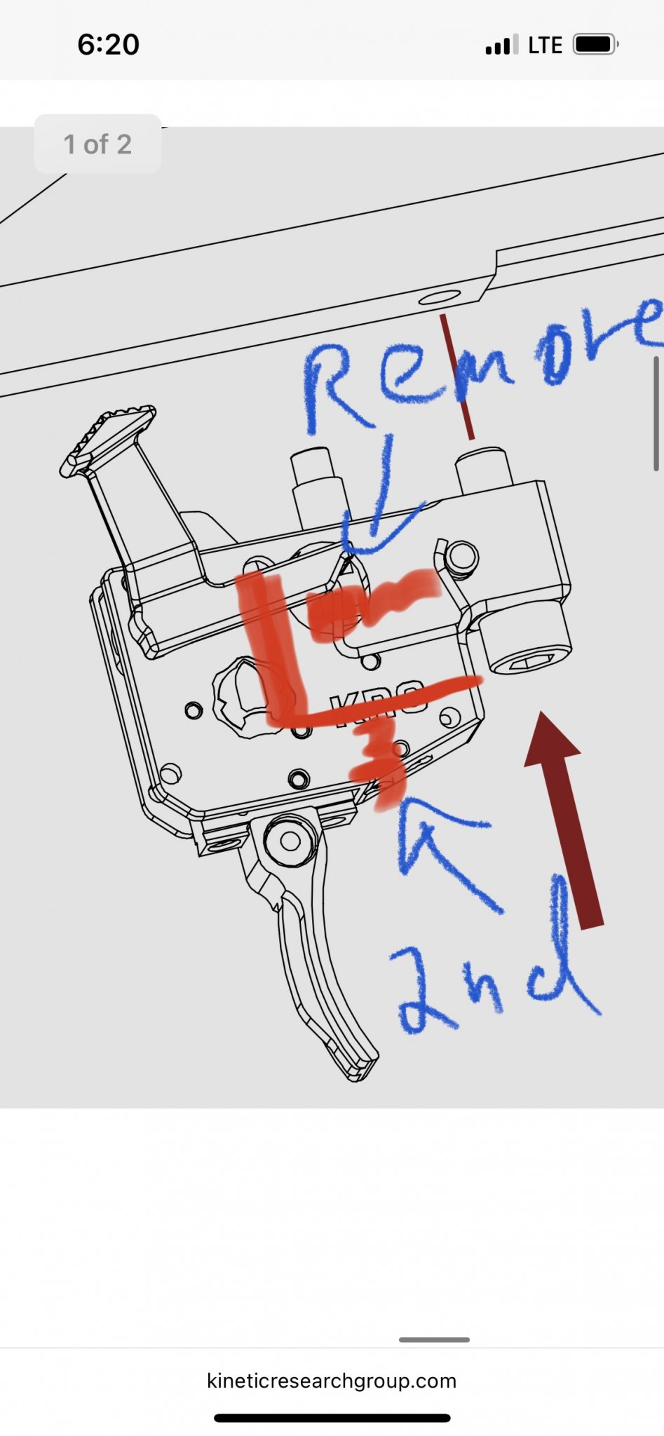

Crude finger drawing on my phone. The red L is the piece inside the trigger that the 2nd stage screw and spring push on to adjust the pull weight. That is the screw closest to the trigger. The squiggly lines represent the springs that push on the L shaped bar. The bottom one is the one you can adjust and the top one is the one I removed and sets the minimus pull weight. That is the reason that even with the bottom adjustment screw backed all the way out it still has around 1.5# pull.
You will need to remove the safety lever, trigger bar, and the L shaped bar to get to that spring. There is a spring infront of the safety pushing from the fro toward the rear so be careful. Also remove the 2nd stage adjuster screw and spring before starting to disassemble.
Hope this makes sense and if you have any other questions let me know.

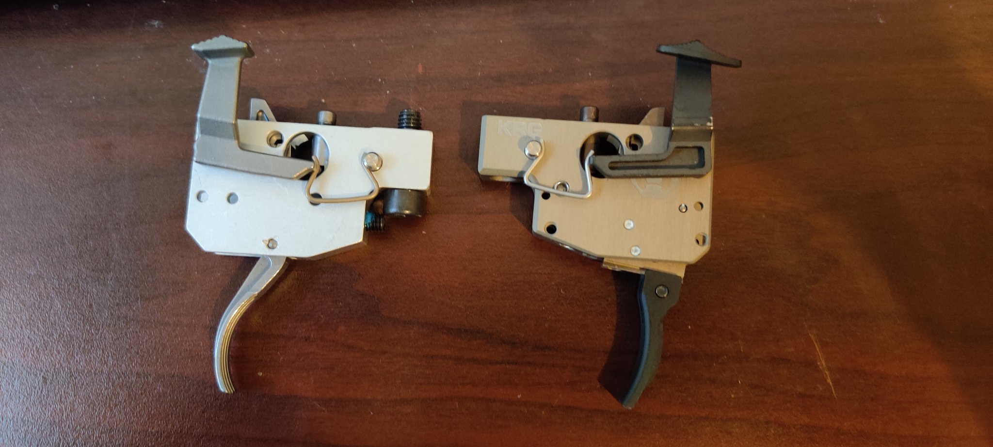

KRG Midas in left hand. Only issue right now is when you're engaging the safety, it feels like there's a middle position. I used the KRG spring so hopefully the stiffer Tikka spring will fix that.

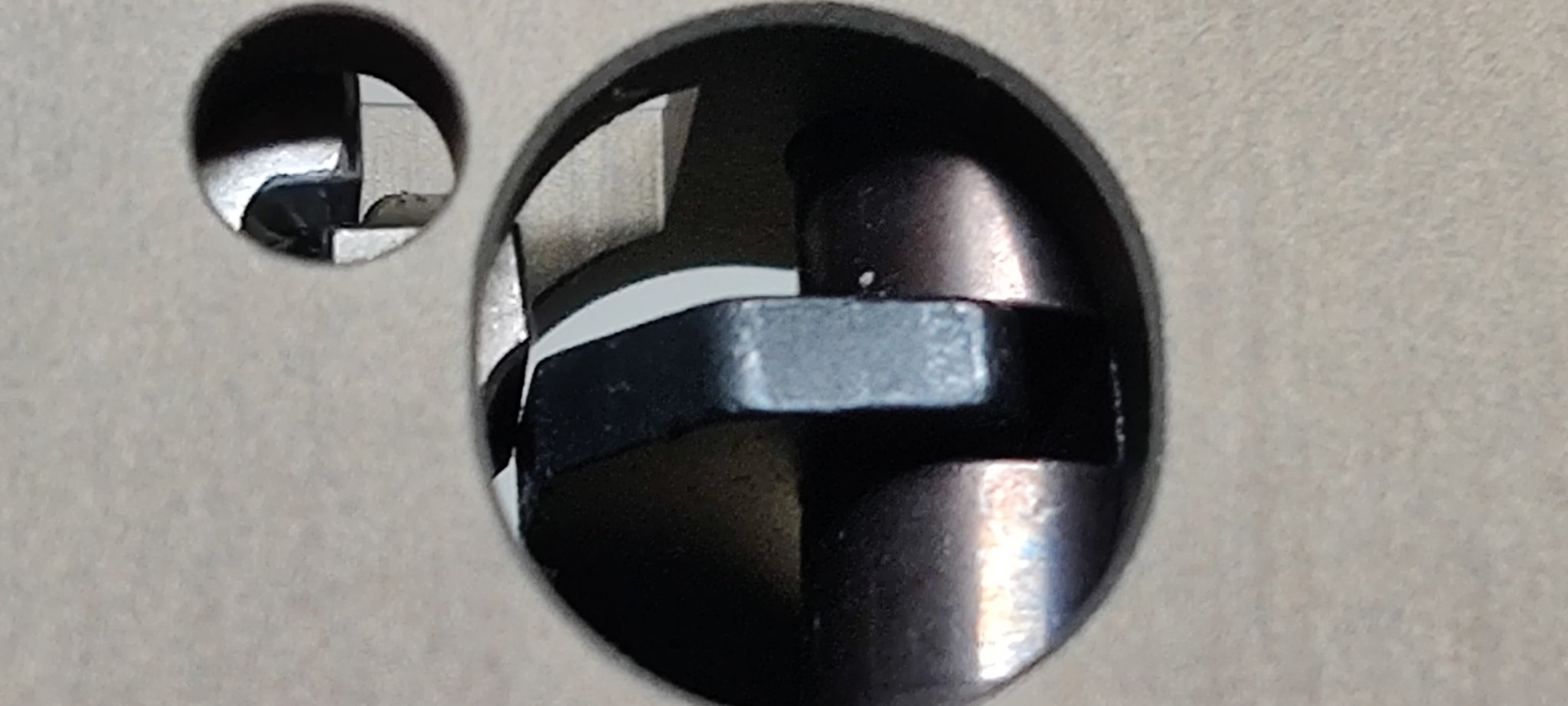

Quick follow-up...had to grind the safety a bit where it engages the sear mechanism. "Click" is gone and just to prove theory, I put the KRG safety on the T3x trigger group. Everything seems to work fine

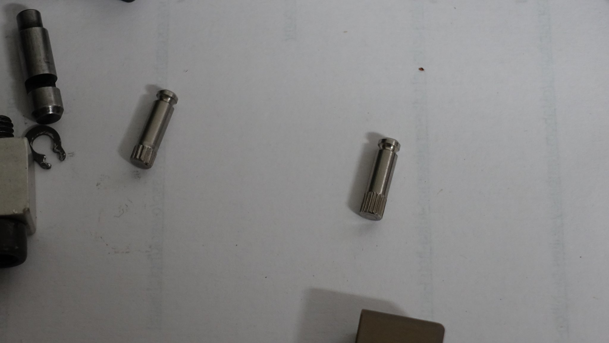

Also a note if someone else is attempting this: The safety spring post is ridged on the flush side. Press out from the head so you don't damage the bore all the way through(though I think it'll still be usable as the post just supports the spring). Also, that internal spring that pushes against the safety lever pin is a PITA to get in; but I had good luck pressing the trigger against the spring while pushing the spring with a punch through the back. While putting a little pressure on the safety, it should catch the spring although the spring will most likely be binding/cocked sideways. Push the spring down using a small/micro flathead and you should be able to push the safety through. May require "walking" or continually pushing the spring up/down while keeping constant pressure on safety.
Did you use a follower pin when you removed the levers?
The safety spring post. What side are you recommending to push from? The flush side or the sticky out side? Did you remove the post completely to reinsert from the other side?
Yes. Follower pin failed as the ends of the safety pins are tapered(basically spring still slipped/cocked). I think this is also due to there being so much room for the spring to move around.
Push from the sticky side. Yes, I completely remove and reinsert from the other side. Here's pic of the pins:
I used a press, actuating by hand. I wouldn't recommend a hammer/punch.

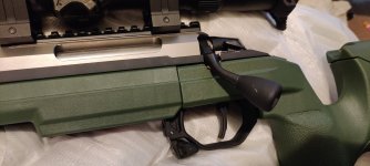

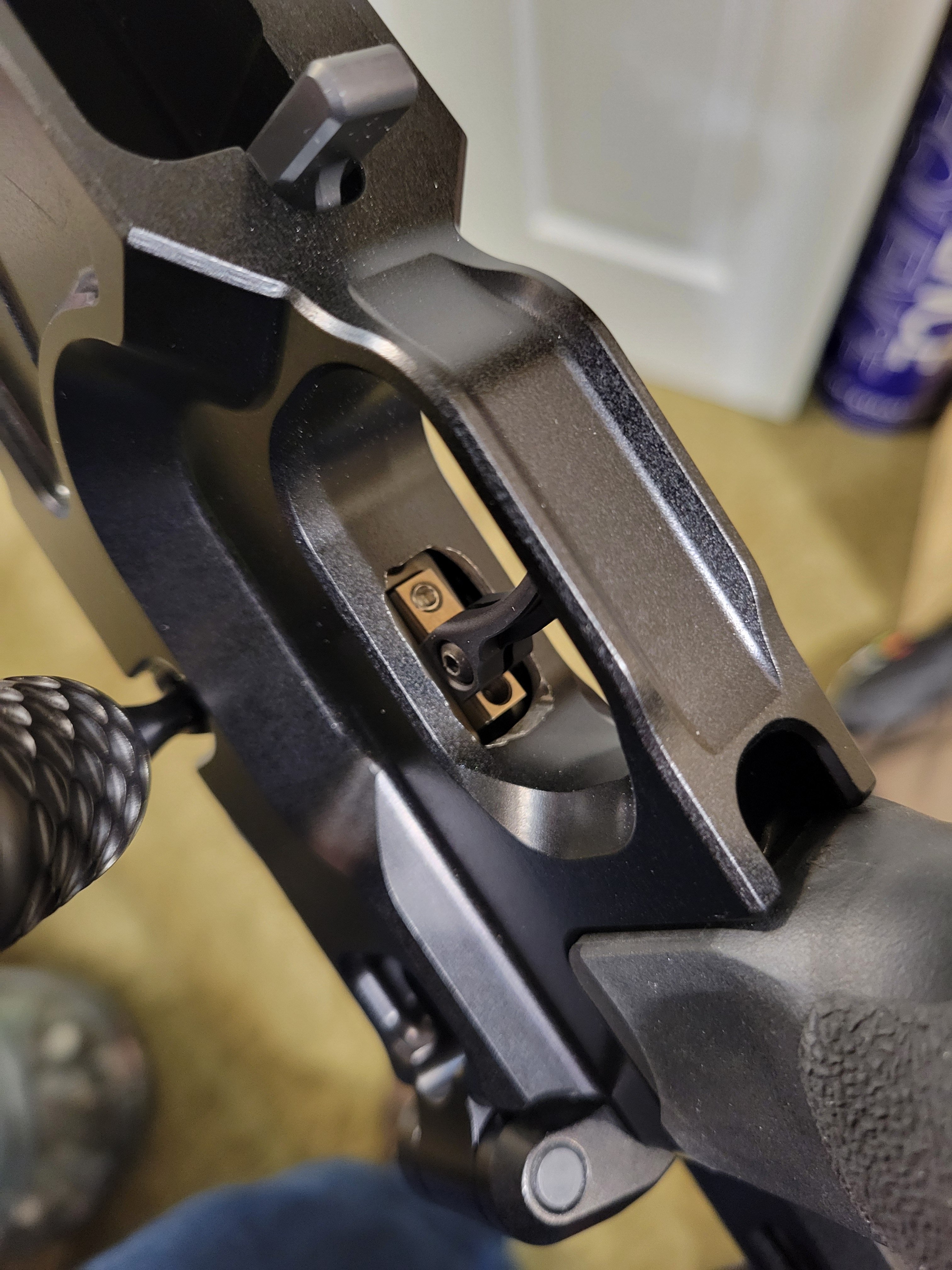

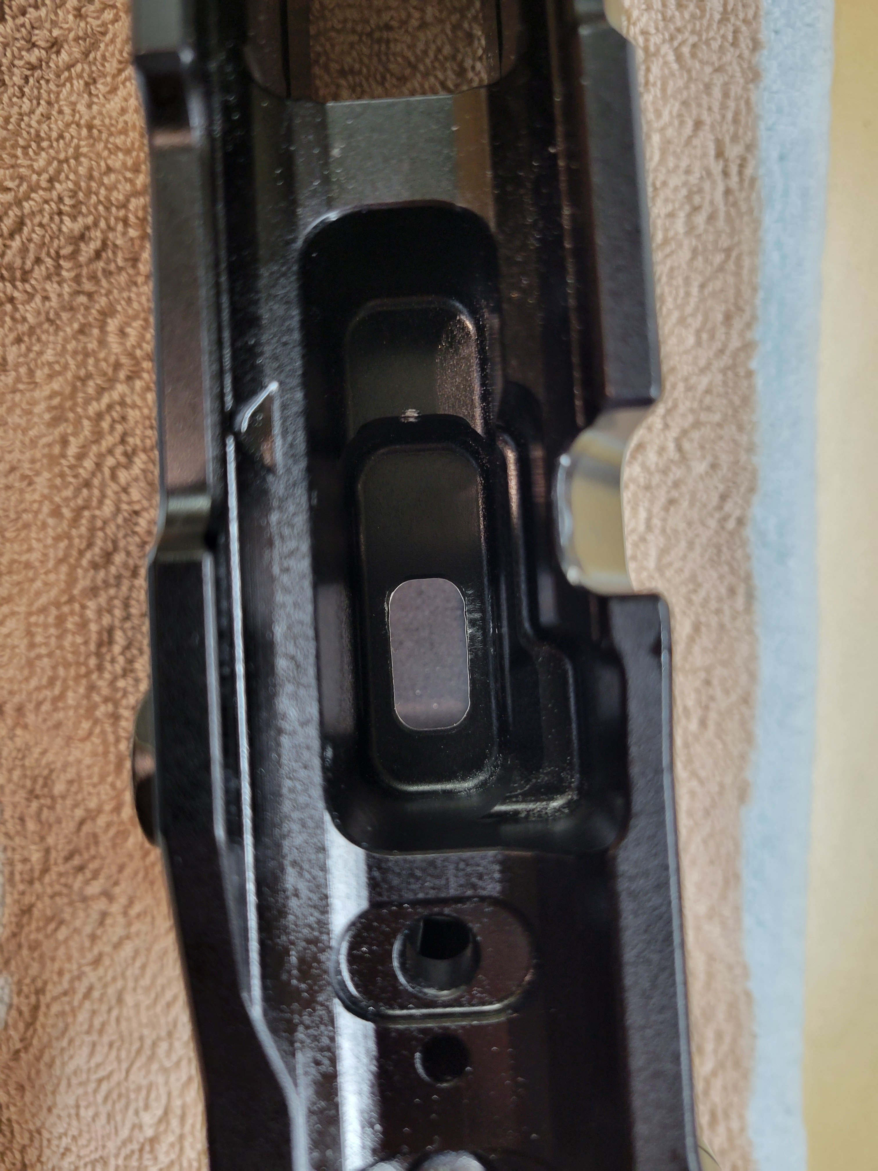

Took a while ( 2 years ) but I finally caved and picked up a Midas. I wasn't prepared mentally to take a dremmel to my Spuhr SICS chassis, but it had to happen. The new trigger shoe was easily 30% larger than the stock CTR single stage. But the real issue was the trigger shoe "block" that it slides on. That needed extensive clearance via the cutting bit. Overall it was stressful to do, but 4 bottles of Guinness does wonders for my "Fuk it" response to kick in.
The picture with the trigger installed was the rough fitment. Then I cleaned it up with a finishing tip.So far so good. Need range time to get a feel for it.

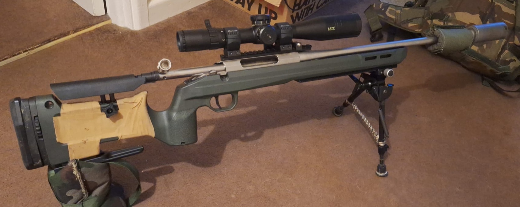

After a good 100 dry fires the Midas actually feels better than the first initial pulls. I reduced the weights to 2.90 total with an even 50/50 split between 1st and 2nd stages. It feels excellent ! Very happy so far. I wasn't exactly feelin it in the beginning, but now it's the shizzel.
That’s sorta how I feel. With a custom 204 barrel, I’m often shooting .5 moa groups with that trigger in a Bravo.
It doesn’t feel like I should be shooting that good with that trigger lol. Def has a different vibe than my two-stage Bix in an R700…in the Midas there’s not much over-travel available (I like over-travel).
The Bix is set at 8oz/8oz, considerably lighter than my unmodified Midas, which is set as low as I can get it. The Midas, even as set, is definitely more safe in a field gun than my Bix at 8/8oz.
In short, the Midas seems just as good as the Bix, just different.
