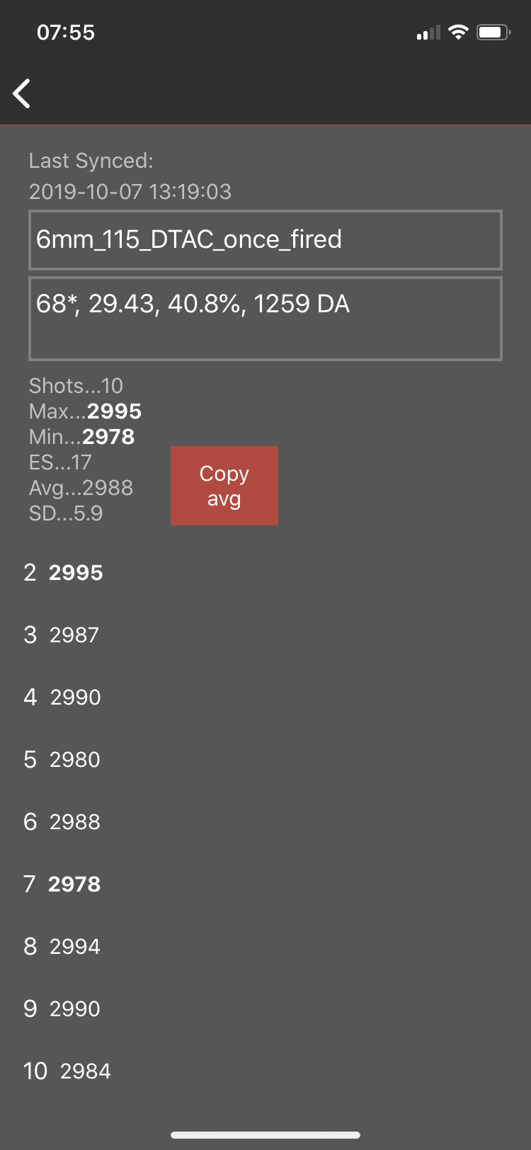

    just to ask do any of them allow you to give a label to stored shots groups like time date or anything it's the one of the things I can think of I wish the magneto speed does not do I wish it did that and erase all would be nice .
    I guess I'm one of the people that has had nothing but trouble with Labradar, it has been sent back once and yesterday after a few shots missed and read it said something like Internal fatal something, contact manufacturer. I've wasted countless OCW loads trying to make it work. Most of my shooting is on the weekend when no customer service is available, I have even tried to find someone to pay to help me with it. it has been very frustrating.... I have magneto speed also, need to look into the mounts you guys are talking about to get the weight off barrel.
    What happens when you have all that shit and it still sucks? Do we keep pretending you need a physics degree to use it? Or that it’s just a spotty unit at best and the ones that have a fully working unit are lucky and we can stop pretending everyone else sucks.
    Like this? It is the XFR attachment/app. It also has a button to delete the string.

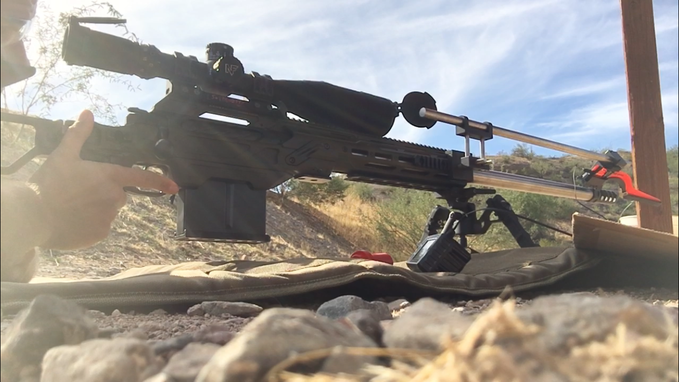

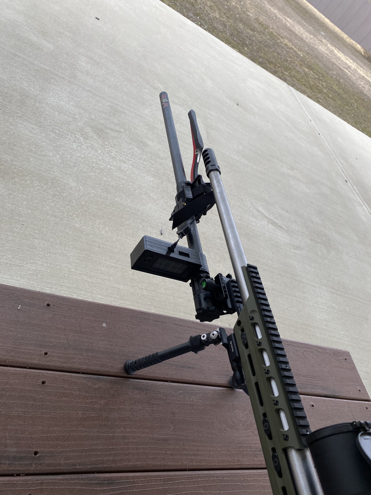

    Can someone post details and photos on alternative mount options for Magneto speed?
    I’m using the Wiser Precision Mount for my magneto. It works great. Uses arca or pic rail and is fully adjustable to any gun, barrel length, contour etc. After many headaches with my Labradar, I went back to the MS. Zero POI shift with this Mount and not a single missed shot.

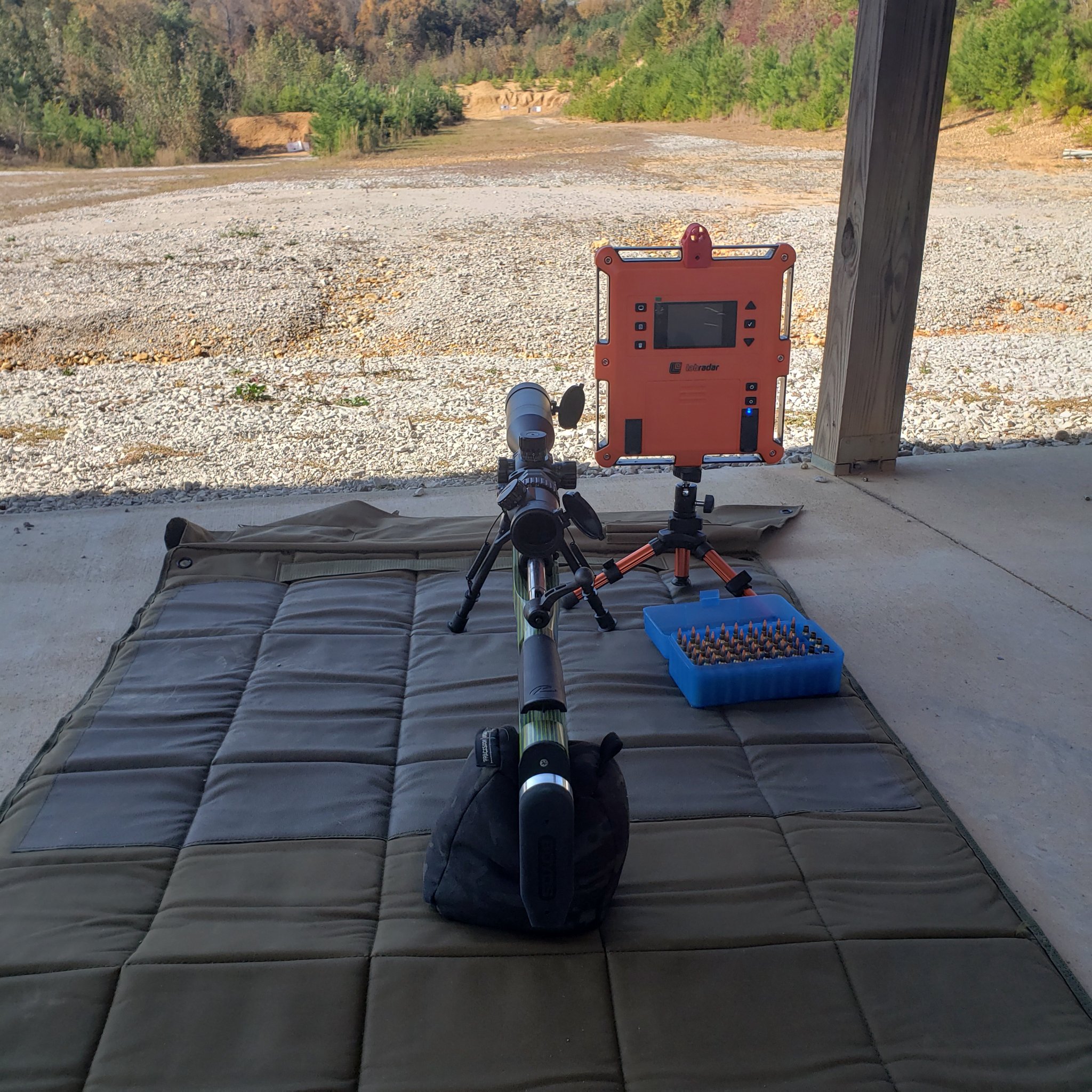

    My Labradars has a hard time on a range with overhead baffles. But it is 100% on a open range. I love it.
    Thanks for mentioning this. Maybe that is another reason I have trouble at my range in prone position, yet it seems to work well off the bench with the unit on my tripod. It is very fickle. I think I will get one of those Piet triggers to see if that eliminates any missed data.

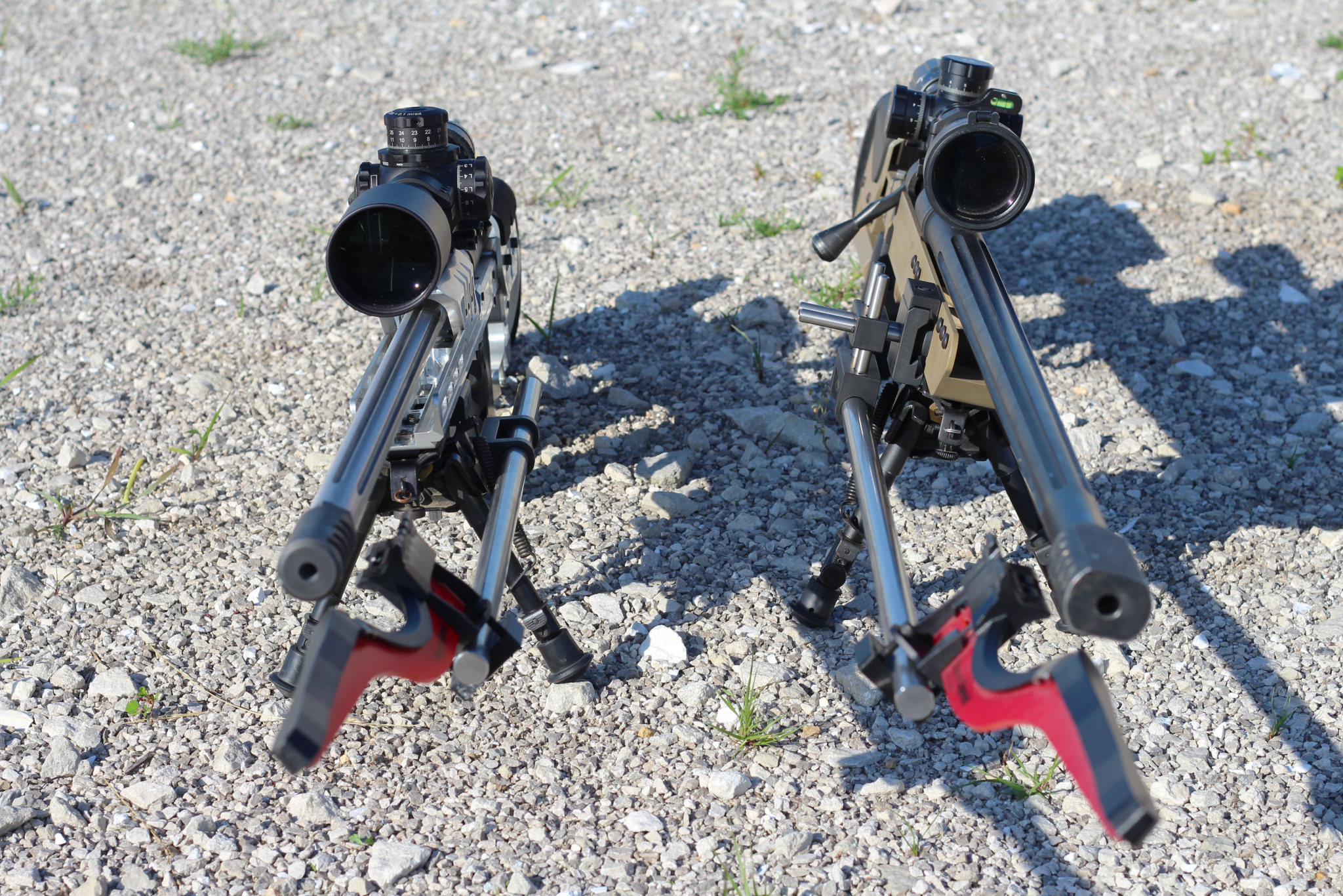

    I can assure you my Magneto Mount is at a different level than the competition, at a similar price. No 3d printed parts here, and a wide variety of adjustment, along with Pic and Arca compatibility. They're constantly sold out, but I have another batch finishing in just a few weeks! They are a lot more complex and costly to manufacture than the competitors, as a small business I can only afford to do 100 units per batch.
    All milled and hardcoated 6061 for the mounting parts, and all lathe turned stainless for the adjustment rods. A wide amount of adjustability, mount your bayonet below, above, on the side, etc.
