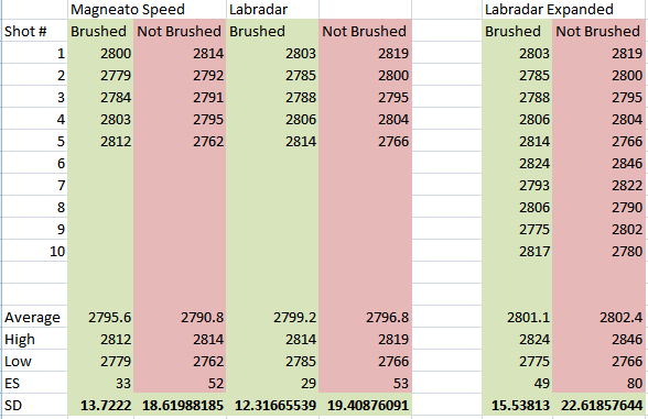

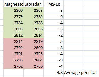

Just a little comparison, nothing extreme. A larger test will be needed to make it scientific but it demonstrates that the labradar averages about 5fps higher.
I took 10 cases and I brushed the necks before seating and I took 10 cases that were not bushed. I then shot 5 of of each with the magneato on the barrel with the labradar reading as well. (I shot the remaining 5 of each on paper with just the labradar, brushing necks appears to reduce your sd from this small sample and on paper looked better as well, not much but a bit)

Yep, thats it. I use a redding brush in a lyman reamer body
Here is the data with the shots straight up to one another.
I use a sonic cleaner (cheapo harbor freight) and my brass looks like new inside and out not sure a brush would help me. My SD are usually good anyways but never hurts to improve. Interesting how close the MS and the LR are, once I moved my LR to be exactly even with the barrel my FPS was identical to my MS.
