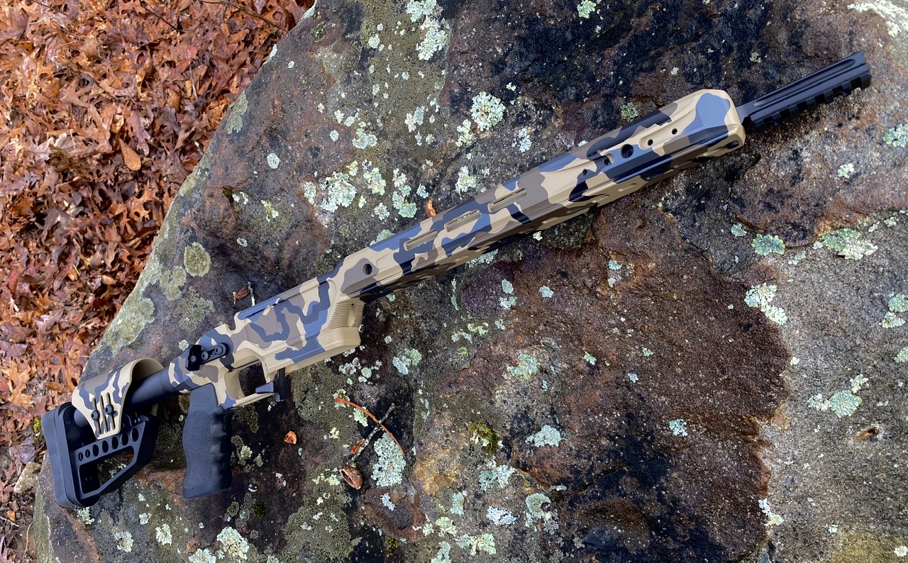

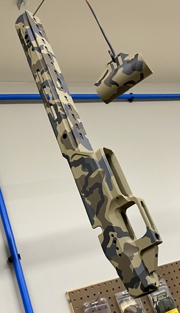

Did this last night on a friend’s match rifle. Supposed to look like Kuiu Vias but it’s really a bit too busy to be spot on. I like it nonetheless tho.
Nice job - did you use the Freedom stencil? And did you bake between colors or let dry, apply next set of stencils, paint over existing color?
Those are the freedom stencils. Colors are graphite black, patriot brown, sniper grey, and coyote tan, in that order. Flash at 180F for about 12 minutes between coats. Fully cure after last coat, then peel all stencils.
Nice job.
Patriot Brown is my go-to usually for brown in a camo job.
I've never had success with that short a flash time when layering, damn if I know why...seems less than 20 or so they'll pull the paint off.
Thank you guys. This is going on a 25x47L build I am doing. I’m excited about it. I’ll post some pics of the stock fully assembled and the rifle when it gets finished.
