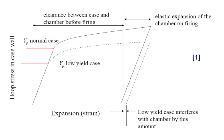

In each firing the brass expands in all directions (length as well as diameter) and so does the chamber steel (to a much smaller extent than the brass obviously) but eventually that brass gets hard enough and looses its elasticity that it will expand open to the max chamber size during firing and then since its not elastic and has lost spring back it will stay large and be difficult to extract. You basically hammer fitted it into the chamber. Since you only touch the necks in neck sizing those now larger pieces of brass will be too large to fit in the chamber without a hammer the next time.
Some people that do neck sizing and dont have the issues are lucky or they are using very closely matched reamers/chambers and brass and they take it easy with loads that are light enough to not work the brass too hard and over come its material properties. They are on top of their complete system though, not just getting into it. Eventually they will still have to use a body die though at some point, its just much further down the road.
